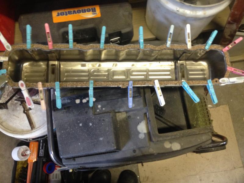

Surprisingly the only leak were the side plates which i have since 3bond'ed and not a spec of oil. Surprised i taught someone something ha. Well it's used for the same thing, whether it is the same or not im not sure. I thought GM stuff was the norm and loctite the outcast. I'd really like to hear some more opinions on this, i am very intrigued.

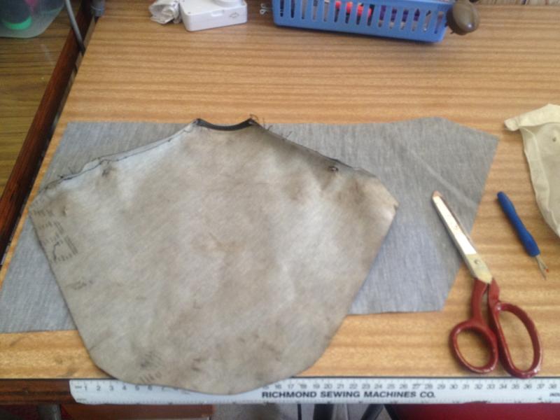

I 3bond'ed this today ready for re installation tomorrow. This time i covered the whole gasket. Apart from not being able to pull the cover off in the first place (gasket stuck to both sides), i only applied it in sections and it left me with bits and pieces.
Also started my gear shift and handbrake gaiters by cutting out some template material.
