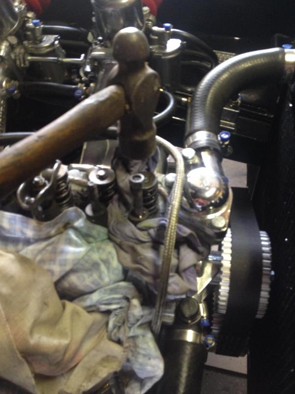

I'll take a few ear buds with me, Dave. Problem trying to coat the inside of the boss is the pool of coolant inside.
You can't drain some coolant off???

It's expensive coolant lol!!
Anyway got it in no worries, just have to adjust the rocker arms. I've noticed a few are quite loose I can turn the pushrods dry easily. Could this have been a factor in the clean break?
#504 TerrA LX
Posted 25 February 2014 - 10:27 AM
So empty it into a clean container and re use it...

My aim is terrible. All sorted anyway I drained coolant out with a during and fitted it it. Adjusted the tappets with the booster vaccume hose disconnected which made things difficult until I realised. I might give them one more go in a little while but hopefully this lasts.

Yeah i froze it over night thanks for that. Went in pretty easy but not too easy. Easy in the sense that i was able to drive it in without needing a press. Though, it destroyed the nut i screwed over it. I drained some coolant, gave it a quick smear of #3, let it dry a little then i fitted it and hammered it nice and straight. Got it to about a 1/2mm level with the other one and left it as i didnt want to drive it too far. Interestingly though not all of the others are level anyway.

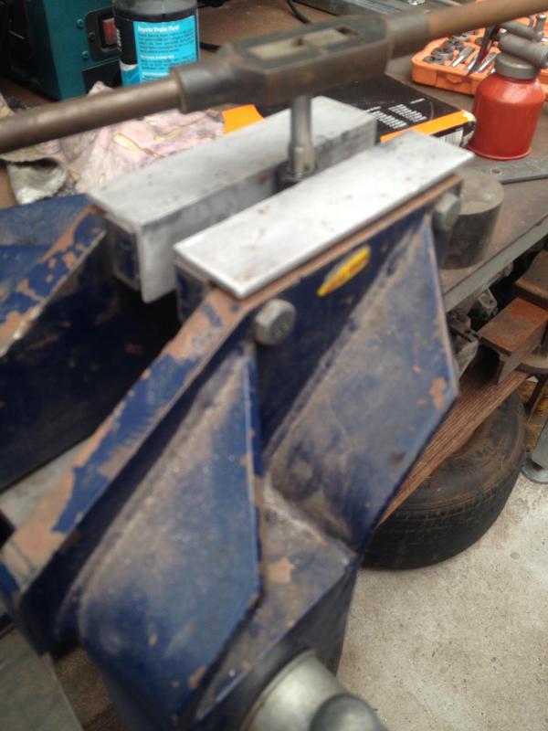

Polished the rearview mirror and tapped a 1/4bsp plug with a 1/8npt thread.
