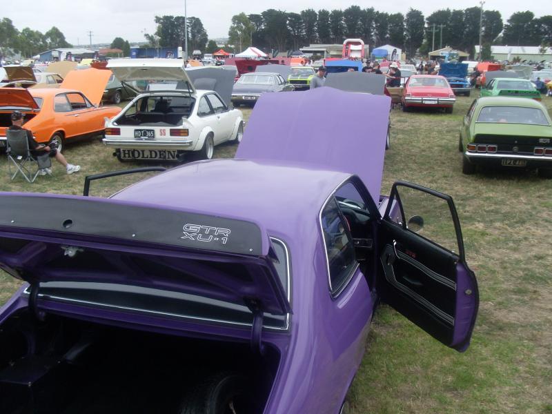

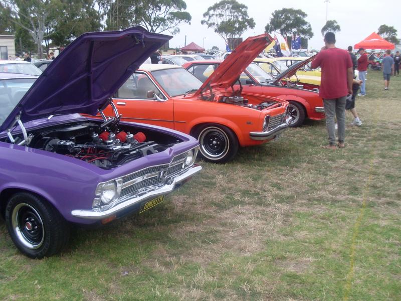

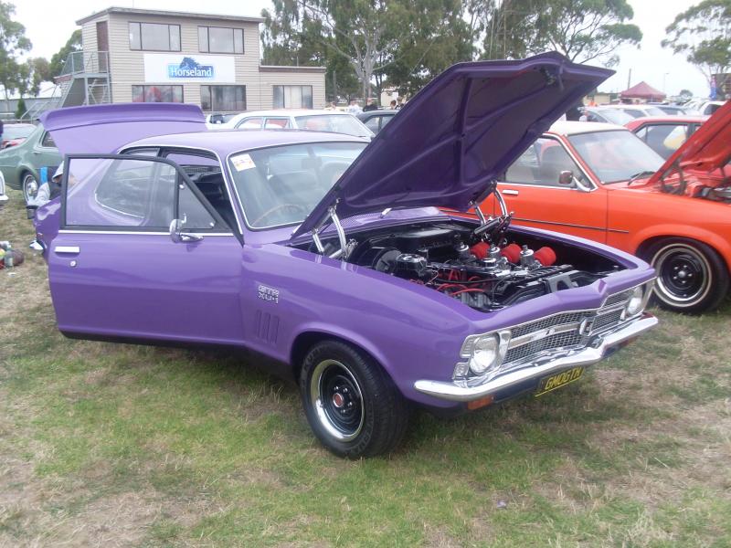

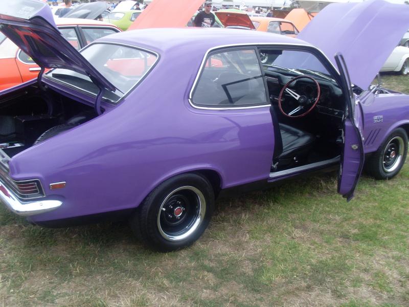

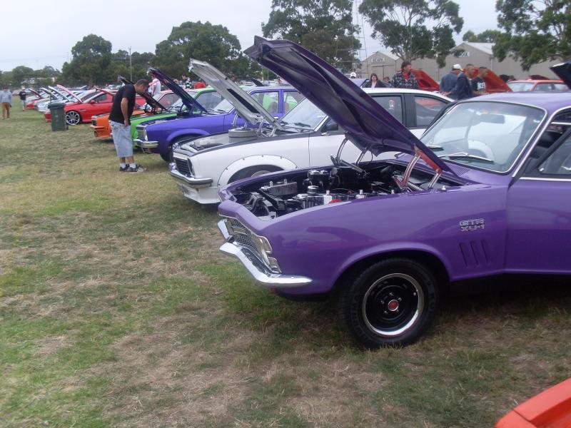

Some pics from the all Holden day.

Shit, how many cars were there? All Holdens?

There were actually 700+ cars there. 7000 plus visitors.

Thats insane. We had to combine the Holden day with the Ford day just to get enough cars to make a show......

Was pretty full on. Would have been nice without the VX + models, who unfortunately made up some numbers. Could have also done without the blasting stereos!

looks like the weather was good to.... a real stereo is an XU-1 muffler :P
