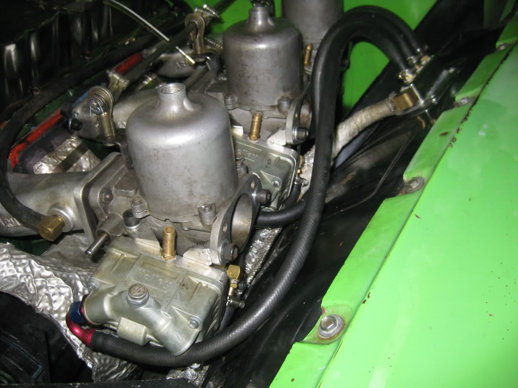

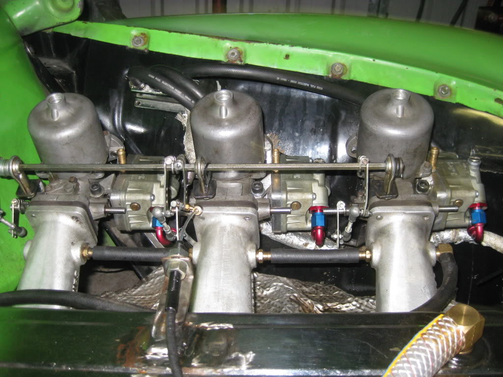

G'day Warren, hows it goin, it's been a while,what have you been dooin? Fitted 2" su's up to a cut n shut armours manifold ,man what a difference to the holley, low end torque is way up but hp/1/4 mile speed is the same ,took over 2 tenths off 1/4 mile time.This motor is getting tired and its time to think about changes for the next engine to get into the 12's.

You finally seen the light & fitted some good carbs.
Did you use the "Torana" Armours manifold, is this why you cut n shut?
Attached File  P1020111 (600 x 450).jpg   73.91K   1 downloads
I haven't got a pic of the other 1 that will fit in the FJ, but the carb flange doesn't kick back down as it does with the "Torana" version (so the the carbs fit under the bonnet). I haven't done much racing, we had a change in roster at work which I have to work 2 weekends in 4, & most race meetings seem to line up with the weekends that I work. I think there is a bit of a conspiracy against me. :furious:
Sounds like the J needs to go on a diet, I thought it was lighter than my LJ, but you 37kgs heavier.
Sounds like theyve got it in for you mate, July 29th was my first meeting in 2 yrs so i have a lot of catchin up to do,time seem to be the main problem.Its hard to get 37kg out without changing the cars character too much.Everything not needed is out (even swaybars) .May be I should lose the 37kg.
Yep definatley seen the light , I couldnt get any more out of the holley. I started with torana manifolds and cut them to get the bowl angle dead right ,otherwise they can sometimes run out of fuel,also joined them together with 1" tube. After a lot of time getting needles right it was ready to run again. There might be a bit more in it with springs and oils and smoothing the air coming into the carbs.
