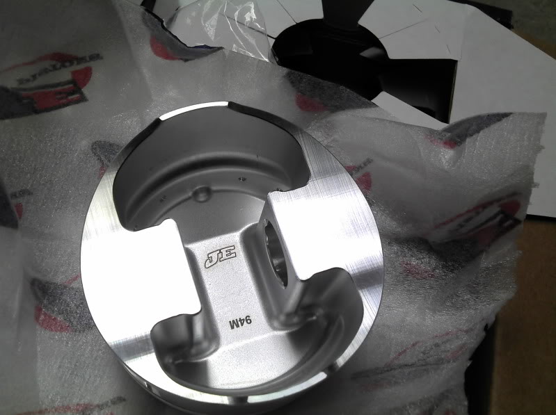

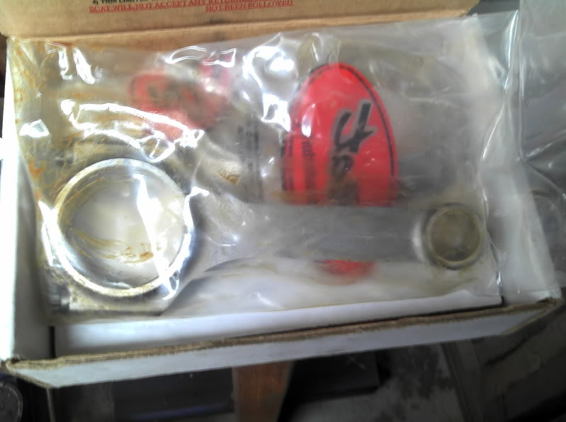

I'm really only looking for a crank, I've already got these-
and these (8 of the things, so two spares)
and the big alloy 12 port.
we just want to throw a counterweighted crank in, but figure its worth doing some minor shaping of the leading edge on the counterweight for that poofteenth extra reduction in resistance.
all the knidedged cranks Ive seen have a heap of work (like someone mentoned about, lots of weight removed)
Would it be worth simply creating a "leading edge" on the crank, intstead of trying to reshape half the conterweight? Regardless of how much shaping, its still going to be balanced with the rest of the internals?
Or do we just stick with a stocko cw crank and not go to all the hassle?

#61 orangeLJ
Posted 15 August 2012 - 02:11 PM
Ive got 4 black/blue cranks and a couple more still in blocks, so thats not the issue (but thanks for the offer)
Its more which way we go with the treatment of it/them?
