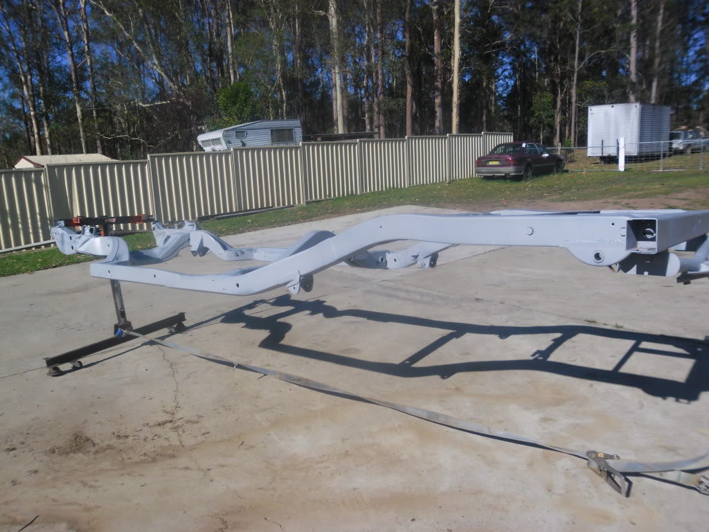

Chassis got its date with the hose and forklift yesterday, im glad we did it because alot of crap came out.

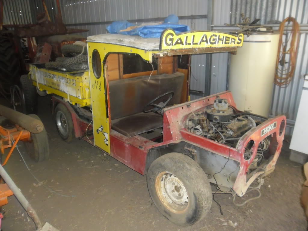

also i saved this little beast from spending the rest of its life in a leaking container.
its a 1978/79 mini moke that looks like a 26 dodge 2 ton truck. its will be mine and dads project together
cheers danny
#40 _Quagmire_
Posted 02 November 2012 - 07:07 PM
that moke is cool

#43 dattoman
Posted 02 November 2012 - 08:25 PM
I have a chassis just the same laying around here
Almost temped to find a body for it now
Is there a plan to coat the inside of that chassis with something to stop it rusting from the inside out ?
#44 _Macca75_
_Macca75_
Posted 03 November 2012 - 03:02 PM
there is something out there but i cant think of it, it comes ether in a spray can with a foot long straw on it or just a paint tin.
picked my extractors up today, nice set of genies :)
#45 _Bomber Watson_
Posted 03 November 2012 - 03:14 PM
Tectyl would be the best product.
#46 _Quagmire_
Posted 03 November 2012 - 04:58 PM
tectyl is just a short term converter/protectant....and dangerous as all hell don't get it on your paint..
.never comes off and eats it
wear a respirator and gloves etc if you use that
wurth's wax or similar.....or even bitium[tar is the go
or even fish oil...
Edited by Quagmire, 03 November 2012 - 04:59 PM.
#47 _Macca75_
_Macca75_
Posted 12 November 2012 - 01:15 PM
Havent done alot, chassis ready for the first coat of paint, for the inside we're just going to use fish oil as the stuff we were looking you'd need to take a bank loan out to buy it.

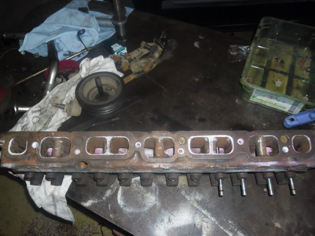

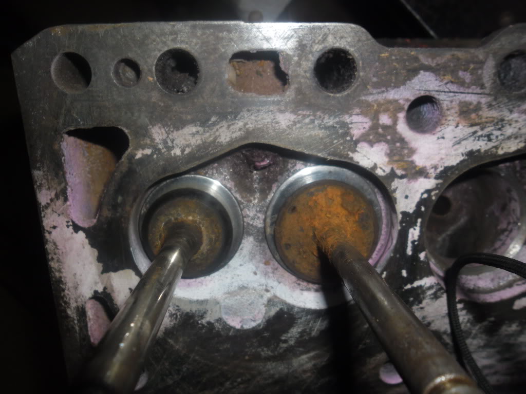

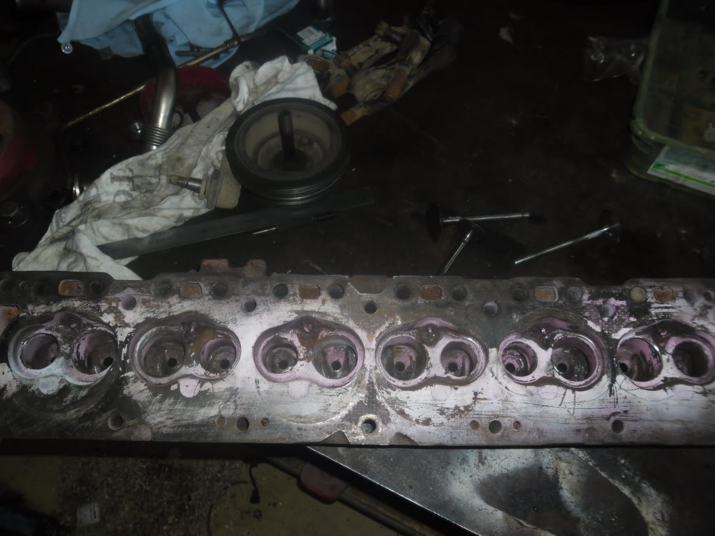

#49 _Macca75_
_Macca75_
Posted 12 November 2012 - 05:58 PM
Ive already got the 173 head, the motor was down the paddock when we moved here so i had to make use of it some how.
heres a few pics of it. won't be a big power house will only be around 160 170hp, so maybe it might handle it lol
chassis all undercoated now just have to wait for it to harden and to the top coat than clear.
Cheers Danny
Edited by Macca75, 12 November 2012 - 05:59 PM.
#50 yel327
  • 13,975 posts
Posted 12 November 2012 - 06:11 PM
Sorry, I read 173 9 port as 179. You want a really high comp engine, make sur ethe cam has plenty of overlap or it'll ping its proverbials off!
