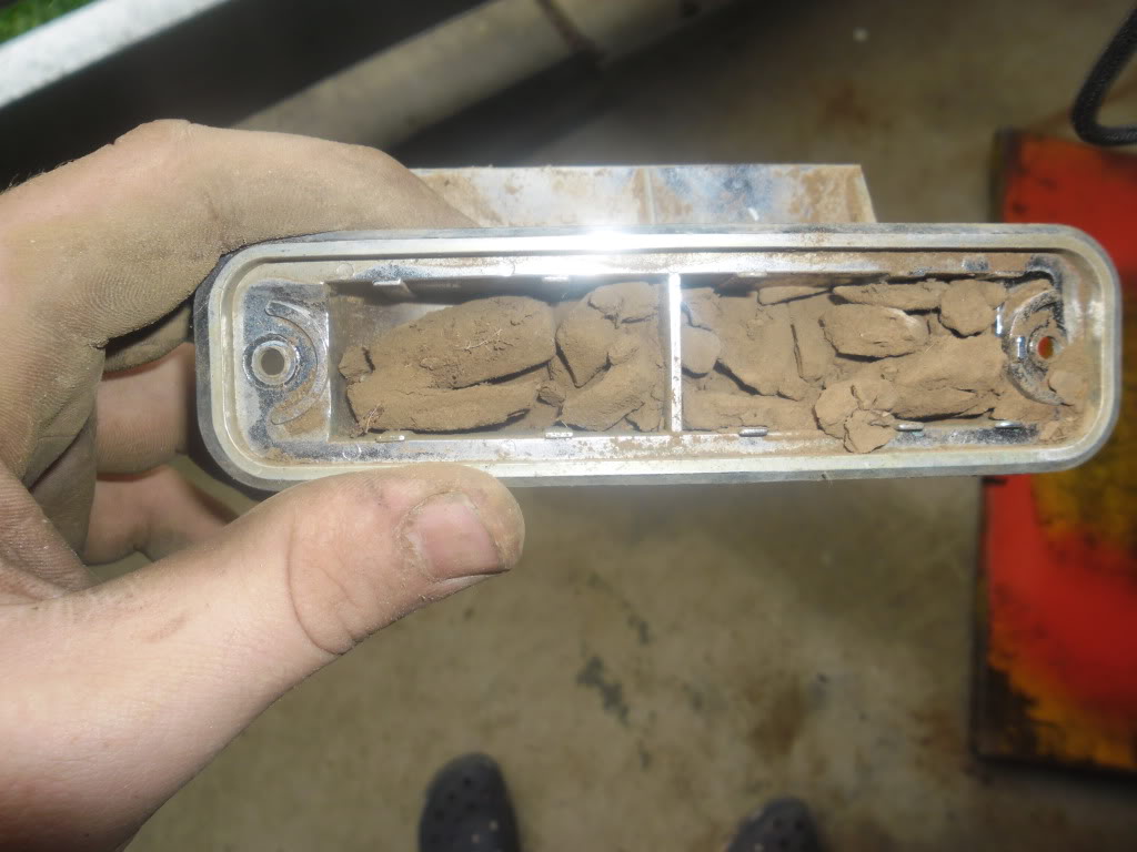

Posted 17 November 2012 - 04:03 PM

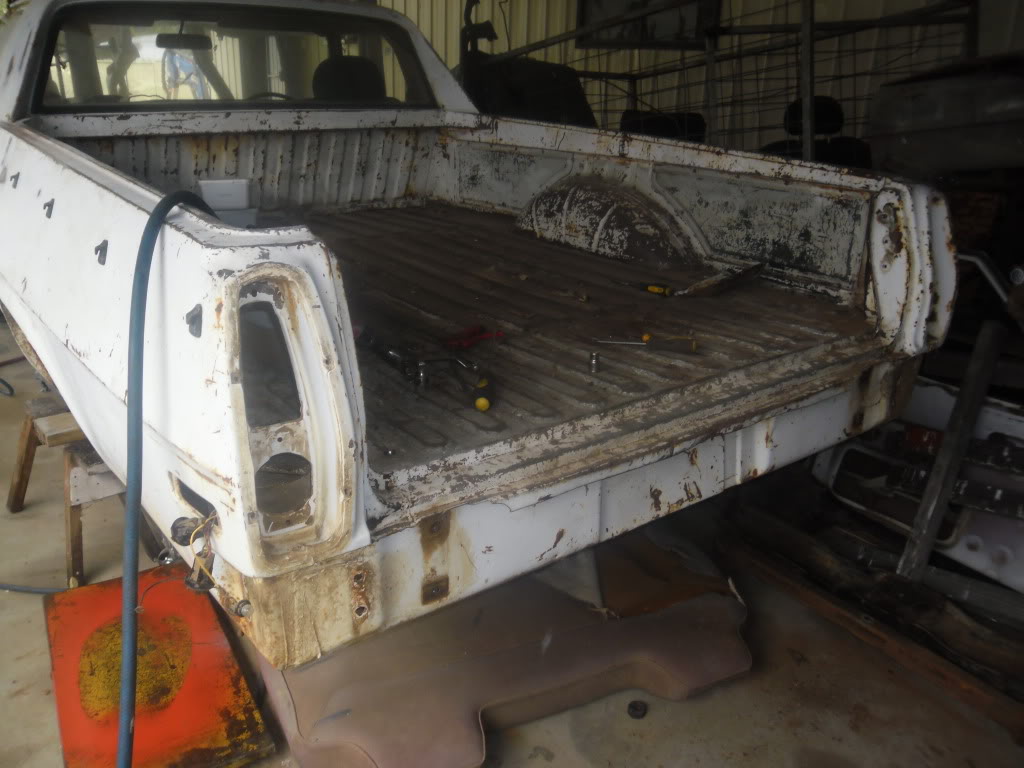

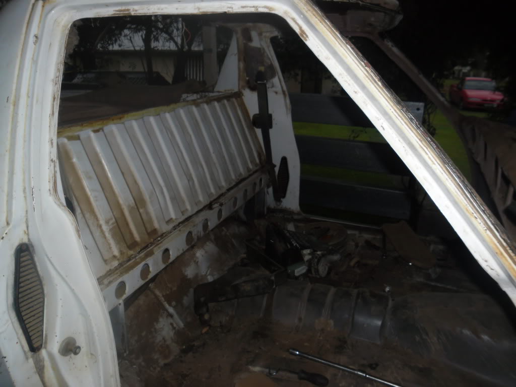

just a small update, took all the lights and tailgate off. started to rub it back where there was primer to see if there was any bog, still clean as a whistle. found 1 of the reasons why i the lights didnt work.
ive never seen dirt like this before
i should really finda better spot or the parts ive pulled off it.
cheers Danny
#53 _Liam_
_Liam_
Posted 17 November 2012 - 07:17 PM
That's a wasp nest isn't it? (The dirt).
#54 _Macca75_
_Macca75_
Posted 17 November 2012 - 08:25 PM
dont think it was, i was just surprised that the side lights were full of it and so was the rest of the ute.

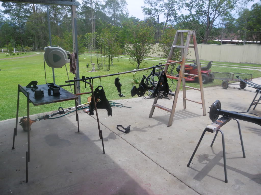

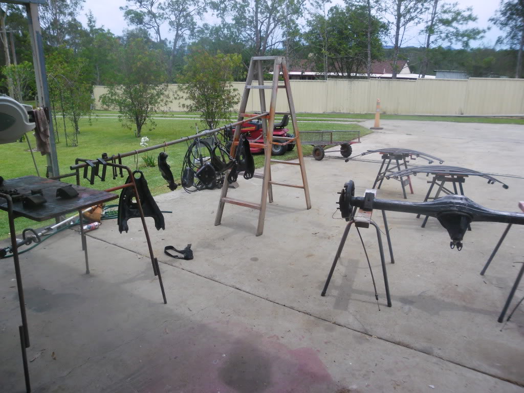

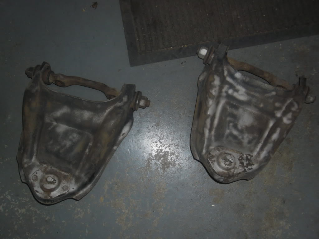

Chassis is now painted, had a go at sandblasting to wishbones i think i need a little bit pactice or the blaster needs maintance.
Danny
#56 _Quagmire_
Posted 24 November 2012 - 08:20 PM
get down and dirty with it....
it's not a bonnet it won't warp..
and next time remove the ball joint if you intend to reuse them
those ones are probaly fuked now...

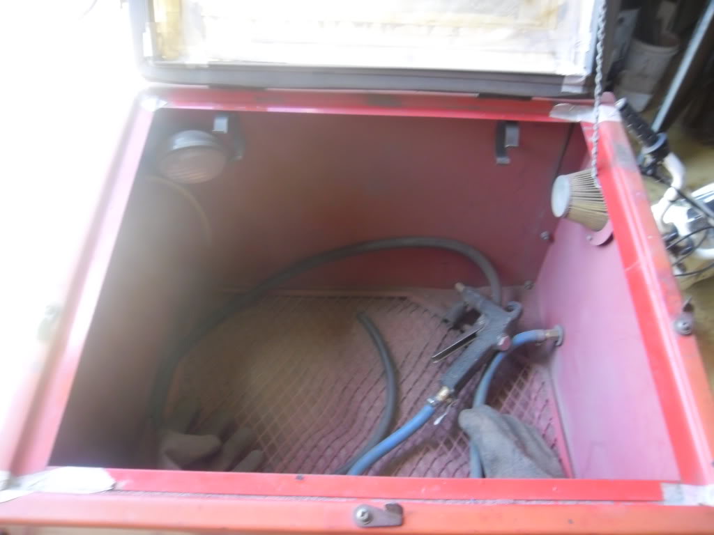

Started doing the Bottom wishbones today, didnt get very far as the suction line came off and I couldnt find any duct tape so i had to hold it, then the air line blew so ive got 125psi coming out the end of the hose than the compresser revs up (15hp petrol motor automatic throttle) so i had to turn it off than grab the hose because there was i tap on the end, maybe i should of just unplugged it owell, then the car battery was geting low the powers the little so i had to blast blind. all in a days fun.
justa few pics. not much room once there a wishbone in there.

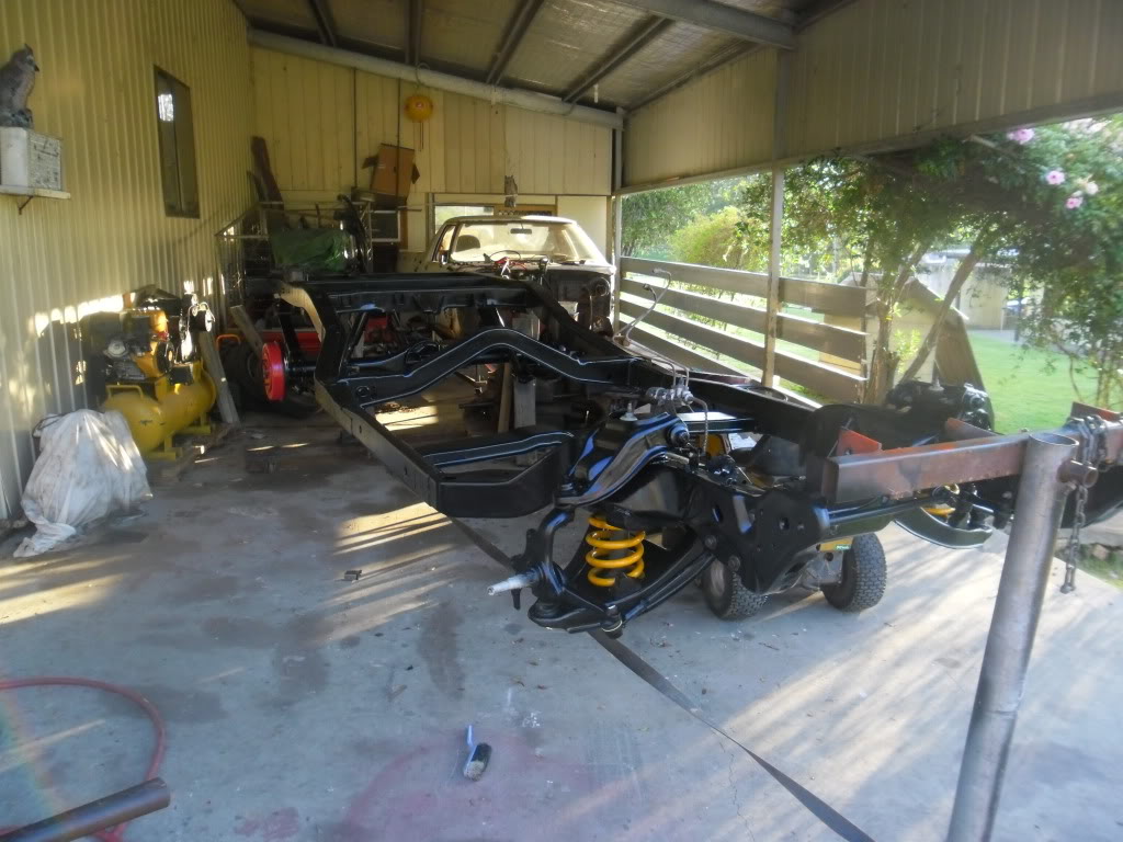

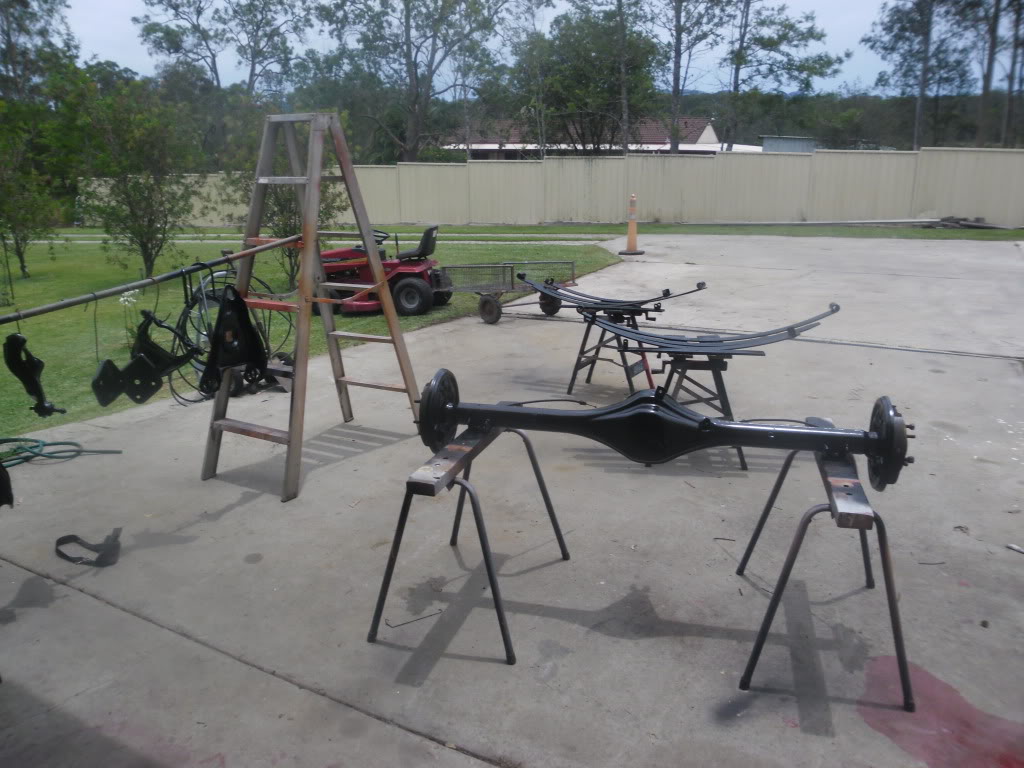

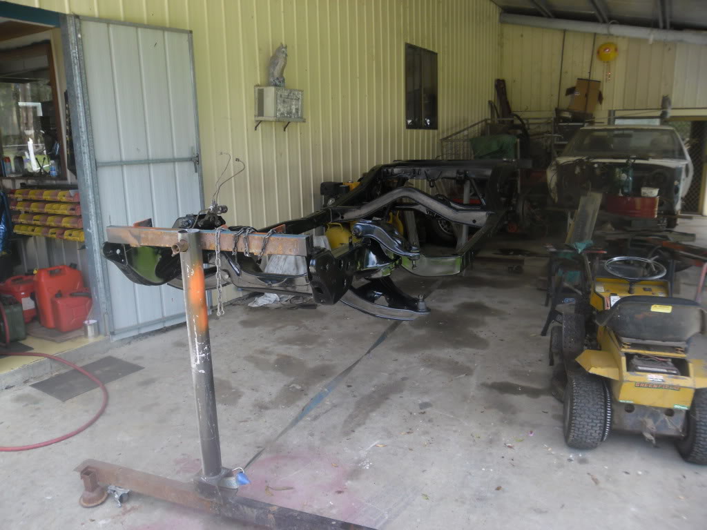

#58 _Macca75_
_Macca75_

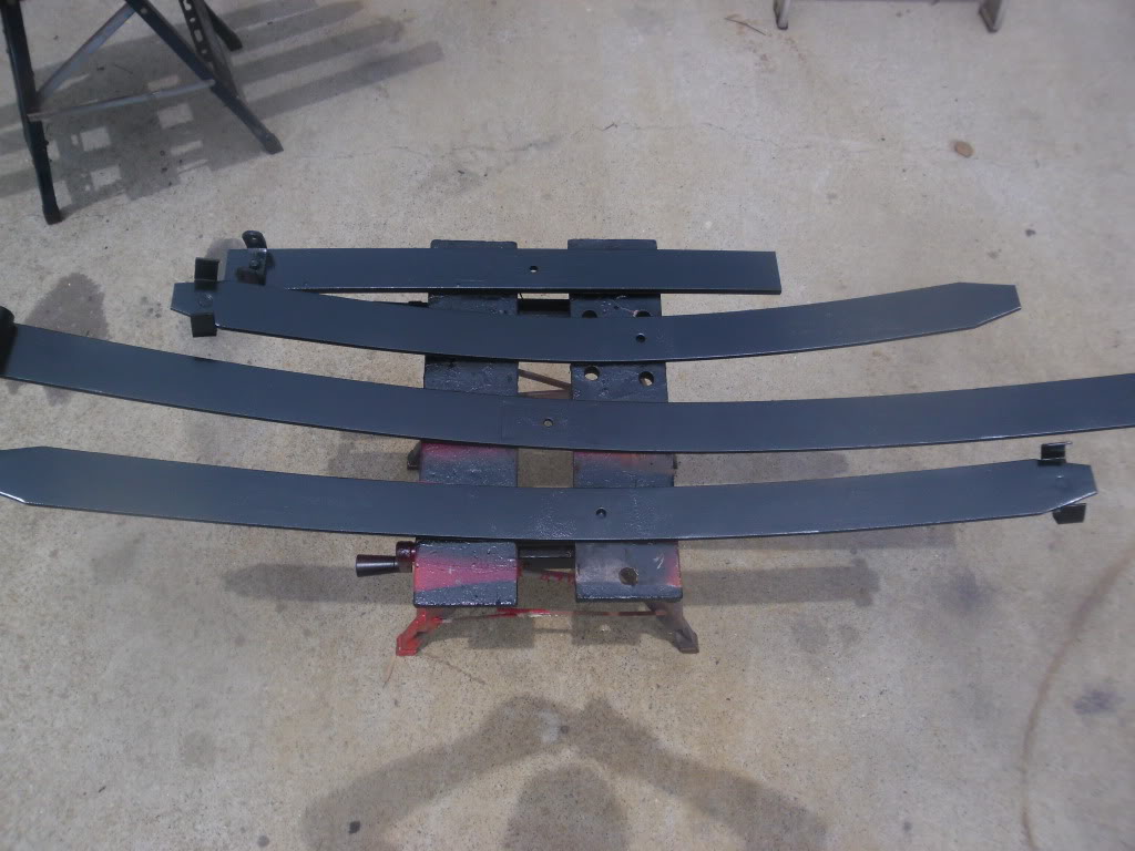

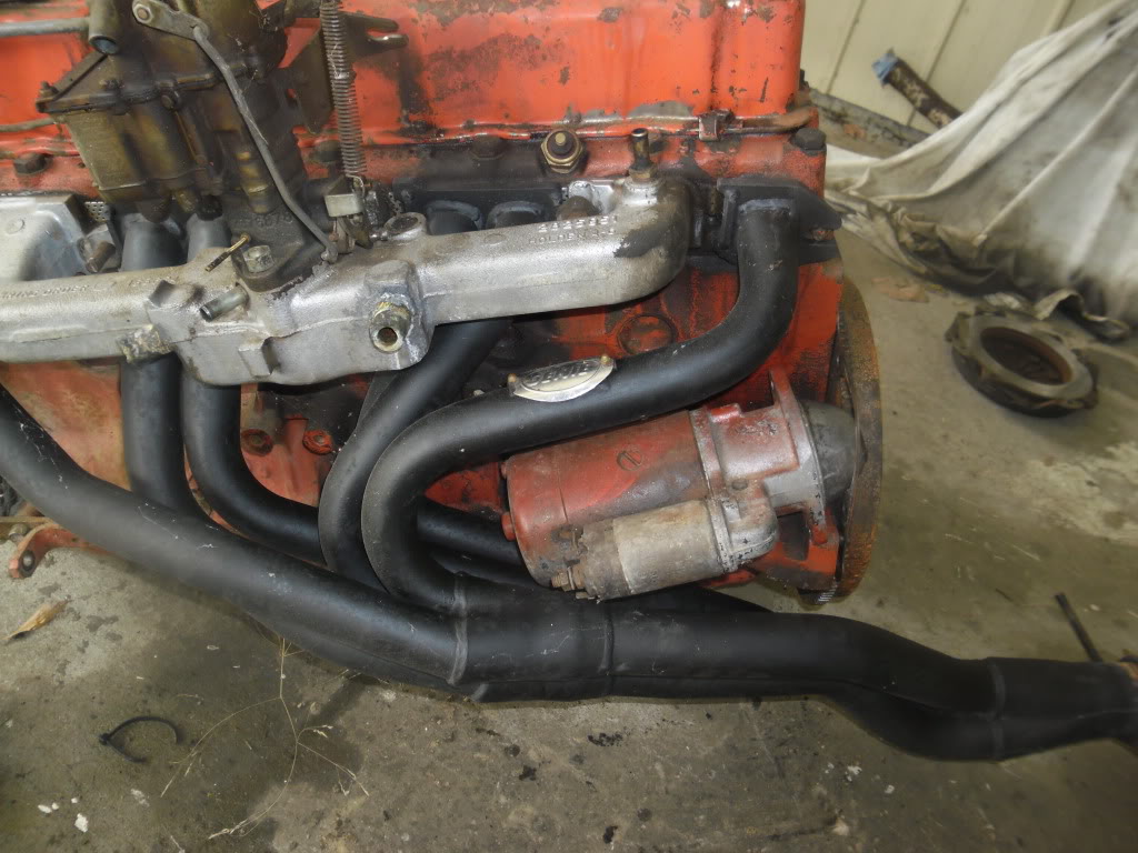

Posted 30 December 2012 - 01:13 PM

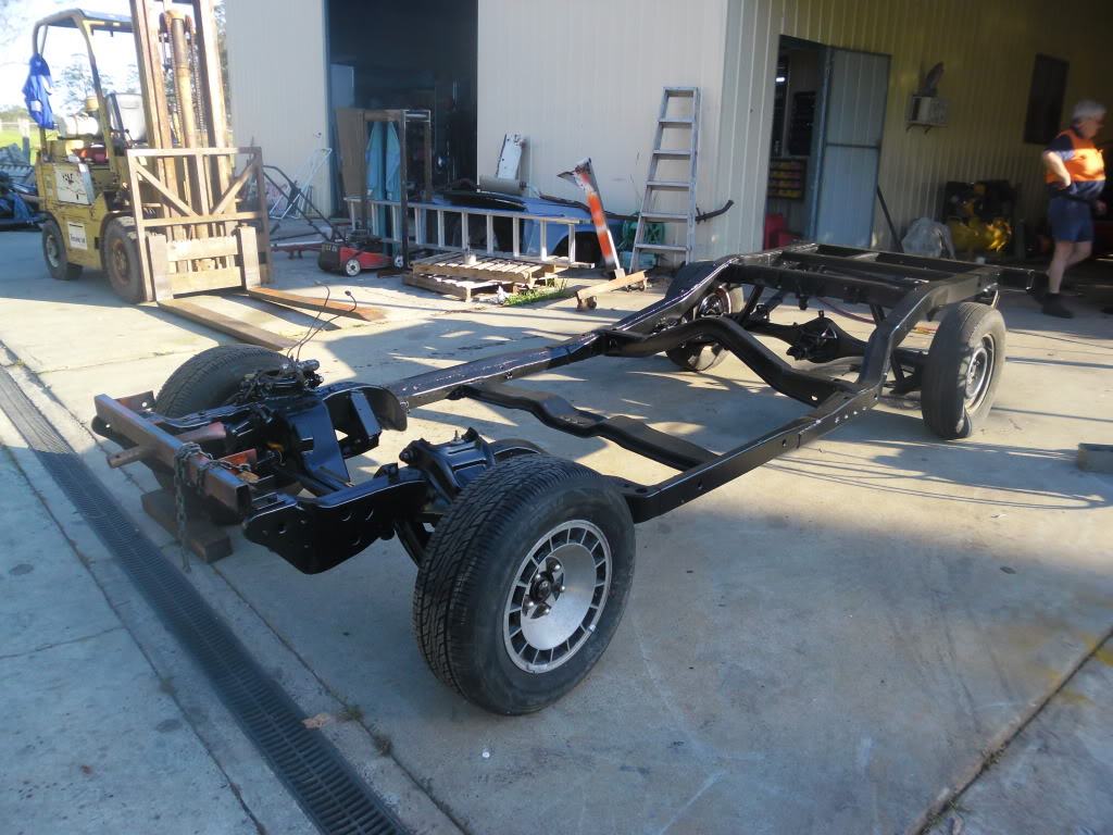

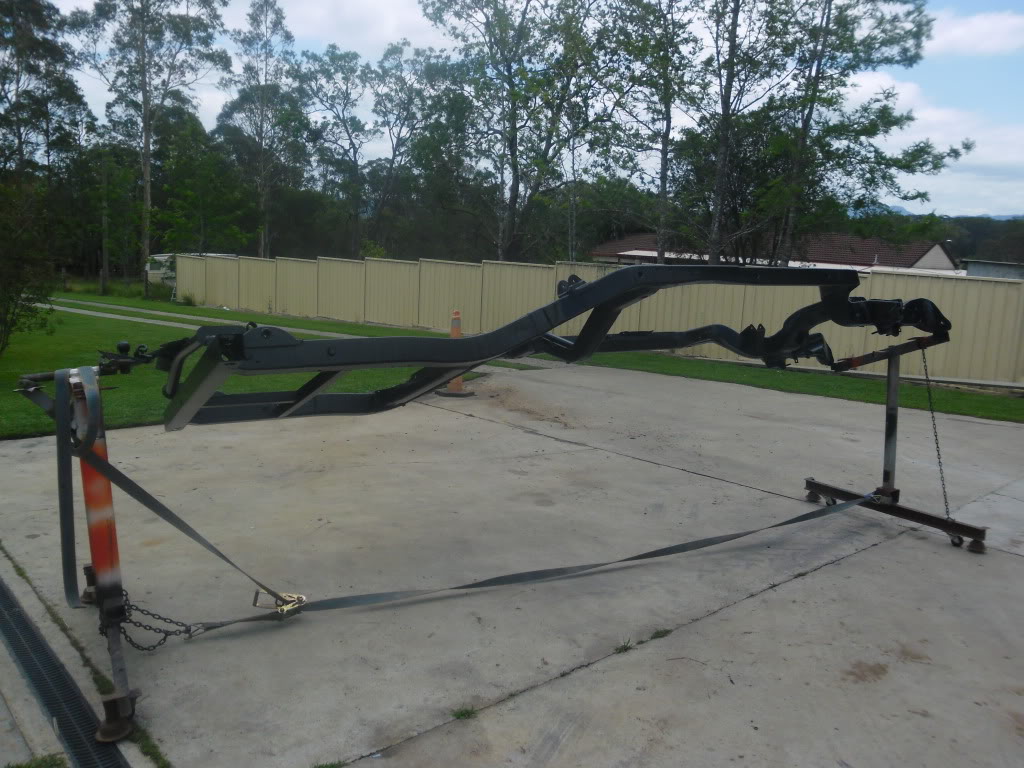

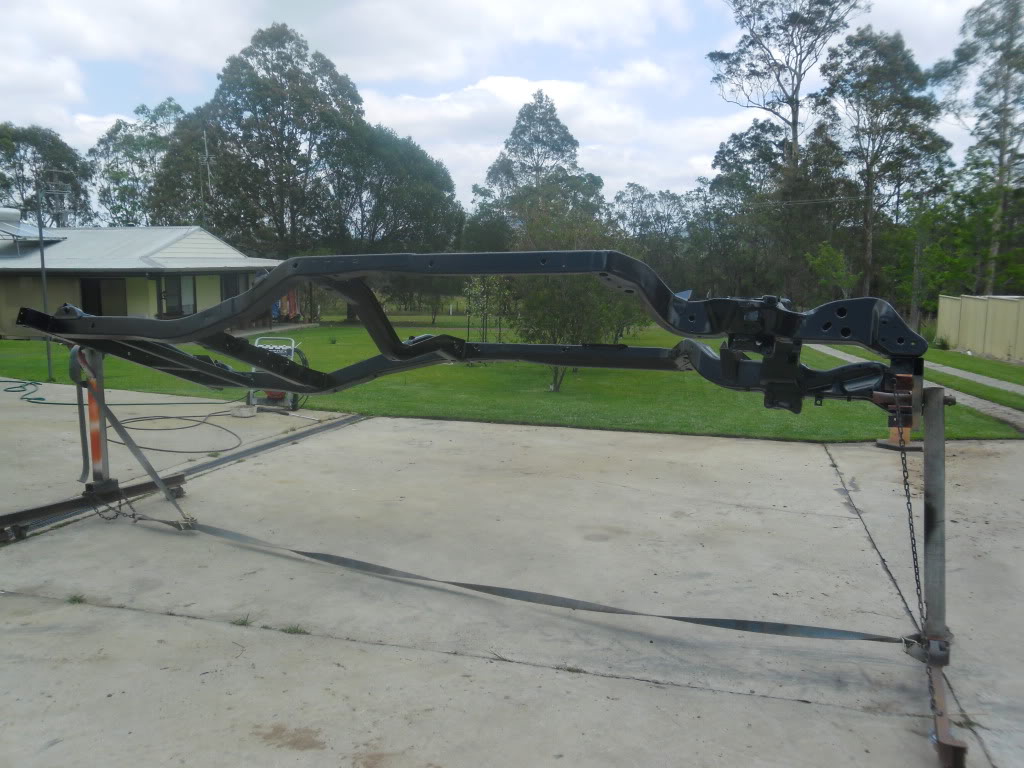

well ive done more work in the past week than I have all year
everything ready for paint
everything painted
i pulled all the leaves apart.
chassis starting to get there
ive got suspention :)

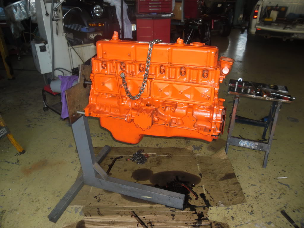

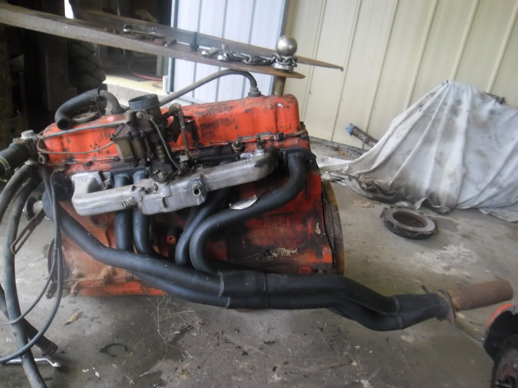

stripping the motor down so I can paint it, but i just had to see what the extractors look like. :)
can still get the original starter in and out.
Danny

#61 _Macca75_
_Macca75_
Posted 01 January 2013 - 01:43 PM

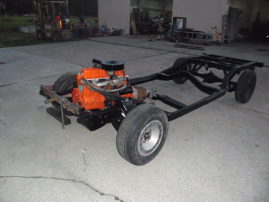

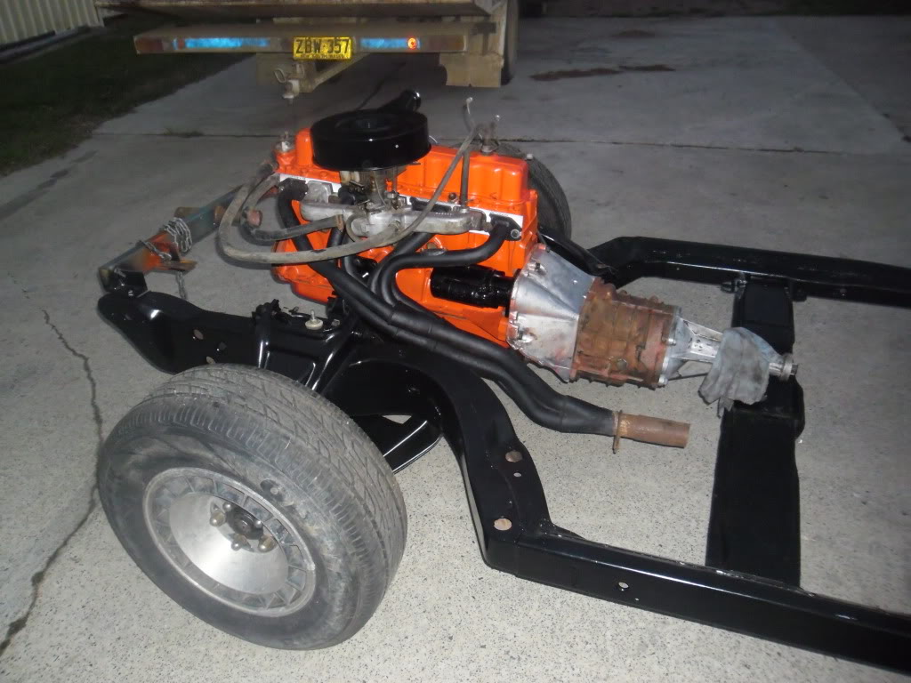

the goal was to have the chassis rolling by the end of the year, well at 7pm new years eve it was sitting back on its wheels :)

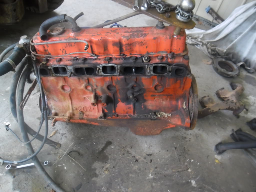

motor starting to get there

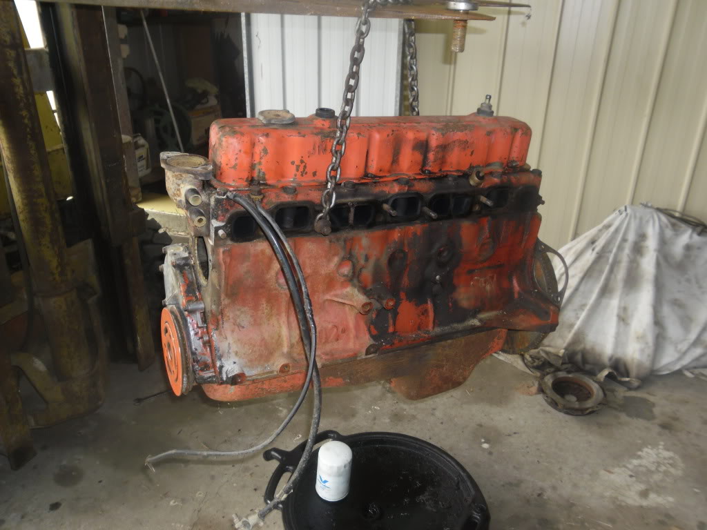

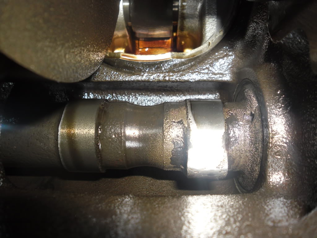

had some fun, tiny bit ok masking tap went down the dizzy hole just after we started painting so, had the sump off to get then found that no.6 ex lifter is starting to dig into the cam, should last abit longer with just a full set of lifters.
Danny

I wouldn't replace those lifters if you don't plan on doing the cam, probably more likely to chew it up that way

thanks, so maybe i should just leave it until it wheres out than throw another motor in/ rebuild it, ive got 2 1/2 sitting around here somewhere.

Personally I think that would be a better idea, a new set of lifters would need to wear in and can often cause damage to a cam in good condition if not done perfectly. It depends on what sort of damage you're talking about as to how long it will last; if its too dry of oil it may dig in on first startup and trash the cam lobe or it may last forever, but general rule of thumb is don't put new lifters on a worn cam.

Posted 02 January 2013 - 12:32 PM
there not the best pics, the flash on the camera didn't want to turn off.

i'd put a new (mild) cam and lifters in
not hard while it's out
#67 _Emu_
_Emu_
Posted 02 January 2013 - 03:16 PM
Replace that cam bro....she's gone.
It will chew out very fast now

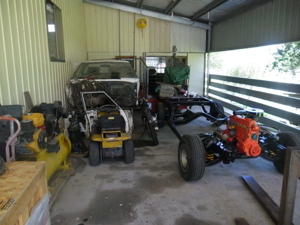

well motor's in chassis, we just needed it out of the road as we gotta get some work done to get the all important money, and my stupid tax file number hasn't come yet so I'm starting to look a bit short.
had a clean up so dad can put his Ute undercover.

I agree, if you value that engine it needs a new cam

$250 or so for the dynotech type cam and lifter combo's on Ebay, either get the 208@.050 or the 215@.050 version. Dont frOck around just do it :P

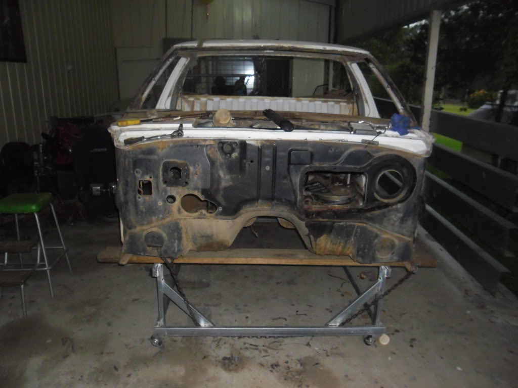

Chassis is finished so its now sitting in the corner, and now the body work can start.

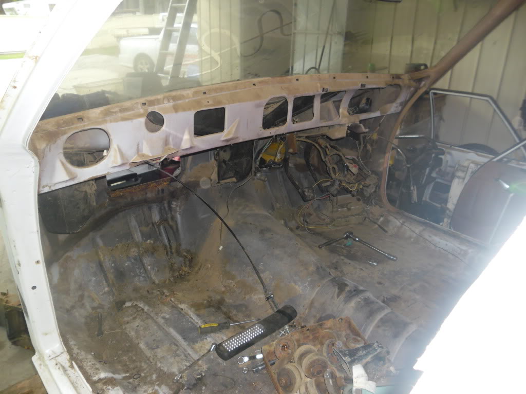

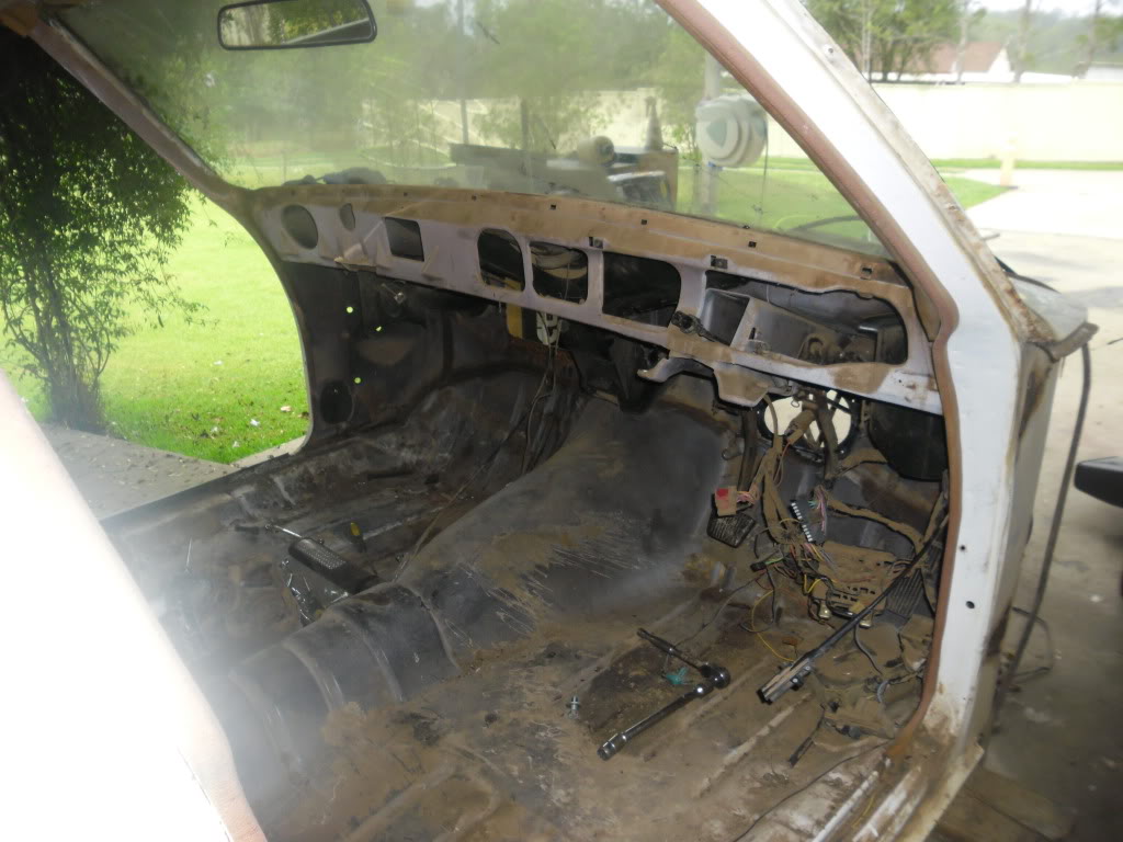

#73 _Macca97_
_Macca97_
Posted 21 January 2013 - 09:08 AM

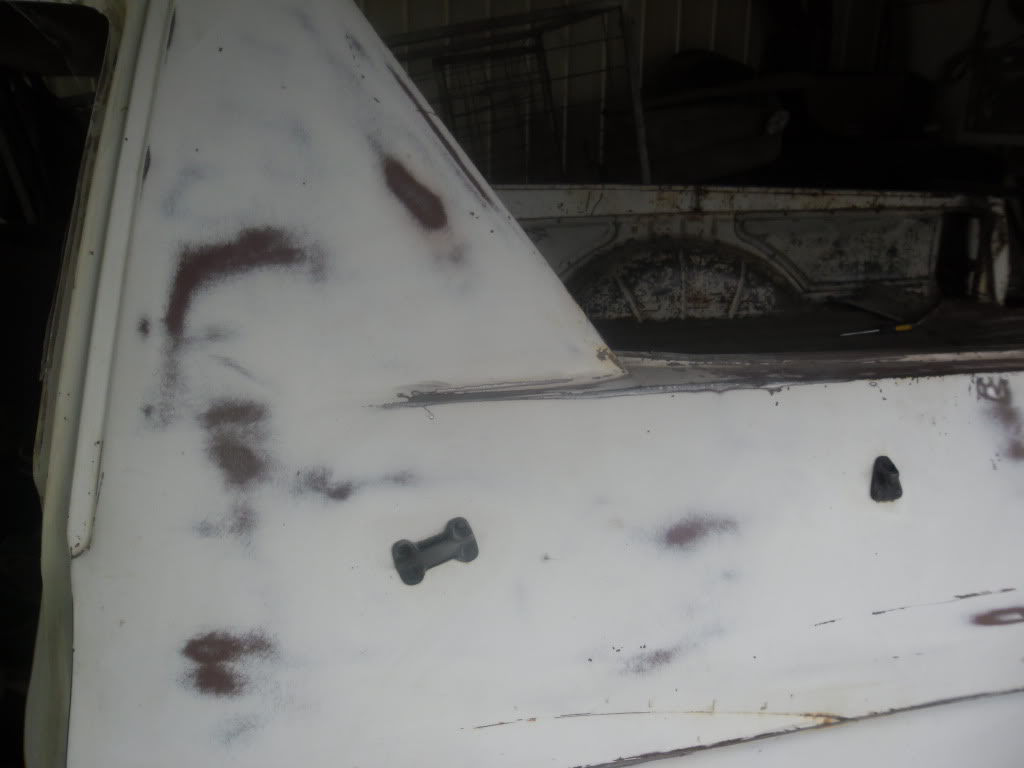

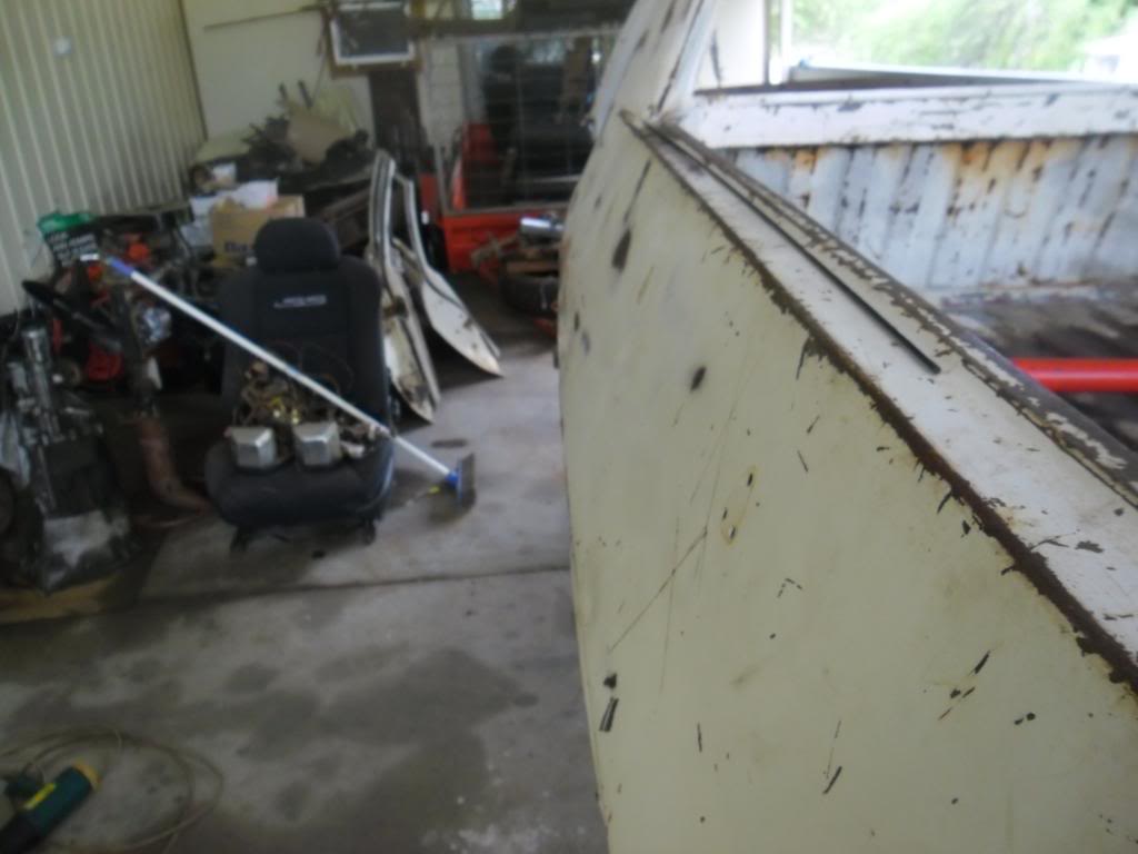

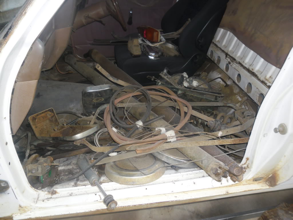

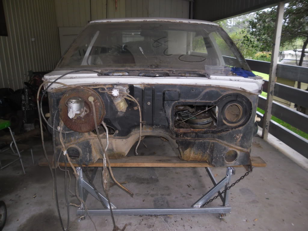

Stripped the body yesterday, I started cutting the windscreen ( its still the original toughened glass one) out than dad walks out with this little right angle knife that has a little draw string/pull attached to it (where the hell does he get this stuff from :/) I'm glad I've got another Ute that I can take parts of. steering column bushes, master cylinder and most of the heat box setup is all shot.
Danny

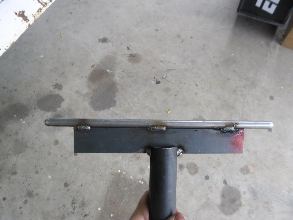

Posted 28 January 2013 - 01:10 PM
Thanks Dave, I think the biggest thanks Dad will get is when its finished and out of shed, It came from out west so maybe just being on farms, found a few 22 shells, so maybe from being flogged round a farm in the dust.
made i thingy up to pop the sides back out.
Danny
