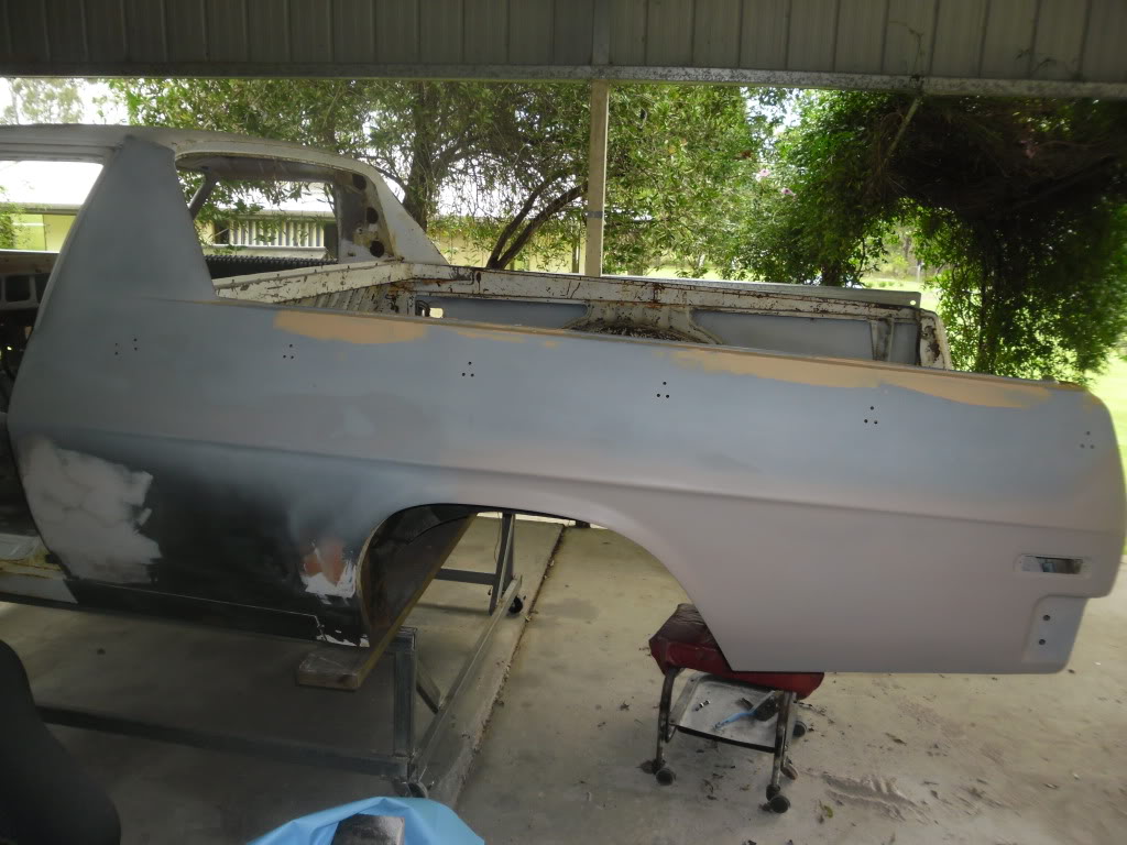

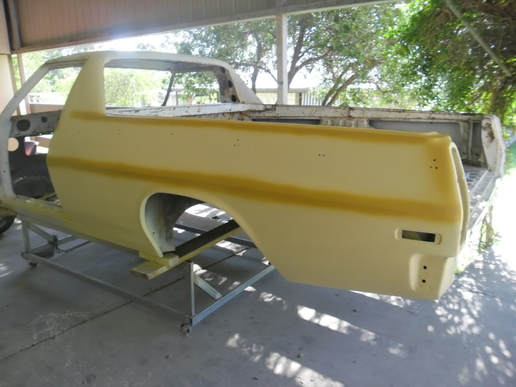

I've got the LH side back to bare metal, got the panel nice and straight and wiped some bog over it just to make it flat.

put a quick coat of primer over the side so it doesnt start to rust and so I can see the imperfections
Danny

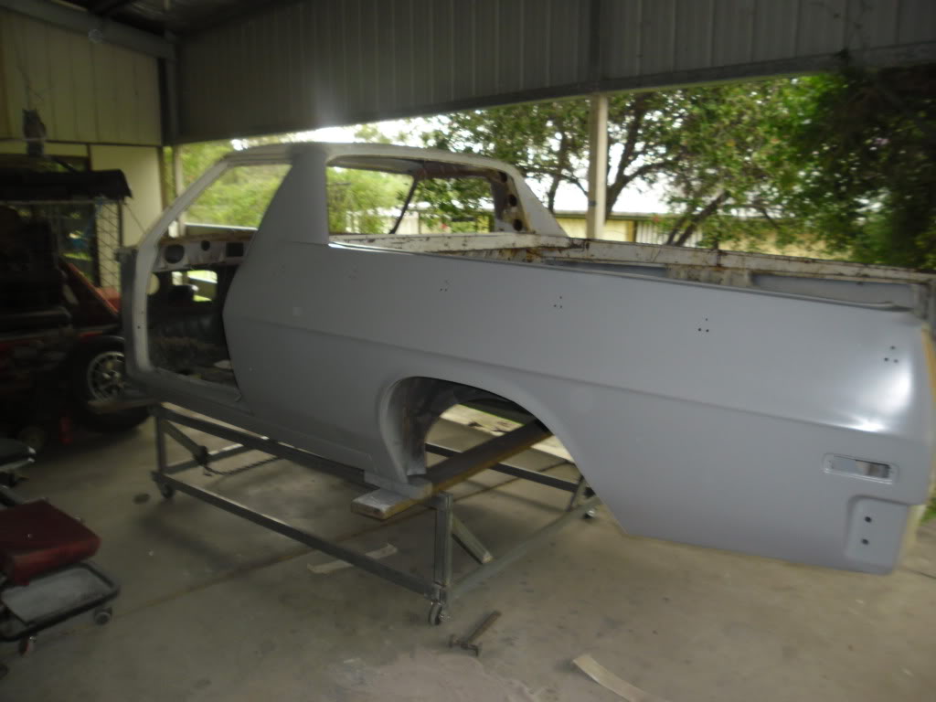

I'm using white Knight SLS etch primer.
the left side is all most done, put a few more coats of primer than rub it back again and put a final coat on.
pretty good for a 55yo mechanic (dad) that taught him self to spray paint and panel beat and a 15 almost 16yo kid that has no idea
Danny

Posted 04 February 2013 - 04:15 PM
Thanks dave, all up it only took about 4 decent days to do that side, at the end of each day dad kept asked me if i was sick of rubbing yet, just keep telling him no.
I've already got the colour picked out, found out its a factory Torana and HQ colour.
Danny

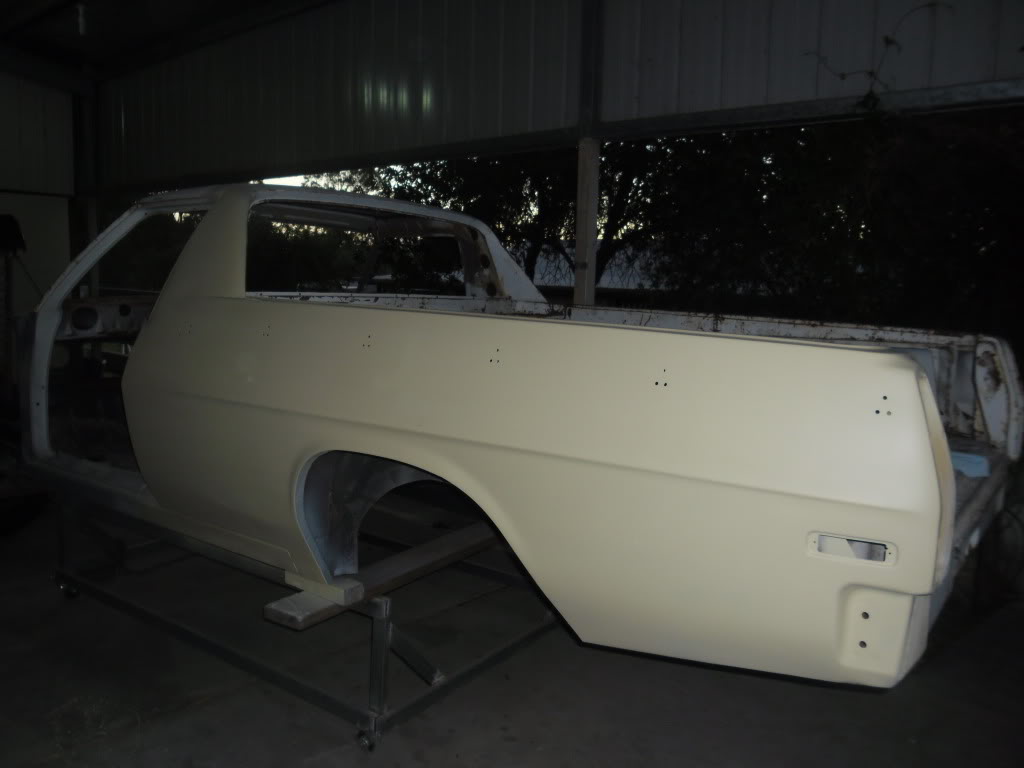

First day at tafe was today, was pretty good. the tafe at taree has both a chassis and engine dyno, so might see if i can put the ute on it when its finished.

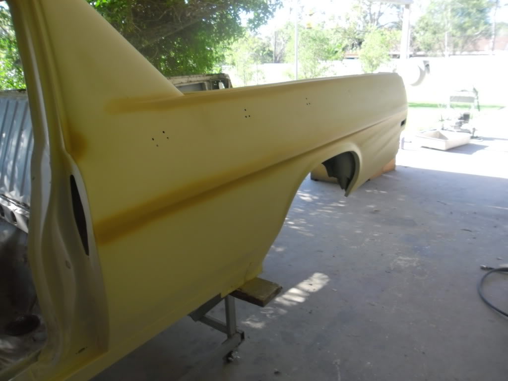

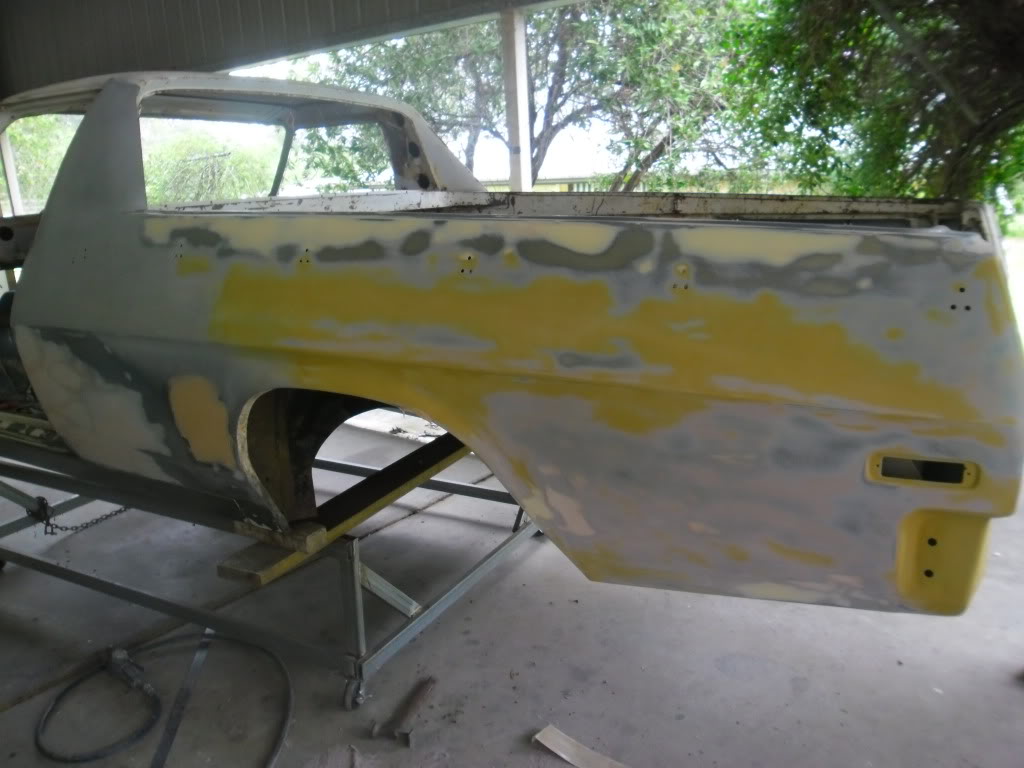

did more to the ute, rubbed the top off the grey primer and sprayed primer filler on it.

thanks dom. across the back where the number plate goes is done, and the other side is all stripped back to bare metal, trying to get all my school stuff done so i really get into it.

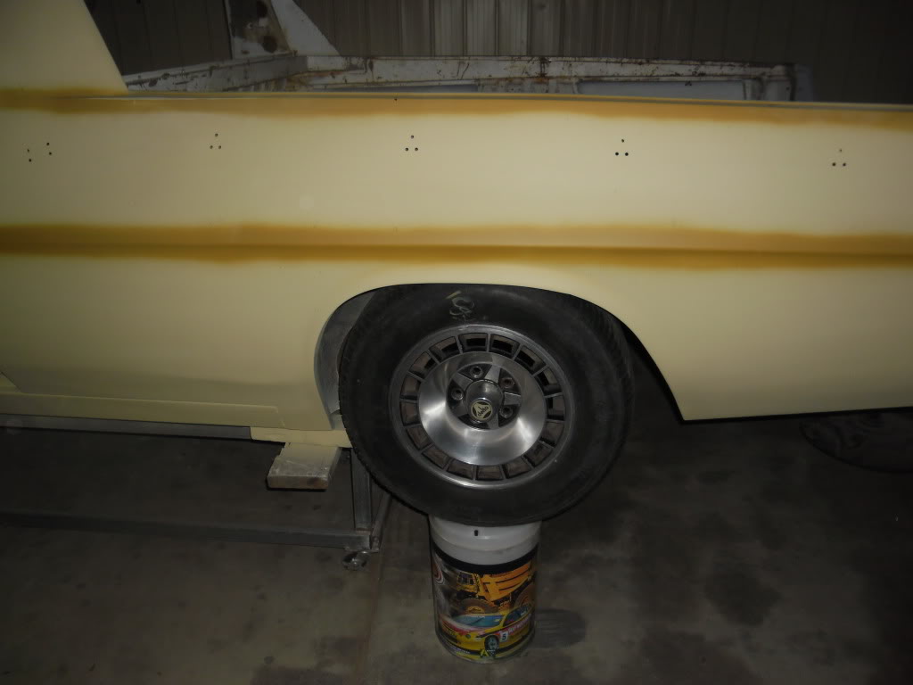

_Macca97_
Posted 28 February 2013 - 08:00 AM
put the wheel on a drum just to see what it would look like.

Posted 28 February 2013 - 01:12 PM
Cool rims. But you could use a shorter drum. Don't go the 'not low enough' route. You won't like it.
#95 RIM-010
Posted 28 February 2013 - 08:06 PM
You reckon that that's too low? It's not a Hilux haha

Posted 01 March 2013 - 12:46 PM
I mean the rim in relation to the wheel arch ya nong! :fool:
#97 RIM-010
Posted 02 March 2013 - 08:58 AM
I realise that, ya nong! Looks like it's tucking just the right ampunt of tyre to me :)

yer its to far up the guards for my liking, dirt roads and low cars dont work, i'm using the same rear springs, because they were sagged a little, and i got a set of front ones that are about 1/2 inch maybe an 1inch lower than standard for mowing a mates yard, so I should get a decent stance.
also picked up a vs commodore thats rooted but the motor is ok of a mate for all the roller rockers, valve springs and anything else dad wants off it.
Danny

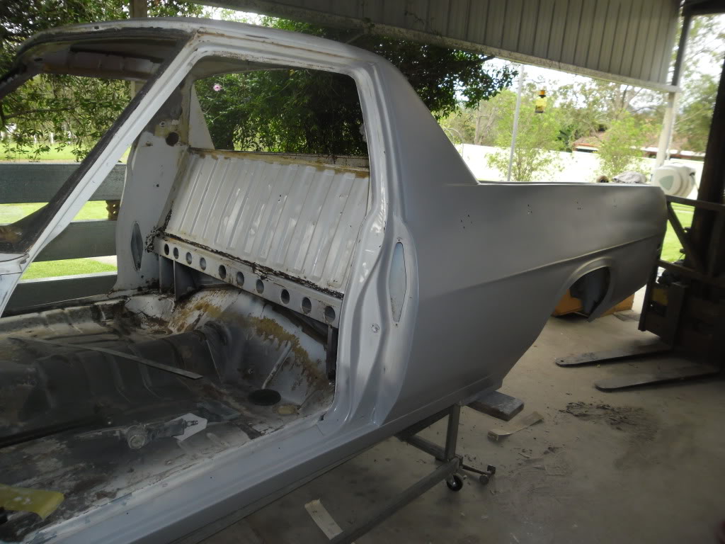

Posted 18 March 2013 - 10:45 AM
right side now has its first coat of primer on it, dont have any pics of doing the body work as we couldn't find the camera,
and added another vk 5 speed to the colection (dad paid for this one)
