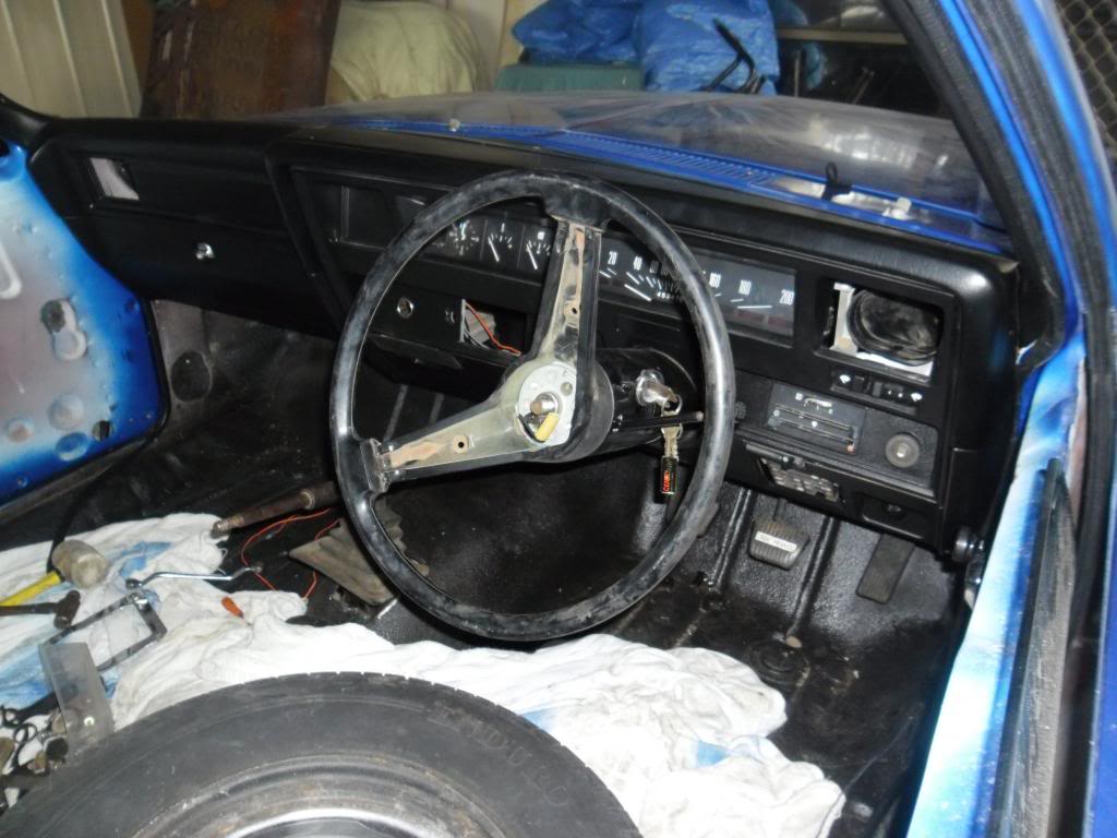

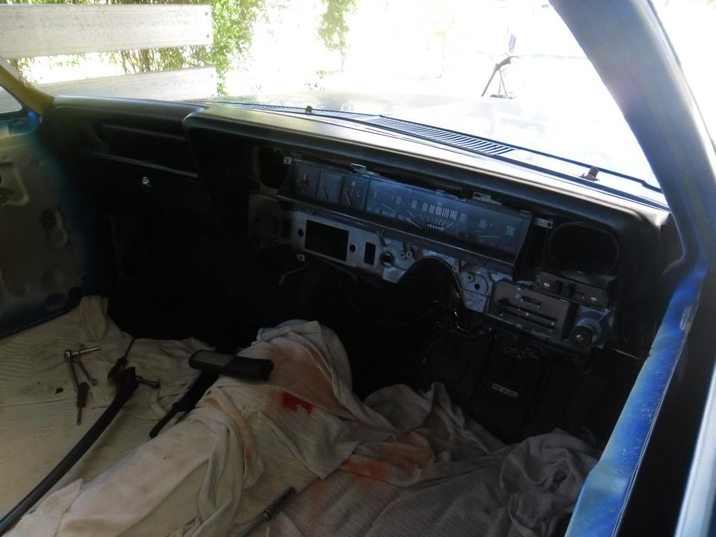

Posted 08 February 2014 - 01:01 PM
slowly putting it back together, heater is in, most of the dash is in, spent a few hours mixing and matching the 2 gauge clusters so i could have the clock and temp gauge, while keeping the idiot light for the temp as well, ill just have to run an extra wire for the sender, starting to get there.

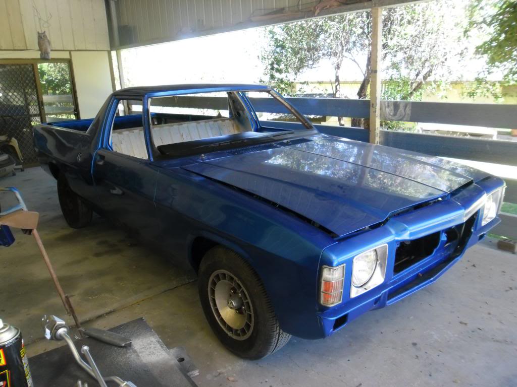

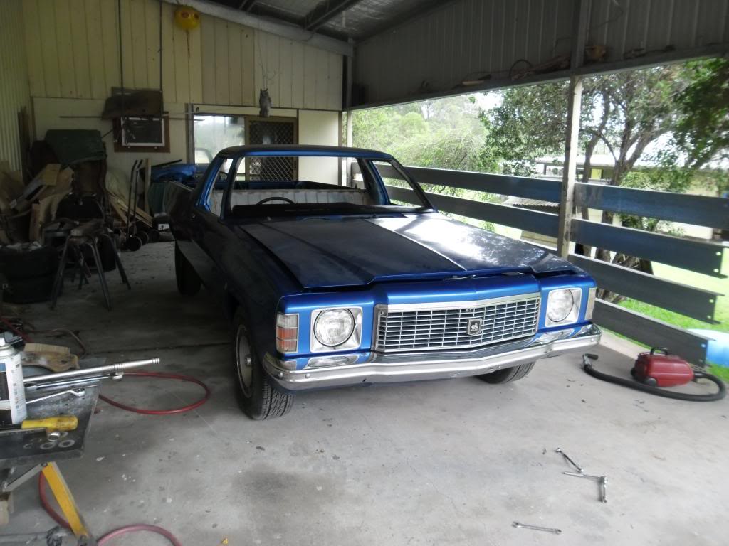

Posted 27 February 2014 - 04:05 PM

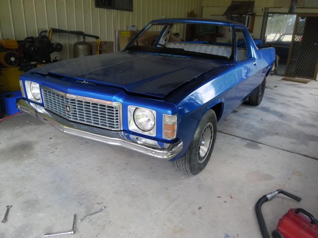

got the rubber kit so ive put door glass in, they go up and down aha, all electrics work, well after about 4 hours they do, motor runs like a charm after a quick turn of the dizzy, starts first hit, no choke or pumping it, just waiting for hood-lining still.
grill turned up great, primed with plastic primer than painted with silver/grey wheel paint, bumper bar came up with some wheel cleaner.
still just slowly putting things back on it :)

cheers Jase,

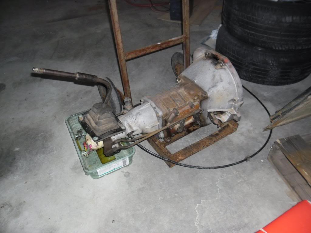

hood-lining turned up today, will hopefully have it in over the weekend, up on the hoist atm, just put the 4 speed in, and will get some new brake line tomorrow and bend up, and hook the fuel tank up, will almost be drivable :)

She's drivable, still no fuel tank or brakes but I DROVE IT :) only went about 4 metres off the hoist but it moves ahaha, 4 speed is in shifter all adjusted up, clutch is good. put the mags on the back, will have to lower the ass as it looks abit like a 4x4 ahah, putting hood-liner in atm. dash is all in. just need a kit for the master cylinder and ill have brakes :)

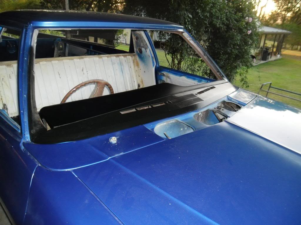

cheers Dave, can have the front screen in but its a pain pushing it into the metal strip, havent cut it out of the other ute yet either aha, and rear window helps hold liner in.

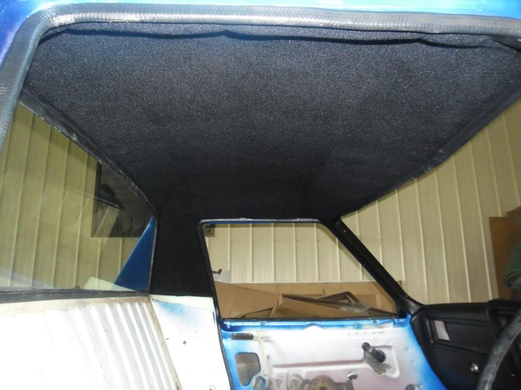

Posted 03 March 2014 - 09:32 AM
hoodlining and rear window is in :), hooked the handbrake up so i had some chance of stopping it, fuel tank is hooked up and has fuel in it :).

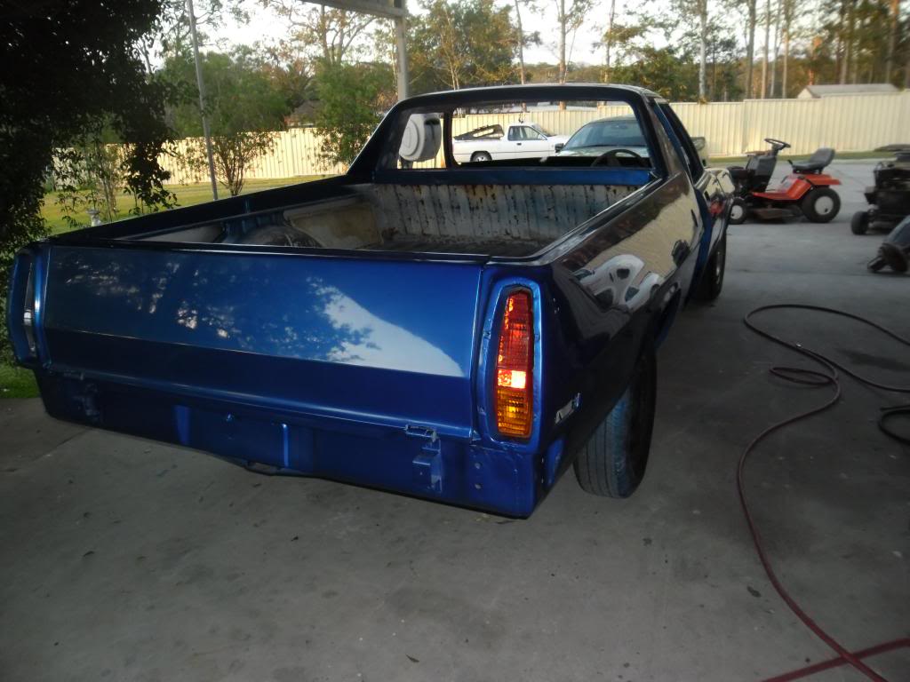

Posted 04 March 2014 - 07:11 PM
sure am Mick, just need to keep doing little things to it

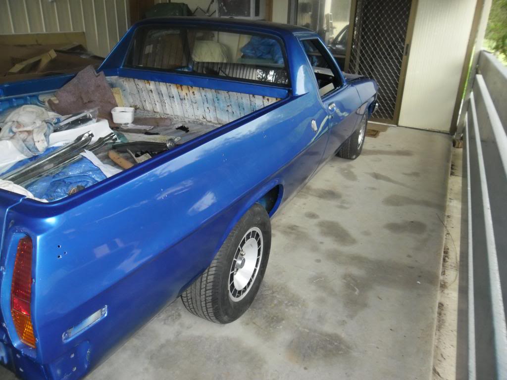

well heres some pics,put the seat in so i could see and went for a drive down the driveway and back (80metres), still no brakes, got it up to about 50 in second, loving the hole in the floor with the exhaust noise coming straight up through it :) got the rear bumberet thingos on to :)
see what i mean by looking like a 4x4^^
Danny

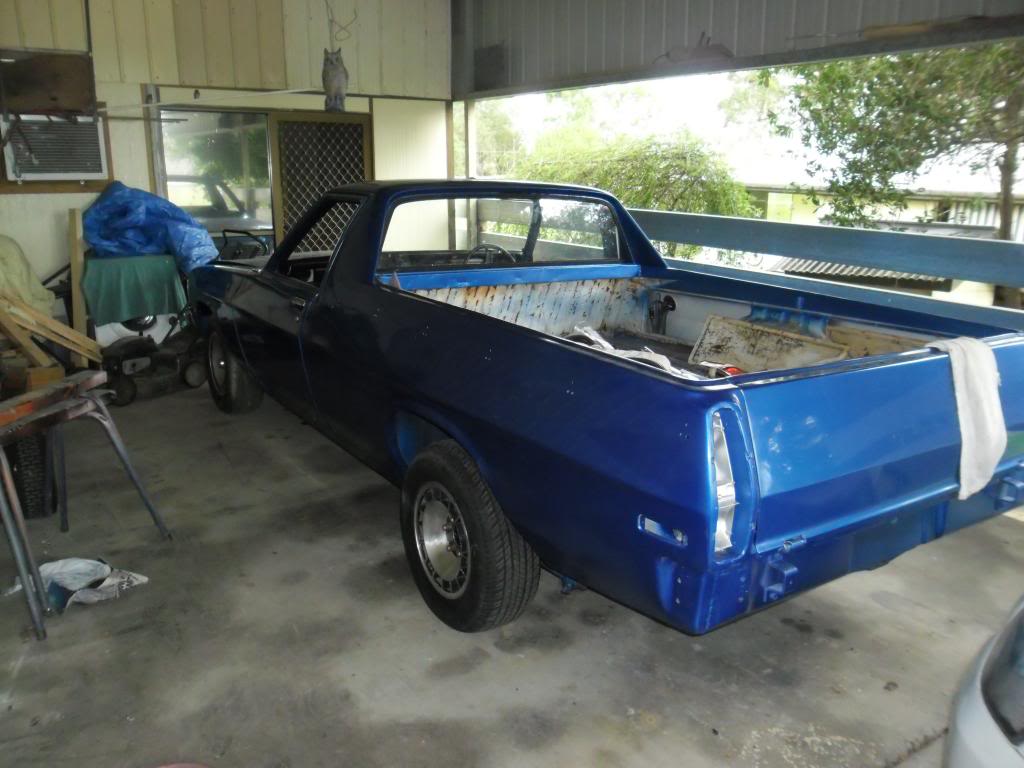

also, spray some blue below the rear window too. Dave I

getting some vinyl to go there dave, cheaper than blue paint :)
