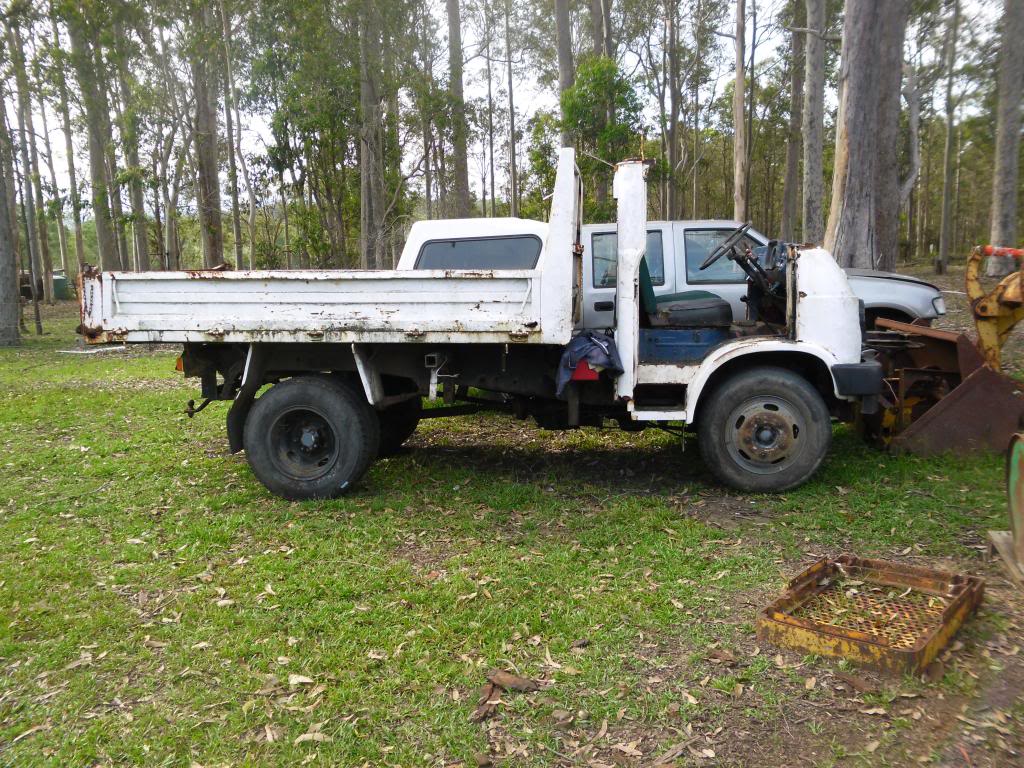

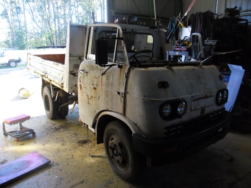

bought a new toy to use around the place since we wanna extend the shed out another 6x18 will need alot of dirt moved so heres a few pics
oh and its 202 powered :)
cut the doors off and what was rest of the roof

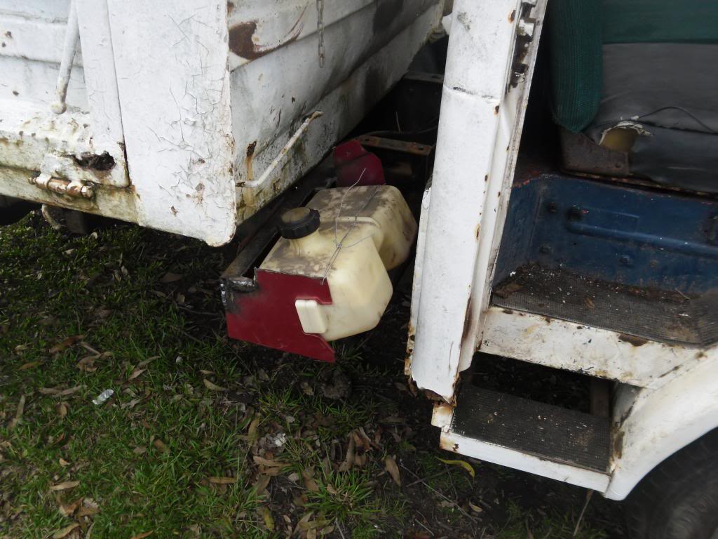

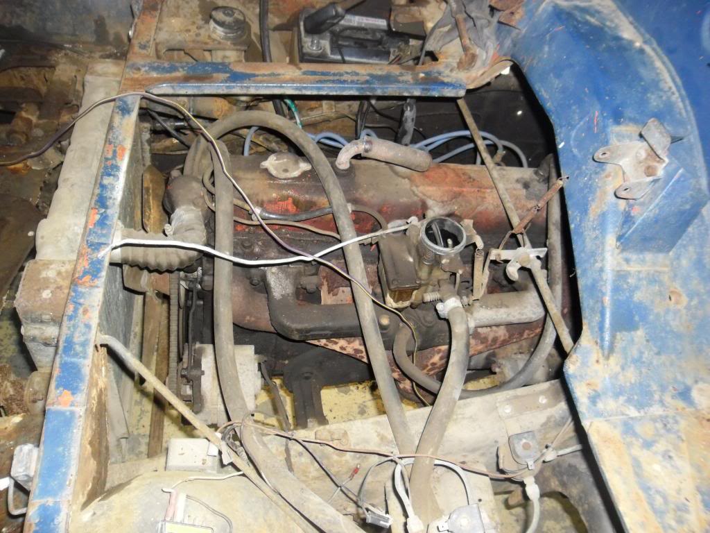

fuel down the guts and  away she went didnt sound to good but after a good run in the shed it came good
put my own tank on it so its easy to see how much it left
the tipper part works great, shes an old 4 speed on the column, gets sideways in 3rd on the wet grass. sounds good after cutting most of the exhaust off

Cheers Dave, its really lowed geared so might only do 30ks in 3rd but loads of fun. can dump the clutch in second and get it spinning :P
Had the Tipper hard at work moving big round silage bails, load of scrap steel and tried to tow my spare parts ute up the back but tyres dont have enough grip :(

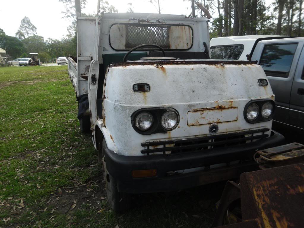

#182 Ice
Posted 07 April 2014 - 04:17 PM
Is that an old merc truck
#183 _Macca97_
_Macca97_
Posted 07 April 2014 - 05:06 PM
na its a little Daihatsu thing, we thought it was a merc when we saw the badge but someones put it on there as a joke

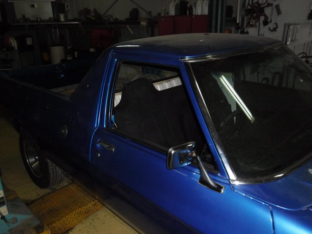

Posted 18 April 2014 - 11:19 AM
windscreen guys came out home and put a new screen in for me, love getting trade price for everything, wont need it for my p's test which is good aha
#187 N/A-PWR
Posted 18 April 2014 - 11:22 AM
Excellent Danny,
At least the Windscreen won't get any chips for a while, must feel good with a fresh start. Dave I

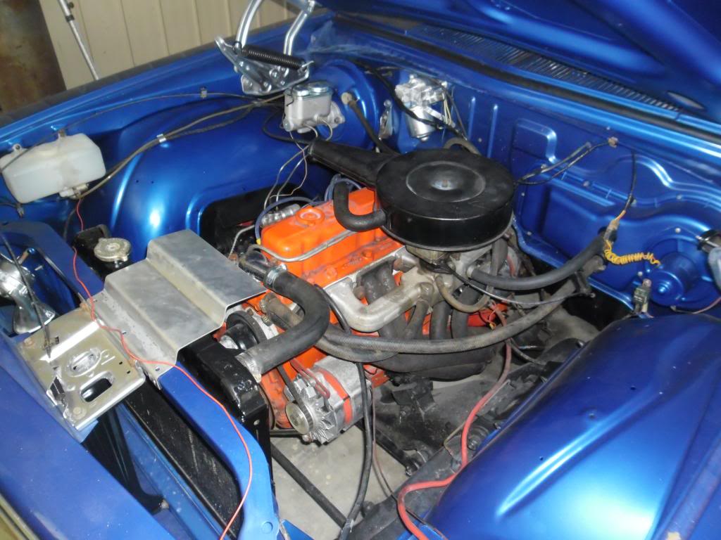

I pulled the blue motor out from the corner and put it on a stand with wheels as my plans for building a hot efi motor are starting to come together with the purchase of a vk efi rail, and with our home made injector tester ill be able to clean them up which is even better :)

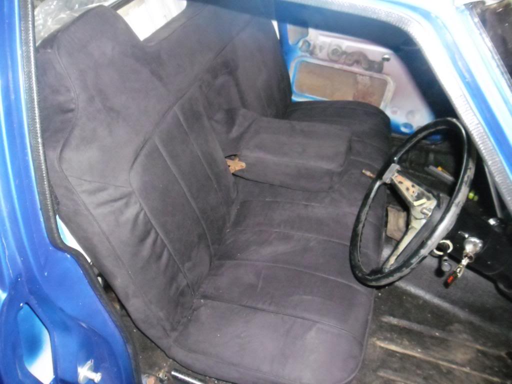

Not alot has been happening, had my birthday 2 days ago so i got my p's, been working here and there to gather some coin up.. Got the seat back and it looks a million bucks, he took abit of foam out of the back rest so i sit back abit further and a mixed and matched 2 sets of springs so it isnt sagged, At 6ft 1in the old hj is abit to short for me so with the few little mods to the seat should make it alot better :), ordered the carpet, kickpanels and rear wall carpet from truefit carpets so they should be here next week or the week after, than ill take it into the exhaust place and get a 2 1/4 system made up with a flex joint, all at trade price thanks to dad :). than its blue slip and rego hopefully :)

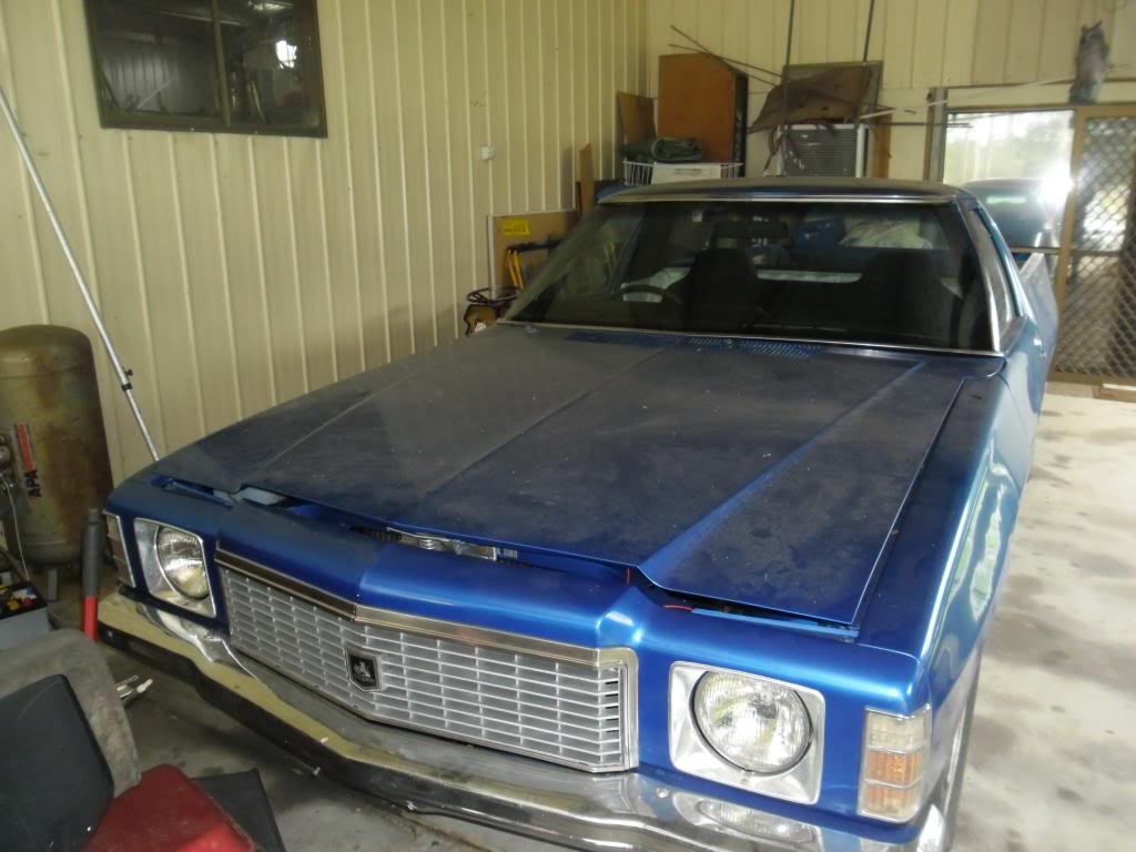

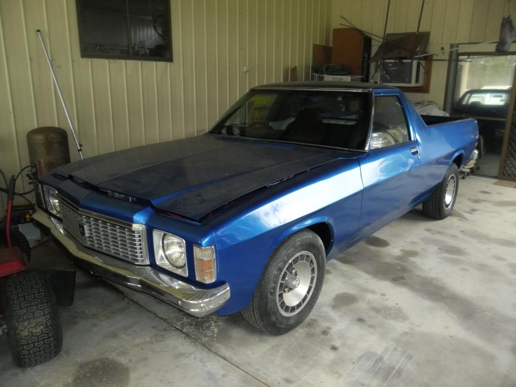

Well i thought i should take a few pics nothing special
I is abit dusty, couldnt be bothered washing it ahahah
^^^^^ My 175psi (about 11:1) monster  :D  :stirpot: :spoton:
The seat looks and feels great :) will have to get the oxy and bend the gear stick up abit as it pushes on the seat fairly hard in 2nd and 4th
Danny

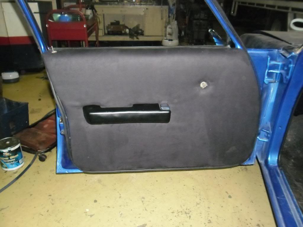

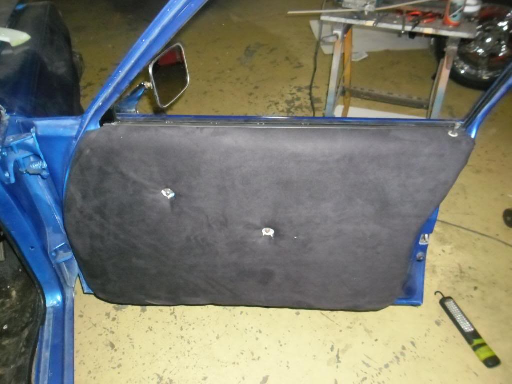

well ive been doing abit more to it, made up some door trims out of the same stuff as the seat. i used 12mm foam, which is abit on the thick side but the wiper arms dont rub and the arm rest pushes the foam away from the handle so it doesnt touch either, i might get some chrome buttons and put on them one day give a pillow/kenworth cab kinda look
The arm rests are old rough ones that came with the other ute, just cleaned them and got some black vinal paint and gave them a coat
got every colour the ute is in this pic ^^
gave the mirrors a polish, made a little plate up to go on the inside of the door with some speed cilps on them and some double sided tap so the mirrors arnt screwing into the door and when you need to take them off the plate doesnt fall down to the bottom of the door.
