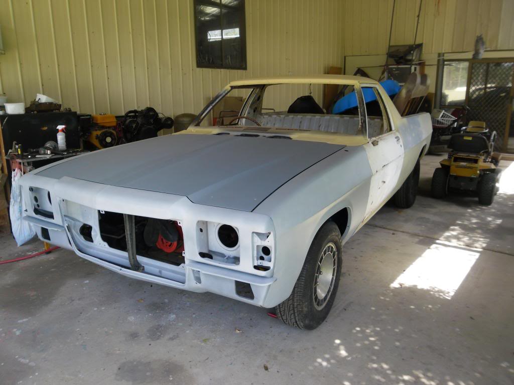

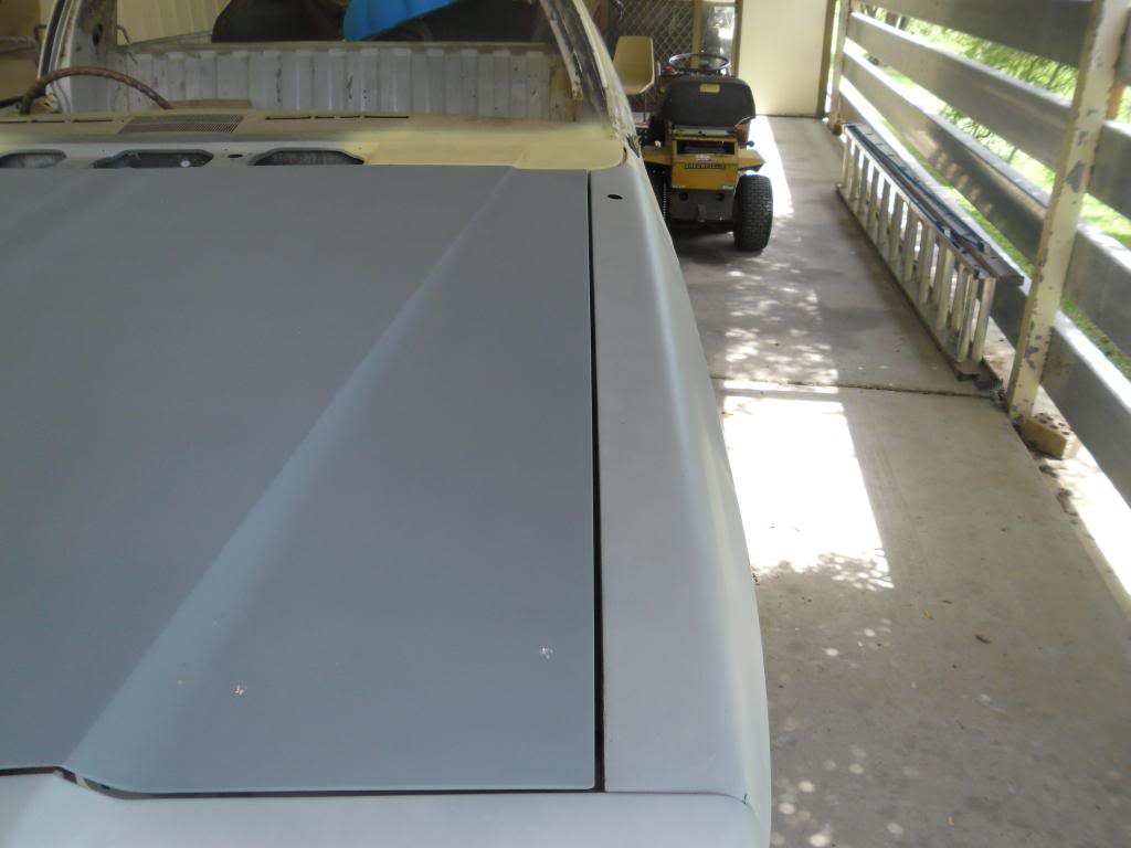

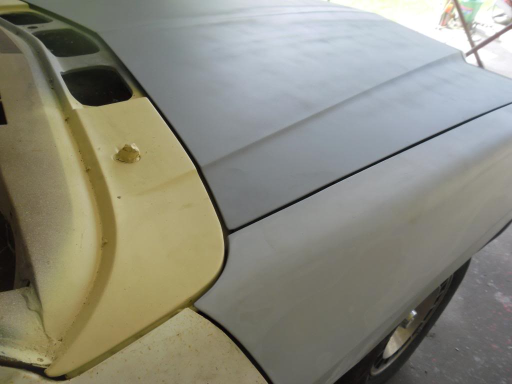

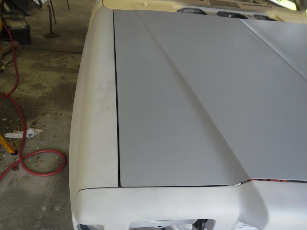

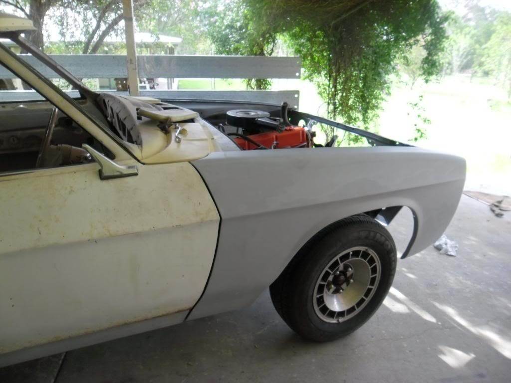

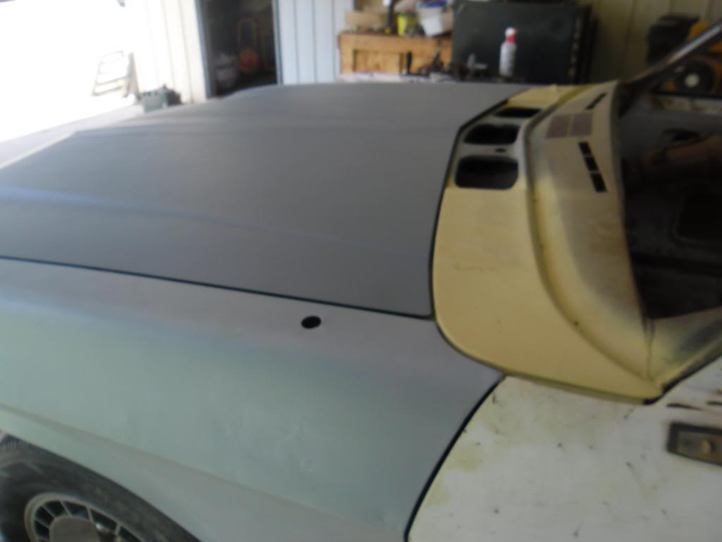

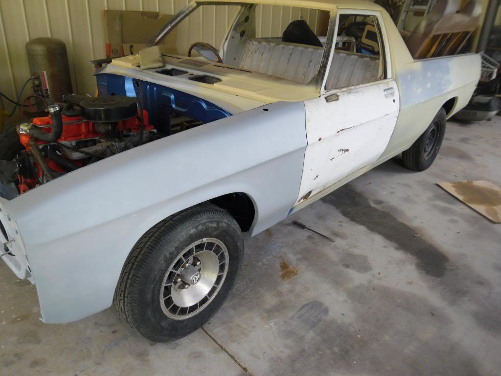

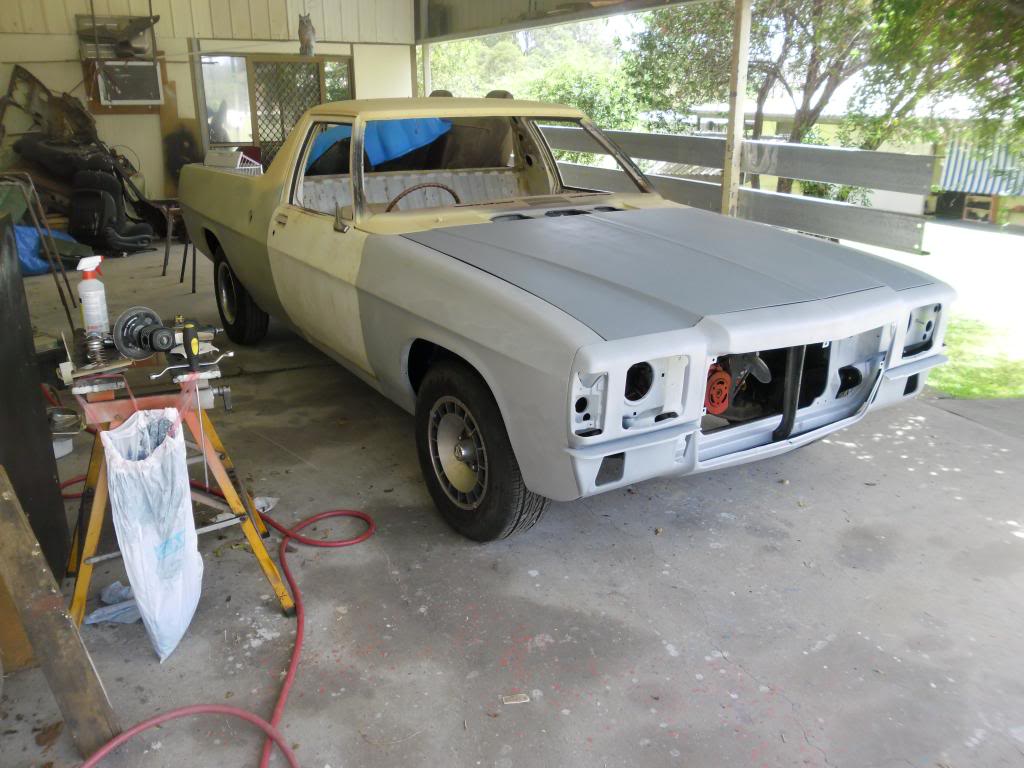

More pics :) put front panels on to see how my gaps are going, through the doors on the help get the gaps, ill weld the cracks up in the nose cone than undercoat and ill put it on, left panel has had a good hit got it fairly straight had about 1/2 inch of bog in it so ill get it straighted out better once everythings bolted up, slowly looking more and more like a Ute.

#128 N/A-PWR
Posted 22 December 2013 - 04:20 PM
Very good Danny,
A very neat and tidy unit you have there, keep up the good work. Dave I

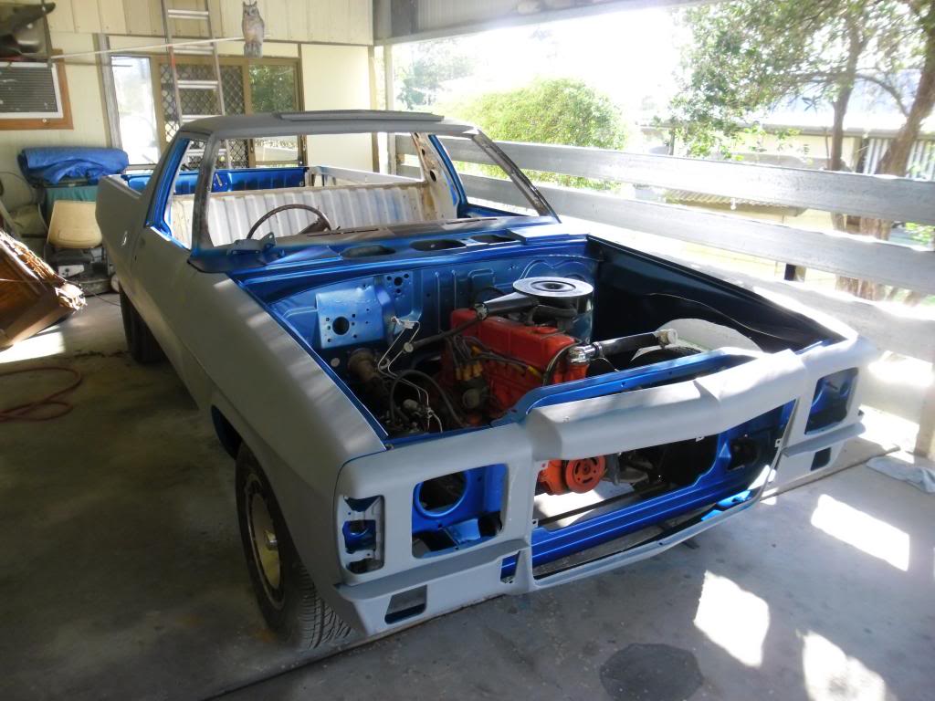

Well i've got all the front completely bolted on, even managed to lift the bonnet up by myself and bolt it up, moved everything around abit and ive got everything nice and even, the bonnet does need to go down at the back abit  but it's close :)

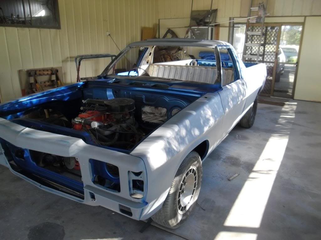

Body is in primer, just gotta prime the bonnet and it'll be ready for COLOUR :)

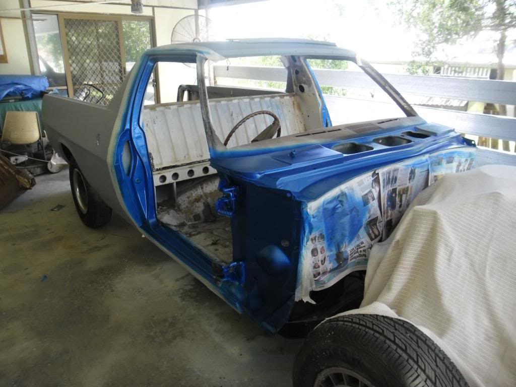

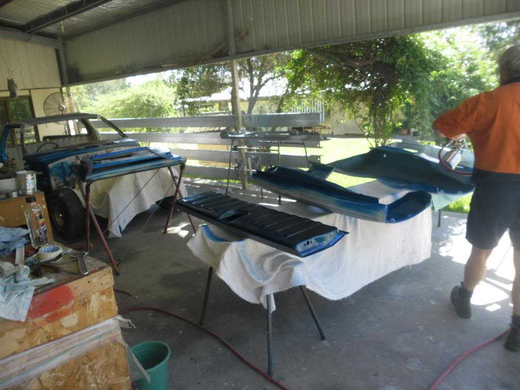

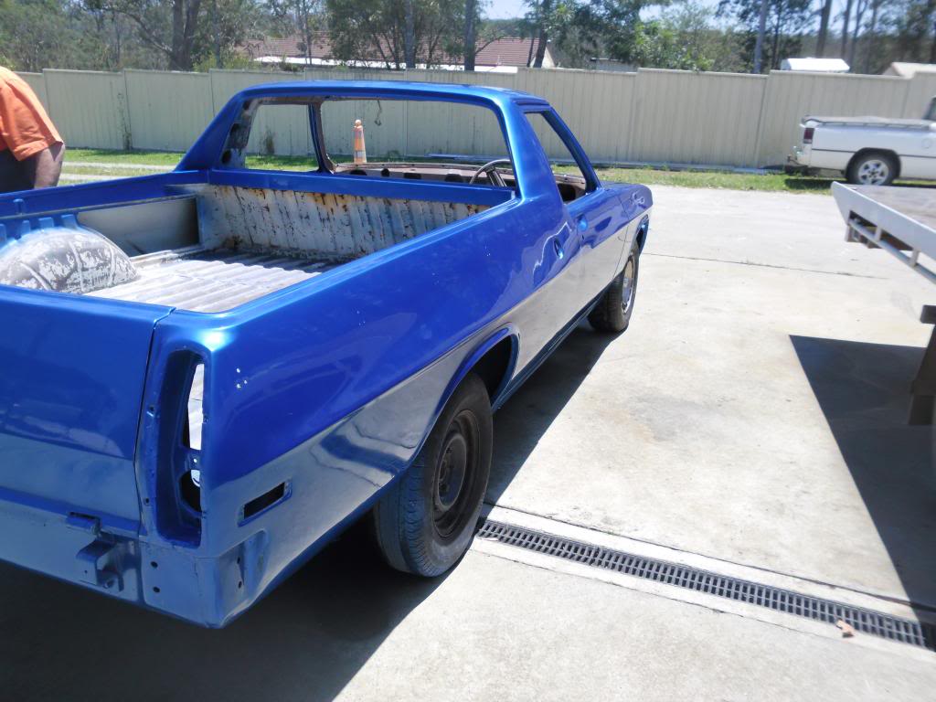

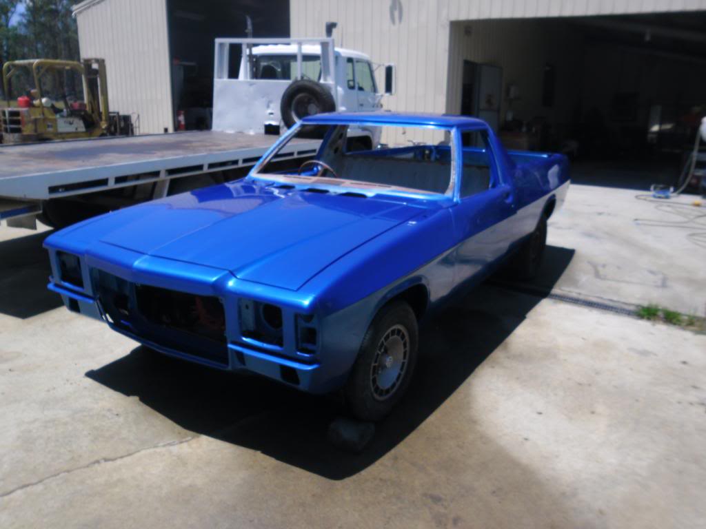

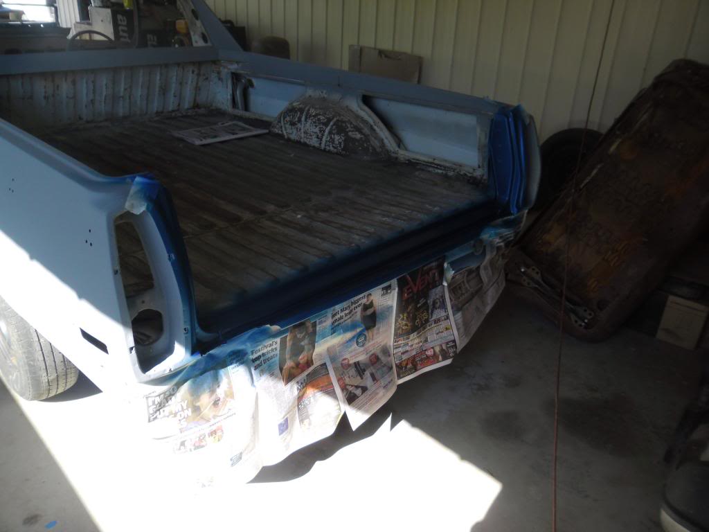

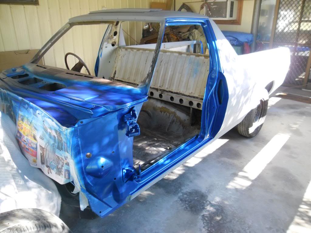

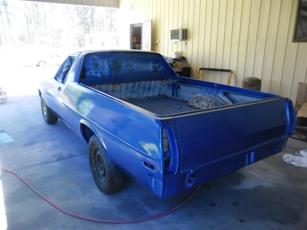

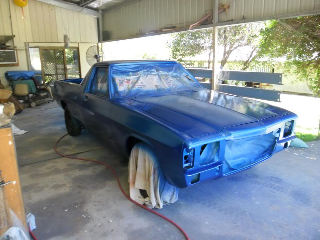

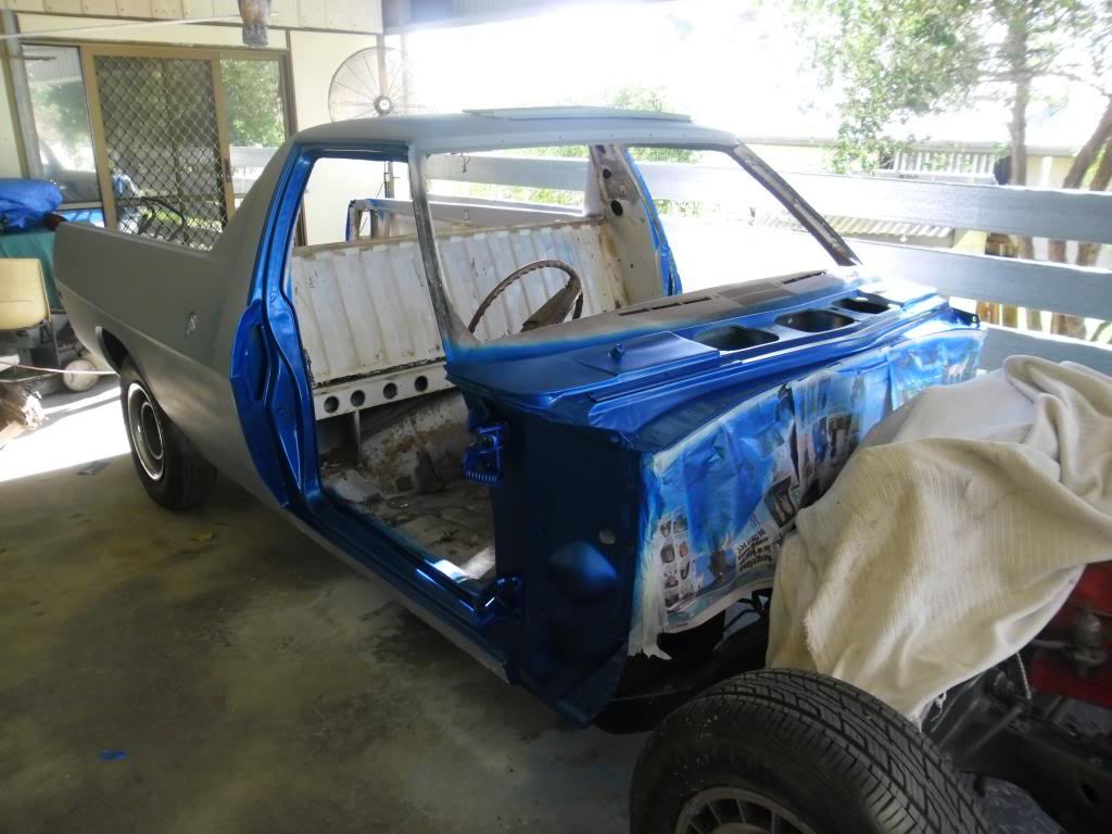

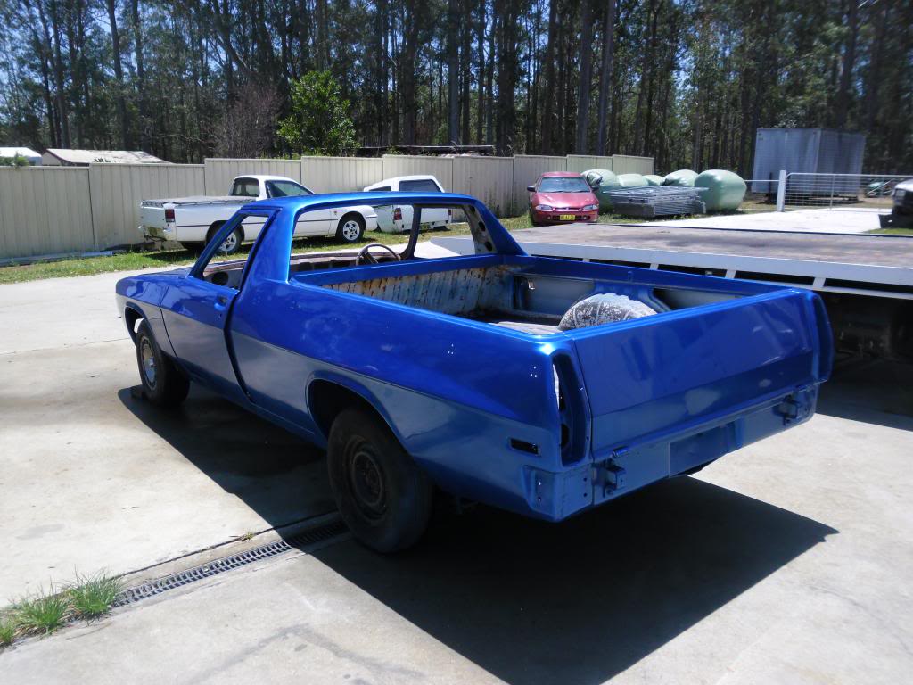

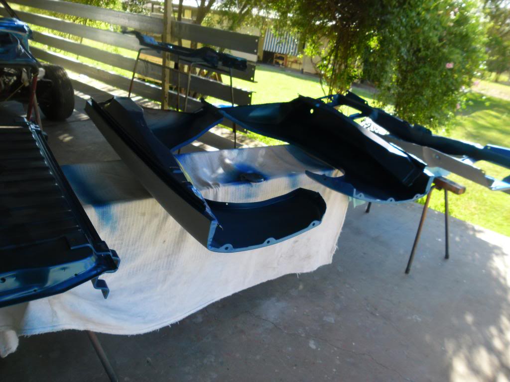

We've got some colour :) :) :) :), inside of panels are all painted, all edges, around the doors those kinda places. found the brandnew tailgate we bought before i even had the ute ahahah
Dad does all the spraying, im not confident enough yet, he was wondering why the paint was coming out so quick, 2mm tip in the gun :) paint went on even, using an awesome vacuum fed gun dad loves it, one of the best guns he's ever used
Danny

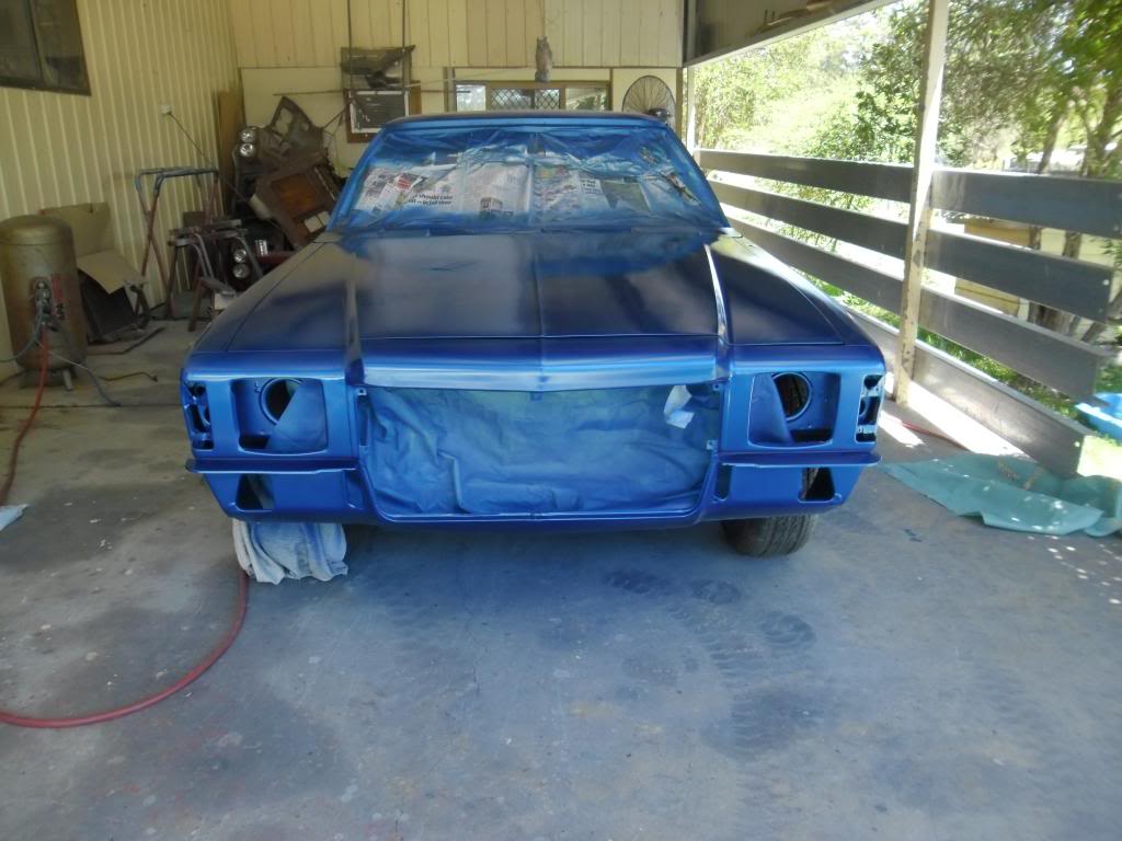

Back together :)

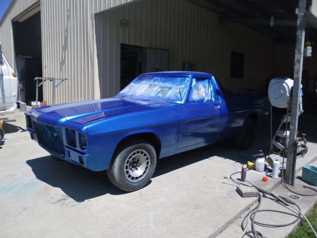

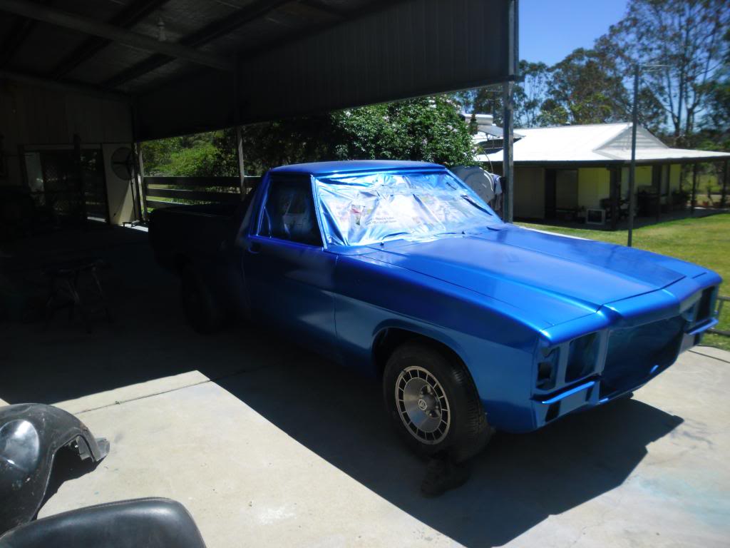

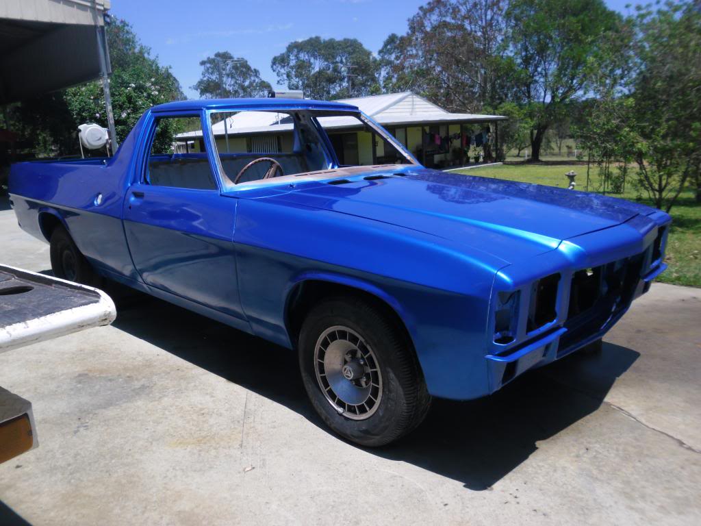

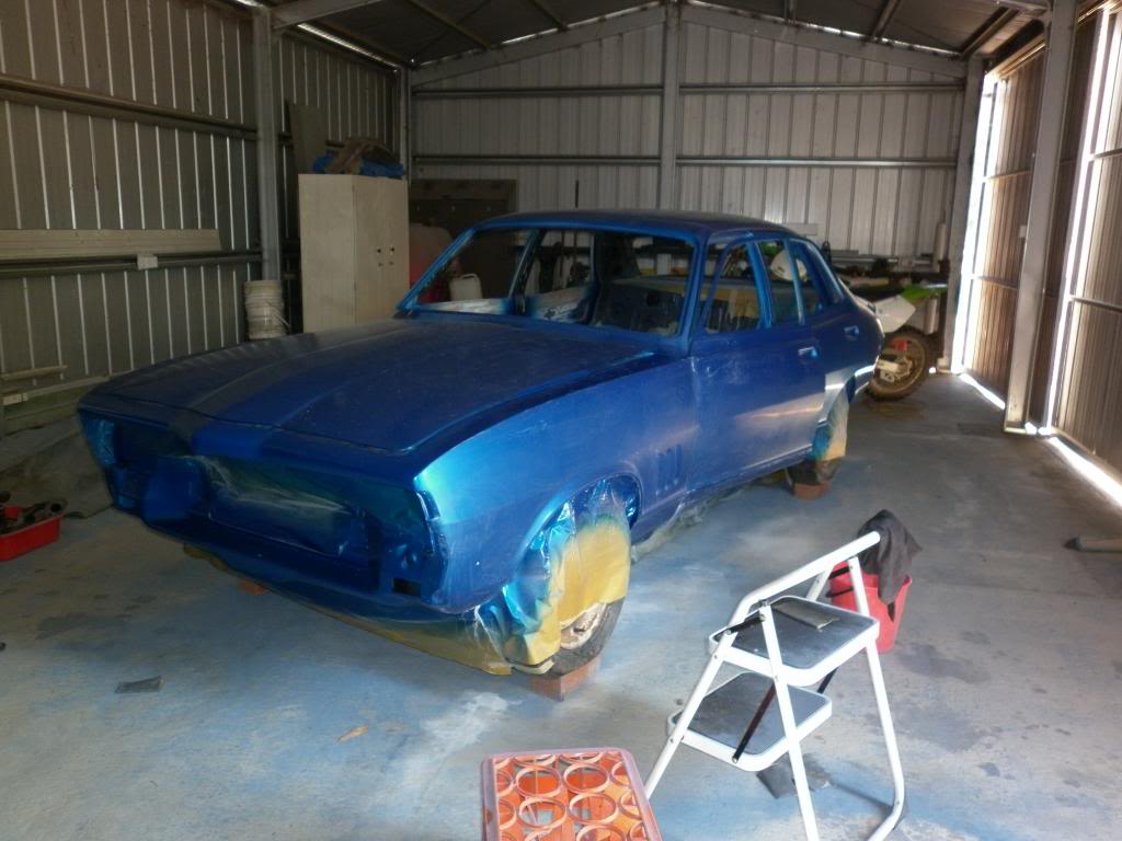

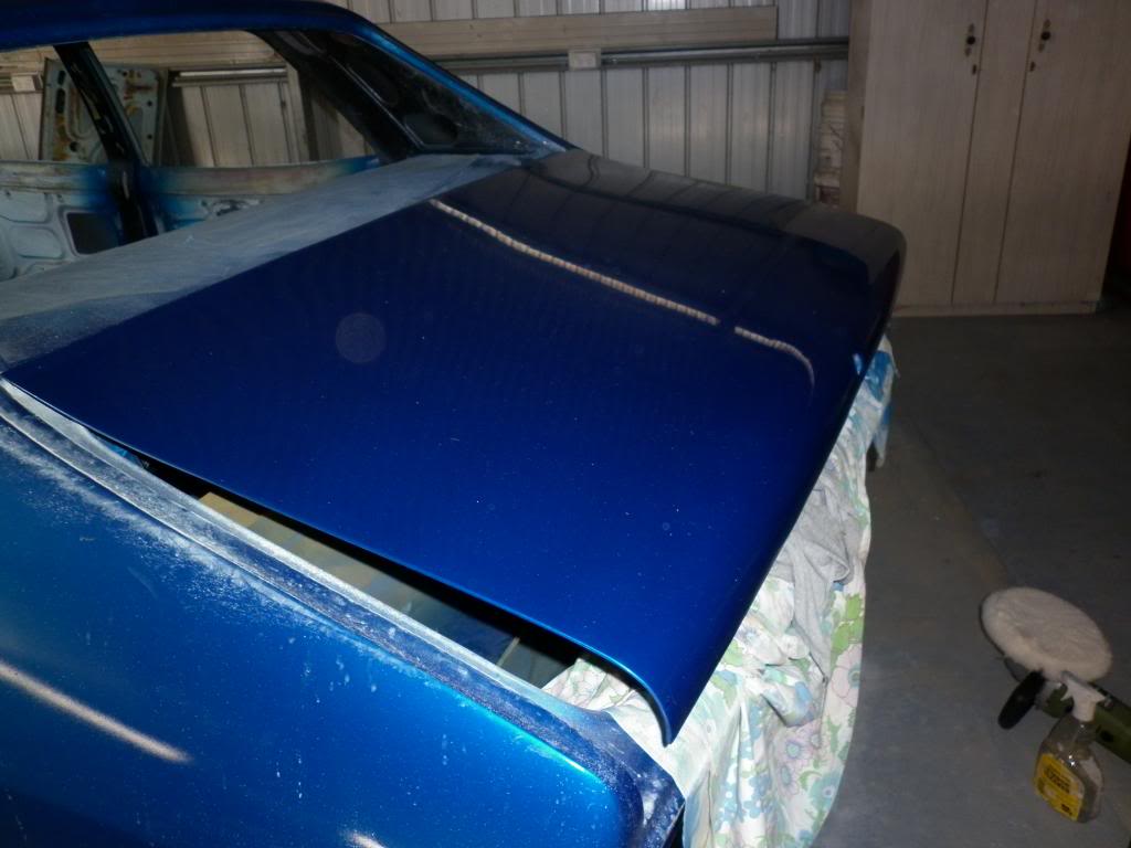

PAINTED AND CLEARED!!! :) will get some pics up once we've buffed it :)
#140 _Macca97_
_Macca97_
Posted 19 January 2014 - 09:28 AM
Well heres a few pics, hasnt been buffed yet,

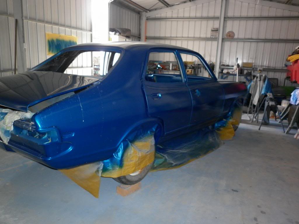

#141 _toranatime_
_toranatime_
Posted 19 January 2014 - 11:11 AM
looks good mate, very similar stage as my 4 door lc. same colour too haha.
we have only got half the clear sanded back and only the boot buffed but it is getting there. such a long process haha.

cheers Kieran, all i wanted was blue aha so dad said right we'll paint it cyan, great feeling when you see it all nice and cleared and it looks great than you rub it back and it looks crap and you think to your self will this thing even shine ahaha
Clears all rubbed back took 3 hrs both me and dad rubbing, way to hot outside to buff it, i still dont feel comfortable doing so dad has that job while i do the rims
Danny

thanks David, I don't think there factory wheels, they look like wheels off a trans-am,  smokey and the bandits car has the same style

As Dave said they are WB Statesman wheels, 15" X 7".
The paintjob looks great.
