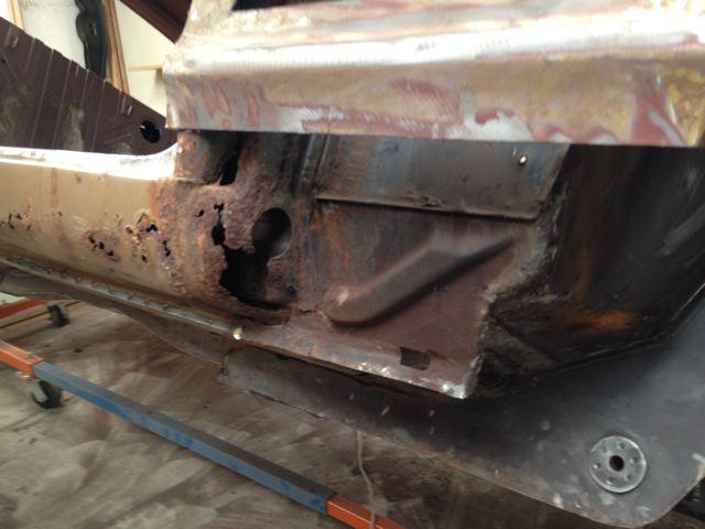

There was a patch-up on the chassis which I removed and found this hidden below, I'll try and make this piece up and weld it back in.
Attached File  IMG_2264.jpg   46.99K   39 downloads
Attached File  IMG_2266.jpg   52.55K   40 downloads
Attached File  IMG_2267.jpg   50.62K   35 downloads
Might get some gas tomorrow and start practicing my welding.

Is that rust patch where your front end bolts to the chassis?
No wonder it was so hard to get those bolts out  :o

Thanks Craig,
I'm looking forward to making the bits and want it to look factory, no matter how long it takes.
That was the rusted K-frame that gave me grief, there's a bit of work involved in making that section with crush tube and thick washer inside the chassis.
Might have to see if you have any boot floor metal I can use to repair this drop tank hole. Could be a real patch work job to fix.

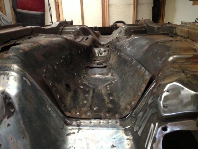

Didn't realise how many differences there are between a 72 and 73 GTR, one of them is the extra strengthening in the tunnel and beside the chassis.  This was a real mission to drill out and remove the second skin from the gearbox tunnel, thanks to Mark for the donation. 97 spot welds were drilled out then the holes welded up (cause they were too big and all over the shot) and redrilled. I've spent 6 hours on this but keep telling myself it's just a welding, grinding and drilling excercise.
Attached File  IMG_2451.jpg   43.23K   34 downloads
Attached File  IMG_2458.jpg   49.13K   34 downloads
Attached File  IMG_2501.jpg   51.24K   31 downloads
A trial fitting, I've since ground all these welds flat and want to KBS both sides before welding in.

#67 S pack
Posted 16 March 2013 - 05:21 PM
Marty
If you're going to put the rail to floor pan braces from a 73 into your 72 then you'll need to remove the washers off the sides of the rails. 73's don't have them.
Keep up the good work
Dave.

Hey Gong,  the holes were too big for my liking (10mm) thought if I welded them on the car I would burn through or not leave an original looking finish, plus they weren't uniform in spacing and closeness to edge. I realise now it's a heap of work for something that's very hard to see.
Hi Dave, I noticed that when I started removing the braceing off the donor, if that washer is removed there might be strength lost at that point. The braceing is very thin metal at that point. I wonder if the 73 has two internal washers eitherside of the crush tube????

#71 S pack
Posted 16 March 2013 - 08:37 PM
Marty
No, the 73's don't have any extra internal washers. What you will do though is purchase 2 suitable size zinc plated flat washers approx 1.2mm thick and install one onto each bolt between the nut and brace metal.
Dave.

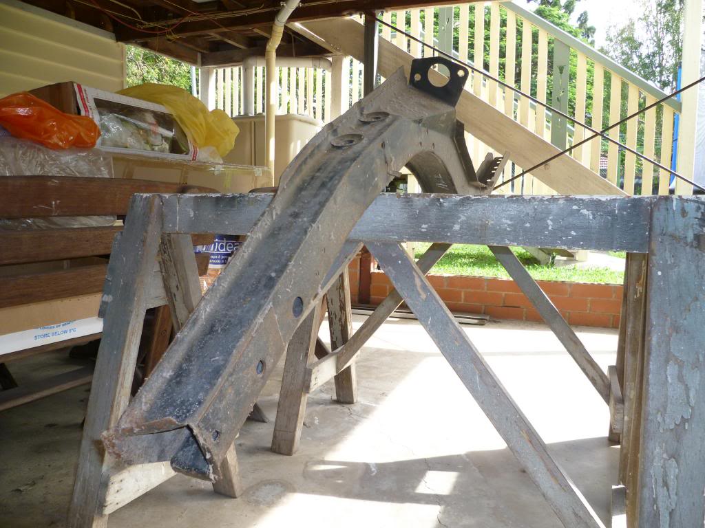

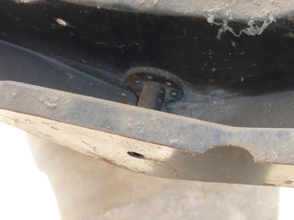

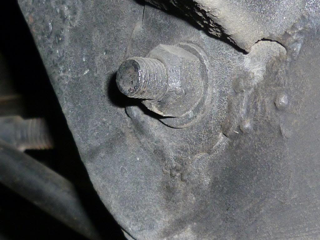

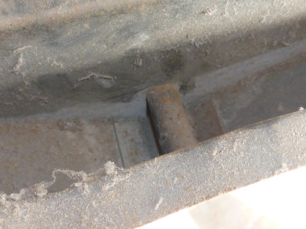

Warrenm, some pics for you.
NOS right side LJ chassis rail. Note it is a 1973 type (ADR 10B compliant)
Note the absence of the washer spot welded to the outside face of the rail. You can also see the washer spot welded to the inside of the engine side of the rail, same as an LC & LJ pre ADR 10B rail.
As you can see here there is no washer on the backside of the outer face of the rail. Just constructed the same as an LC & LJ pre ADR 10B rail.
Last but not least, the left side floor brace on a 1973 LJ. The metal tab on the brace is welded flush against the side of the rail and a flat washer installed under the nut.
