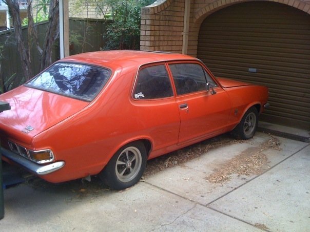

you've come a long way, mate. I feel as though i'll have the same problems trying to rego mine!
12632_228010943676_7037317_n_zpsamas1ieb
Yeah I have come a long way, but still not there.
You'll be right.
