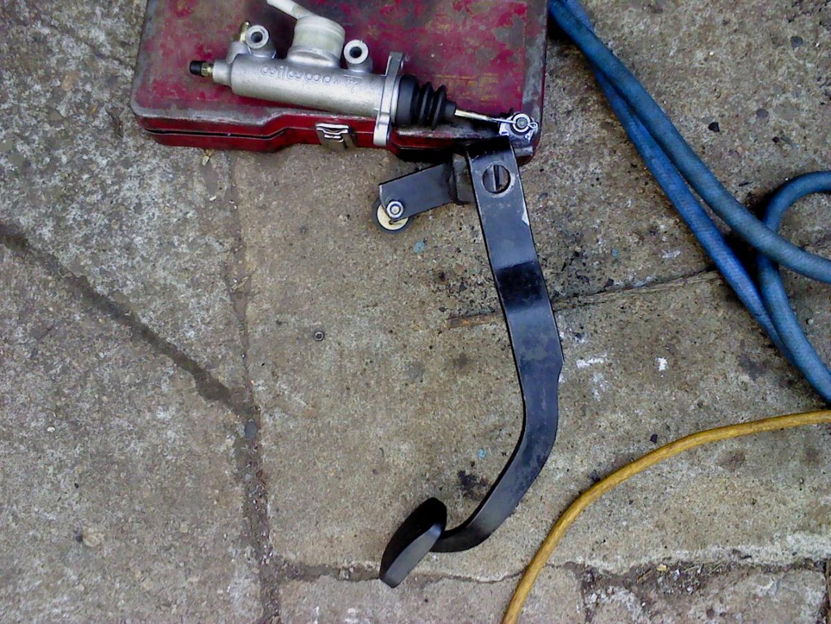

#242 Heath
Posted 28 January 2015 - 12:23 PM
Yeah I wanna do it under the dash using that Wilwood master - I know that the 3/4" master that came with the box is the perfect unit, but I need to convert it to suit a remote setup (with the hose coming into the top) and don't want to buy the whole kit just for that one bloody part.  :mellow:
nemo355v8 has paved the way on this one.
#243 _LS1 Hatch_
_LS1 Hatch_
Posted 28 January 2015 - 12:58 PM
http://www.summitrac...s/wil-260-10264
No need to buy the entire kit.. :)
#244 Heath
Posted 28 January 2015 - 02:16 PM
Jeff please give yourself a pat on the back.
#245 _LS1 Hatch_
_LS1 Hatch_
Posted 28 January 2015 - 02:21 PM
Consider it done :D
I actually had went into the shed to look because I thought I had a spare myself I was going to offer you (I gotta post a little box over to my mate in a week or so anyways) I couldn't find the one I thought I had, so dug up the link instead. (I had ended up with a wilwood master cylinder like that in with a bunch of other junk I had bought somewhere or other.)
I used a factory late Camaro reservoir on mine btw...mounted nice and all.

axistr
  • 1,239 posts
  • Location:North west sydney
  • Joined: 19-November 05
Posted 28 January 2015 - 03:57 PM
Heath I just used a BA Falcon master cylinder assembly, all mounted under the dash. Used the late commodore reservoir on the engine bay side. It was a simple conversion and the clutch is very progressive and light. I have concentric throw out bearing also

#249 turbo76lx
turbo76lx
  • 656 posts
  • Name:Glen
  • Location:Vic
  • Car:LX
  • Joined: 15-August 08
Posted 28 January 2015 - 04:32 PM
Hi Heath, i made up my own under dash clutch cylinder using a toyota cylinder on my lx gtr hatch build.
There are a few pictures about 1/3 of the page down on how i done it which help with a few ideas on how to mount yours.
 http://www.gmh-toran...tr-hatch/page-3
