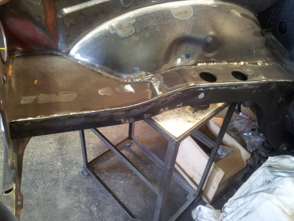

#190 Heath
Posted 01 January 2015 - 08:24 PM

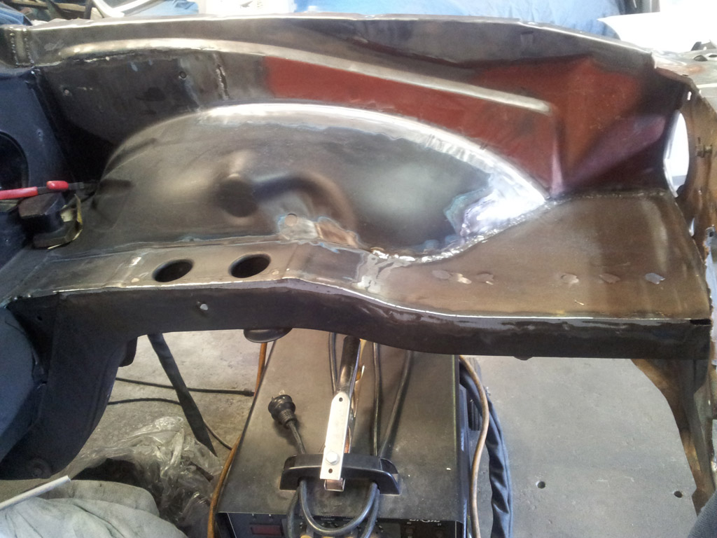

Thanks for the encouragement guys. Just a little update, shitty messy photos, but just made some progress trimming the rails and starting to box it all up.

40°C in Melbourne today, so didn't want to be welding and grinding all day. Basically finished the rails at least.

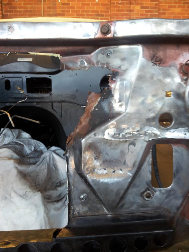

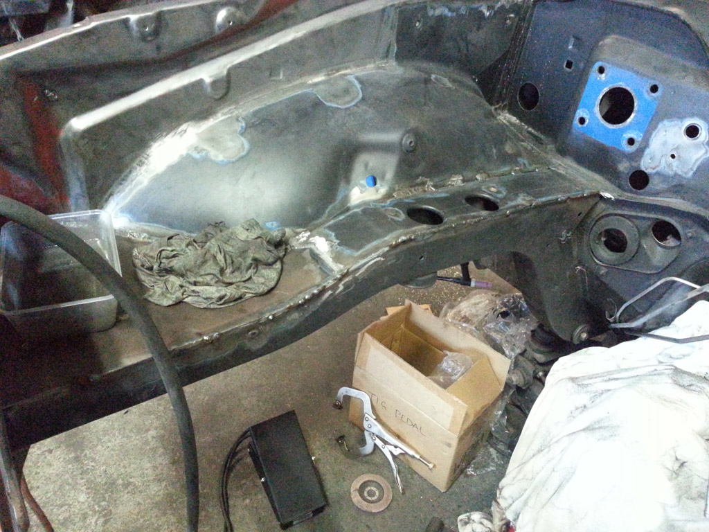

#197 Heath
Posted 05 January 2015 - 09:03 PM
Don't want to use the standard radiator mounting tabs
Passenger side of my front cut had been bastardised for a crappy A/C install I'm guessing, so had a go at repairing that.

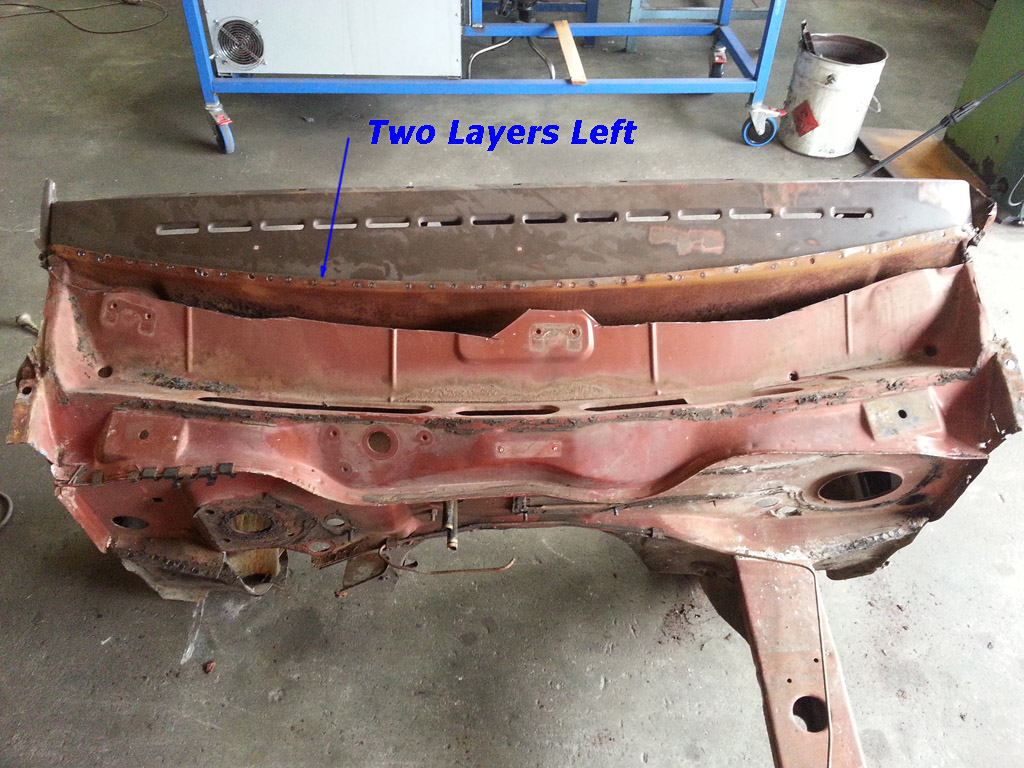

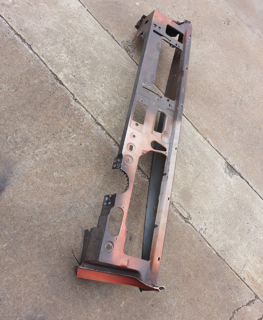

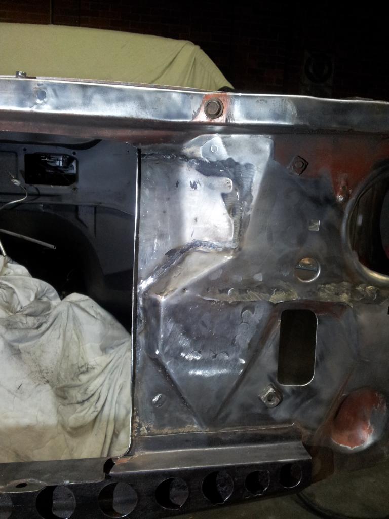

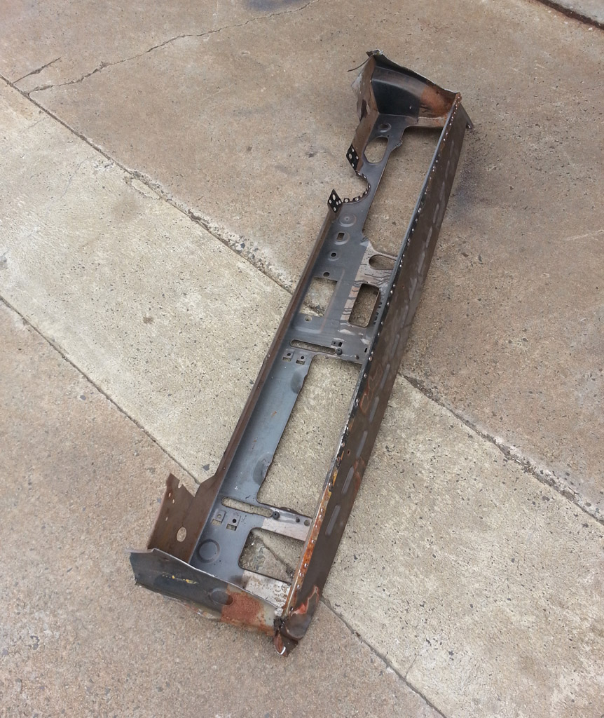

#199 Heath
Posted 11 January 2015 - 12:09 PM
Yep keen to see Matt! I actually haven't made up my mind about the brake lines still - I've gotta decide soon hahahaha

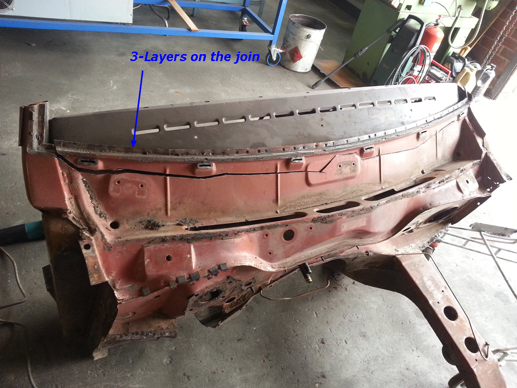

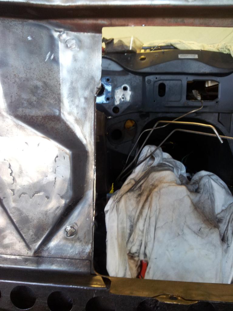

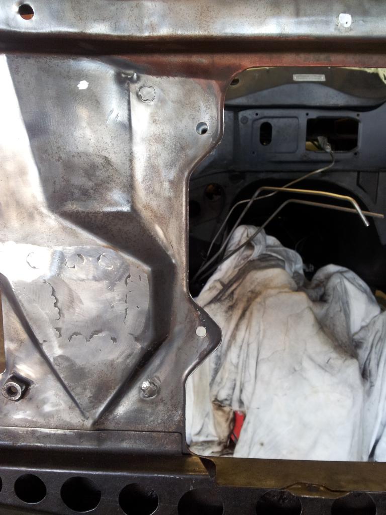

Finished the square mouth on the rad support, awful photo though.

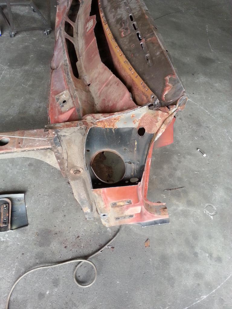

Starting to move onto the dash area now. It seems pretty clear that if you had an LX and a UC and wanted to swap dashes between them, you wouldn't be able to. You absolute need to molest AROUND the dash in the LX, and you need to molest the dash itself in the UC.
The obvious join along the top is a 3-layer spotwelded join. There are two challenges to drilling this out - you don't want to drill the whole way through without paying good attention to what you're doing (or the LX dash getting grafted in your UC will look like swiss cheese where you want to plug weld it), and in addition to that - there are probably 10 spot welds that are obscured by the top layer of metal. They joined the bottom two and then put the top one on and spot welded more. I elected to drill the visible spot welds and cut the top of the plenum off to get better access. This means the dash that I've cut out is neater, BUT I do not really want to remove this piece on the hatch, so I think the hard stuff is just beginning.
At this point, the previously shrouded extra spot welds are exposed:
