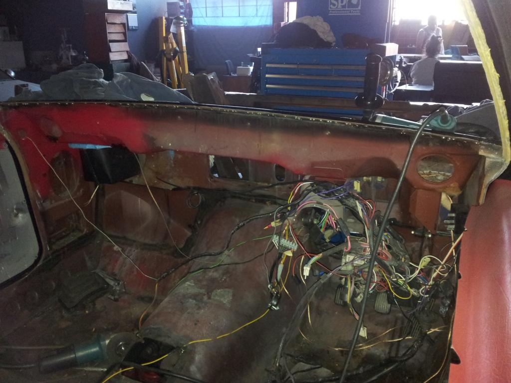

Ahh Craig that is a damn good idea but I had already started drilling the spotwelds along the top of the dash in the car a few weeks ago. Bugger! Can still fuse it, but have a fair bit of plug welding to do too :(
What I did on the car was drill the whole way through with every visible spot weld (as the UC dash was going to scrap) and then run along under the join with sandpaper and a torch to find all of the obscured spot welds, marked them on the top and went through from the top too. After a bit of buggering around and cutting it near the pillars, I got the dash out this arvo. Still not cleaned up at the ends though.

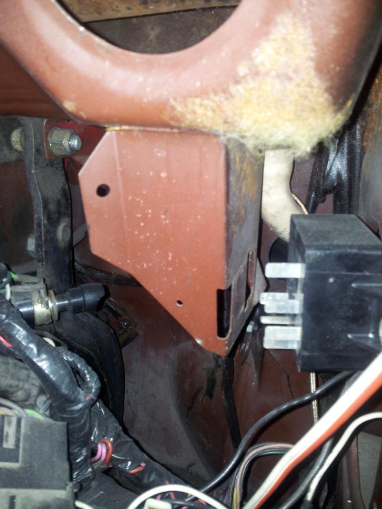

Yep cool. Fortunately I have a fair few Torana parts and can mix and match, but I'm sure I will have questions. One of which right now, actually.
I'm not used to UC's... this panel hanging from the plenum is not something I recognise from LH/LX? Am I losing my mind? Or is this a UC-specific thing? What's it for?

Posted 14 January 2015 - 05:10 AM
Bonnet release cable clips onto it
#209 Heath
Posted 14 January 2015 - 06:32 AM
Ah that makes sense. UC has the lever, LX has the direct-pull cable under the dash. Will examine further before deciding what to do.

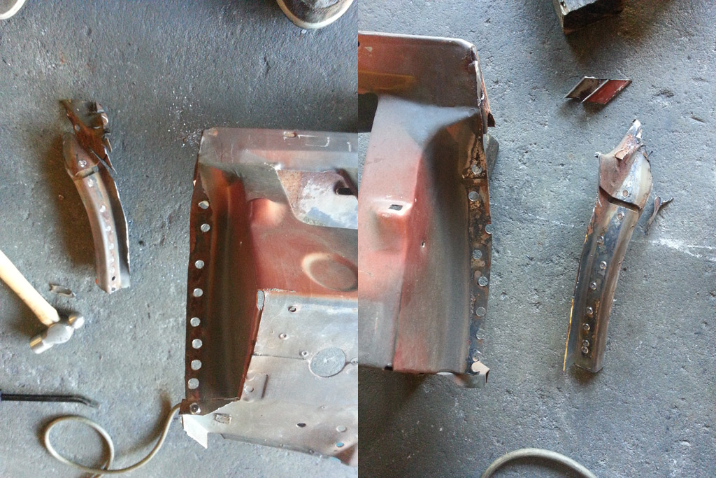

lol nothing is out of whack (if your firewall was outta shape, it would be fairly clear), it's simply that everyone else seems to have cut the ends of their dash on/left the ends of the UC dash in there. I carefully removed the UC dash 100% (sacrificing it in the process), and kept the LX dash 100% complete (sacrificing everything around it) not realising any of this, and now while the dash is the right size, there's no way of getting it in the hole past the kinks in the pillars and I actually bent it last night trying to get it in.  :<_<:
Ah well. I'll have to be a little more creative.

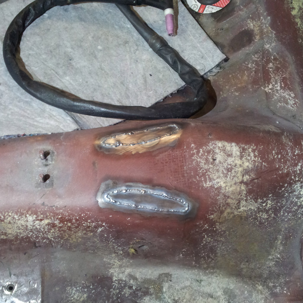

One of the plans was to lose the handbrake. Welded up the holes so far, but I will also be unpicking the brackets from the underside of the car etc. I want this car to be on a diet even with the heavy driveline and all the shit I'm too stubborn about to do without, so any un-necessary factory bracketry I can get rid of is good haha
Edited by Heath, 21 January 2015 - 08:42 PM.

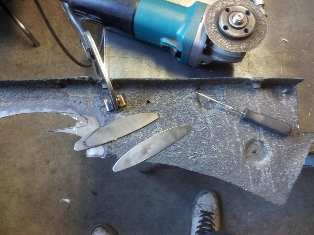

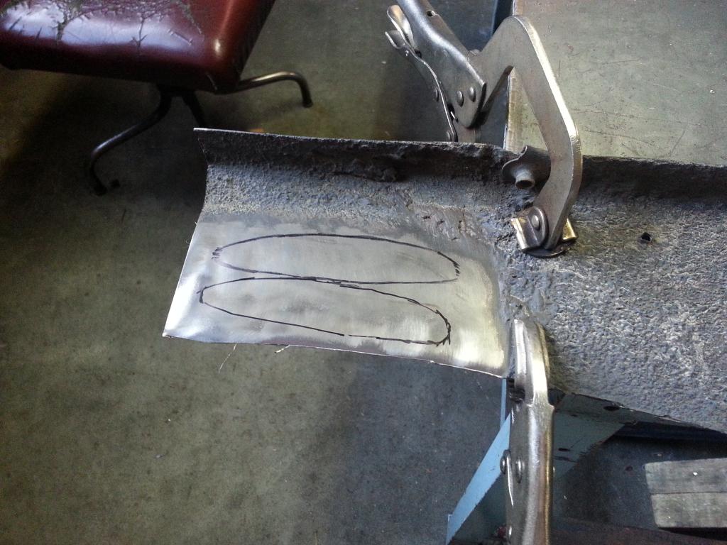

Well my mate came Groges down today to check out my work on the car and we decided that I should take the bay a little further. An hour later we had one side almost ready for welding haha
Used a spare bit of one of the donor front cut's inner guards as it already had a similar compound curve:
