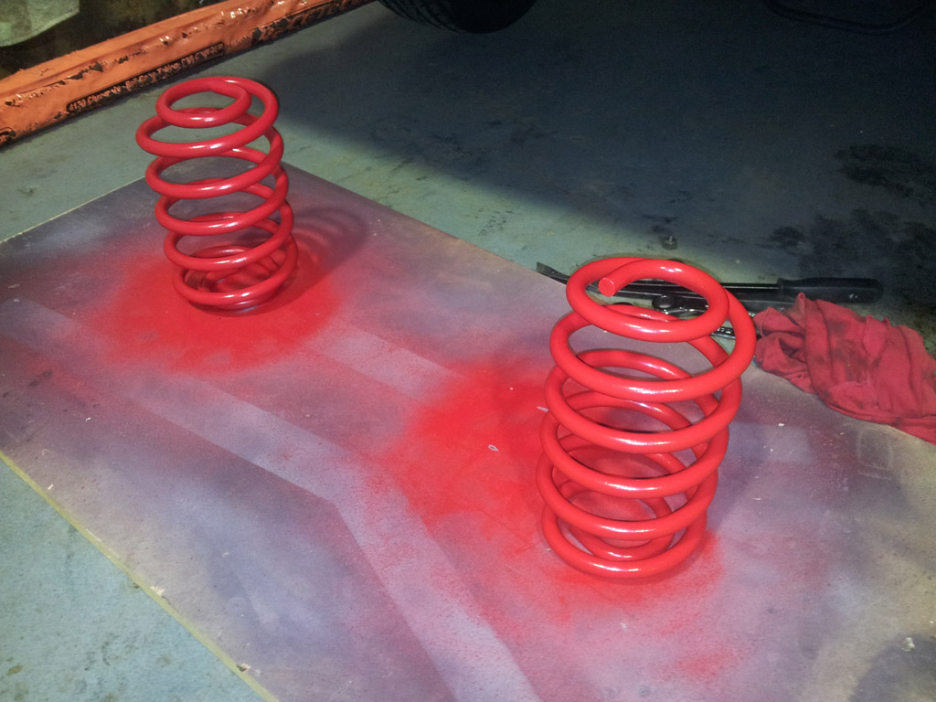

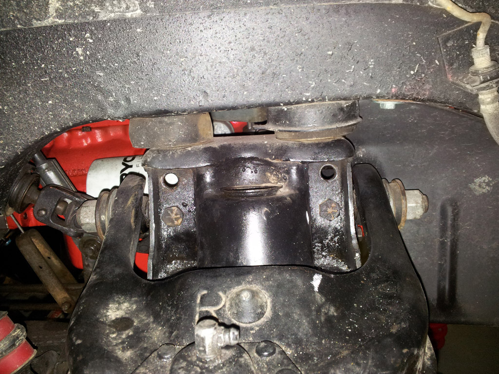

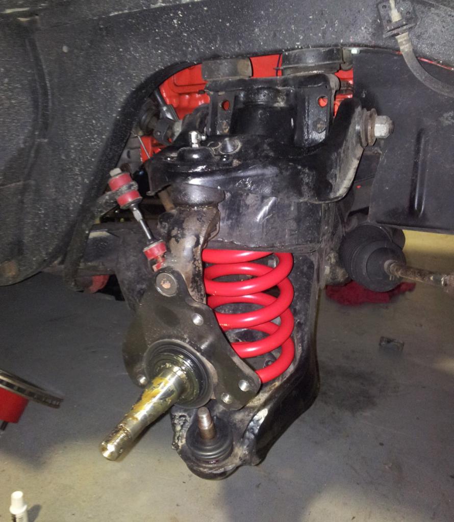

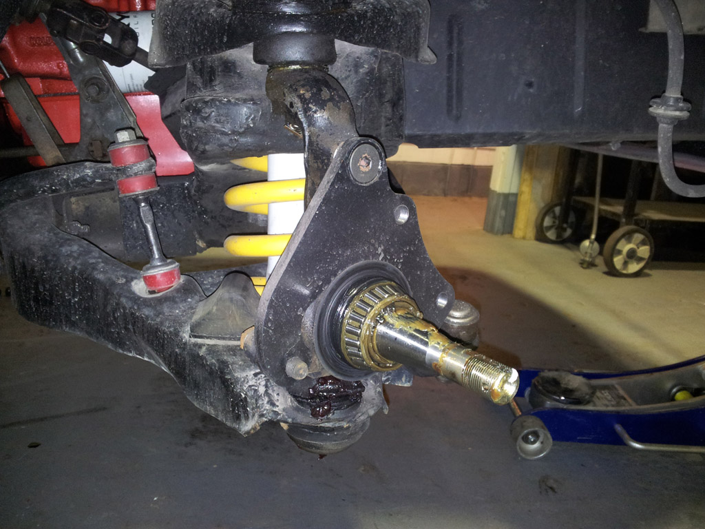

Had the front end apart. Found a few things not torqued up correctly, one stuffed outer wheel bearing and the lower balljoint boots were buggered.
Lowered the UCA pivot point height by 30mm (no dive adjustment)

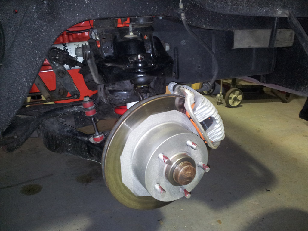

Painted the springs red to match the rest of what's in there, KHFL-14s but a bit went missing somewhere along the way. This photo also shows the drum brake front stubs and the caliper adapters which I've never actually seen before. Countersunk bolt at the top, and two more at the bottom (front and rear) which go in from the back.
Also just painted the hub area of the DBA17 (or similar) rotors silver because the red looked pox.
May be interested in selling this front brake setup further down the track (PM me if you're interested) as I may want to go another route.

Always something that needs doing/fixing on old cars eh!
Those discs look like HQ -WB  DBA 014's or equivalent.
#33 Heath
Posted 20 July 2013 - 03:06 PM
lol the more I can do to make this thing mine the better. Love being back in a Torana but don't love driving a car that someone else put together haha.
They are 290mm and Commodore pattern. Got the bearing numbers written down too, presumably the same as Torana.
Edited by Heath, 20 July 2013 - 03:06 PM.
Yeah, pays to check things have been done properly.
They are Commodore calipers but the rotors look like HQ. :dontknow:

They are early commodore rotors. You can tell from the distance between the wheel mount up face and the disc itself.  The commo one is set back an extra 10mm or so more than HQ-WB.  Bearings are the same so no issue there.  I just went through similar on mine.  Someone had fitted HQ stubs, commo rotors, spacers and HJ girlock calipers on mine.  Maybe you could just fit HQ stubs, discs and calipers?

The caliper adapter plate is a CRS item, they make them to suit HQ brake to torana drum brake stubs or commodore brakes.

I was told the caliper adapters were actually a 'V6 Conversions' unit. Not sure exactly what I will do with the brakes yet. I think I would like a slip on rotor with 4-1/2" PCD and a better caliper design (got some GTS-T style Nissan calipers I might be keen to use). Hadn't figured out stub axle choice or anything yet. Need to figure out something that is going to clear the wheels I choose to use to.

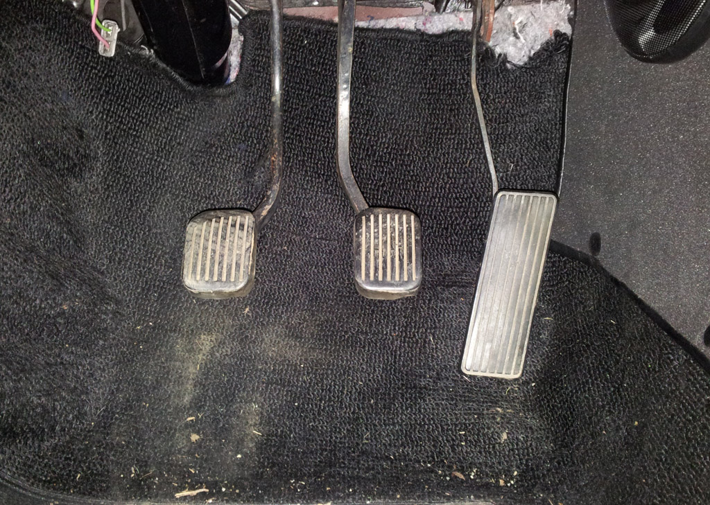

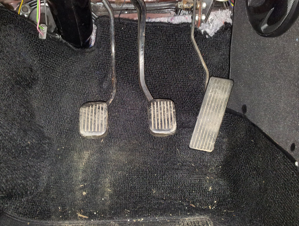

Also chucked my modified accellerator pedal from my green sedan in. The photo doesn't really show the subtle change but it makes a big different on the street when you're not threshold braking.

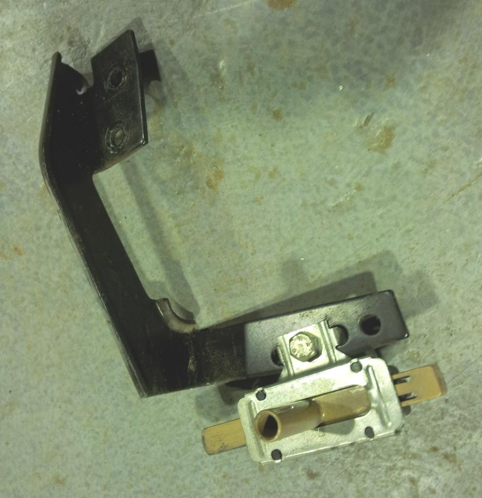

Found this when I pulled it apart (didn't notice it before). I recognise the switch as a Torana slushomatic kickdown, but this thing is a factory manual. Is that an original bracket and is that what it's for?
Edited by Heath, 22 July 2013 - 10:08 PM.
