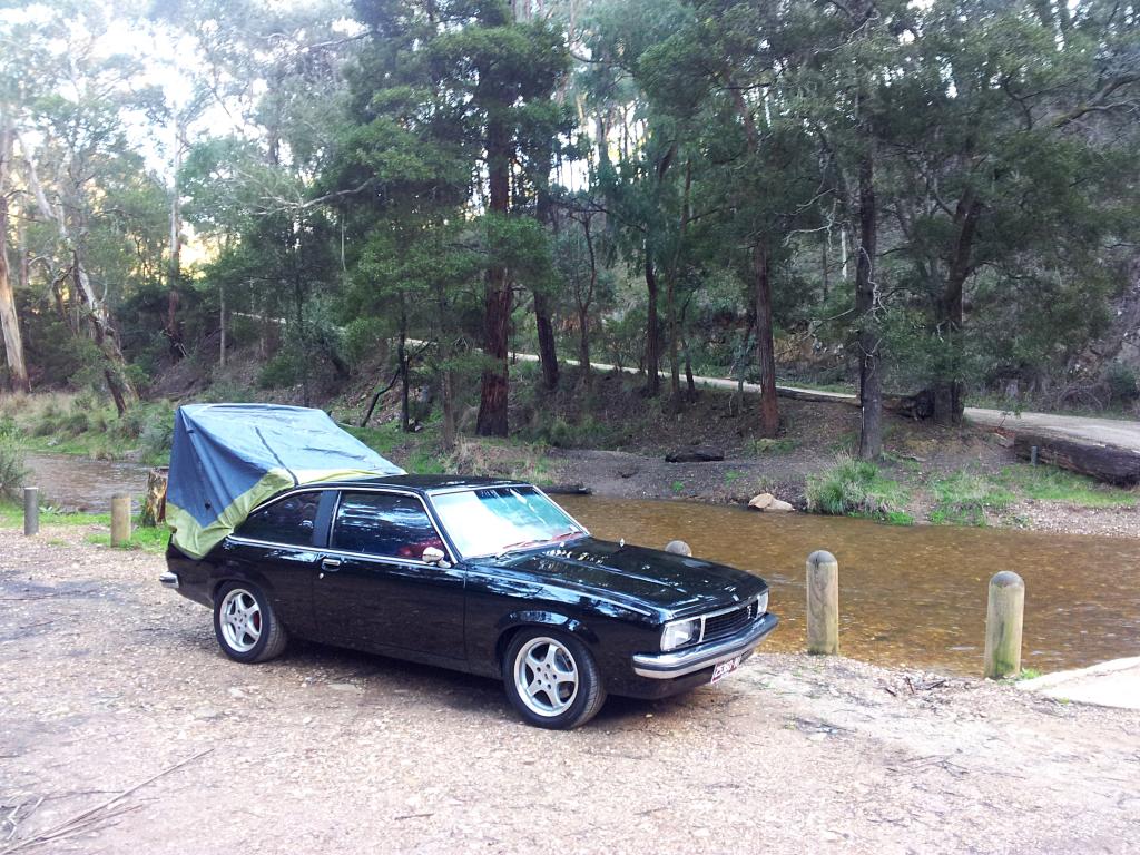

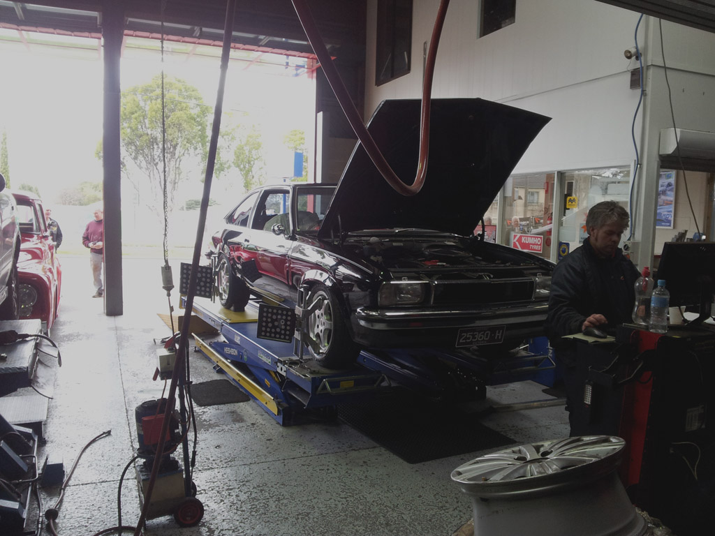

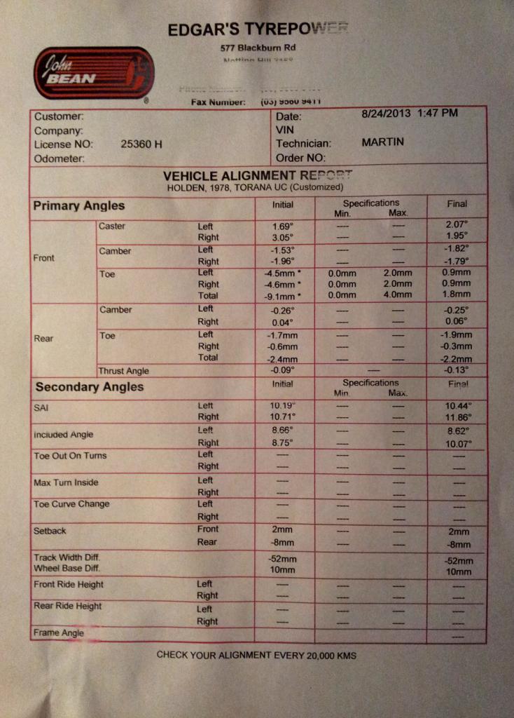

Wheel alignment went as planned, with really good results. Recommend Edgar's Tyre Power (Notting Hill) to anyone in the Eastern Suburbs. Awesome blokes and the best equipment around.
Loaded it up that night and took it up into the Lerderderg Gorge with my girlfriend. The suspension works on the Torana a bit better than the Datto so it didn't mind the rough roads at all. Oh yeah didn't have a hatch hutch but I am a resourceful person lol.

Why so much negative camber and so little caster?
#86 Heath
Posted 26 August 2013 - 08:56 PM
How much caster do most people run? That's significantly more than I had on the green car. I expected the goal to be a bit less camber but he seemed to think that was cool with what I use the car for.
#87 76lxhatch
Posted 27 August 2013 - 05:31 AM
You're about at the absolute max caster possible for an LH or LX front end, but for a UC that's still within factory spec I believe. My opinion would be similar to yours on the negative camber - that's a bit much for road use and will wear out tyres and track into the ruts - I've used up to 1.5 degrees when there's no choice but with a nice straight front end that gives you options I'd keep it down to 1 degree. The great thing about the UC geometry is you can wind more caster in to make up for it without the side effects; mine is currently just over 5 degrees static caster, with only 1 degree negative camber.
#88 Heath
Posted 27 August 2013 - 07:24 AM
Okay, well now that it is at a benchmark (symmetrical etc.) I can muck around with some more shims in the back later on to experiment with an increased caster angle. My suspicion is that 5 degrees might be a bit too much caster for a manual LH rack (you do have power steering right?). Food for thought anyway
#89 76lxhatch
Posted 27 August 2013 - 11:57 AM
Yes 5 degrees is probably a bit much, although I've got 255 wide front tyres and I did run the (UC) manual steering that way for a bit - ok while moving but 3 point turns become annoying.
Depends on how it drives of course, but I would imagine if you could knock the camber back to -1 and add another degree of caster (total +3) instead then it would handle pretty nicely.

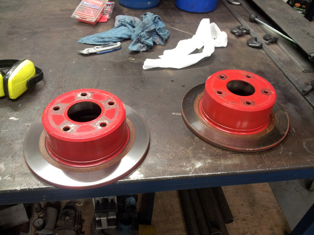

Posted 13 September 2013 - 09:58 PM

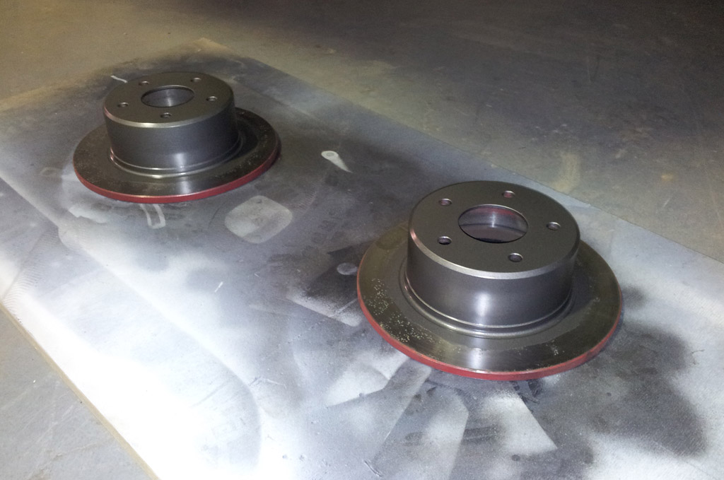

Keeping busy on this thing. Got around to painting the rear brake rotors to match the fronts:

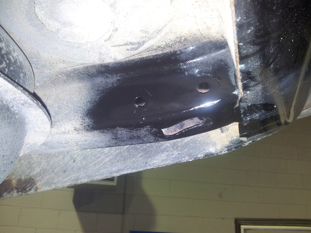

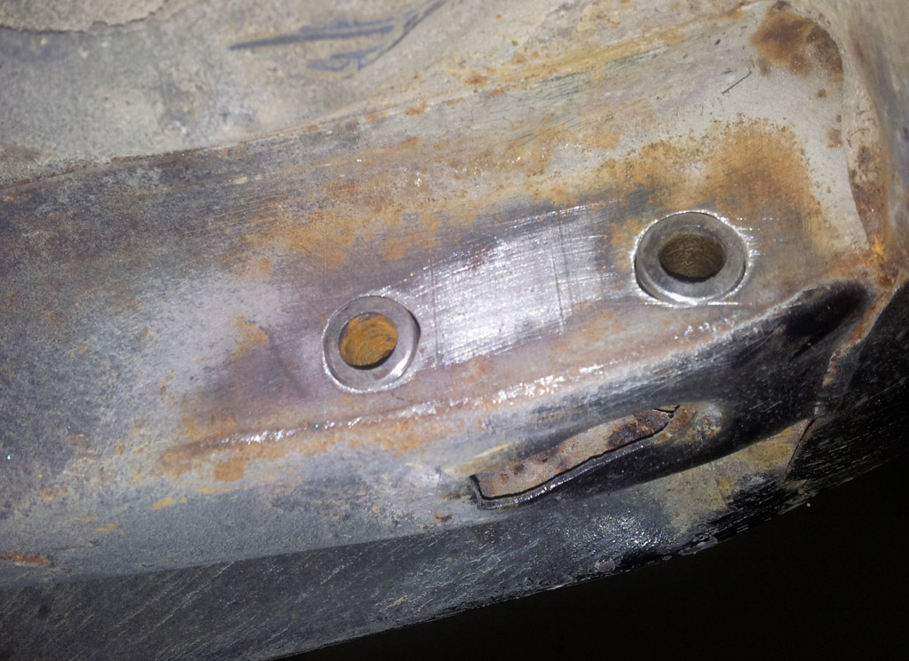

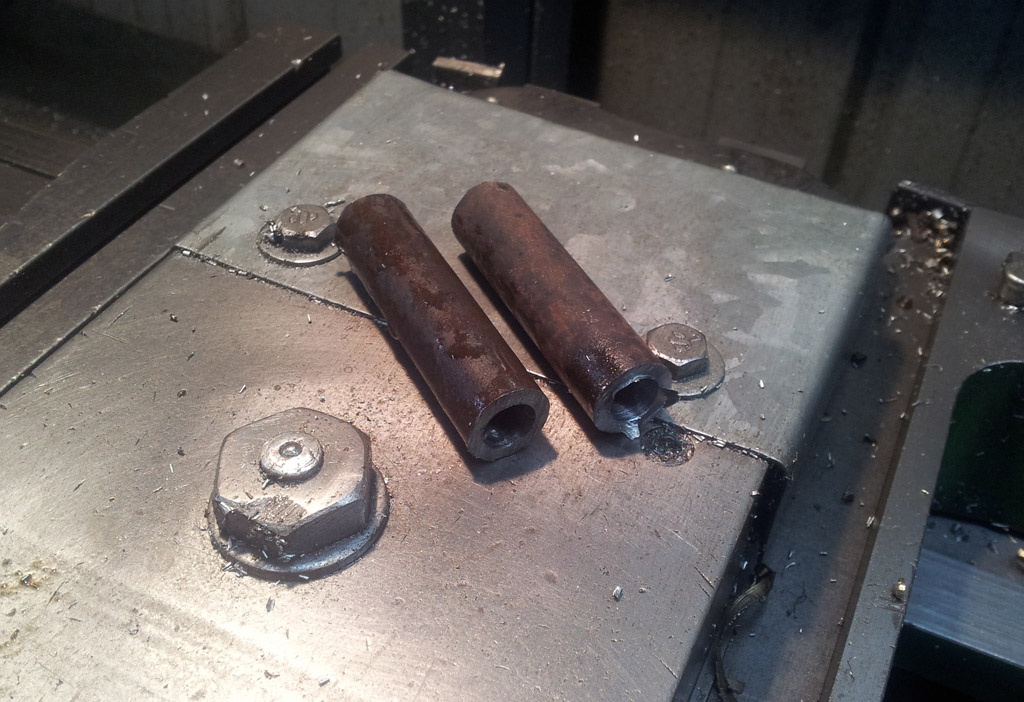

Turned up some little crush tubes for the chassis rail so that I could mount a tow point on the chassis. Will put one on the front bumper bar iron later on too.
