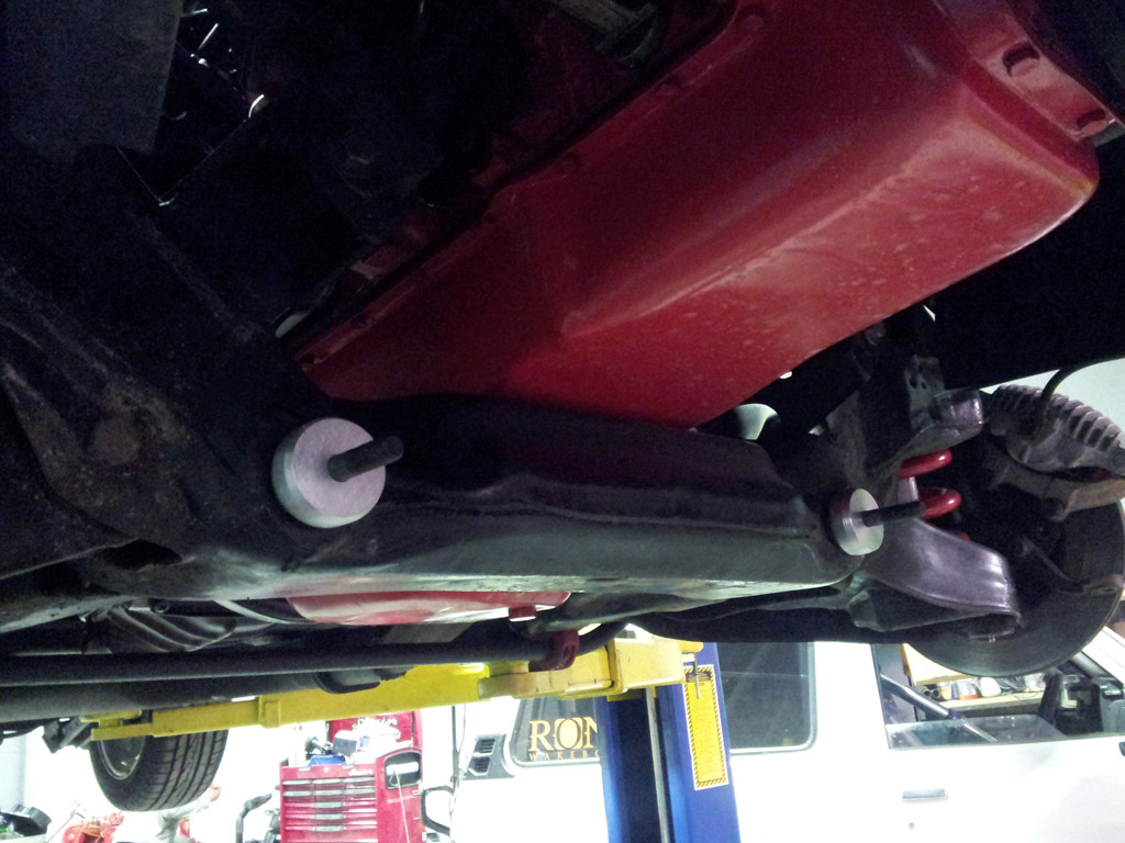

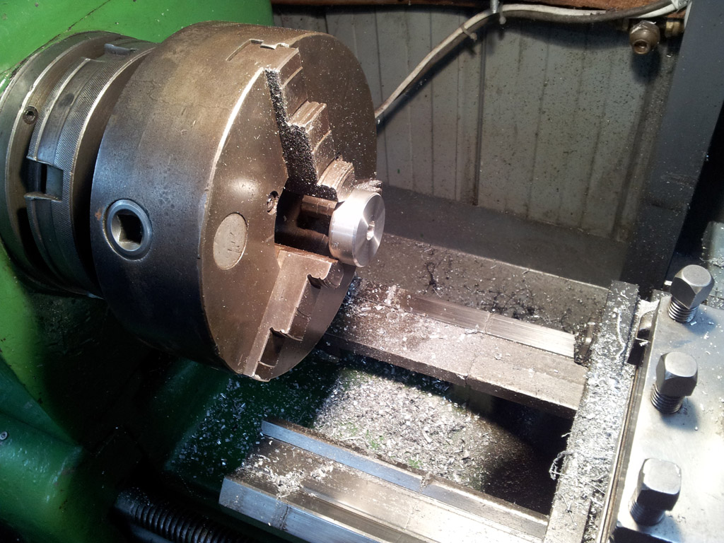

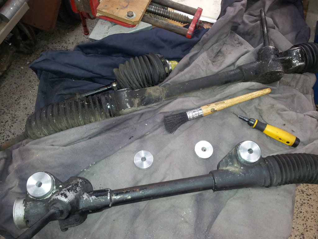

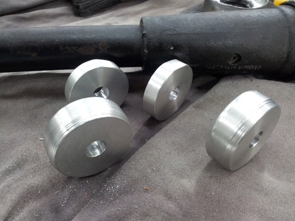

Want to put an LX rack in this car to speed up the steering a bit, but not a fan of the rubber mounts. This is not the finest machining work I've ever done, but I figure the design will probably need to be revised anyway. Spun these up earlier this weekend, two are just plain ally washers with a flat linished on them (to sit on the front), the other two are chamfered down to seat positively on the back of the rack (you won't really see them). I notice the UC rack actually has one of its bushes 'slotted' as are the ones that eyepeeler has for his car. I haven't slotted mine, and I've drilled them to a fraction under 1/2" so i will drill/file them accordingly which should ensure I can get a decent fit. We'll see...

What's the advantage of a solid bush for the steering rack? I've noticed others have done it also

Will be really interested to see if you end up filing it out a bit. I was having the same conversation with Welby (A9X) before I had mine made up, why do they need to be slotted?
Alloy bushes won't wear out like the rubber ones. Also, the rack tends to move around a bit with rubber bushes.

I was going for the more positive location aspect, not the wearing out aspect, but I suppose that is also true.

I've got the urethane bushes in mine (only urethane I run except engine mounts) for less movement. Those alloy jobbies are impressive. Can't see value in slots either...

The centre distance on the LH rack seems to be spot-on. Still haven't figured out what the slot is for.

Just filed each of these bushes for a minute or two until they were a snug fit on the standard captive bolts.

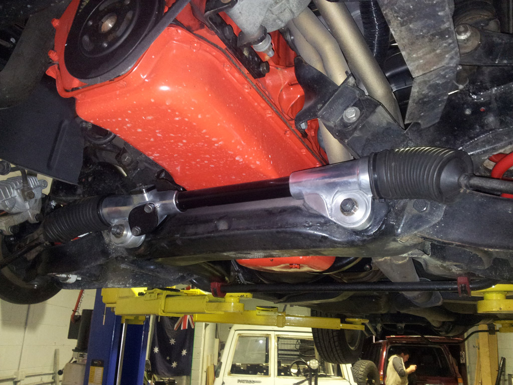

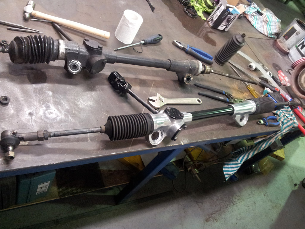

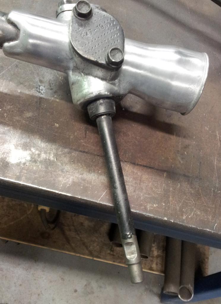

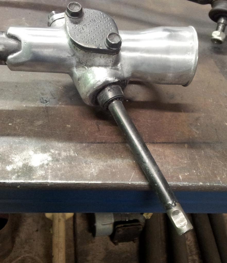

Chopped the end off the steering rack input to accomodate the twin-uni mod:
Gave the rack a bit of a tidy up
Chucked it in.
#67 Potta

Bit of an update... car went back together after a fair while off the road. Ended up having to put a 1mm thick rubber washer behind each rubber bush (against the K-frame) to ease up some misalignment in the mounting surfaces on the K-frame, not sure if other solid bush guys have experienced the same thing? But it was making the rack tight and it was a bit tricky to diagnose.

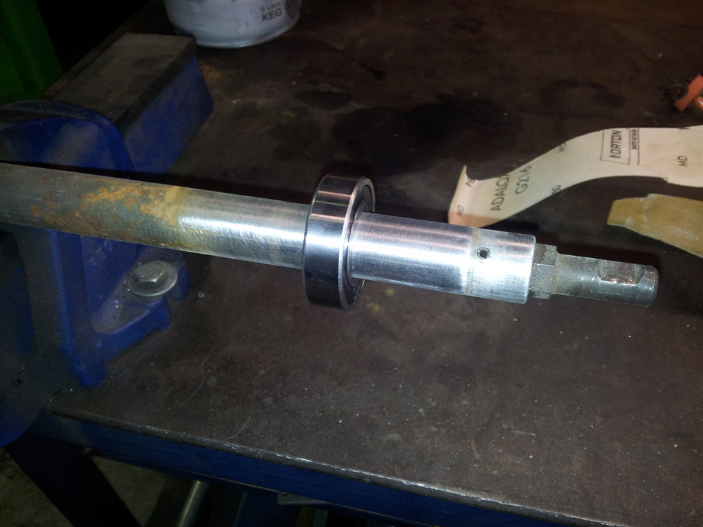

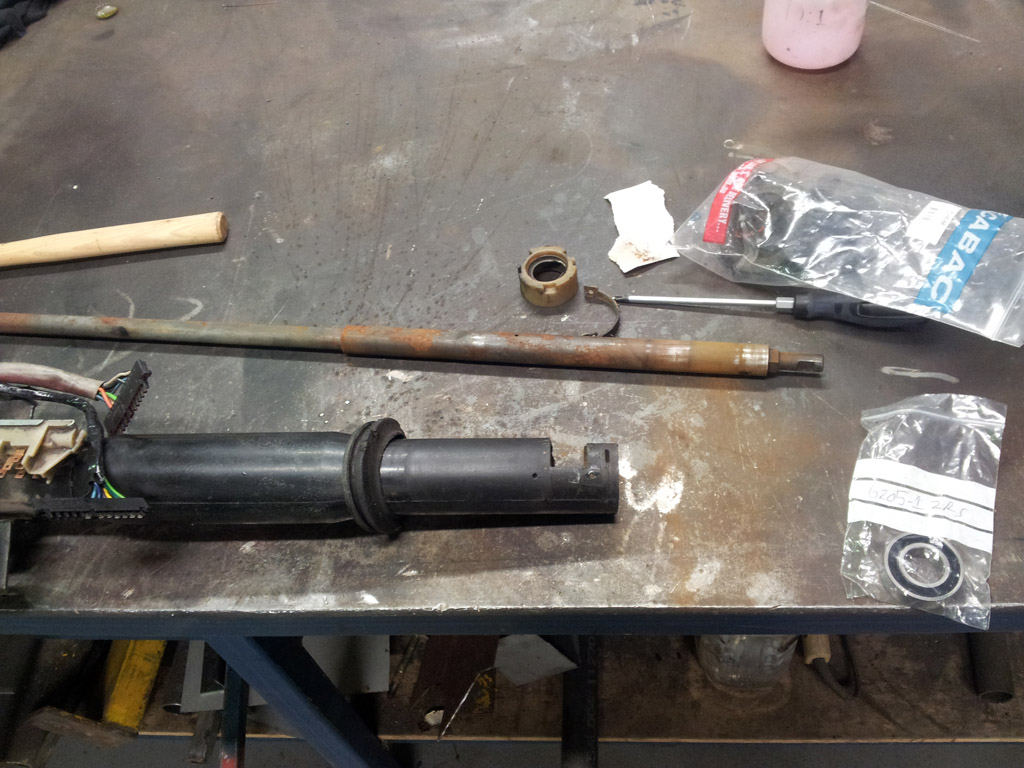

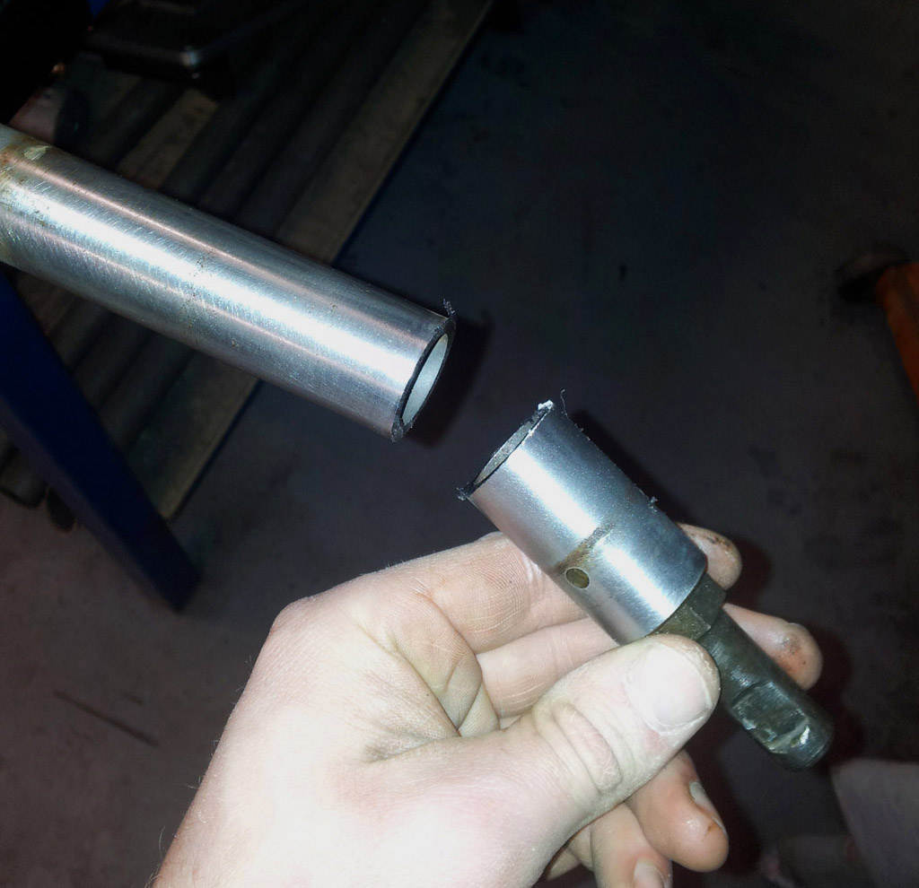

Linished the column down for the sealed bearing mod.

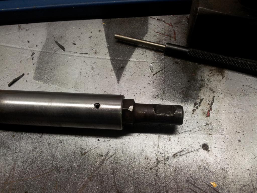

Cut the column short

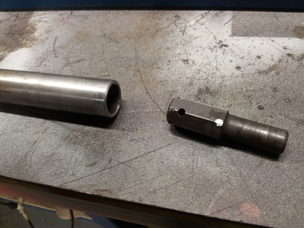

Deburred the shaft & end, marked the point of the hex to line up with the rollpin hole etc
Refitted rollpin in new hole

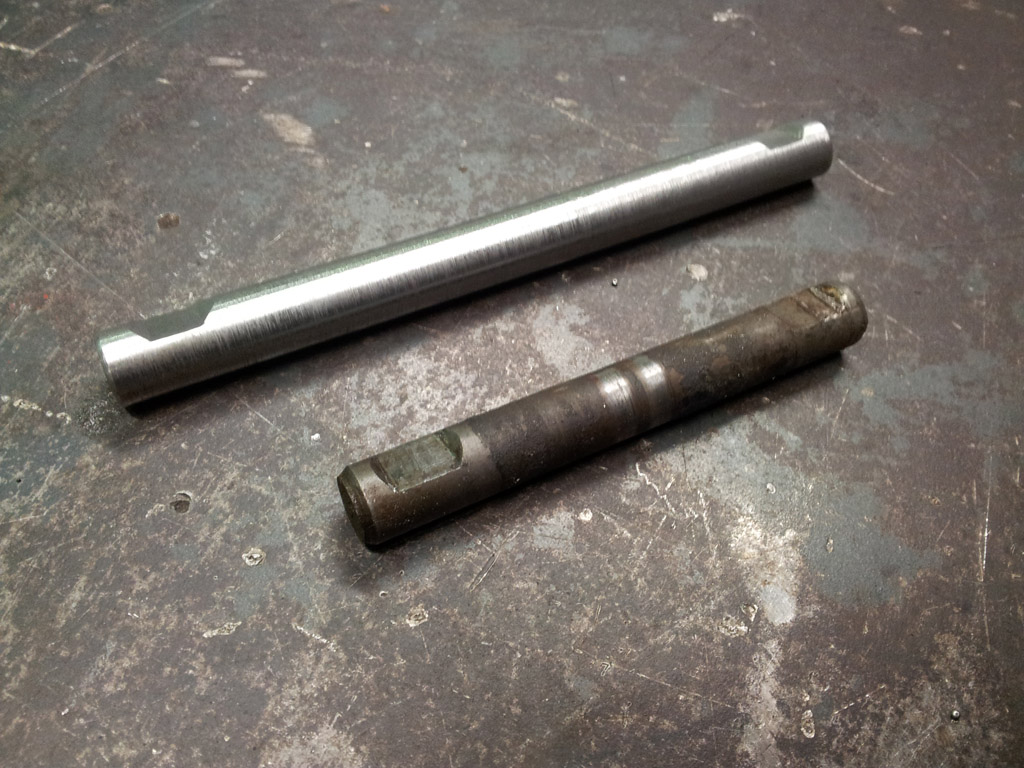

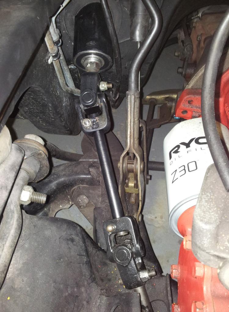

Turned up longer intermediate steering shaft, filed the flats on manually
All back together
Should be able to feel the work come together after my wheel alignment tomorrow!

What's the go with that modification ? Is there a thread on that, and what are the benefits please ?
I can imagine why it is done but would like to have it thoroughly explained if possible - bearing part number etc.
#75 Heath
Posted 24 August 2013 - 08:48 AM
The sealed bearing swap is a very common mod documented in this thread:
http://www.gmh-toran...brg/?hl=g clamp
The bearing I used was a (updated part number 20/4/23) 6205-2RS-25.4. It is a 1" I.D. and 2" O.D. bearing with rubber seals on both sides. The standard unsealed bearings don't work very well - have a fair bit of resistance, fall apart and are damn ugly.
Replacing the rag couple with a second uni joint is also a pretty common modication for more direct steering.
Shortening the column and making a longer (4340) intermediate shaft was something I thought of years ago and I've been waiting for an opportunity to do, but I have seen someone else on the forum do the same job. You could argue the difference is negligible but I prefer sharing the shaft misalignment between the two joints - it is a mechnically superior system - also makes for better clearance, I probably coulda/shoulda made the column even shorter but it's done now.
