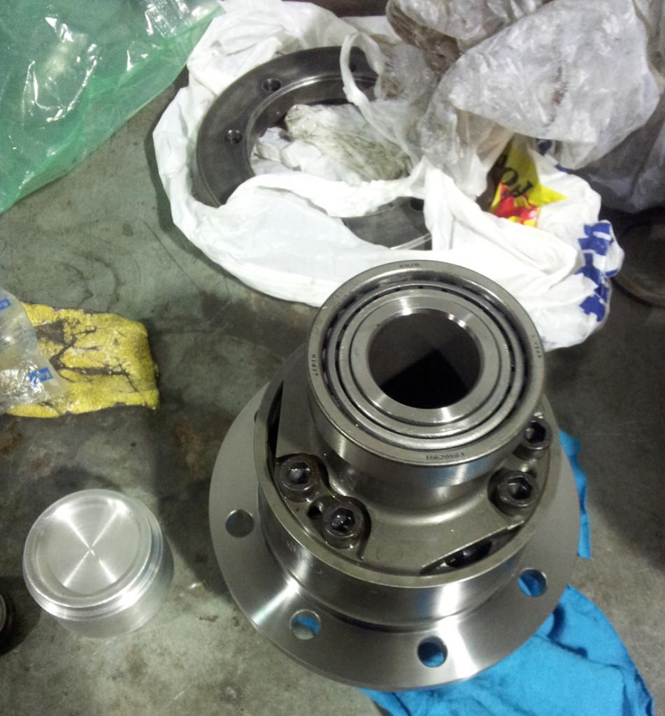

Picked this baby up for the BW78. Harrop modified Eaton True-Trac, 28-Spline.

Thanks Re the diff, its a VL std length by the look of it, comes in 25 or 28 spline. have you counted the splines yet?
Not so easy to get 28 spline axles, but if it,s 25 spline, probably heaps strong enough?

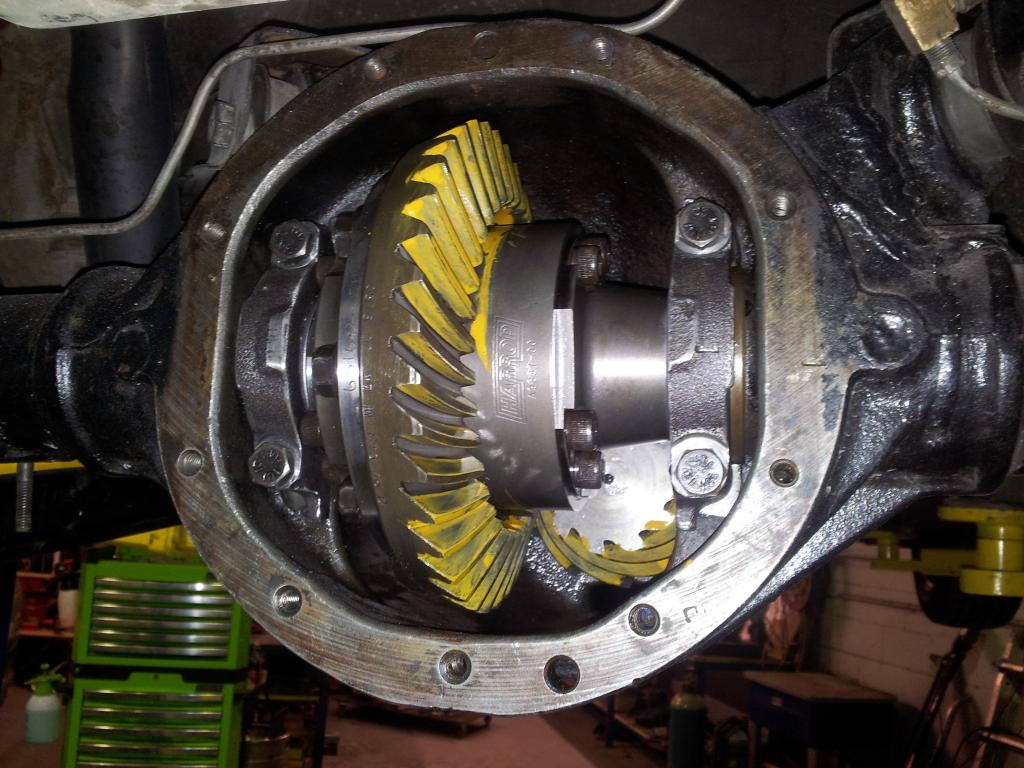

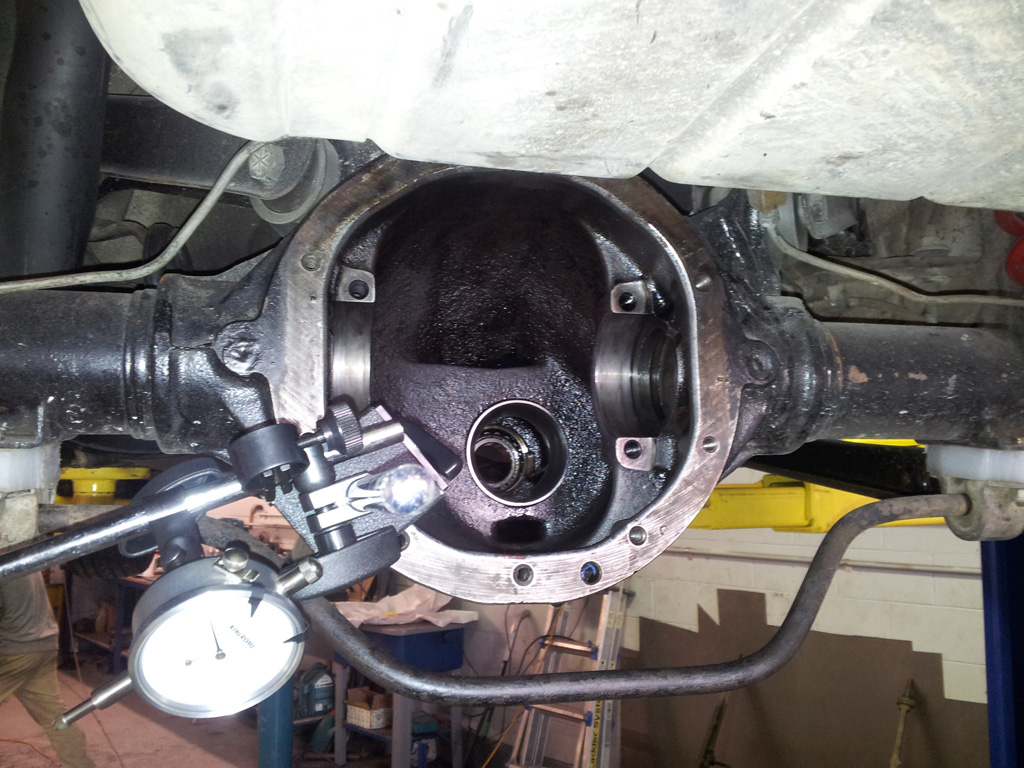

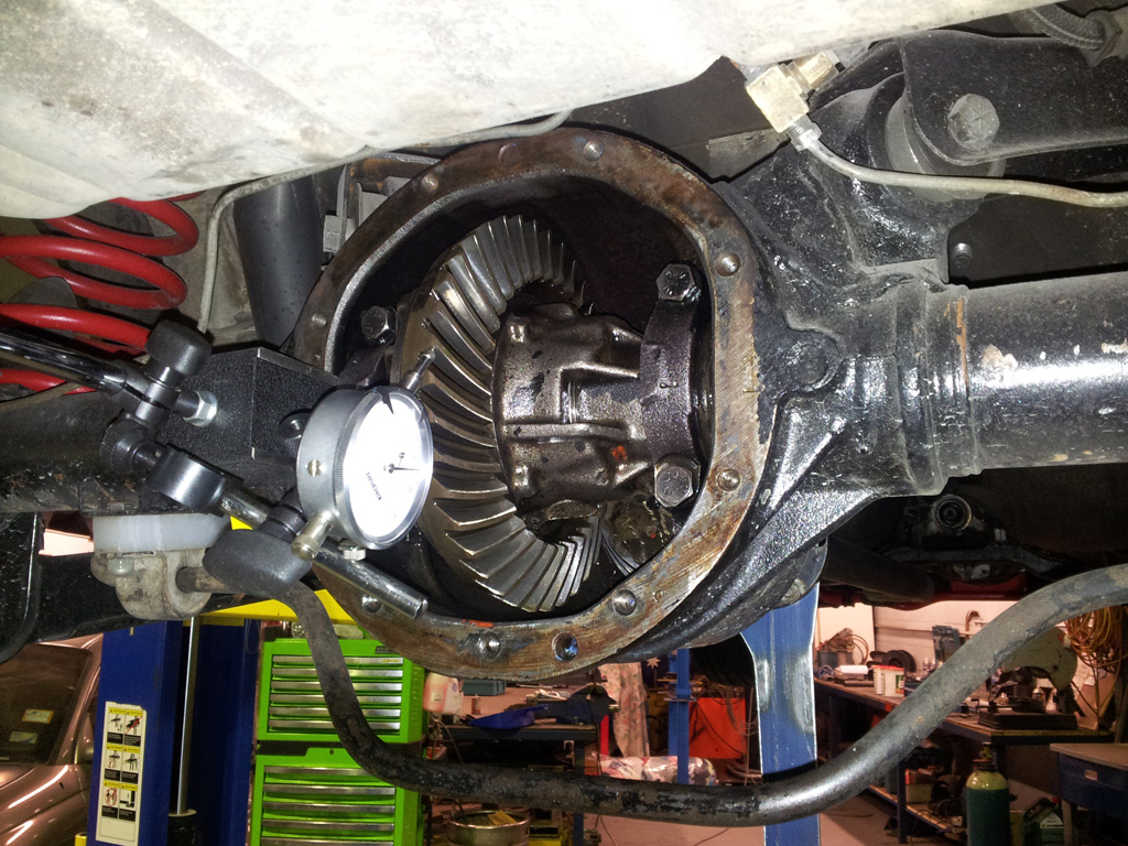

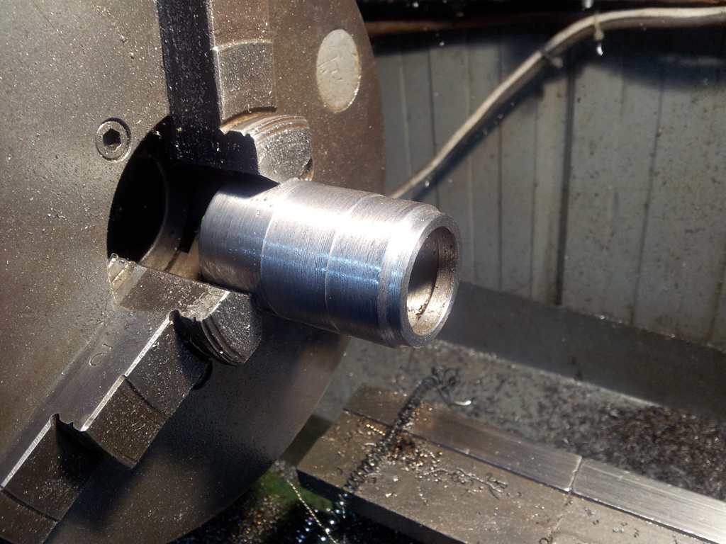

Turned up a solid bearing spacer for the pinion bearings:

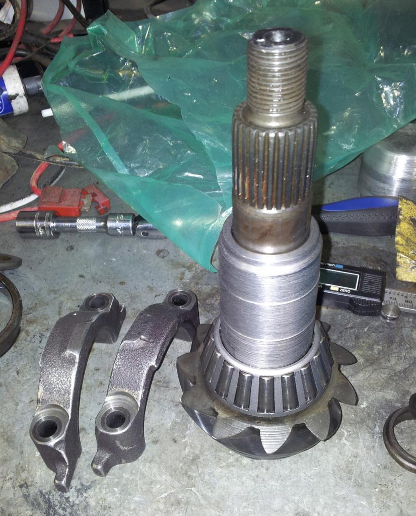

Measured up what it had already. Tight setup on the gearset, but the open centre was worn out and was giving it a fair bit of backlash.

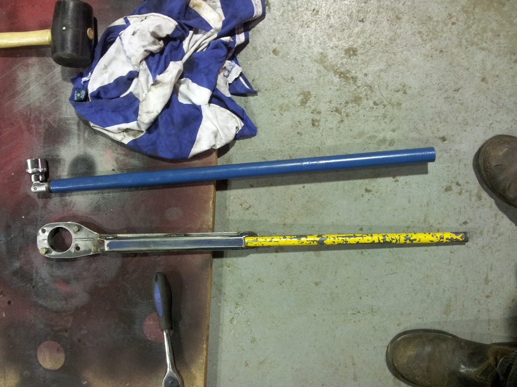

Made up a tool for getting the pinion nut on and off during setup:
Made a tool for installing new carrier bearings:
Ended up getting a bit of a hand from a diff shop around the corner from the factory - G&J Diffs in Dandenong. I went there to swap some shims and discussed a problem where the gearset seemed to be binding, ended up actually having a slight fouling problem on the TrueTrac centre with the factory pinion which turned out to be a BW75 gearset. I happened to get an "old stock" centre and after a bit of machining from the pinion head, it was all good. They also gave me a hand with the final setup too.

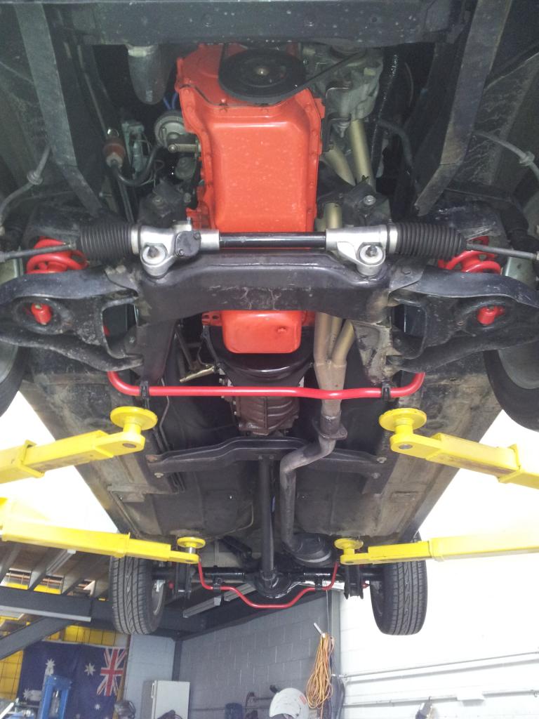

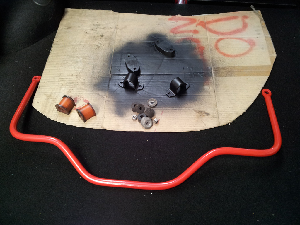

Also got my hands on an 18mm rear bar. The mounting points don't line up perfectly so I will need to change the setup a little later, but I put it on.

How do you find the helical gear type diff compares with a clutch type LSD? Trying to decide whether to invest in a TrueTrac... only shortcomings I can see are loss of torque if you happen to pop a rear wheel up in the air, which shouldn't be happening in a street car.
On paper seems to be a good compromise between a stock BW LSD centre and a KAAZ centre - both of which I'm also considering for my BW78 conversion
#118 Heath
Posted 11 October 2013 - 09:08 PM
I find the TrueTrac very good. I've been in plenty of clutch-type LSD cars including quite a number of the OEM BW ones. I've been in one KAAZ car and actually thought it was a bit much (I'm normally pretty damn forgiving towards that kind of thing).
I haven't done a lot of k's because I ran low on oil pressure with this motor recently and it's out ATM, but for the time I have driven it, I've been very impressed. Seems to be the best option for a street car at least, you could argue that a KAAZ is more suitable for track work on paper at least.

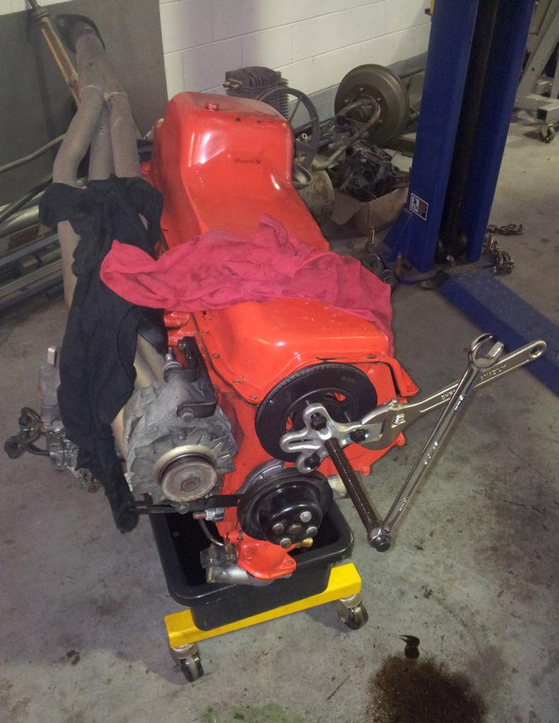

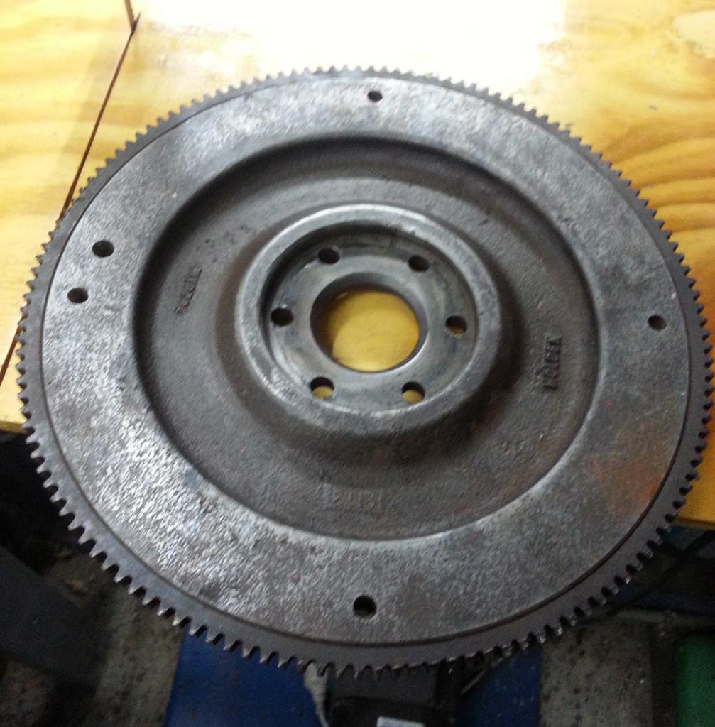

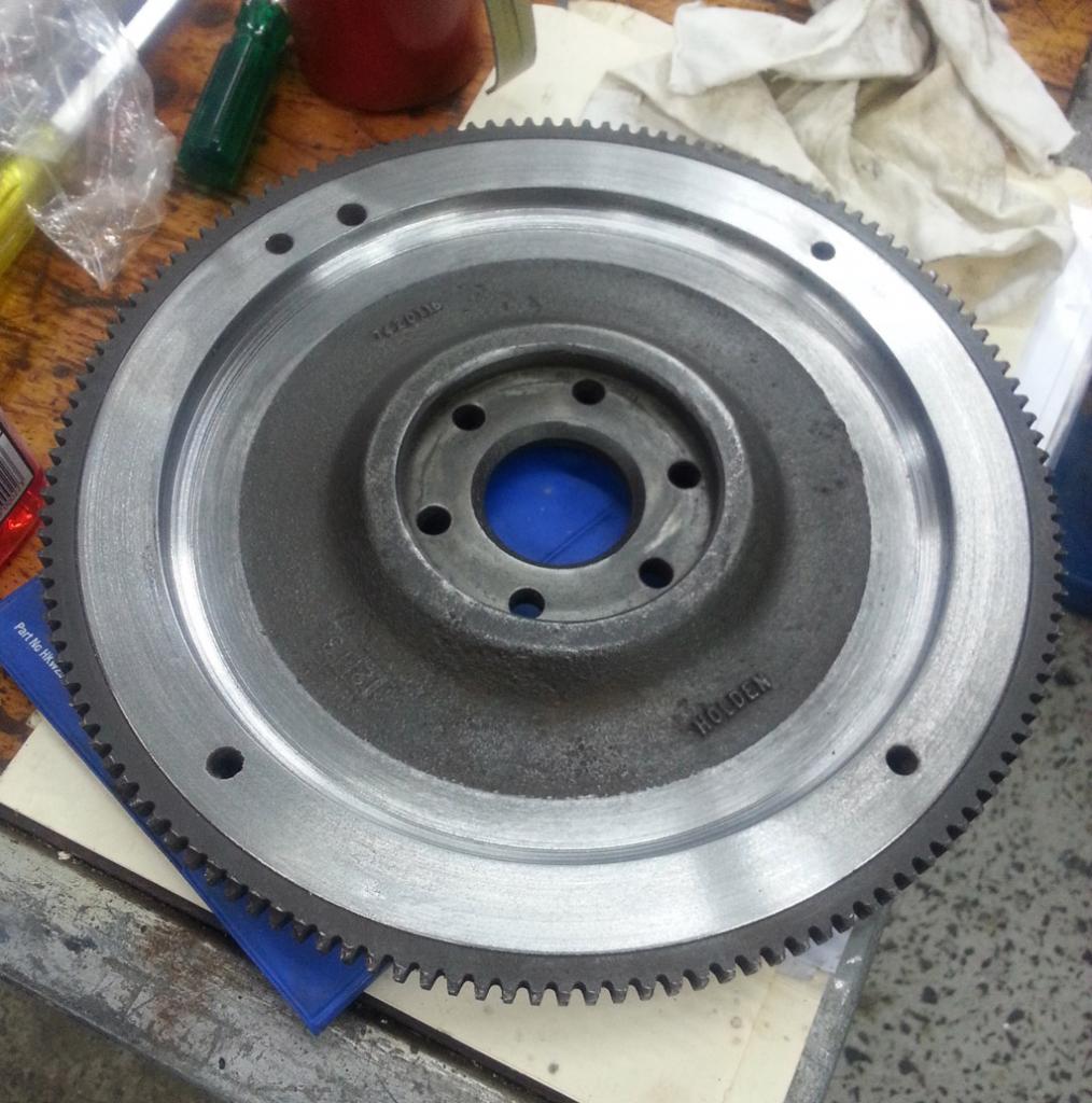

Well the motor developed a surprisingly bad leak a few weeks ago, got low on oil without me realising and through a few corners ran outta oil pressure.

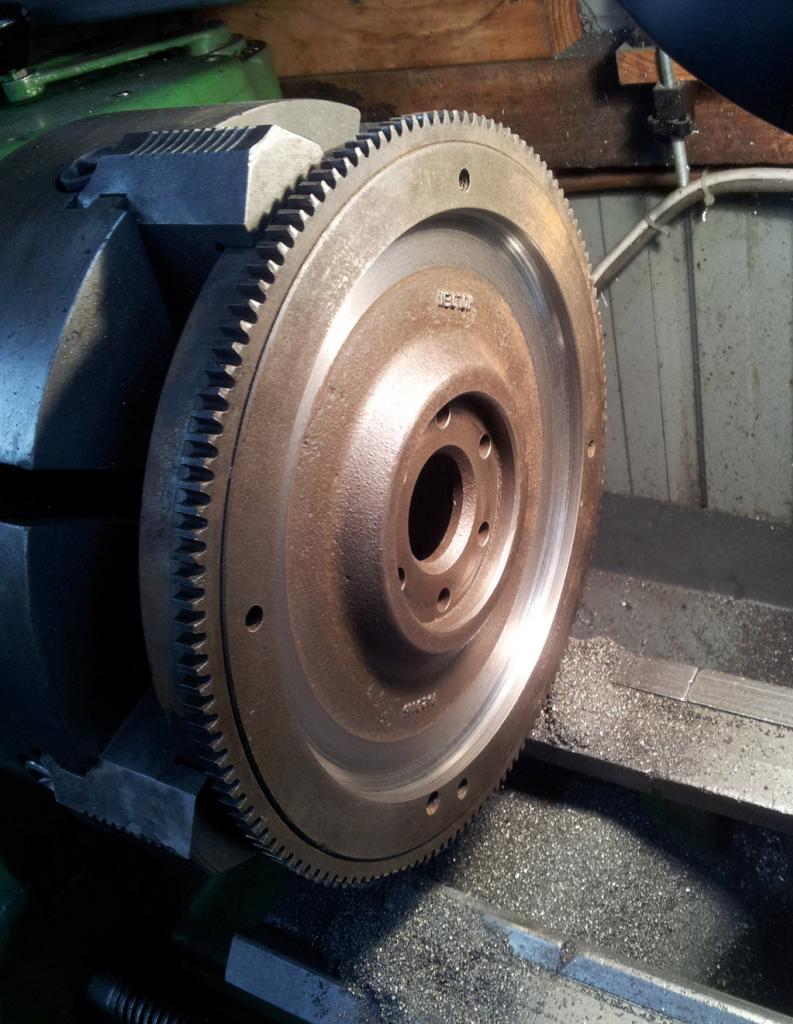

Crank needed grinding so thought it was just as worthwhile to get my spare Black 202 crank and blade the ends of the counterweights, I'll get some better photos of that when it is back from balancing.
I can't fit a Black flywheel into my bellhousing with the rat-trap clutch arrangement, and don't want to get too involved in changing that stuff around so I'm sticking with the Red flywheel which is not ideal, but I at least put it in the 4-jaw and took a bit of material off the engine-side. Would have prefered to put it on a rotating table and take proper mass off the clutch-side but didn't have access to the necessary equipment.
Gotta bit of work to do in the next fortnight or so.

Why don't you just change it to a full cable clutch?

Posted 21 October 2013 - 06:35 AM
So why doesn't the blue/black flywheel fit? Dimensions are the same as a red, except less material in the back similar to what you have machined out.
#122 Heath
Posted 21 October 2013 - 12:00 PM
Blue/Black is a nicer flywheel, but I believe the clutch to suit (which I don't particularly want to spend money on when my red clutch is perfect) is a bigger unit that doesn't clear on the rat-trap arrangement. The reason I don't change to full-cable is that it's just more parts to buy and more money to spend on a setup that will not be in the car for all that long. I know the existing combination worked well
