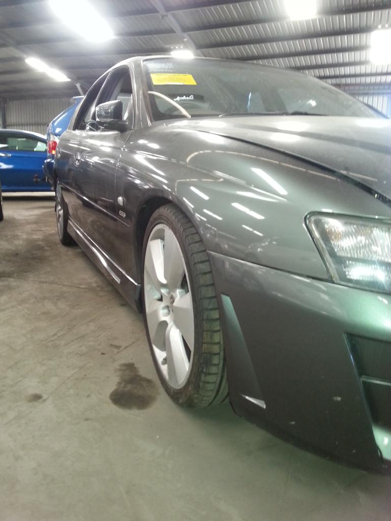

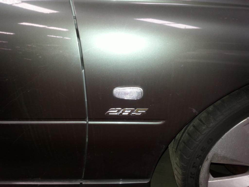

Hey guys long time no speak.
Well went to Pickles and bought myself a VY/VZ?? Senator. It has no seats in it but im willing to sell everything I can except the motor, gearbox and computer/loom as I obviously need that for the WB Stato
Ill put this on the sell section but thought I would post here too as this was where it all started.

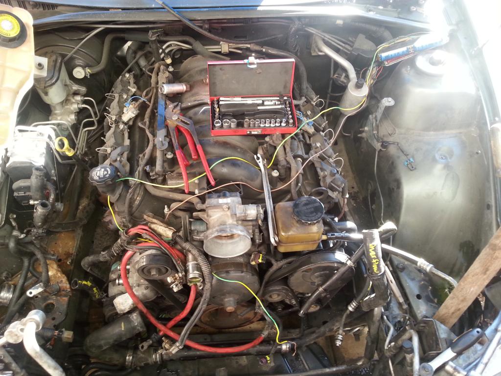

VATS turned off.
Now time to hot wire it

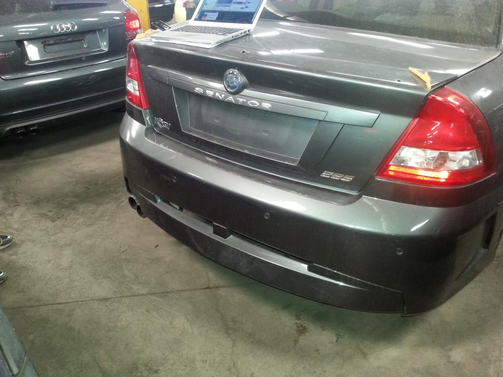

Im not sure mate, i got the stereo, cd stacker and built in GPS stuff but the sensors went with the bumbers i just sold.

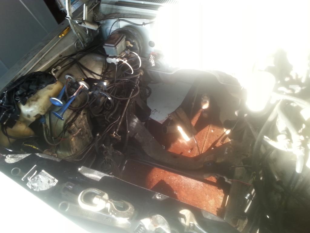

Made a home
This will live in there soon
Ignore the mess

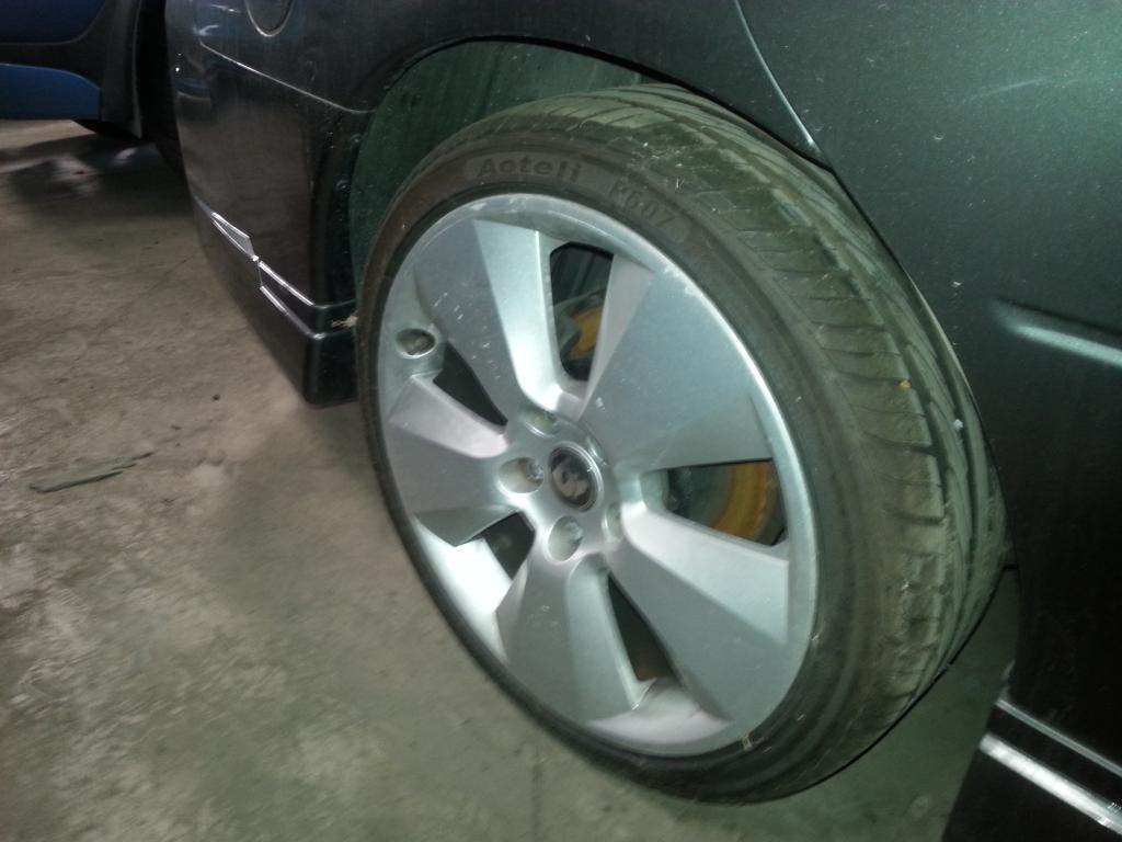

The interior is suede tany creamy colour, quite nice; the whole time I thought what a damn shame to pull this apart it was such a nice car. Oh well being a write off not much point crying over it. The chassis at the front passenger corner has come back probably an inch or so as the passenger door gaps are tight. Passenger front suspension arm is broken. So the chassis could be fixed but don't know what the go is with having it pass as a registered vehicle/chassis.
So the interior has to go, door interior, glove box etc.
Brakes
Drivers door and glass
Drivers rear door no glass
Drivers front guard
Passenger door glass, doors no good.
CD stacker
Tail/brake lights
Strut brace, but may be tweaked??
Factory radio/CD
Built in GPS but im sure its out dated but someone may want it as it would be a good fit in a similar vehicle
Wheels with 3 good tires, one tyre average.
