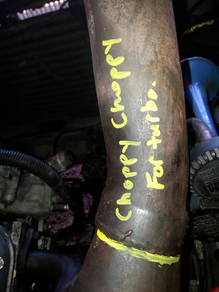

Progress is slow but heres the baby
Im hoping the extractors can be used even if they need a bit of chop chop and weld
Edited by Bart, 06 October 2014 - 07:01 PM.

The passenger side prob will but I doubt that you will be able 2 get the drivers side in, as it's mega tight in there around the steering wheel.
Cheers, Nig.

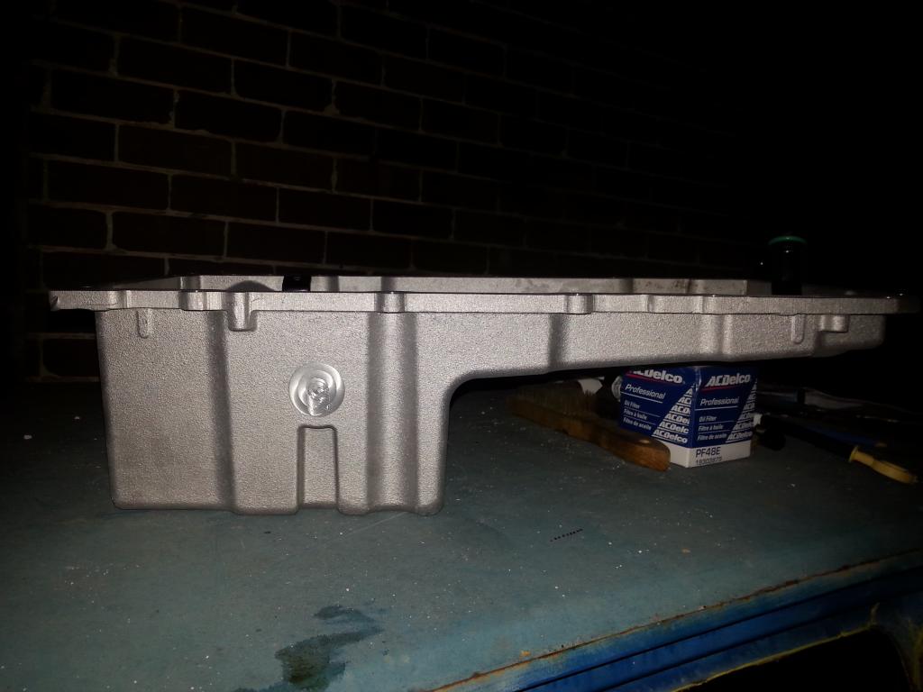

#56 Bart
Bart
    Shit a brick
  • 2,559 posts
  • Car:LJ Torana
  • Joined: 20-November 05
Posted 08 October 2014 - 09:24 PM

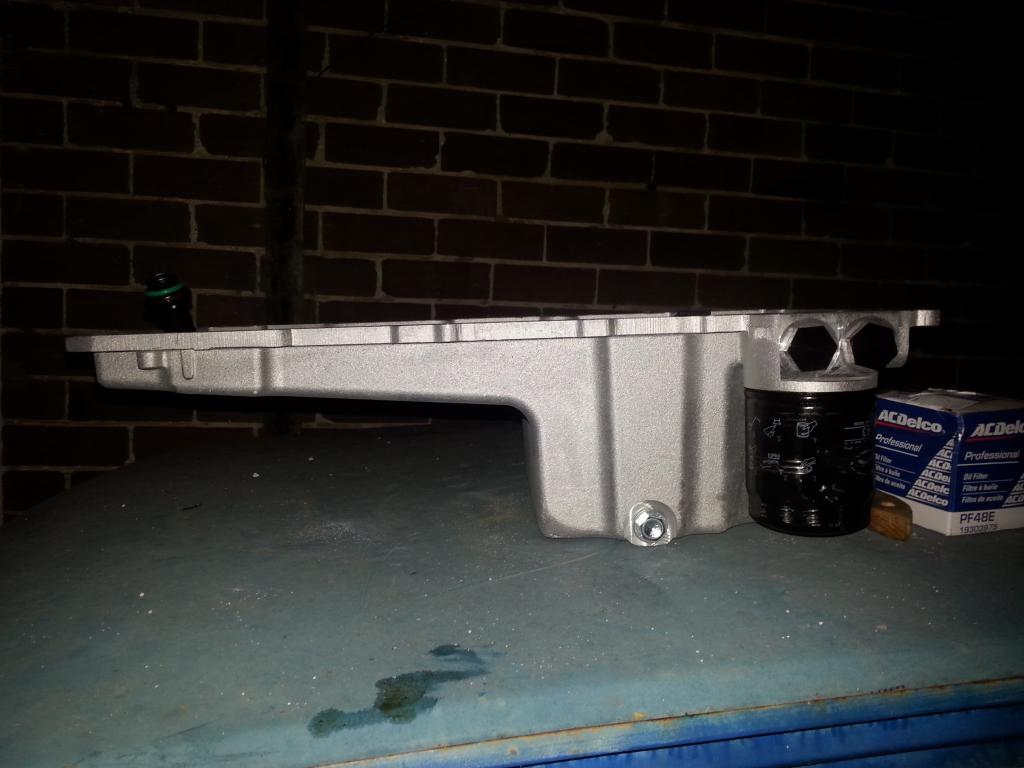

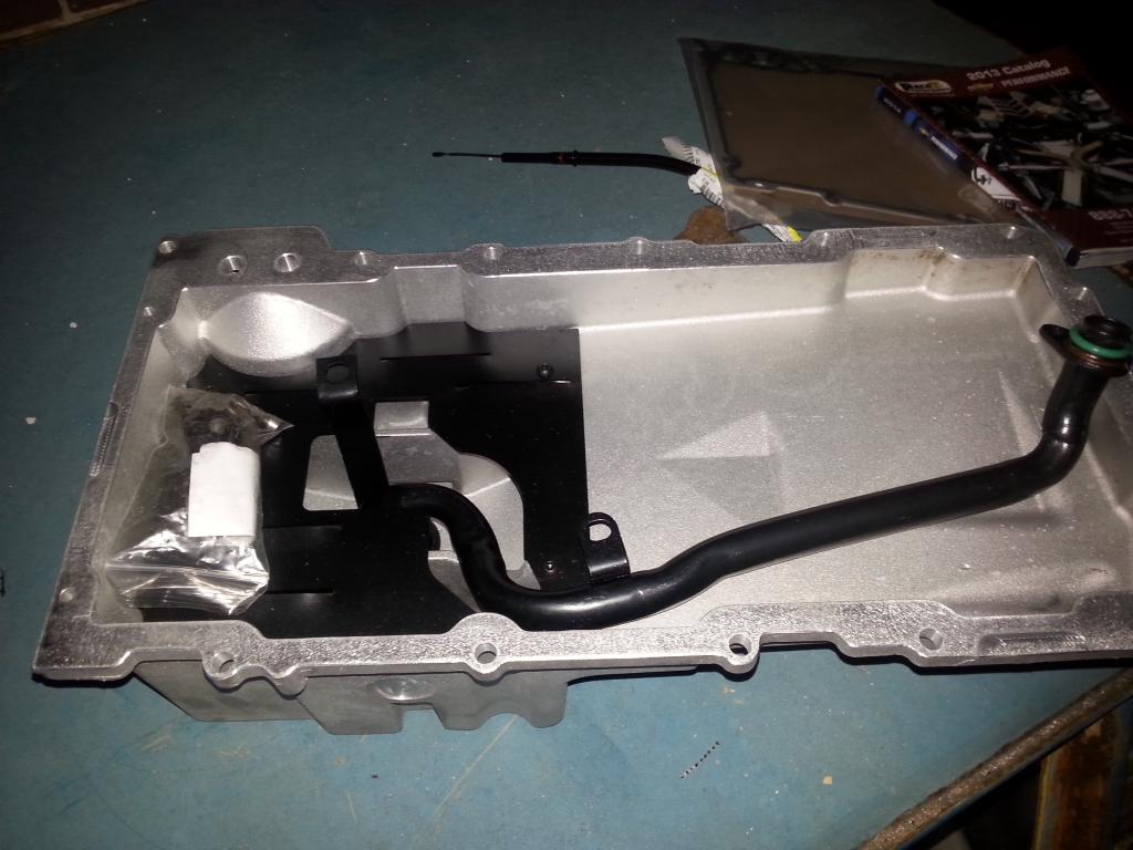

Ordered the LS Mast oil pan, gasket, oil filter, dipstick and tube. $660 delivered
#57 Bart
Bart
    Shit a brick
  • 2,559 posts
  • Car:LJ Torana
Posted 11 October 2014 - 08:26 PM
Mast LS oil pan specs
http://www.mastmotor...l_pan_views.pdf

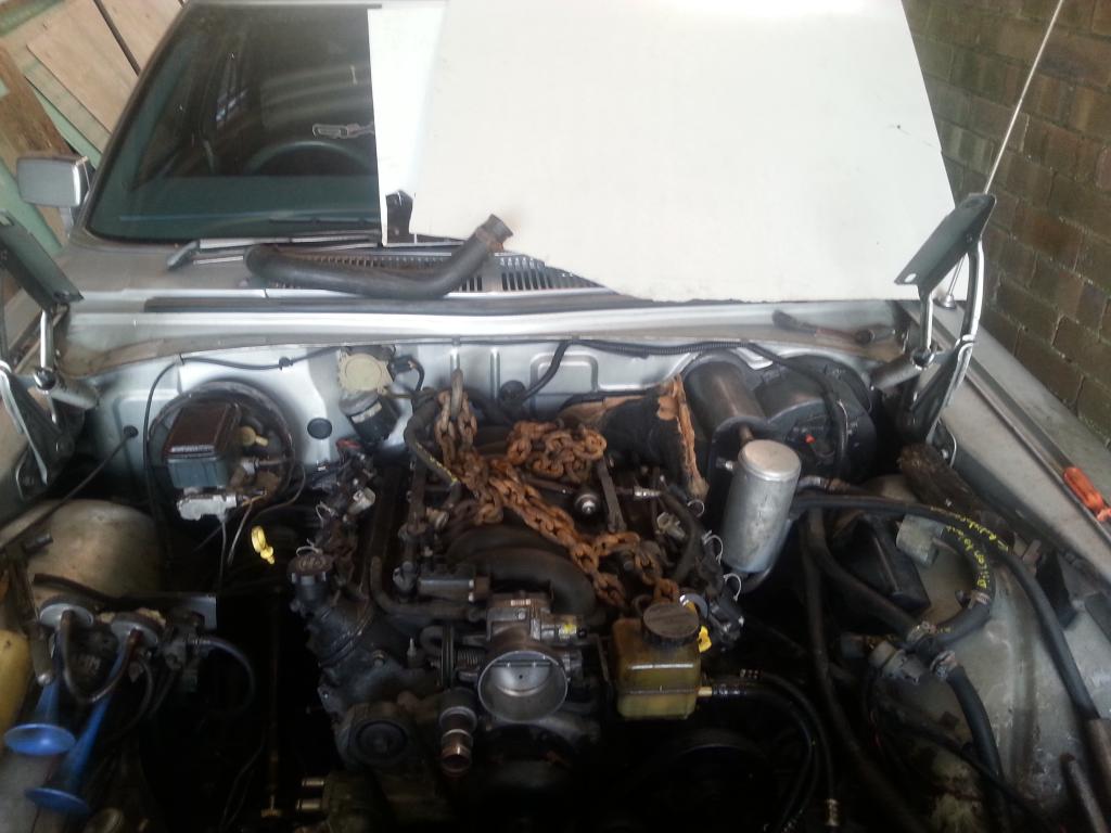

#58 _monman71_
_monman71_
Posted 12 October 2014 - 11:57 AM
Like to see when the motor is sitting in there the gap from the air conditioning box on the firewall and how the sump sits near the crossmember.
#59 Bart
Bart
    Shit a brick
  • 2,559 posts
  • Car:LJ Torana
Posted 12 October 2014 - 09:32 PM
So do I :)
Its a bit of an experiment and this is going to be my daily drive when the LJ is in the garage
#60 Bart
Bart
    Shit a brick
  • 2,559 posts
  • Car:LJ Torana
Posted 29 October 2014 - 08:31 PM
Sump arrived
#61 Bart
Bart
    Shit a brick
  • 2,559 posts
  • Car:LJ Torana
Posted 02 November 2014 - 09:04 PM
Sump fitted
#62 _monman71_
_monman71_
Posted 14 December 2014 - 04:41 PM
Is it sitting in there yet?

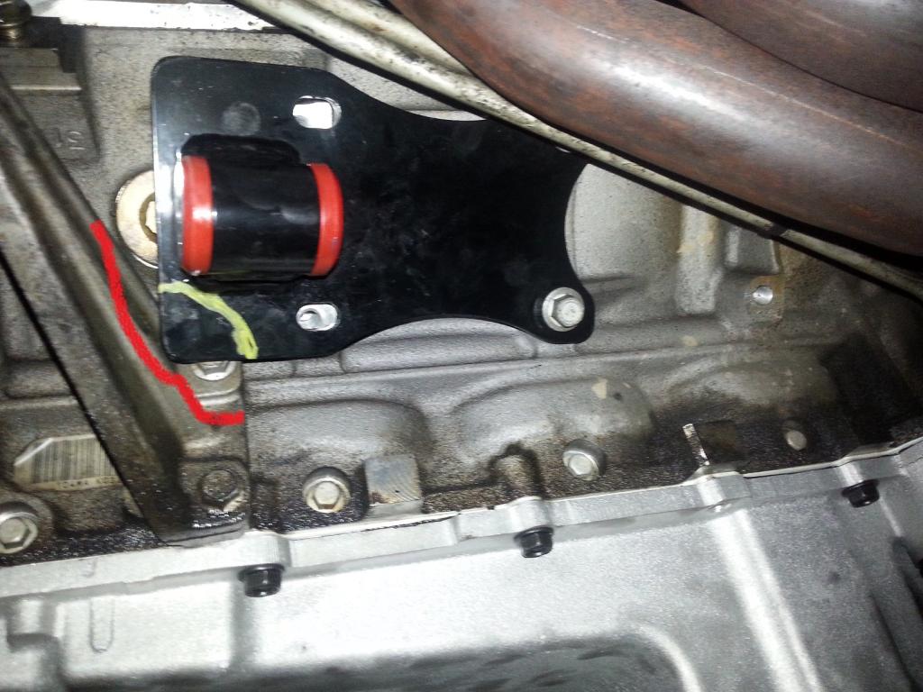

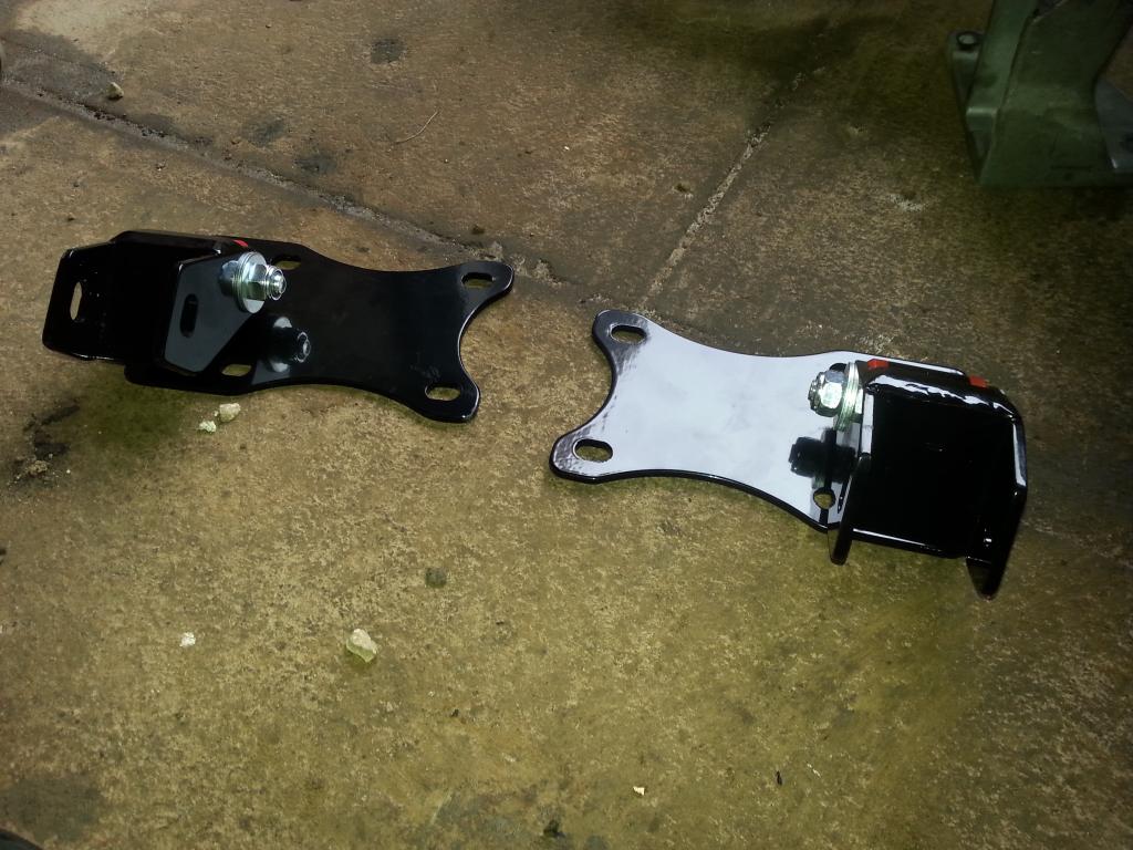

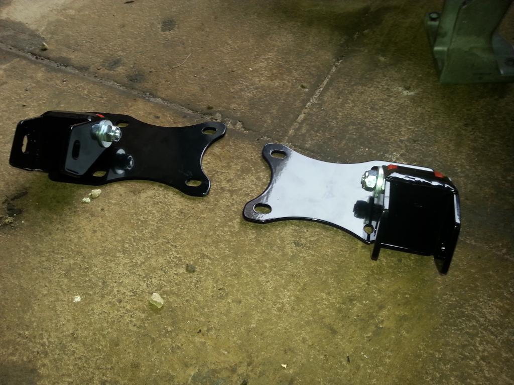

not yet mate but I got the Tuff mounts. Been renovating. Tried the mounts but they foul with aircon bracket and looks like foul on alternator bracket but will confirm later
Been playing with this too
And been making this which should be finished soon. Its aluminium 2 piece direct bolt with minimum fiddle as some of the repro out there.
#64 Bart
Bart
    Shit a brick
  • 2,559 posts
  • Car:LJ Torana
Posted 16 December 2014 - 12:12 PM
Trying figure out why my engine mounts dont fit.
Emailed Jason at Velocity Auto seems I have to cut the alternator bracket to make the mount fit.
I dont know about anyone else but at $410 I expect I shouldnt cut anything but there you go. I dont expect something for nothing which is why I paid the price but i want it to bolt on.
Anyhow Jason did help out on this and advised to cut on the red line. I marked the yellow line where i was going to cut but ill cut on the red line/alternator bracket.
#65 EunUCh
EunUCh
  • 2,774 posts
  • Location:not this planet
  • Car:japos
  • Joined: 23-November 06
Posted 16 December 2014 - 03:46 PM
Is it just me? or is that a bolt head just under the corner of the mount holding things up?
Hard to tell from the picture but is seems like your idea might be the better option ?
#66 Bart
Bart
    Shit a brick
  • 2,559 posts
  • Car:LJ Torana
Posted 16 December 2014 - 04:13 PM
I think cutting along the yellow is better but knowing my luck and the way this has panned out so far if I have to send the mount back i dont think Jason would accept it if it was cut so i am going against my gut feeling and cut the alternator bracket unfortunately.
Yes the alternator bracket bolt is directly under the engine mount/plate
#67 EunUCh
EunUCh
  • 2,774 posts
  • Car:japos
Posted 16 December 2014 - 05:05 PM
Understandable if you need to send it back but..should it fit in the first place?.lots of people have paid good money
for conversion kits only to find "small" things or in some cases major drama...i was considering a V6 conversion and was told by some
you need to cut a small section from the K frame for the starter(frok that) and by others "not with ours".
Makes you mad when when things don't pan out at least most of the way with some of this stuff..sump looks pretty good.
I would "go with the gut" feeling :)
#68 _LS1 Taxi_
_LS1 Taxi_
Posted 16 December 2014 - 05:14 PM
Delete the alternator bracket entirely.  Don't need it.
I've got the tuff mounts and mine fouled too.  Tossed the bracket over my shoulder. All good :)

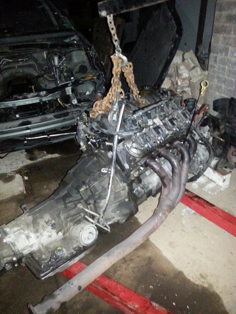

#70 Bart
Bart
    Shit a brick
  • 2,559 posts
  • Car:LJ Torana
Posted 21 December 2014 - 10:34 AM

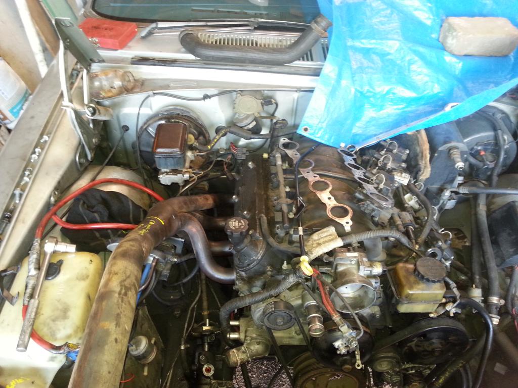

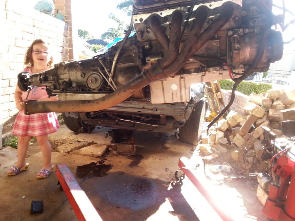

LS1 is in

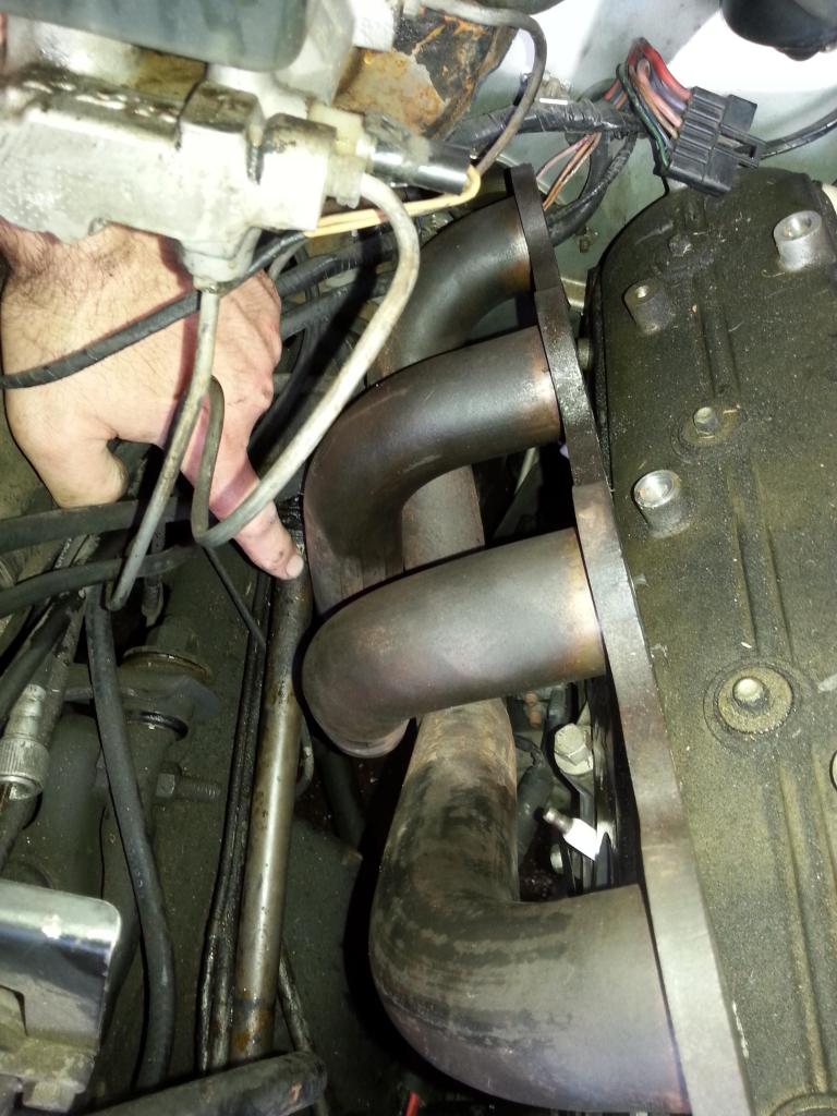

#71 Bart
Bart
    Shit a brick
  • 2,559 posts
  • Car:LJ Torana
Posted 21 December 2014 - 10:41 AM
Commodore extractors don't fit. Fouls up on the steering shaft on drivers side. Havent checked the passenger side yet.
Anyone modify one of these? I was thinking of chopping the two middle primaries where it hit the steering shaft and moving them closer towards the block/head. I think this would then clear the steering shaft. But then I don't want to ruin a perfect set of Commodore extractors.
Edited by Bart, 21 December 2014 - 10:41 AM.
#72 _monman71_
_monman71_
Posted 21 December 2014 - 01:19 PM
I knew the commodore extractors wouldnt fit on that driver side, how was the clearance with the rest of it?cheers

Posted 21 December 2014 - 06:39 PM
Hmm I think the collector will hit part of the sub frame even if the primaries were moved.
Unless I do this
#74 Bart
Bart
    Shit a brick
  • 2,559 posts
  • Car:LJ Torana
Posted 21 December 2014 - 07:01 PM
So you're saying the passenger side fits? I did try passenger side but hits the heater box. Maybe if I chnge the rear primary to clear the heater box it should fit? Or remove the heater box?
#75 EunUCh
EunUCh
  • 2,774 posts
  • Car:japos
Posted 11 January 2015 - 08:15 PM
Any chance a set of cast headers would fit a bit snugger?
You might lose a bit on performance but budget wise you might gain with  just a bit of pipe bent the right way?
just thinkin :)
