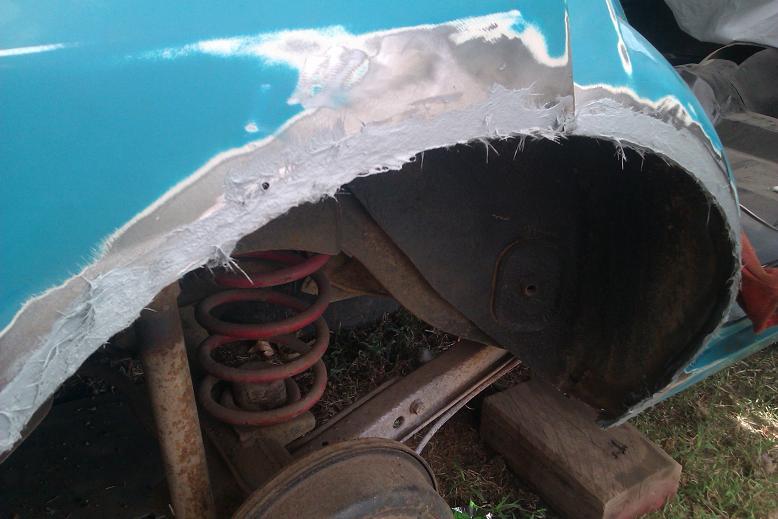

bottom one is first guard i cut (with it flipped for comparison)
close, but no great cigar.
will be hiding under flares so is cool
photo's taken tilting at different angles, but get idea

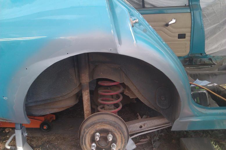

Posted 11 February 2015 - 04:15 PM
believe if i pretend the rust in the door is NOT there, for 24 hours
..then it magically disappears by itself!
so.. that's good at least.
__________________________
second one done is 'better" than first.
(which makes sense)
lucky this was just the test car, and do it for real next couple of times!
haha ;)

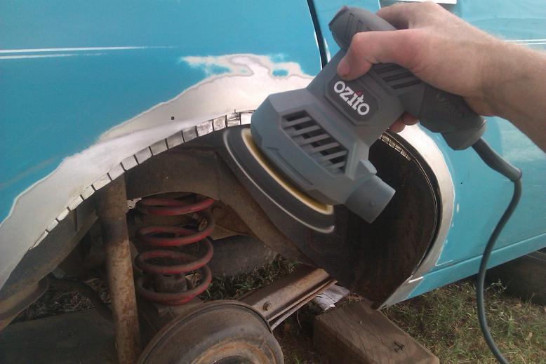

for anyone new to resto like me
do NOT buy this.. thinking it will help sand back your car.
it won't. (barely good for sanding primer to prepare for paint, if that even.)
buy a bigger more powerful model, or an air operated beast.
(fortunately got a refund.)

What grade/Grit paper were you using ?
#165 _livo74_
_livo74_
Posted 11 February 2015 - 08:01 PM
was 120, big k.
am not sure right or not. chunkyish cut back intended anyways.
but the toy, sorry, tool,
barely span with it's own weight resting on itself
#166 Ice
Posted 11 February 2015 - 08:03 PM
With tools you get what you pay for Mat there good for wood those Ozitos

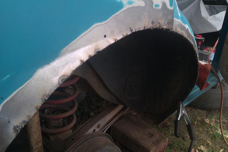

Posted 14 February 2015 - 04:37 PM

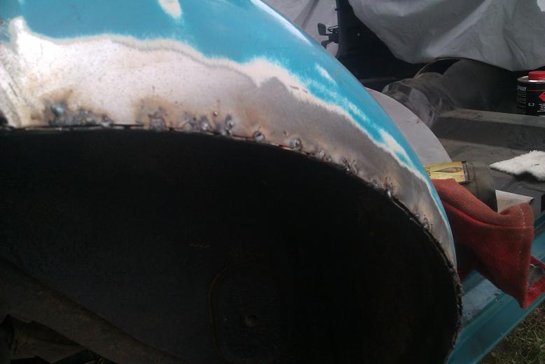

can i weld or what!
well, um, no.
it's a mess.
(and by god, am not attempting to run thicker piece along underneath, am sorry to now be saying.
would blast holes bigger than thumb trying to marry to thin sheet i would.)
but, for those contemplating welding, first time or not, has to be done.
panels don't flex when press against them anymore (!!)
so gotta be done.
fibreglass reinforced etch filler, fuzzy much!?
(wanted heaped on to fill, inside and out, so didn't care about look)

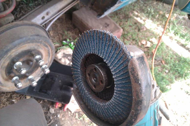

by the way, new best friend for removing paint and filler.
cut back.

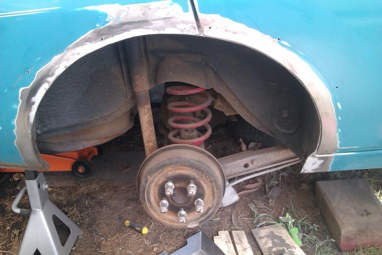

door closed
have run out of etch filler, so have etch primed and waiting to dry
so can do another filler top coat/fill using normal filler, before final sand back and prime.
#169 EunUCh
EunUCh
  • 2,774 posts
  • Location:not this planet
  • Car:japos
  • Joined: 23-November 06
Posted 14 February 2015 - 05:17 PM
For a first time job it looks like not too bloody bad :)
Have never done that before but something that might come in handy for the next one is a small  panel clamp/s and some small copper tabs (about 2mm thick and as square as needed to fit in space,it pulls the panels together and the copper bits soak up some heat and sort of helps ).
#170 _livo74_
_livo74_
Posted 14 February 2015 - 05:51 PM
never heard of that, sounds like a very good trick, thankyou :)
heat was such a bloody problem, add to that time waiting to cool even
#171 _Liam_
_Liam_
Posted 14 February 2015 - 06:09 PM
The reason why I did the flat bar curved to suit over what you have done is, all those fingers needing to be welded as well which would absolutely suck. Hahaha. You aim the wire at the thickest material and kind drag it onto the thinner or the other way around I can't remember tbh. Good job though.
#172 _livo74_
_livo74_
Posted 14 February 2015 - 06:28 PM
braver than i, is all i can say!
would of been a shamozzle if i tried it ;)
after realizing i was using my welder as a plazma cutter haha
only had the balls to tack weld the fingers
Edited by livo74, 14 February 2015 - 06:28 PM.

I'd have to disagree, I had one, and I basiccly sanded back my entire car with the same one. I used a combination of paint stripper and 40-80grit then 120 to finish it off. :)
120grit won't be sufficent to sand back paint.

I'd still avoid that brand though, for the sake of another 30 bucks.
