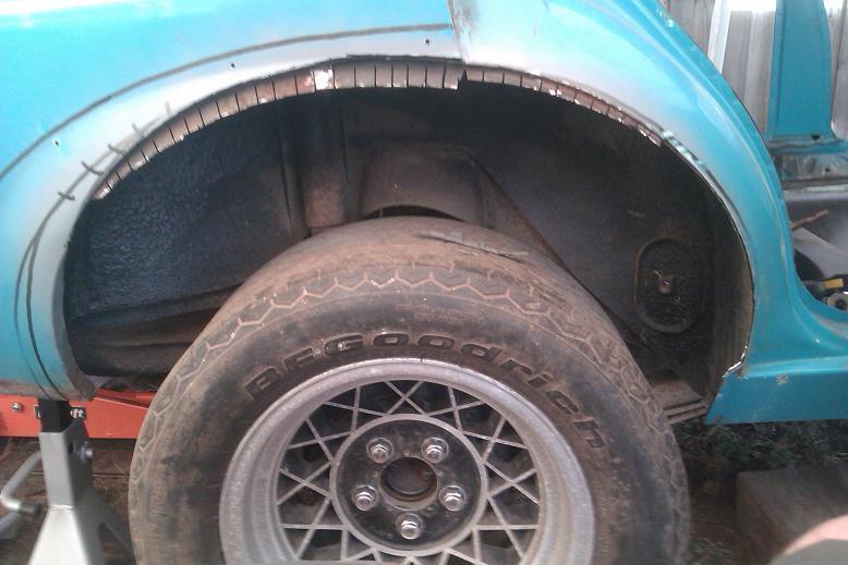

i keep looking at my cut, and am presently pondering over and over..
why not cut more?! (before i weld, as you say)
it so fkn easy and reckon would take me quite literally ten minutes a hub.
..and then ??never rub.
so, importantly, is there a limit on how much can cut??
it's a bit deceptive when looking at above pic, but it's only a half thumb more to the "arch's" top/beginning..
..but..
more and more am reckoning still worth it for even more "anti-rub",
and have been considering cutting them back to there.
is there a limit?
read in one place it was 75mm max.
i already cut 70 to be safe.
deadener contaminating the weld was ANOTHER thing had no knowledge of.

Cut as close to the rear flares as possible. More is more!!
#104 _victor_
_victor_
Posted 06 February 2015 - 11:24 PM
Hey Mat
Have you got your flares yet ?
I think until you do , don't cut any more.
Then you can match the cut with the flare & have a nice neat finish.
That way you get the max cut.

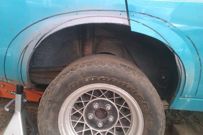

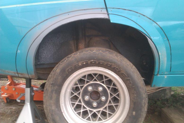

Posted 07 February 2015 - 08:50 AM
daz, victor
i do have the flares, and had held up in place whilst marking cut line.
seemed like a friggin lot at the time!!, and enough to hide under flare so not very visible (unless viewed low down.)
but it's not the max.
and am risking missing an opportunity i imagine.
haven't ever been in a lowish tory running 8 or10's at back.
sound of rubbing against tyre probably not a great sound (and scary? and eventually expensive?)
will position flares again and be cutting max.
but first,
will go to lang lang show'n'shine tomorrow, and expect get to have a look at tory or two, to gauge theirs.
ollie mentioned last night, if had been light would of gone out and taken photo of right side flare..
would of seen has a thumb nail line already drawn/scratched in the primer showing an arc running right up to the arch,
where have been pondering cutting to.
read my mind he did. :)

what i would like to do.
(photo shopped to show effect of right door/guard cut-away)
but,
so as to be wussy, and not a trail blazer.. that cuts too much and risks having to get engineered?..
am probably just doing this.. (with adjustments of fglass to bring in a 3/4 of a cm)

each to their own,
was going to piss me off seeing that guard sticking out,
..so off with it's head!
cutting back this far
requires leaving the under layer to fold over
door cut too
tomorrow,
will cut more off and by then have room for only one and a half adults in the back seat.
just kidding.
am finished this side till clean up and weld.
forgot to screw in rear of flare so is hanging off/away car in pic

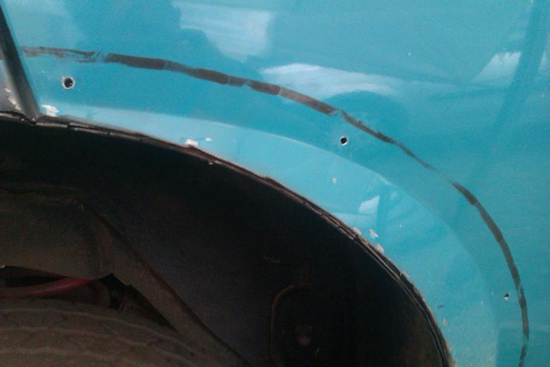

Here you go
#123 _livo74_
_livo74_
Posted 07 February 2015 - 09:44 PM
hmm, another one with no bolt closest to the door on the little flare.
was wondering if mine was a flaw originally, or an option to put in recessed bolt (if want) and cover it over..?
seems some have em and some don't.  want it secured there thinking though.
cheers al

I don't think they're supposed to have a fourth bolt in the door section are they? That wouldn't look quite right with two bolts so close together.
If you were worried about pulling the flare in tighter then you might be better off fibreglassing something to the back of the flare and securing it from the inside?
#125 _livo74_
_livo74_
Posted 07 February 2015 - 10:05 PM
a-ha! good thinking andrew.
i like the uniform bolt gap, when without that is.
but i didn't want any gap between my flares, so wanted to secure. solved it for me you have :)
