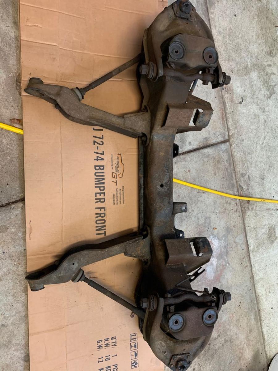

I finally stripped down the K Frame and made a bit of a mess on the driveway. I high pressure cleaned it sending lumps of grease and dirt in all directions which ended up on my boots and in the house carpet. Incredible Sally stayed calm and helped me attempt a bit of carpet cleaning.
The front of the frame has copped a hit and curled over the lip so I'll have to check it all carefully for anything out of alignment.

Your floor looks a little like mine atm 😂
When i had mine on the rotisserie there was heaps of
dirt coming out of rails at front using compressor to
blow it out.took bloody ages to get most out.still
managed a little bit in the paint lol when i primed
the undercarriage ..
Your going well mate.have you sourced the inner beaver
panel bro or you going to fab one up yourself..
Good spot Maz, the inner beaver is 40% stuffed. Looking at finding second hand if it can happen quickly otherwise I'm keen to try make a new one.
