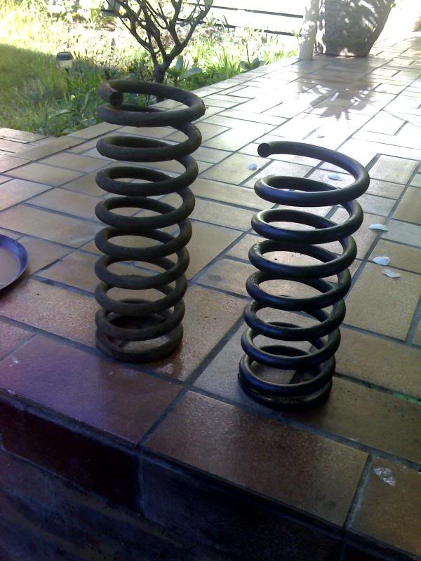

I always approach springs with a certain amount of reservation.
If its a standard height spring i'll always use compressors, but with lowereds you usually only need a trolly jack and a few stands.
The biggest thing with anything like that is to go real slow, and if anything feels wrong then stop, step back, and re asses the situation.

Do you have any form of compressors heath?
To get Maddys (Daily Drivers) Springs in, we compressed them with compressors out of the car, then wrapped them up in Fencing wire, then put them in place, bolted it all up and cut the wire out! Was a long process but it finally worked...

Nah I don't have any spring compressors. I remember you telling me about the fencing wire idea, but I kinda didn't want that much potential energy being supressed by a questionable execution of wrapping etc haha. The one I was looking at at Rob's place probably would have worked quite nicely...

I used a trolley jack, obviously, what did you think I used? With MY springs, I was not able to get them in the position that I wanted, I haven't insulted or questioned anyone's technique or advice, hell I didn't even ask for advice on the installation of them, I just went and did it and found that my lowered springs aren't short enough to just fit in properly with that method, I could have put another pair of springs that I had in (that were thicker and shorter) comfortably, but they are not the springs that I wanted in my car. It's not a topic for argument; it simply doesn't work, I didn't do anything wrong, I am over it, and don't mind pulling it apart later on down the line and having a tinker if the problem doesn't rectify itself

If the springs are not seated properly Heath, you could be putting yourself or any others that ride in your car in danger, If one of your shockers are stuffed it can affect the steering, braking, etc, so if the springs are not installed correctly, It's dangerous.

Heath, that spring doesnt look right.
And i agree with darrenmark1, fix the bloody thing before you hurt someone.
They look like standard 6 cylinder springs with a little over one coil cut off.

Uhu, I cant say i have seen every non standard Torana spring ever manufactured but i have never seen one with the top coil like that.
Personally i would not use that spring.

i gave you a couple of pairs of springs by memory. and as mentioned i had know idea what they were other than they were too low. and i remember at least one pair was yellow?? (freshly powdercoated.)

DJ, what can you see that's wrong with the spring? You do realise they are upside down in that photo, right? The only observation that I made was that the end didn't get as close to the next coil as the standard springs, but other lowered springs I've seen aren't hugely different anyway

Heath when I change springs I drop the shockie out and use a bit of hi tensile threaded rod with steel plates and nuts to compress the spring, then i remove ball joint and change spring.. pretty quick and no danger to you that way
Mate, the main thing i can see that i dont like about that spring is the fact that the bottom coil (top in the pick) sits to far away from the next lower coil where it ends, unlike standard or most other after market springs that either sit very close or contact.
My concern with this is if it is sitting like that then all the weight will be pushing down on to small of an area in your lower control arm, instead of being spread around the circumference of the spring (and the spring seat) as was originally intended.

Sure, I thought the same thing as I started compressing the spring after I stuck it in, but by the time I had actually lifted the lower wishbone high enough for the ball joint to bolt up again, it had compressed enough for a fair diameter of the spring to be 'seating' nicely, so it wasn't just resting on the point (of course if it were resting on the point, it would be trying to puncture the lower wishbone and distorting the spring simultaneously, after having a close look at it, that problem doesn't seem to be apparant at all). This will be better again when I can make sure they are sitting spot-on in the bottom of the wishbone. I think the main thing that this 'problem' is causing is that my car isn't sitting as low as it could. That is not a huge concern of mine :P
