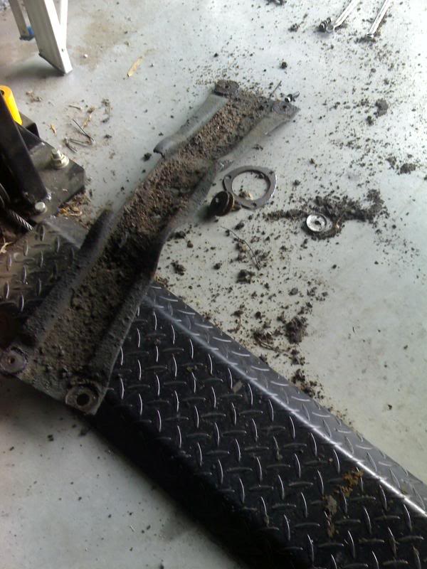

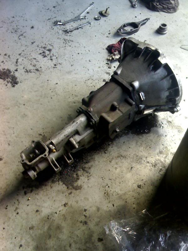

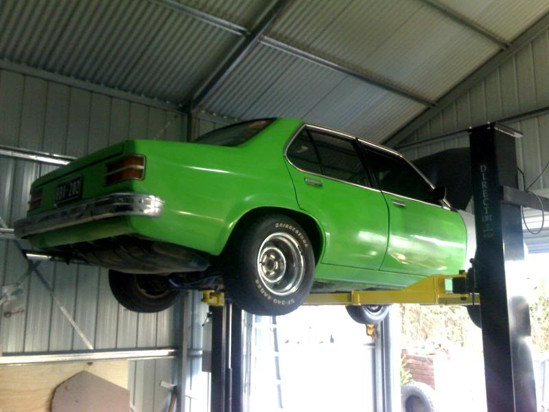

Rightio yesterday I pulled the car apart. Had access to a hoist for a day so I didn't f*ck around. Me and some friends did a good few hours of work.
I had shock rattle in the rear, so I pulled out the old shocks and swapped them with some spares I had... noise is gone now
Drained gearbox oil, dropped the tailshaft, starter, box peripherals and the box, (had to drop the front exhaust flange to get the bloody gearbox out lol) unbolted the pressure plate and clutch, inspected the flywheel and spigot bush. Both seemed fine, rubbed back the flywheel with emery paper (~300grit), cleaned all that and the new pressure plate which had a greasy coating to prevent surface rust forming. Greased the spigot bush lightly.
Crossmember had about a kilo of greasy dirt in it, and the box was coated in road grime, inside and out; bellhousing was disgusting, but the clutch looked dry. Didn't have a boot on the clutch fork either. I spent ages just scraping crap off and then degreasing it all.

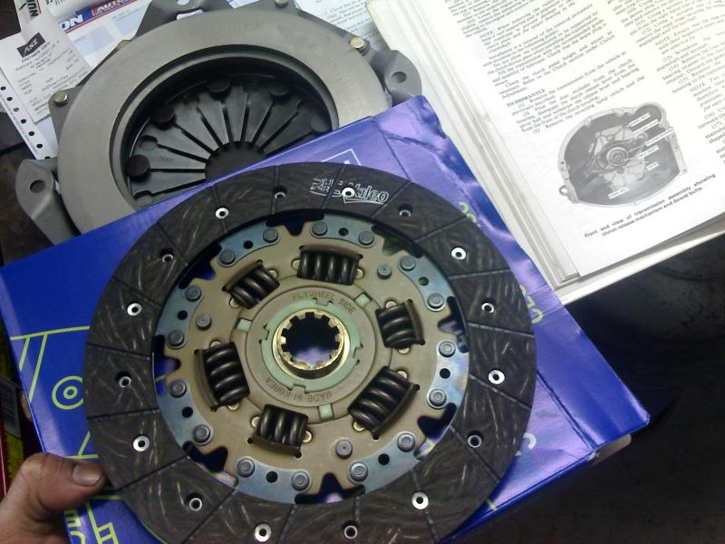

The pivot point for the clutch fork and the sheathed section of the input shaft were both cleaned and greased for smoother operation. The throwout bearing that came in my replacement clutch however, was different to the one in my gearbox. It had a smaller diameter where it meets the clutch fork, and a flange that looked un-necessary? so I had no real choice other than to use the old throwout bearing. That was cleaned out with kero and re-greased
Clean enough:
New clutch:
When I put it back in the tailshaft unis were filled up with the grease gun, and the box was filled up with Castrol VMX 90 and Nulon G70 additive.
Productive day all-in-all, things went pretty well to plan

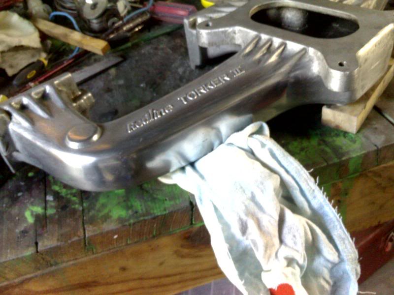

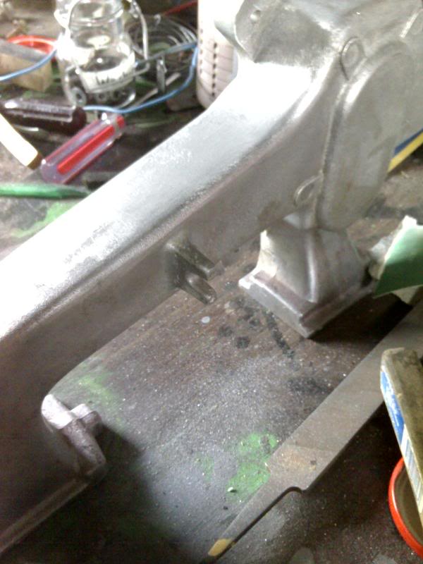

Well I conveniently received a free Redline Torker II six banger inlet manifold from Courage on my birthday (Friday) - thaks mate!
This will be mated to an Impco 300A with a two barrel Holley baseplate adapter and be my next aspiration setup. I already had a Redline Road Master V2 manifold that I was going to use, but this has nicer looking ports that suit the inlets of my new YT head better, so I'll use this one. I hate the rough cast finish so I started sanding it back and polishing it up. Looking good so far but it's pretty slow with no power tools haha. Does anyone know what these weird tab things on the underside of the runners are there for? I don't know whether to grind them off or not...
