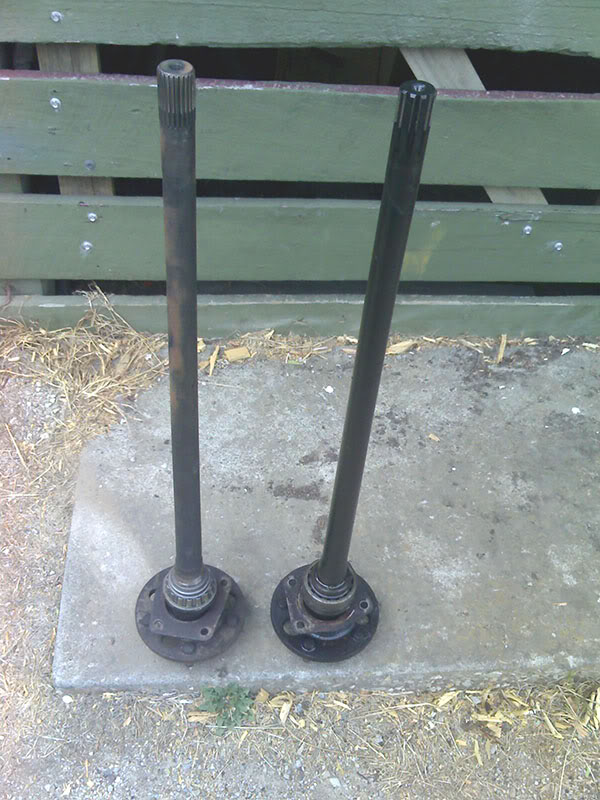

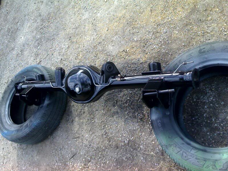

I just priced a bearing kit from Bearing Wholesalers. It's just for the centre itself not the wheel bearings on the axles (I'll do them if they make noise but I will probably end up breaking axles etc so might not bother). Timken products, with the oil seal for $95, sounds okay. I'll probably grab that next week.
Mmmmm gave the housing its final coats and have started cleaning all the little parts up and putting them back together.

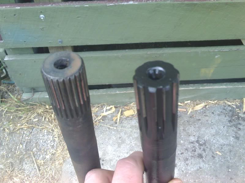

And I bought a pair of fine spline axles off MR5000 as well. Here's a comparison shot between Coarse spline (10 splines) and Fine spline (23 splines)
