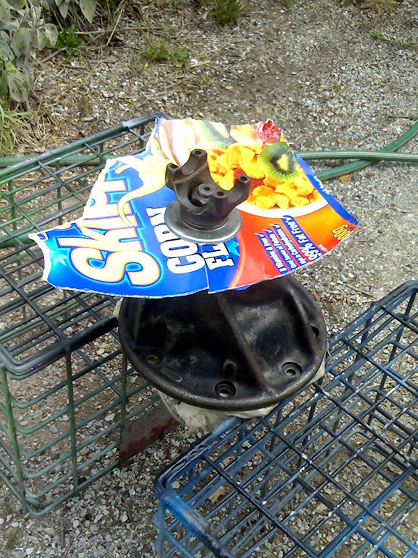

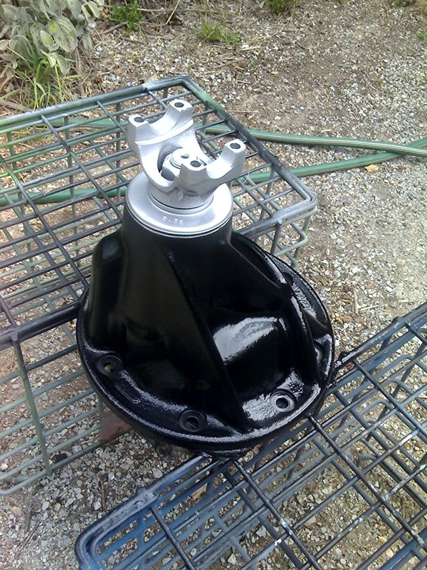

Hand scraper to get the thick dirt & grease off the flat areas, then degrease & scrub, rinse, angle grinder wire wheel most of it off, degrease again, sand corners & edges roughly, degrease again, sand back everything finely, wax & grease remover, prime, sand, prime, sand, topcoat, cut it back fine then wet the hell out of it and leave it :)

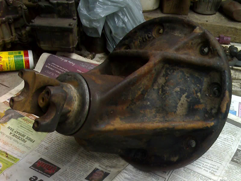

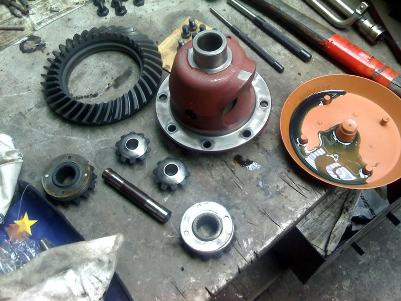

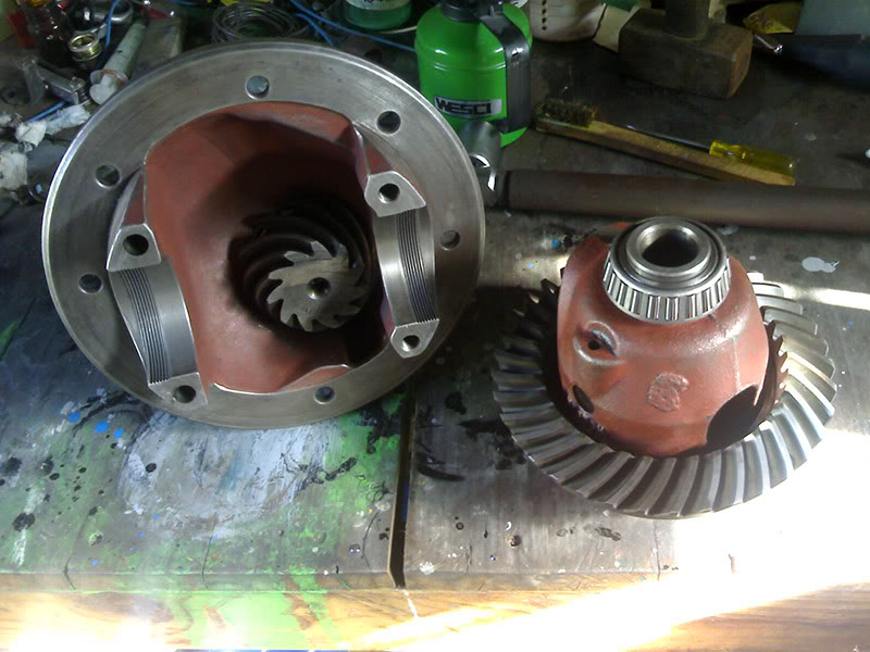

This is the whole centre assembly as I pulled it out of the diff housing. Had course side gears, and the gearset wasn't in the best condition anyway. Bearings were noisy too. 3.36 ratio if I didn't mention it in an earlier post:
Centre out:

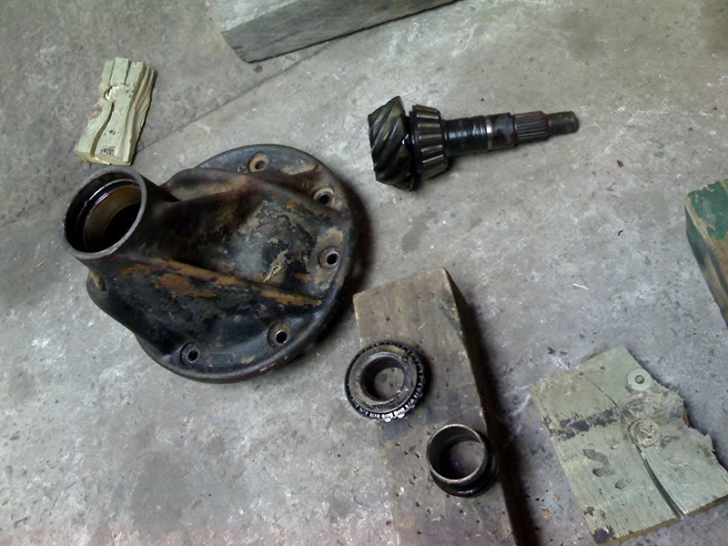

Pinion out:

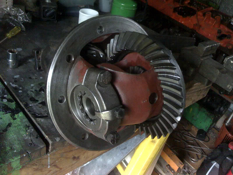

Centre apart:

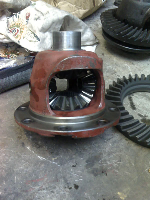

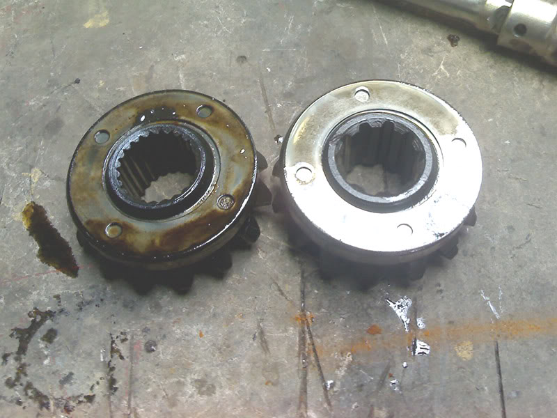

Comparison of side gears, fine and coarse spline respectively. Using fine:
New gearset in:
Ready to put it back together at home with a 'rebuild kit' from Bearing Wholesalers (bearings and pinion oil seal)

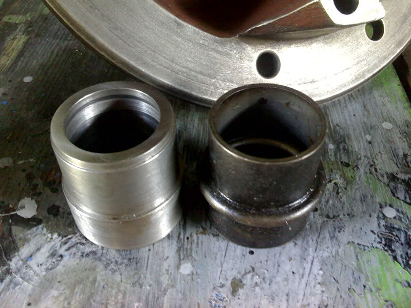

Replaced the standard crush tube with a non-compressible tube,

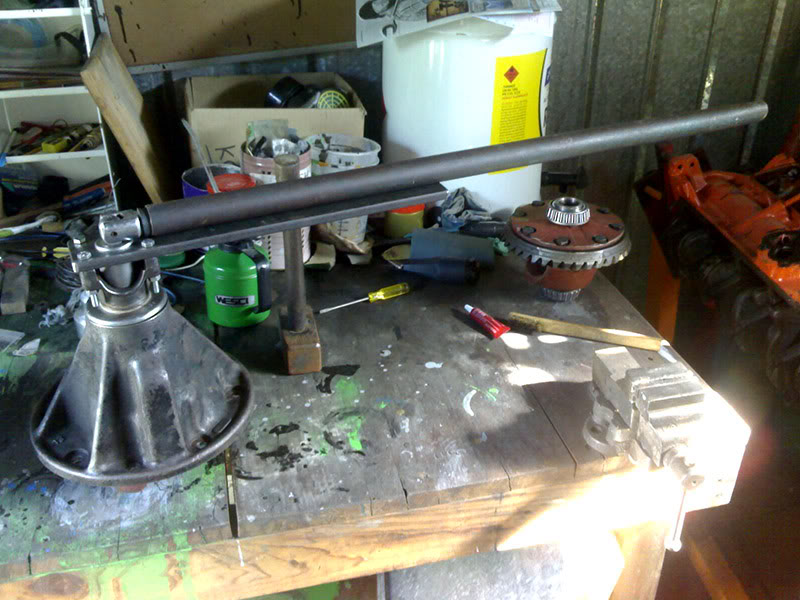

...toleranced to suit this housing and these bearings. This is just turned up on a lathe out of MS, takes a bit of buggering around to get it the right length though. Anyway this allows you to control your preload properly, and absorbs the forces that occur when the helical gearset (pinion & crownwheel) try and go in and out of mesh (i.e. when you come on and off power assuming that you actually have a man's gearbox, or whenever you go to reverse etc). This one has about 3 thou of preload and it means you do the nut up as tight as you can get it, which is where tools shown shortly come in handy

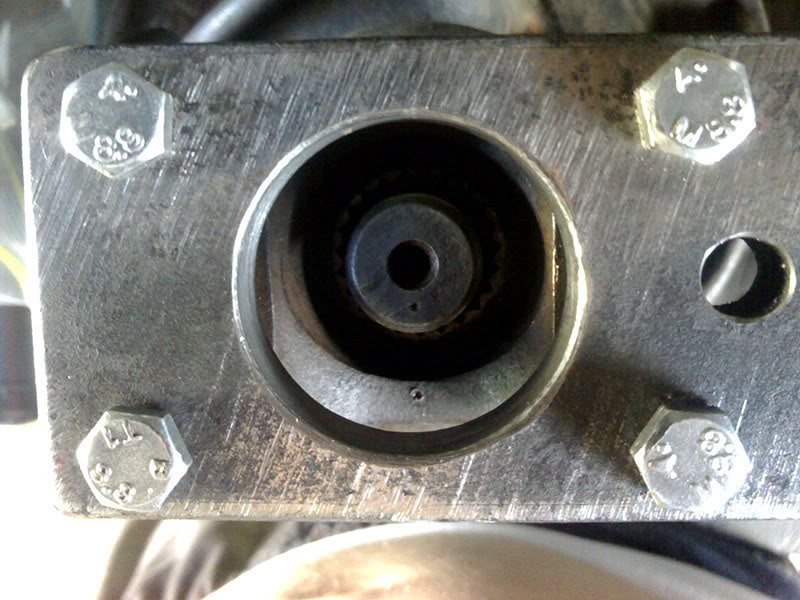

This photo just shows centrepunched marks on the pinion shaft and the yoke - just keeping them in the same relative position:
Tools that assist in applying proper torque to the nut: lol
Not finished yet though...

Nice work, did you buy the fine spline side gear separately? (most people would just swap the centre)
I'm assuming you checked out the tolerances in the spider/side gears and they are all good, along with the centre pin? Seeing as you've gone to the trouble of all new bearings and solid spacer it would be a shame not to cover everything :spoton:
Good setup with your 'tool', you need something like that even with collapsible spacers as they take a lot to compress
#1614 Heath
Posted 17 March 2010 - 04:18 PM
Yeah the tool just gets jammed in the vice and works well. If you are re-using the collapsible spacer, you wouldn't need much leverage, but I dare say that wouldn't be the best idea anyway!
I had a 3.08 Fine Spline Salsbury? Carrier that I got the gearset out of. So I had two pins and used the pin that had the largest diameter on the contacting surfaces, and the best looking gearset of the two, with the fine spline side gears. What do you mean by tolerances of those gears? Sticking a feeler gauge in the mesh or something? Because I didn't go that far.
