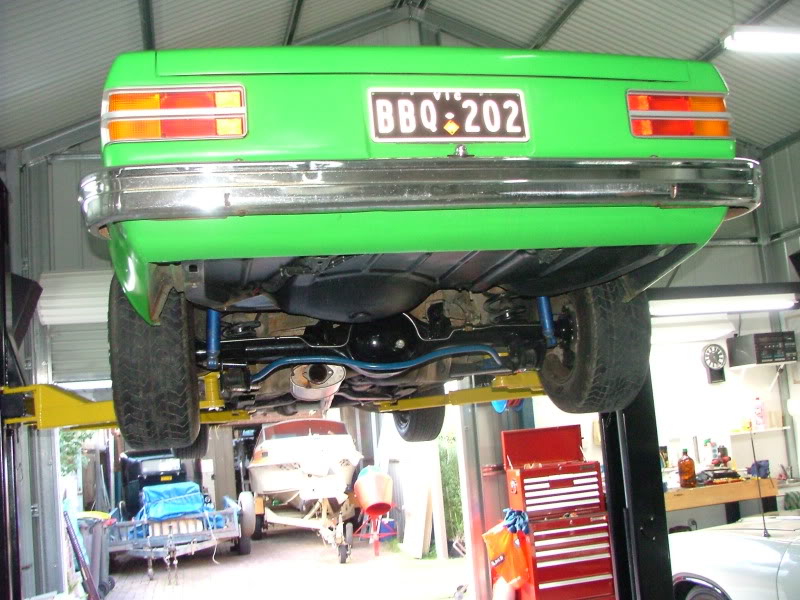

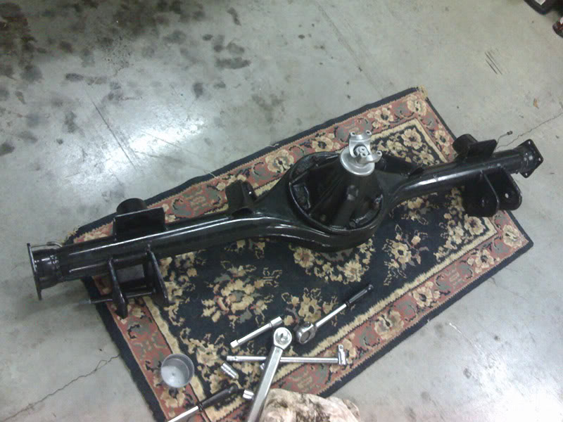

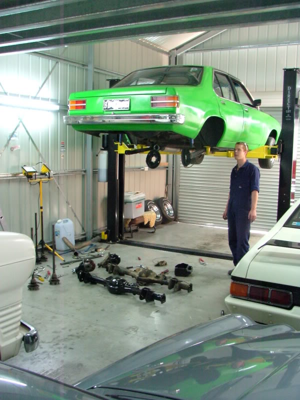

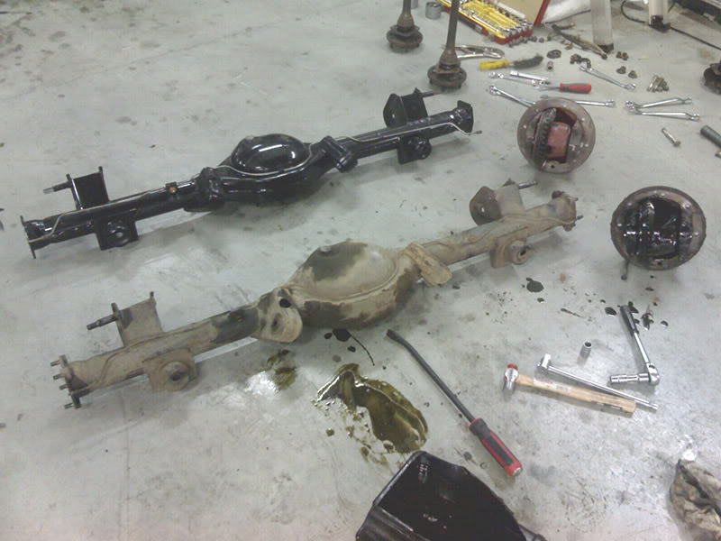

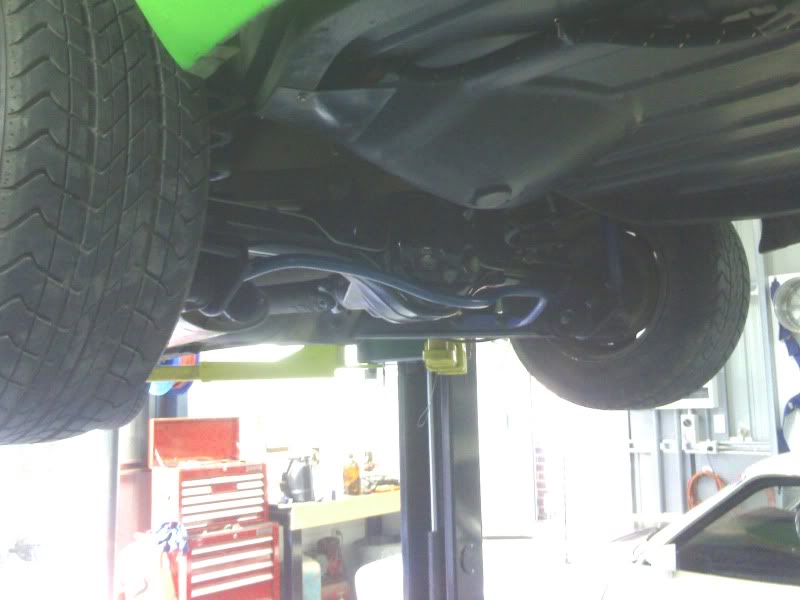

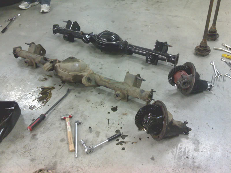

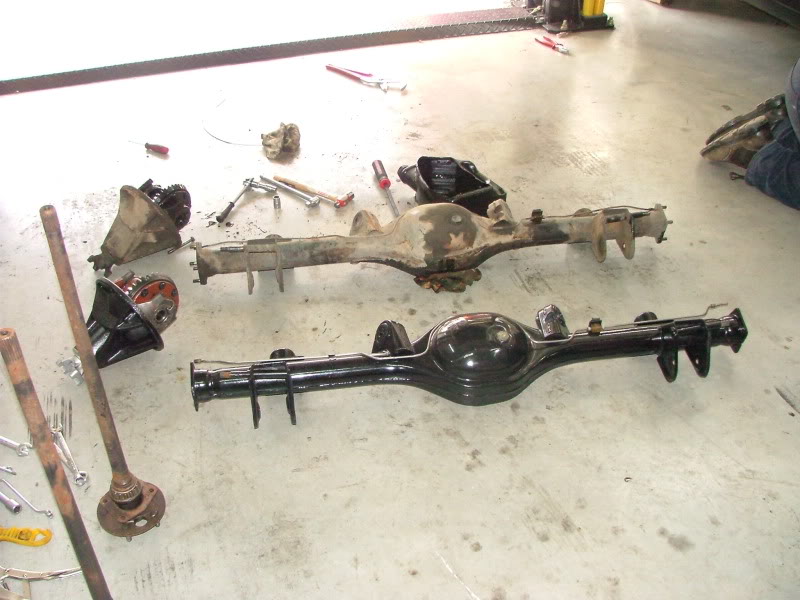

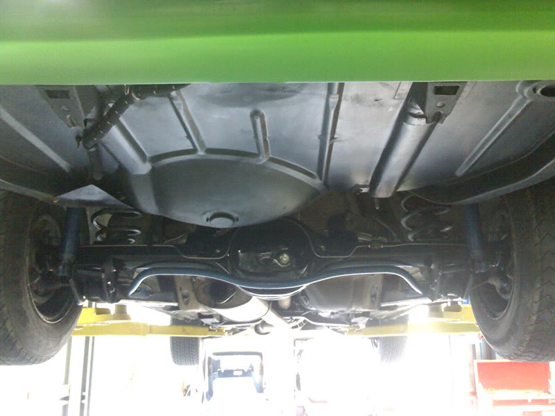

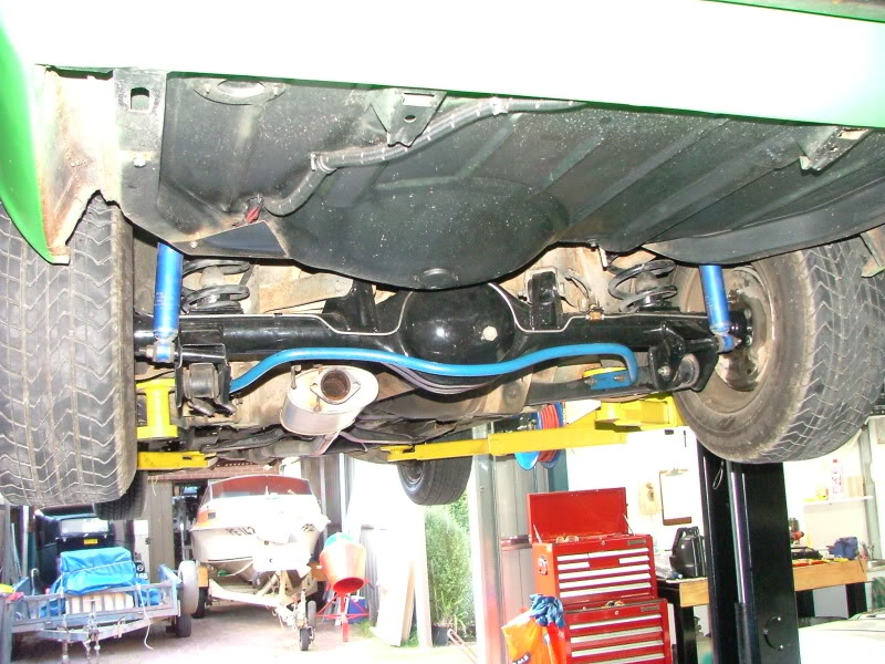

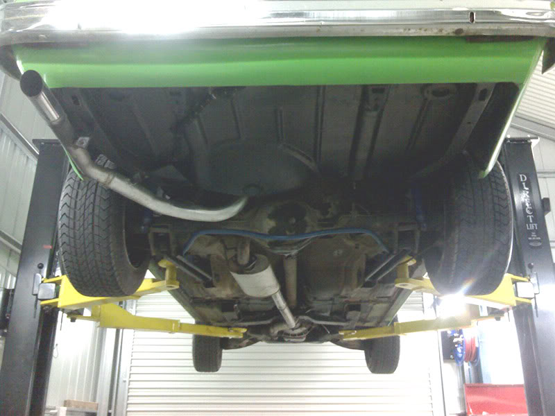

Well it all went in today, things always seem to go smoothly and predictably when you have access to a hoist hehehee. Photos aren't the best sorry
Before:
After a bit of tinkering:
Great comparison:
I was very disappointed to find that the car had CS axles, so now I have six course spline axles that I have no use for, and no spares for this car at all! PM me if you have some fine spline LX/UC axles you want to get rid of and I'll pay a reasonable price.
The 3.36:1 gearing has woken the car up heaps, it's just a much better street car now (my calculations were incorrect, turned out it had a 2.78 rear end when I thought it was 3.08). The highway cruise revs are kinda high but I don't do a lot of that sort of driving, so it doesn't bother me too much. And yeah the diff is working beautifully - doesn't make any sounds, feels great on & off power and in the transition between the two. Just loves being slammed through the gears, it's like a built auto now, don't need to kinda ride the clutch in to take up the backlash etc, just constant drive when you're feeling enthusiastic :)
Ohh yeah and I dropped the tailpipe for the drag day as well, so now the car is a bit louder (particularly inside the car, which is where it needed more volume), and with any volume increase, there comes a phony power increase, which is always good lol. I just need to go and get a turn-down made up during the week.
Whoever thought you could have so much fun with a greasy old unopened 202? I will be cutting shithouse times next weekend but I will be having the time of my life if nothing breaks :D

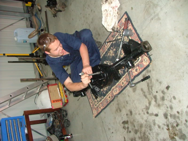

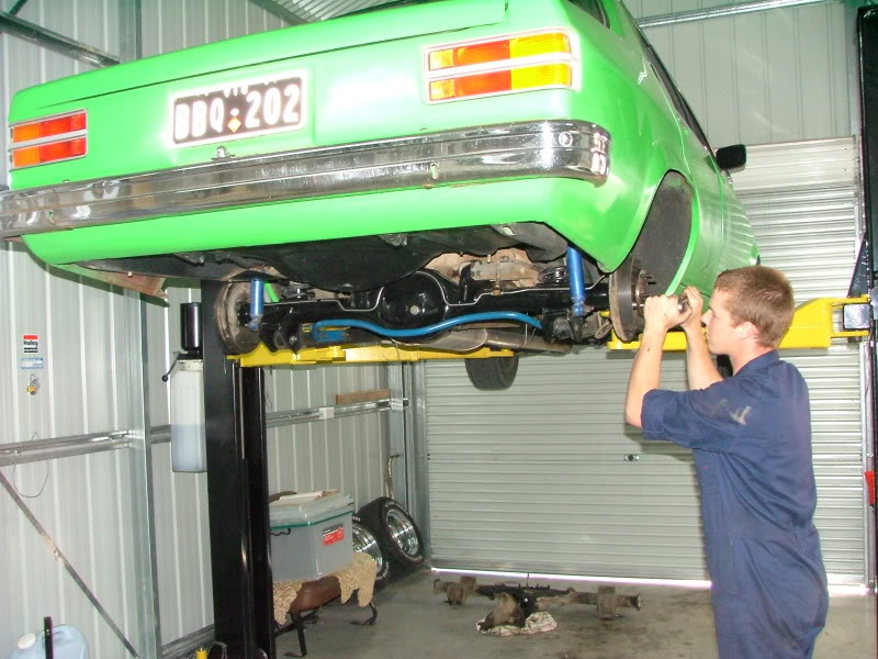

Here are a few better quality pictures, draw your own conclusions from Heath's facial expressions (particularly when filling the diff oil)
#1637 Heath
Posted 21 March 2010 - 09:03 PM
Mmmm the oil filling photos are very flattering.
