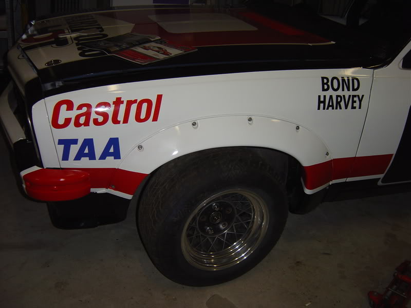

Changed some stickers.
#938 _TJ253_
Posted 18 July 2007 - 04:02 PM
the taa sticker looks better rory its not as big as the last sticker and looks better in the Blue

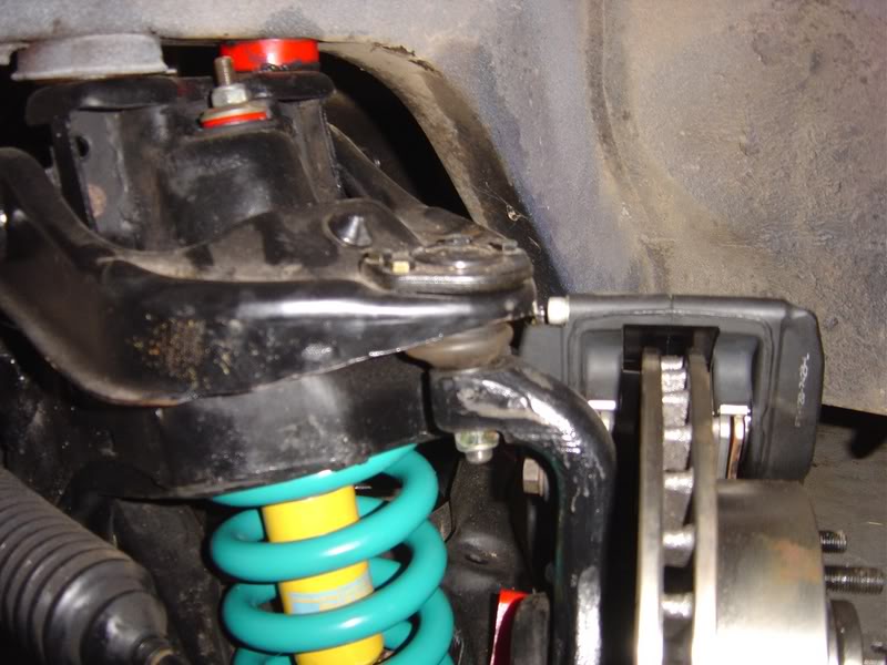

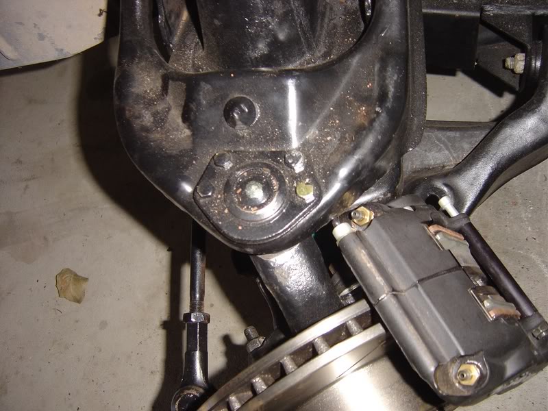

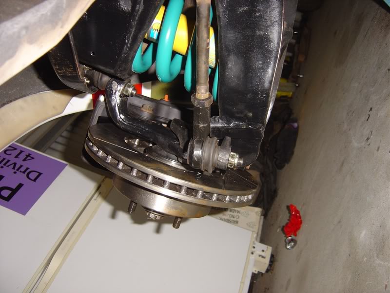

They hit the rear of the top arm on full lock..You aint gonna like this..I will post pics now I am back from those bloody awards!
#946 _rorym_
Posted 22 July 2007 - 12:16 PM
They touch at the top on full lock...the last pic shows that the steering arm isnt touching the bump stop yet ..so that needs to be packed out to stop them going so far...I doubt they will go under 15 x 8 Simmons.

Can the caliper mount to the front? Would that make any difference? I've already ordered and payed for the wheels and they are somewhere between Retros and my place! Maybe I will have to look for a different style caliper!!$$$???
Thanks for the pics Rory
#948 _rorym_
Posted 22 July 2007 - 12:54 PM
Cant do the front as you would have to grind away the caliper to clear the tierod end too much like here
http://www.gmh-toran...?showtopic=1012
