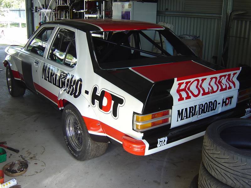

Thats look tough as mails mate.
Should look HOT on the track. Plates should now read "HOT134"

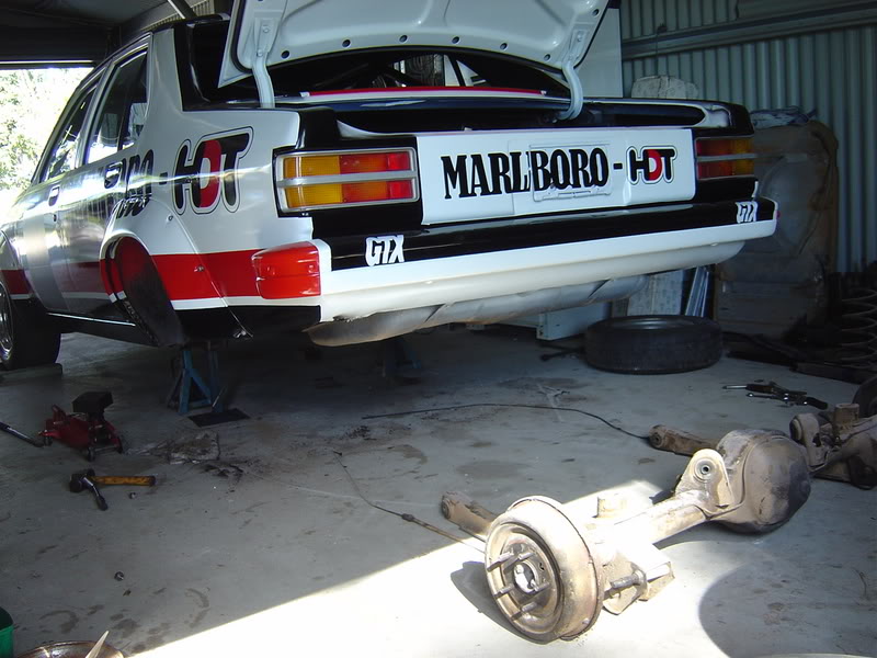

A new bottom! Sexy!

Yeah, thats the goods!

Awesome, now it looks like a race car you just have to make it sound like a race car. :spoton:

Bruuummm! Brummmm! Hows that?..Lol! No engine in yet Adam. Tomorrow the steering column gets put in and hooked up.Will pull the seats for recover.

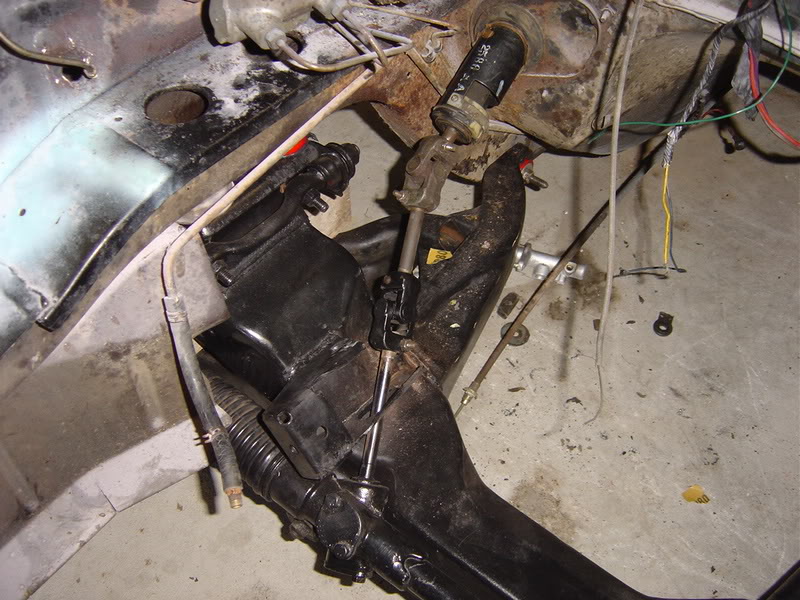

For those that have never seen...the 2 steel knuckle modification.

Do the LH/LX's just have one steel one at the top and a flexible one near the bottom as standard? Its a bit different to doing it to an LC/LJ, you've had to modify that engine mount a bit.
Actually gives more clearence Alex..the steel one is half the width of the round fabric one.

Mine is done a bit differently on the LJ. The column has been moved to the side a bit so I didn't need as much clearance as you have but the engine mount section didn;t need any modifications. There was enough room to use a custom top steel knuckle incorporating a flexible coupling and just the standard steel one for the bottom.

Rory is that because you're putting a different set of extractors in (or want clearance for some other reason), or does that somehow improve the steering by reducing the acuteness of each universal join?
Alex..On the LC I cut the rack about 4" up...so down about 4' from your bottom knuckle...just for more clearence.
Heath, It takes away the vagueness of the cloth uni joint...gives more feedback through the steering wheel but in a race car thats what you want not comfy steering for the road.

If you cut the one on your LC that far down, you must have had to modify the crossmember to clear it, like you do with the CRS steering location kit. My lower knuckle could only go down about another 10-15mm max before having clearance dramas on the top edge of the radius arm and the back of the crossmember.

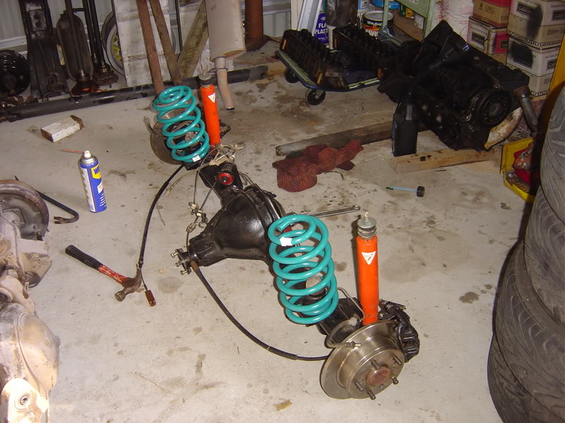

Front Bedford springs and Bilstein shocks are in..Jesus are those Billies HARD or what?? :huh:

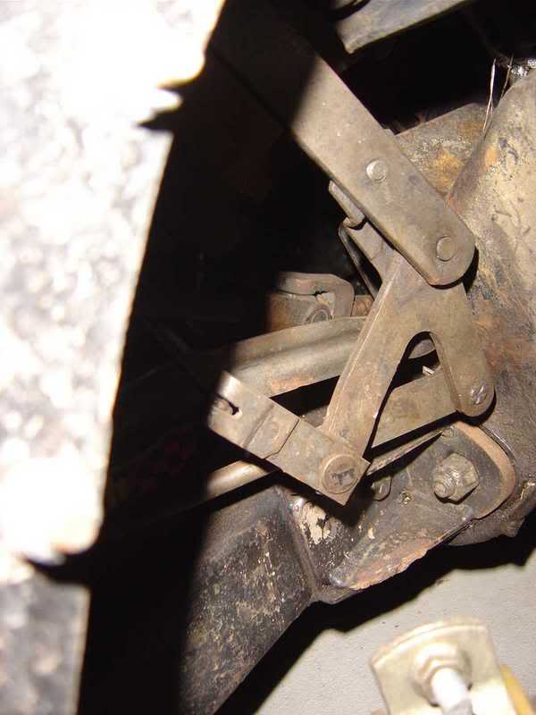

Alex..notice the knuckle in relation to the bottom bracket in the corner to get an idea of how low I got it. Also your engine mount bracket is different to mine.

Yeah, its a bit hard to make out exactly with that rat trap crap in the way, what a mess! You can see why you'd go to a cable or hydraulic set-up if you weren't going for an authentic mock up. My upper uni with the flexible coupling incorporated must keep the angle up a little compared to yours. You didn't drill the hole for the extra bolt in the crossmember to radius arm bracket, is that welded to the radius arm?
