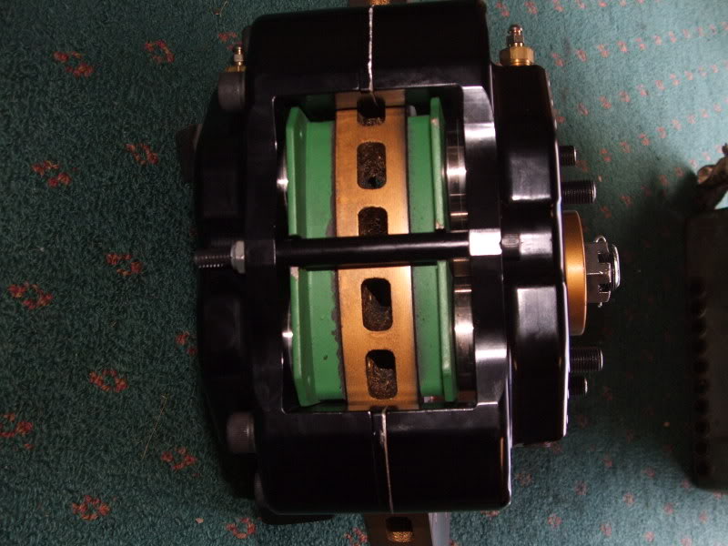

i have a question did you lower the top arm from its original mount?
#952 _rorym_
Posted 22 July 2007 - 07:02 PM
Yes..25mm.
#953 boomfunk
boomfunk
    Forum Trimmer
  • 2,065 posts
  • Location:QLD
  • Joined: 07-December 05
Posted 22 July 2007 - 07:15 PM
so if it was in the original position would they hit?
#954 _rorym_
Posted 22 July 2007 - 07:25 PM
Yeah reckon it would...but it would be trial and error...pretty sure you would still have the problem.

Thanks, so the top of the caliper where it says outlaw sits above the face-where the wheel studs are-of the disc?
#960 _LJ355_
_LJ355_
Posted 22 July 2007 - 07:55 PM
Looking at that pic it appears that way but im sure it sits below i havent got the car here to check with that setup 14''gts wheels fit no prob to give you a idea
#961 _MRNOS_
_MRNOS_
Posted 22 July 2007 - 07:57 PM
yeah problem with Rorys wilwoods is the simmons are flat on the back-unlike some rims the have a sort-of built in spacer, so any caliper that sits above the disc/wheel stud face, requires the simmons to run a spacer

#963 _MRNOS_
_MRNOS_
Posted 22 July 2007 - 08:00 PM
Looking at this pic i'd say its the same as the wilwood/simmon problem
Edited by MRNOS, 22 July 2007 - 08:00 PM.
#964 _LJ355_
_LJ355_
Posted 22 July 2007 - 08:03 PM
Ahh ok i know what you mean ive only had the gts and a set of welds on mine and i think they are stepped out a bit damn wish the painter was finised with my car i would tell you exactly how it is
#965 _rorym_
Agree..If it is that wide...which is wider than the alloy WB..you are stuffed. Welby!..NEXT??

#969 dattoman
Posted 22 July 2007 - 08:51 PM
Outlaw are a cheaper copy of the already cheap Wilwoods
My experience with them is they flex like a bastard
And yes we still have wheel issues as the caliper sits past the BUF by more than 10mm
So we need a wheel that has a bit of centre to it
The Simmons does
But the caliper fouls on the bolts on the back that hold the wheel together
I'm going to have a measure tomorrow to see if its possible to use a shorter bolt and thinner nut to clear the caliper
And PM Welby for the wheel studs

#971 A9X
Posted 24 July 2007 - 10:38 PM
Yeah its either, use the wilwoods, but not the simmons, or the other way round, although sounds like Welby is having problems with a few wheels fitting over the wilwoods
You are dead right MRNOS.
Although i'm not running Willwoods but Harrops, we have the same problem Houston.
My current angle is back to Retro (Simmons) to modify the wheel. This is currently underway and i'll have an answer ver soon (i hope).
