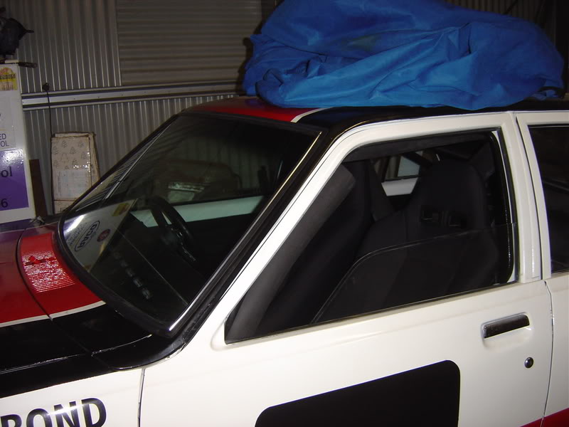

Got a 57L foam filled race fuel cell with sender, the seats are back today...look horn, got a 2 L oil catch can arriving..dropped the cam off ...slowly, slowly...windscreen guy bailed..its pissing down here..he is doing the screens tomorrow...

Glass is in,seats are back, rollcage rubber cut and ready.. fuel cell arrived. Talking to Tyre Tech at Albion Sat to sort out which slicks I am running.

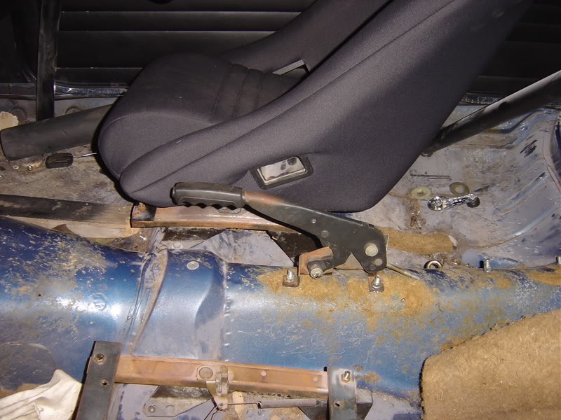

UC handbrake bolted to the floor...the pin needs to be lengthened then through the floor......

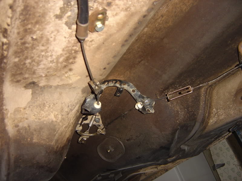

To pick up the Nissan single pull handbrake cables...I just bent the bracket to the shape of the floor then bolted it up...

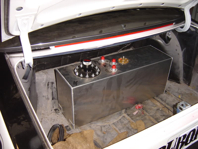

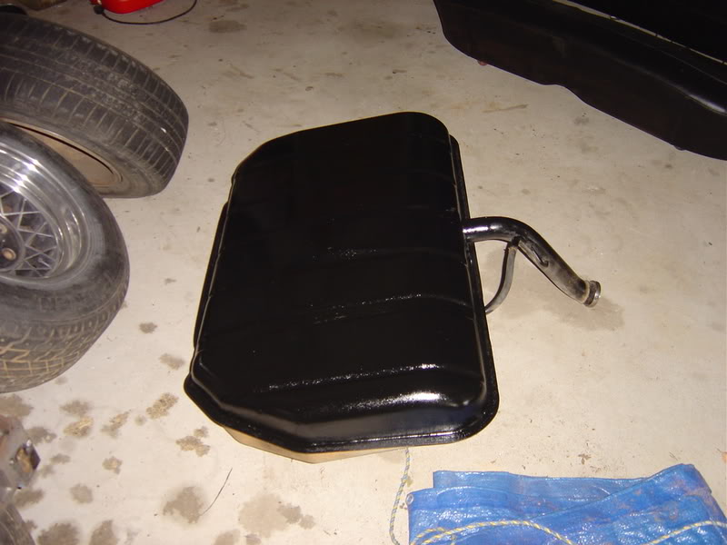

The fuell cell is drilled and ready to bolt in, I took out the old original fuel tank as it had a huge dent in it and have the good one I got off Big John all painted up and ready to go in.
