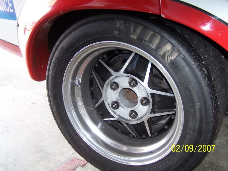

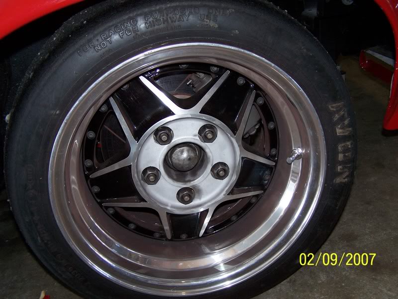

Posted 03 September 2007 - 10:34 PM
SOME PICS FOR YOU RORY. Don't know if these are any help for you or not

Posted 04 September 2007 - 06:38 AM

Posted 04 September 2007 - 08:45 AM
Yes the HDT L34, Simmons B45's machined to look like Globes
#1023 _MRNOS_
_MRNOS_
Posted 04 September 2007 - 08:47 AM
Rory's not running simmons anymore, but I will be so those pics will come in handy I didnt manage to get any closeup shots of that car, although for display wheels for my car that "reda9x" sedan there gave me some ideas :clap:
So that was you Red taking the photo!, I was there talking to my friends when u took that photo, I was up there in my car, and when I was out looking at the Torries, i was trying to work out your car,was it parked in the Skid Pan?
