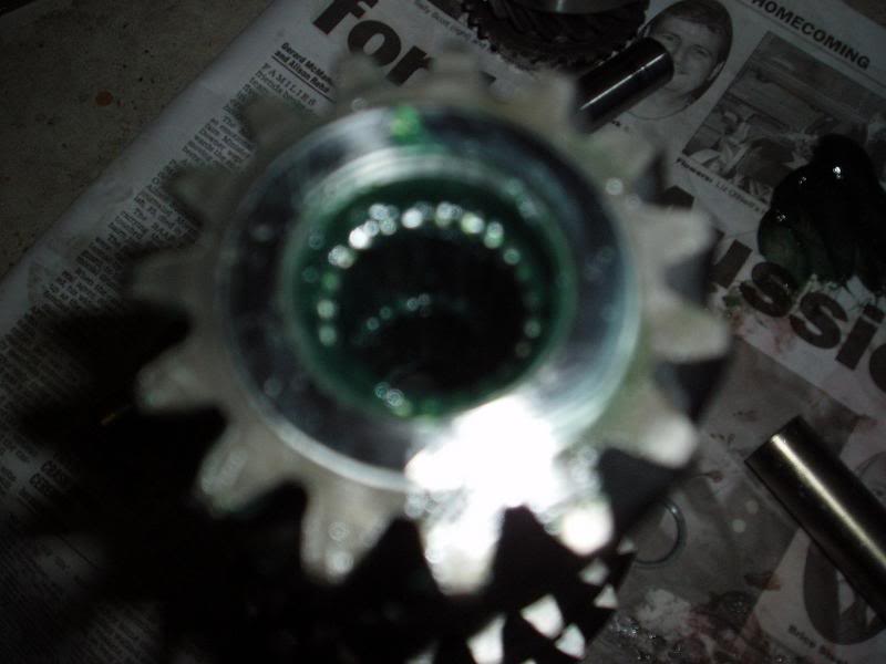

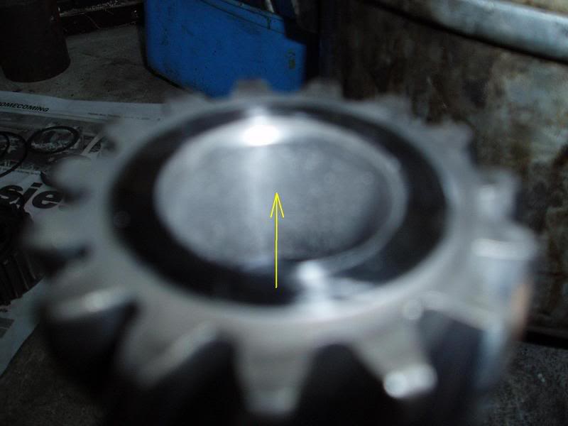

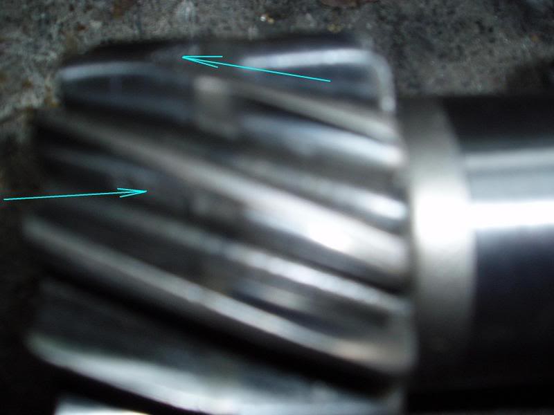

Cluster gear.
The arrow points to the bearing surface for the needle rollers in the 1st gear (small gear) end of the cluster. With time the hardening comes off this surface and the flakes of metal accelerate the wear process.
Lay shaft.

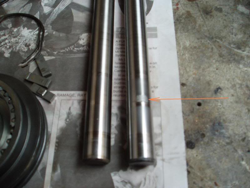

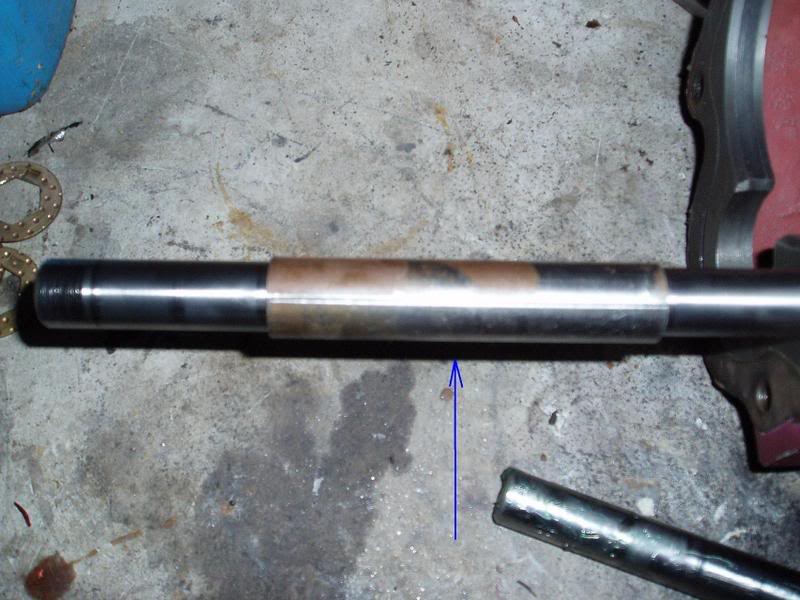

This is the shaft that supports the cluster gear. Again the hardening is coming off.
As these bits wear, and also the needle rollers, the gears begin to run out of mesh and the hardening starts to come off the gear teeth indicated with the arrows. This cluster was actually rubbing on the reverse gear idler boss in the housing it was that stuffed.
Another gear that commonly suffers this fate is the input shaft gear if the front bearing has been collapsed and driven for too long. Any gear you find with the hardening damaged is not worth refitting and any gear that it meshes with will also more than likely need replacing.

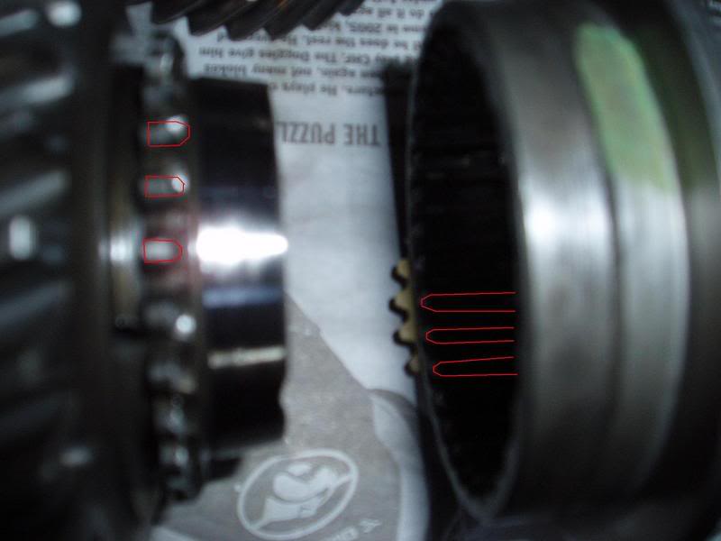

"Dog teeth" and synchros.
Some books call these splines?
This pic shows what good ones look like. They are tapered to "hold" themselves in gear while torque is applied. The pics aren't the best but I hope you can see that if the gear and the coller were engaged and torque applied that they would pull themselves together. The red arrows point to the tapers and the yellow arrows point to the lead in. Any damage on the lead in indicates a synchro problem (crunching).
This pic shows worn ones. If you see this type of wear on a dog it should be thrown out as it has been jumping out of gear and will continue to do so. As the tapers are now worn in the opposite direction, these components would try to push each other apart (jump out of gear) when torque is applied and no detent spring will be strong enough to stop it.

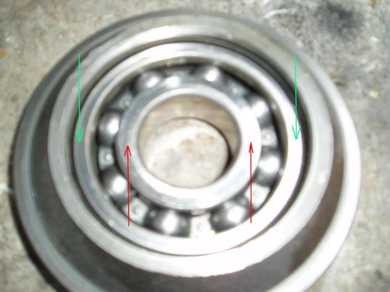

The next pic shows where to hit the bearing when fitting it to a housing (green arrows) and where you would hit to fit this assembly to a shaft (red arrows). If you hit where the red arrows are when you are fitting a bearing to a housing you are using the balls in the bearing to transfer the impact and can damage the bearings. Get it? This applys to any bearing, wheel bearing, alternator bearing etc.
Also applys when pressing bearings on.

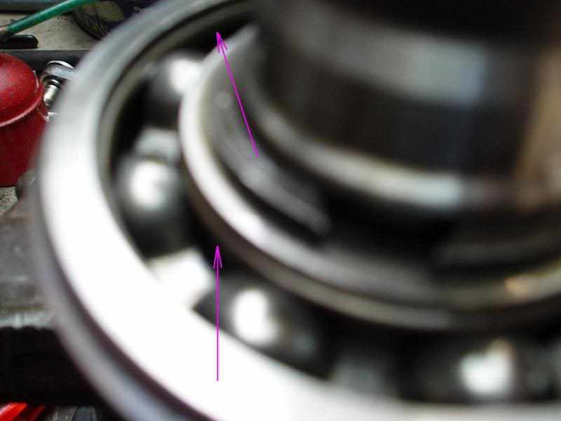

Snap rings / circlips.
There were some dodgey g/box bearing kits around (maybe there still are?) that supplied skinny snap rings that didn't fit the grooves in the shafts and housings properly. This can let the gears on the mainshaft "float" and this then upsets gear selection as the synchros don't work as well. It can also lead to gears jumping out.
Check for wear on the sides of any snap rings to be reused as the same faults can happen.

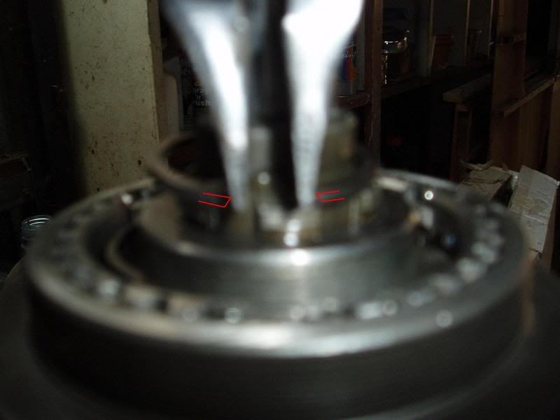

The next pic. shows a snap ring being fitted. The red markings show that the tips of the snap rings have a taper. This is to let the pliers grip them, not so critical when fitting but makes them a bastard to remove if fitted backwards.

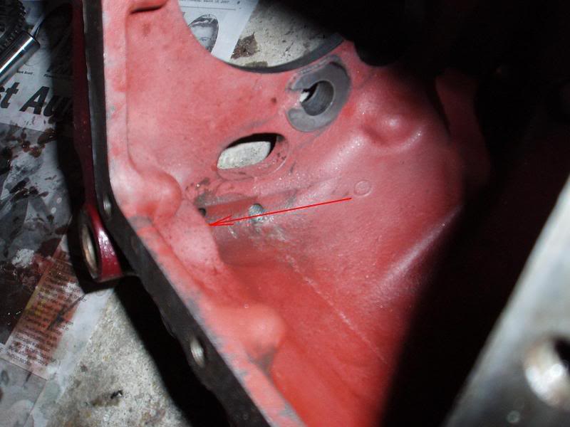

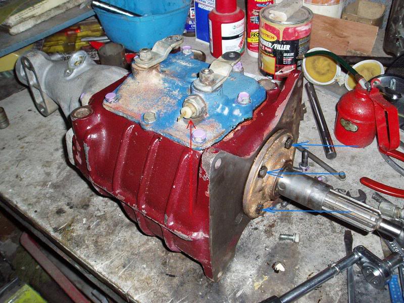

Another thing to look for on an aussie is hidden gremlins. There is a cavity in the housing that all the nasties (broken bits of shrapnel and debris) want to hide in.
So here is the box ready to put back in. Pretty colours huh? The pink bolts are the only bits I have used from the box I pulled out. And that was only to keep Mrs RoDoMo happy. I might paint it black so I can have a "black box" to go with the telemetry read out. :blink: The blue arrows indicate bolts that can potentialy leak oil past the threads and I used sealer on these threads.
The rest of the bolt holes on the casing are blind with exception of the drain bolt on the extension housing where a copper washer was fitted.
The red arrow points to the nitros interlock switch. This means the nitros will only activate in top gear as the cluster is "delicate". :tease:

Cluster gear.
Thats why i had to replace the cluster when i rebuilt the M20 for the LJ.
I still have the old cluster around somewhere. Should grab it out and take some pics. :spoton:

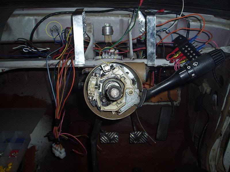

Wiring up dash. :cry:
Last week was mounting dash and getting depressed over the diff. (And lost a weekend on boy's car) The loom had been chopped out of the car when I got it so it is basically a rewire.
Should have all the wiring finished by Wed. night. Then I have 4 days off. The plan is to finish everything I've started before I pull anything else off. Some things can wait like fuel sender and reposition battery if time gets short.
2 blocks of 2 diodes had to be fitted to the dash wiring to give me a "dash light test" function. Yellow circles.
Also tidied up the "console"

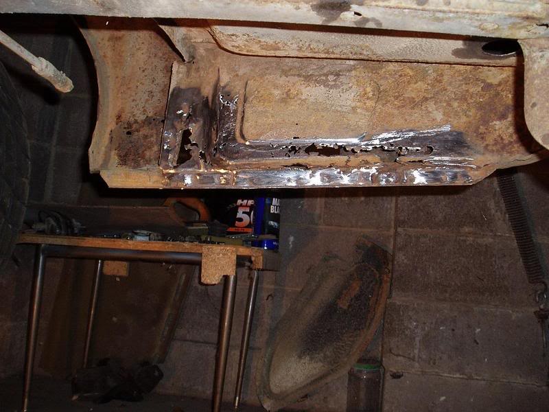

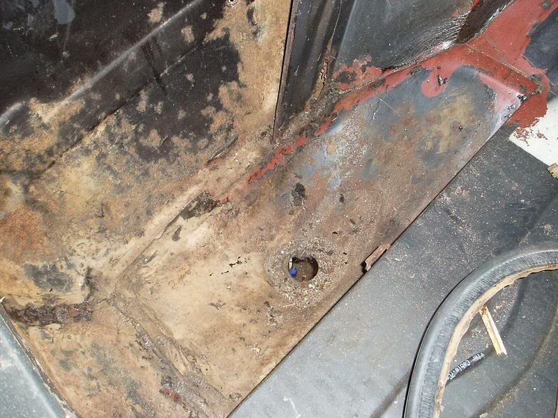

I went to pick-pay & go with a measuring tape to measure up for a small tank to fit closest to above the rear axle. I found 120Y was the most compact and checked out all the ones there, picked what I though was the best one, removed it, payed for it, and took it home. That was about 6 weeks ago. Yesterday I made up the bracket to fit it and nutted out in my brayn what was going where in regards to filler necks and pickup. In this process the tank got jigged around a fair bit and guess what? SUGAR FELL OUT OF IT! :cry: Kind of explains why a goodish 120Y was there in the first place I suppose. Air hose in the filler neck and vacuum in the sender hole got most of it out. Then 10 litres of hot water was swished around inside it. Finally a spray gun with the pot removed and an extension hose on the pick-up tube "vacuumed" out the remaining water. Tomorrow I will get some metho and rinse it again as a precaution.

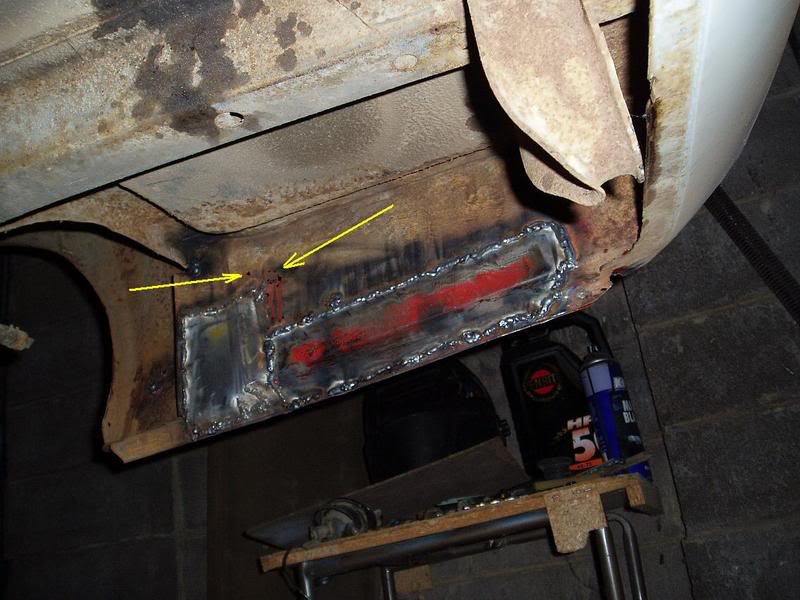

While there is no tank, hence no fuel, I thought it best to repair the rust in the rear of the car.
R/H Quarter.
Yellow arrows indicate holes that showed up after heat was applied (don't ya hate that!) and will be fixed using "an alternative method :spoton:"
These are "patches" over the rust rather than cutting out and replacing sections as time is a factor here. All exposed sections will be wire brushed and either red oxided or body deadened, should keep the scrutineers happy though.

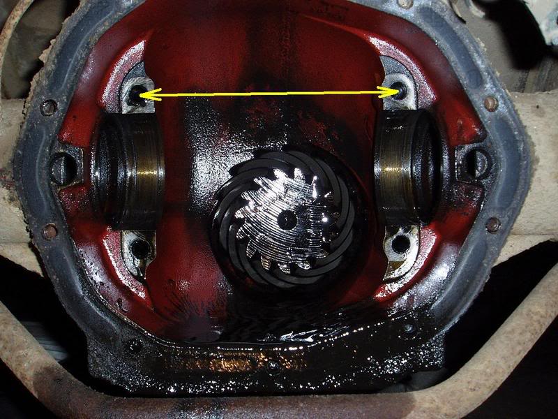

While waiting for the red oxide to dry I removed the diff centre. This pic doesn't do justice to the size of the pinion in a 2.6 but compare it to the carrier bolt holes. It is huge.

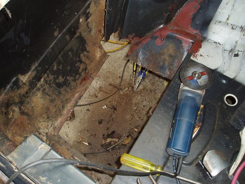

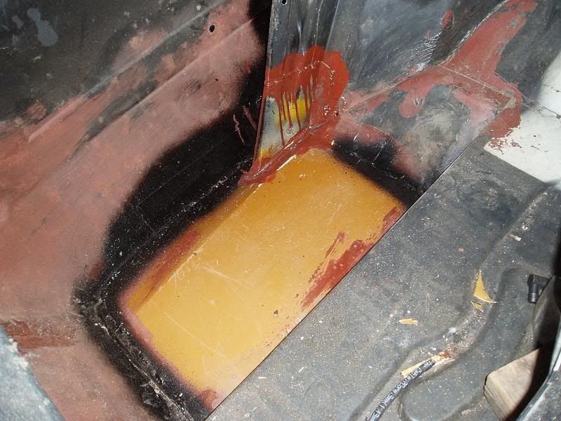

Major issues in the L/H quarter.
Wheel well :DELETE:
You might notice a bit of "quick fix tape" under the deadener in the quarter.
Thats not rust :<_<: It's a "crumple zone" :spoton: (Just pin holes really) There's that bonnet panel again :spoton: Not much of it left now but "boy" has donated another UC bent bonnet for future projects.
The diff centre is back in, the new carrier bearings have eliminated any side thrust but I didn't need a spreader to refit the centre. What this means is backlash is halved but carrier bearings have little pre-load. Should last until budget allows another diff though, no problem, better than some 9"s Iv'e been reading about. :tease:
