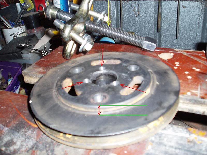

I got the balancer off! :D
I had to think in my brayn though. :fool:
The puller I have is a "she'll be right" $2 shop "spethal". I have used it 4 or 5 times on Holden balancers and other stuff with no probs. but this was stubborn.
I drilled 3 x 1/4" holes parallel to the crank. to "relieve" the grip the balancer had on the shaft. The red arrows show the holes. The holes were drilled "staggered" to the threaded "puller" holes as if it were too weak near these threaded holes the threads "might" have stripped and I would have been in more crap than a Werribee duck! The holes were drilled to a depth of 25mm, not quite the depth of the balancer, so no swarf would enter the engine. In other words I didn't quite drill them through. I wrapped masking tape on the drill bit to indicate depth. The balancer is made from cast iron and is easy to drill. After the holes were drilled the same puller was used and the balancer virtually fell off.
You might see the bend in the puller thread from the effort prior to drilling. Yellow arrow. And the damage to the thread to the left from the friction.
The green lines show how much the balancer had slipped backwards toward the timing case, as well as torsionally.
You can see in this pic that the balancer had started to "machine" the timing cover.

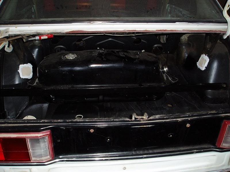

Anyway the day "ignited the flame" and I was out there again tonight dummy fitting the fuel tank.
Here are some pics from other things that happened this week.

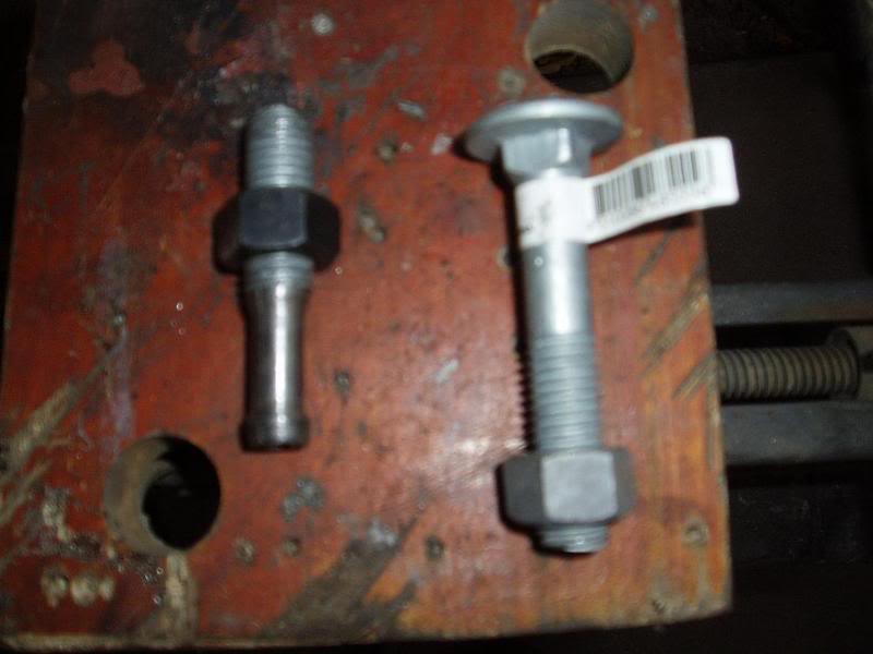

The "billet" fuel tank adapter was manufactured. It was cut to length then a hole was drilled down it's length. The "bolt" was then mounted in a drill and the drill mounted in the vice and locked on. An angle grinder was used to "contour" the shape and the adapter was "finished" with a file and emery while the drill was still going. This fits in the "bung" hole at the lowest point of the tank.
The catch can was fabricated. The plastic fittings came from the Bunnings garden department ($12 all up) and the hose was $3 a metre. The wire inside the hose is mig wire that I wound around a big screwdriver and pulled through the hose to stop it from collapsing. I mounted the catch can higher than the rocker cover so that any oil would collect in the hose, hopefully, and drain back before it got to the can. The plan here is that the "catch can" relieves pressure rather than catch oil. The coiled wire might help to catch the oil droplets, let it drain back, and let the pressure pass over?

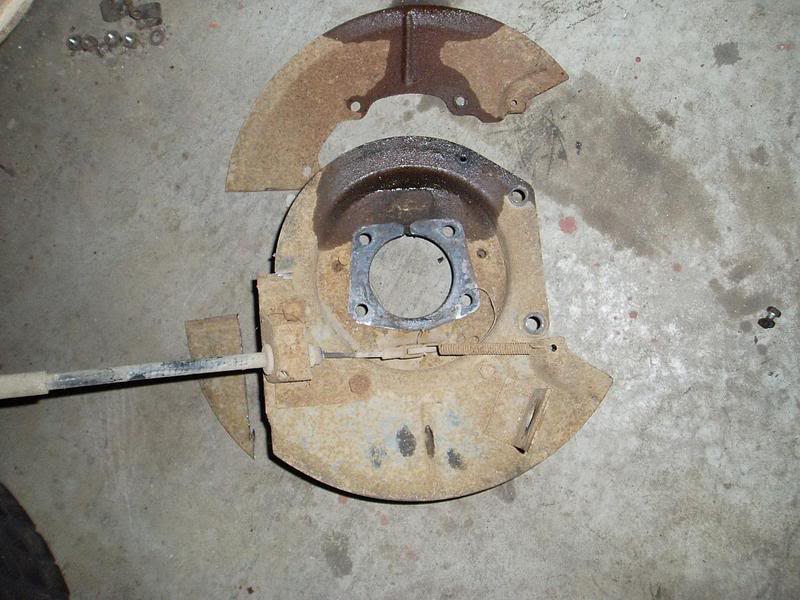

All 4 calipers were re-kitted and the best of 3 master cylinders was chosen for a re-kit. Turns out the one off the car had been re-sleeved with a stainless sleeve so that was the one to be re-kitted. The rear backing plates were relieved. As it is 4W disc, I had to leave the top section intact to accomodate the "emergency" brake cables.
The budget at the moment wouldn't allow for slotted rotors so the pads were slotted instead at a tangent to rotation. I'm not sure what effect this will have but surely it can't hurt? :huh: A 3mm cutting disc on the angle grinder was used to 1/2 the depth of the pad lining. I now have directional pads. :blink:

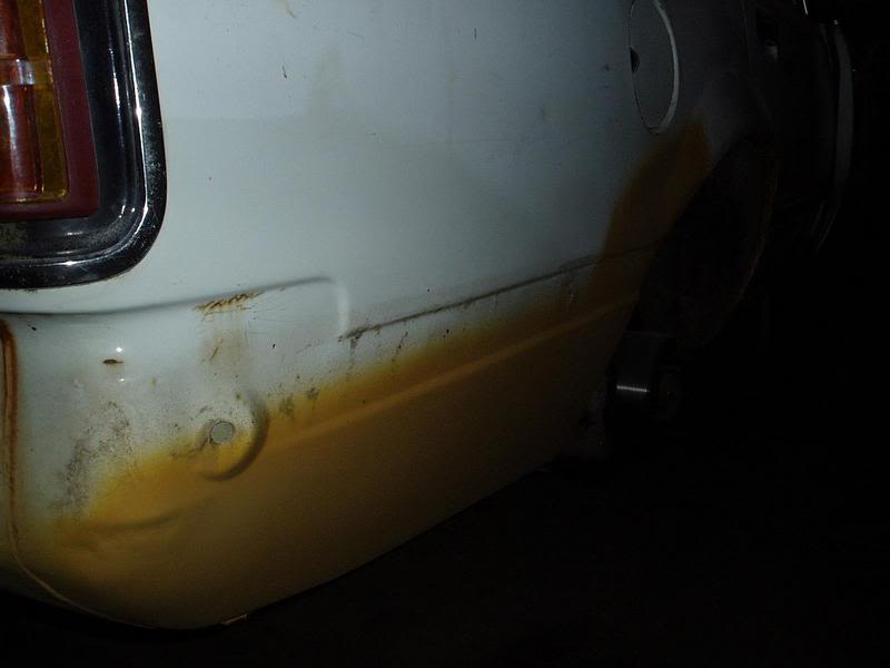

The lower quarters have been "tidied" (car must be in a "presentable" condition)

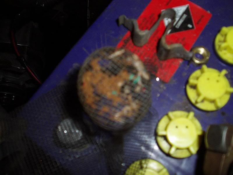

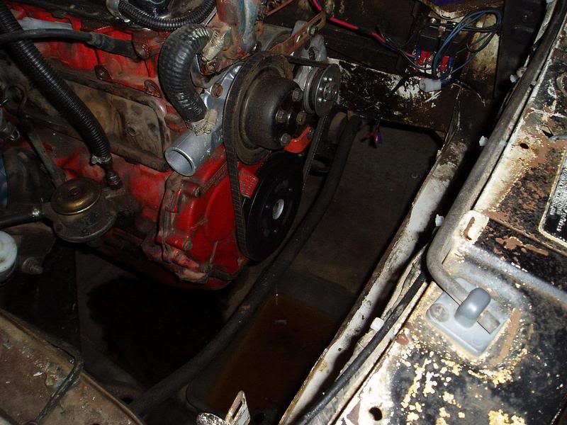

Prior to initially starting the car (a couple of months ago) I fitted a piece of nylon flywire to the top hose before the radiator. This motor is an unknown and had had obvious cooling issues and had also sat for 2? years in my shed.
I removed the flywire when I had the radiator out to do the harmonic balancer.
This motor has only run approx 20 mins in total since fitted and the flywire is half blocked :blink:

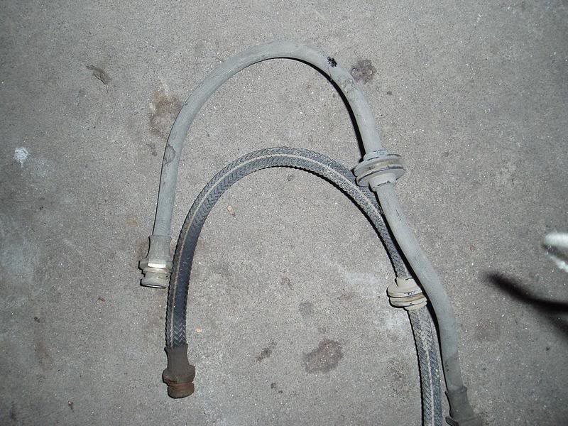

The brake hoses have been replaced with VL hoses as the "word" is that the early hoses suffered "ballooning" meaning they swelled under pressure and pedal travel increased. The ones with the "criss cross" braiding are the early hoses.

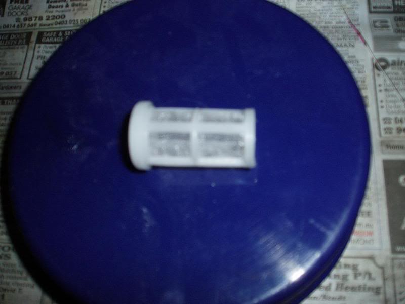

A strainer was fitted to the fuel tank adapter inside the tank. This is a strainer for a paint spray gun and normally goes on the suction pipe in the pot. It took a bit of fitting down the filler neck :blink:

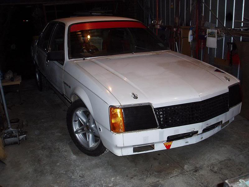

Posted 30 May 2007 - 12:28 AM
Getting there, sent off the entry for for Sandown this Sunday 3rd.
Bonnet pins
Cut holes in lower valance (no time for ducts though) better than nothing.
VK mirrors (fully cowled and not wind effected)
Wheel upgrade from 195/50/15 on standard SL/E rims to 225/50/16 on HSV Maloo rims ($158 off e-bay and only need 1 tyre :spoton: ) And a bigger footprint than 13" :tease:
Creative use of 100mph tape (lucky it comes in different colours)
Few stickers here and there
Might even get to finishing buffing it if I'm lucky?
Hmmmmm can't quite see the boot lid?????
