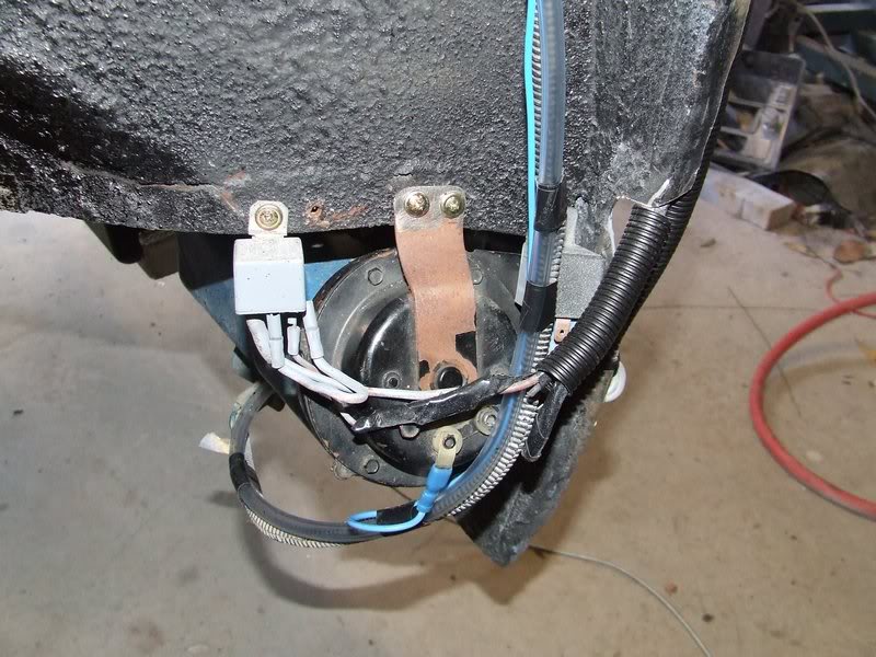

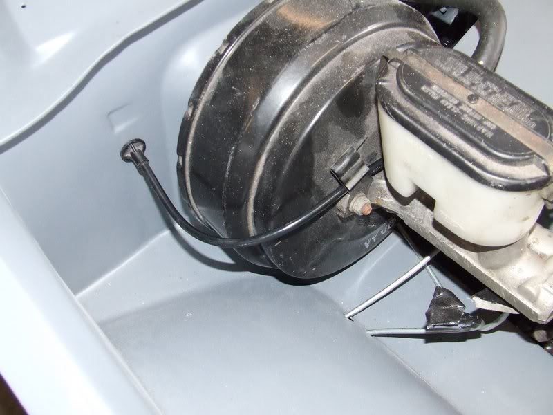

Well the car now has a horn : )
There was no wiring at all for the horn so I had to run a wire up the column to the little button thingy, then through a relay then to the horn.
The relay is up under the dash, out of harms way, but still easy to get at if necessary.

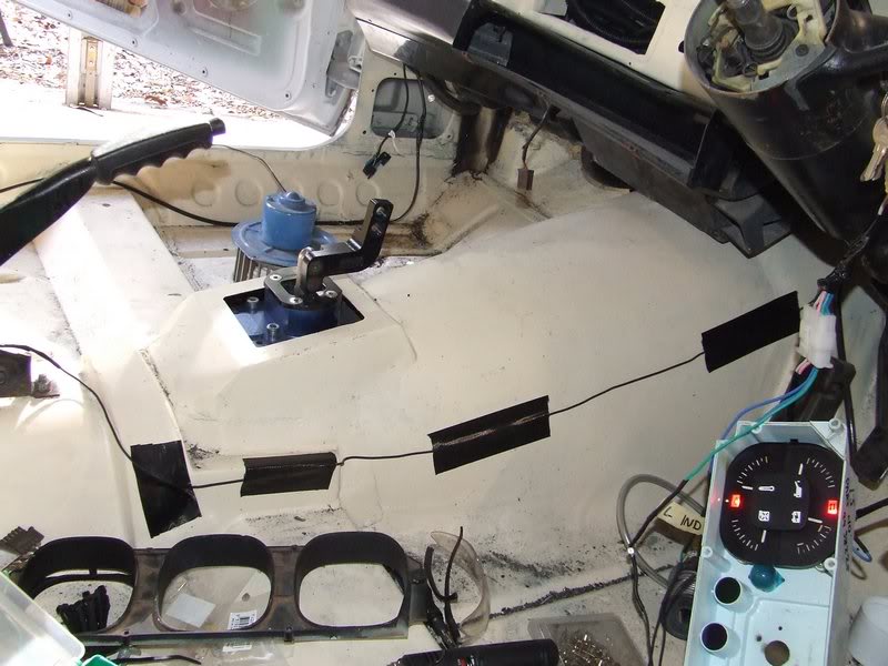

I also had to get the handbrake light working. After mucking about with the switch for a while I got it working, and then ran the wire to the dash light. It's nice to have all the little things working now.
I just taped the handbrake light wire to the floor. The carpet will hold it once it goes in.
See the lights in the dash working!!! YAY!!!! : )

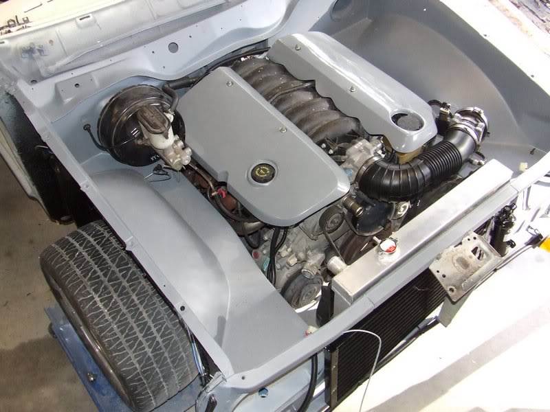

I bolted the new engine covers on, refitted the brake booster and accelerator pedal to see if the engine covers needed modifying and to just have a look at how it all sits. I like it. It'll look nice and smooth once it's painted.
This is the only visible bit of the accelerator cable.

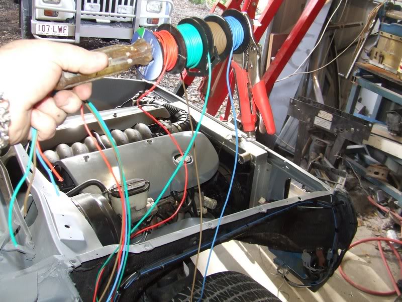

Next thing I started was to run wires for the oil pressure sender and light, and water temp sender and light. It's pain in the a$ running wires, so I try to run as many as I can at the same time. Seeing that these 4 wires are going to basically the same place, I ran them together. I even made up a really technical, very scientific, fully adjustable and super dooper wire spool holder and wire feed unit : )hahaha

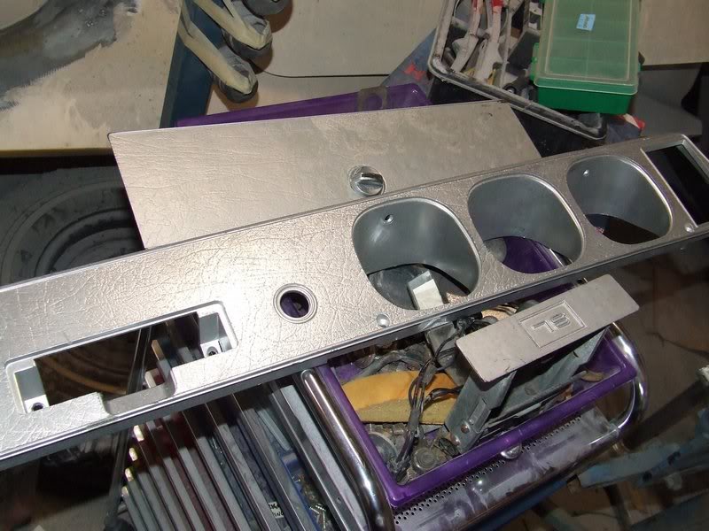

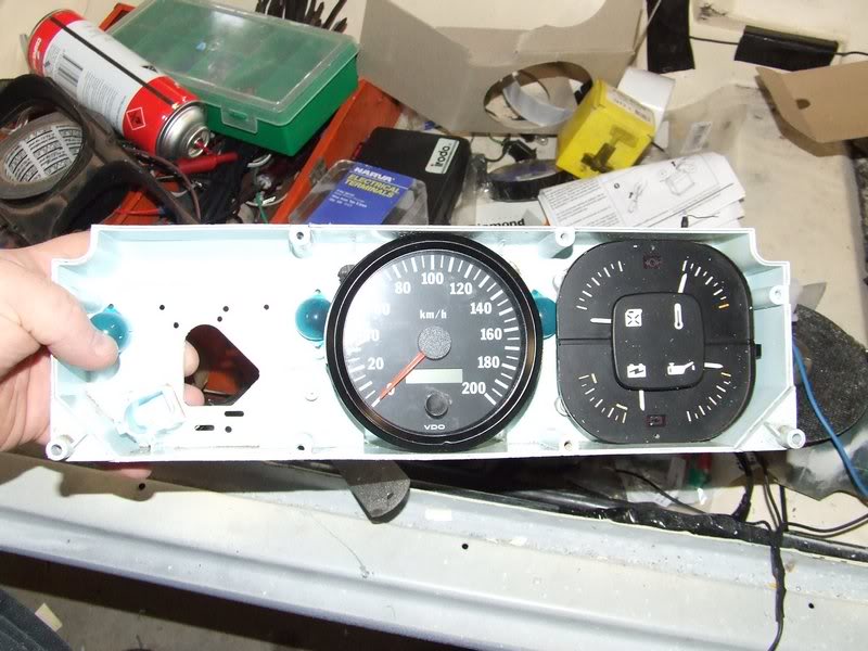

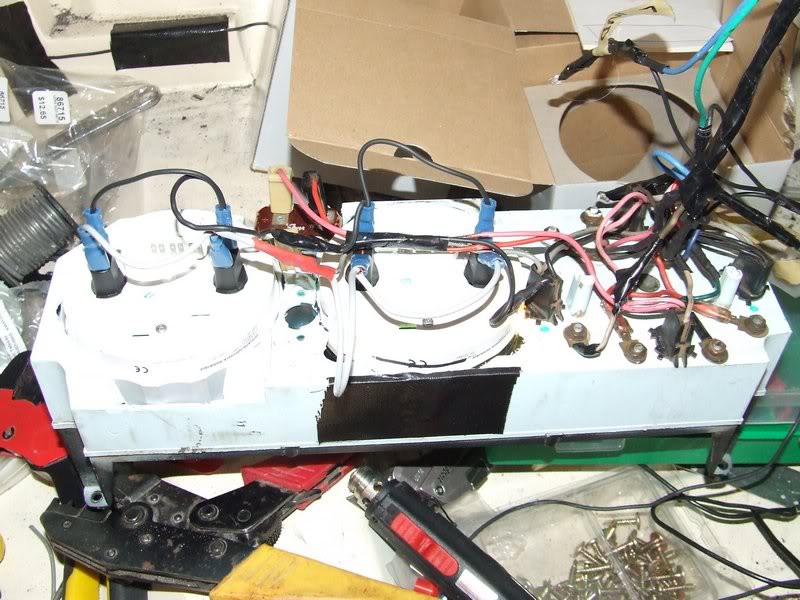

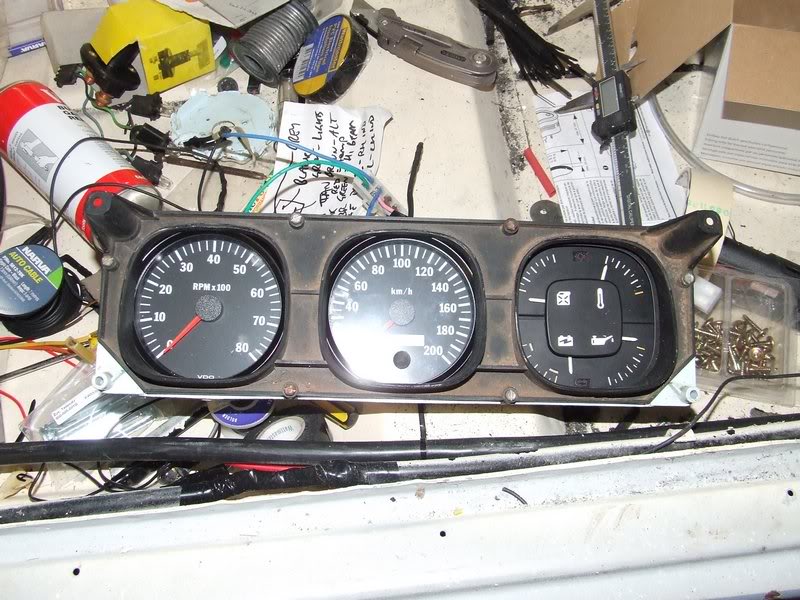

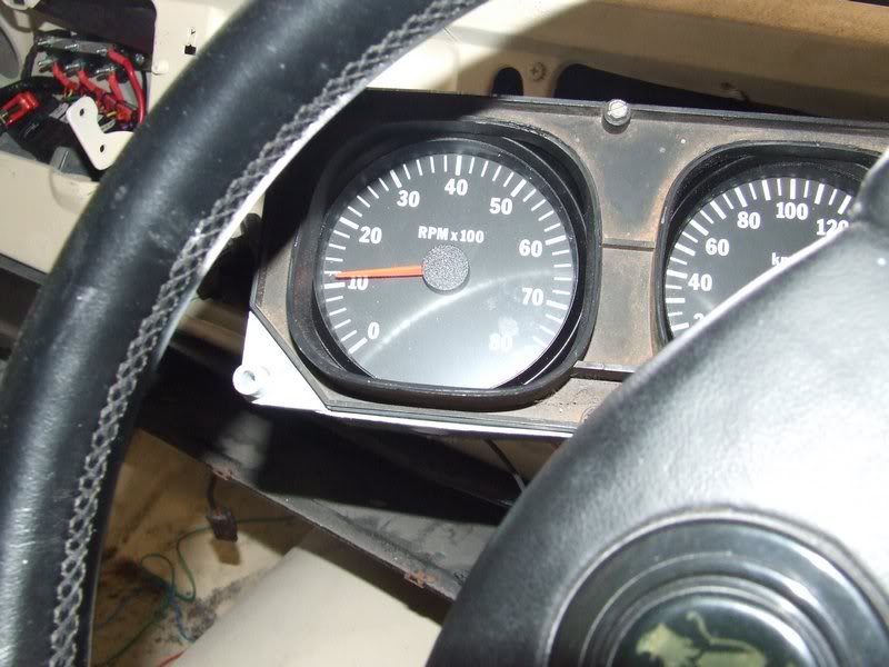

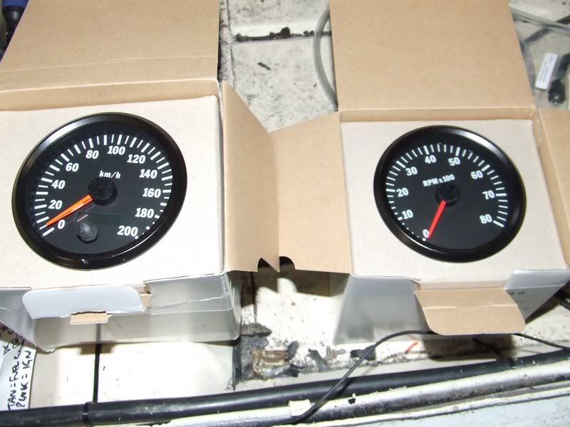

The new VDO gauges arrived today. These will be sunken into the dash where the original gauges were.

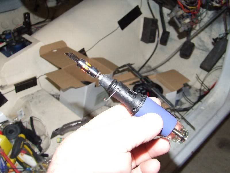

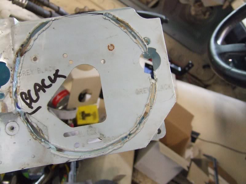

A butane soldering iron with a cutting attachment is good for hacking holes in plastic.
Speedo fitted.
Here's what the soldering iron does to the plastic. It's not too pretty, but it's effective. This is where the tacho will go.
Hooray. They are a tiny bit small for the opening, but with the new plastic lenses and the rest of the dash in front of them I don't think you'll really notice.

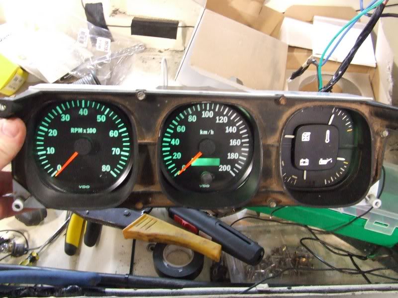

I even got the lights working.

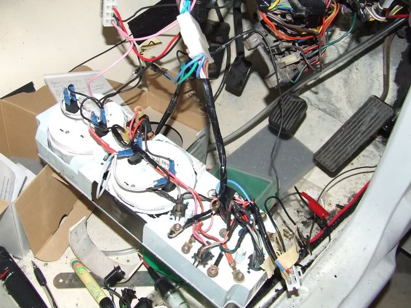

The wiring for the lights on the VDO gauges.
Now with (I think) all the wiring for the gauges finished, it's nice to know there's ignition lights and the 0.0 trip meter on the speedo.
Here's the mess on the back of the gauge cluster. Once I'm certain the speedo is wired correctly, I'll neaten this up. I did just notice in this pic that the plugs for the speedo and tacho aren't plugged in, so don't hassle me about that : )
Look!! The tacho is actually moving like it should. The LS1 has a pulse rate the same as a 4 cylinder, and luckily this tacho came already set up for a 4 cylinder, so works perfectly.
