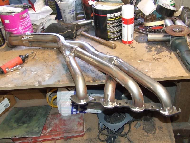

Well I've done a couple of small things, but nothing very exciting.

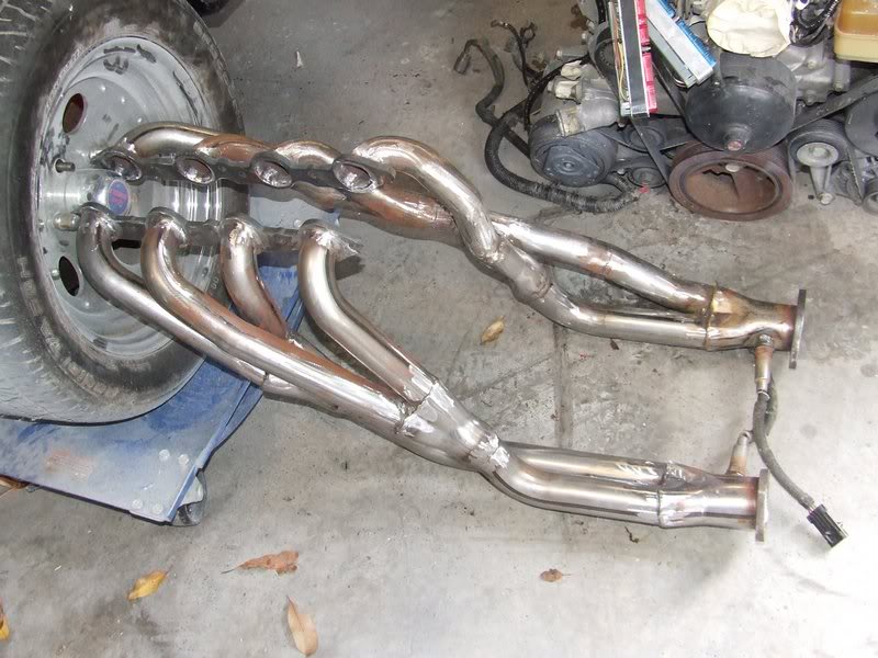

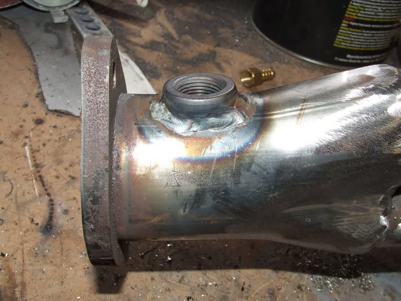

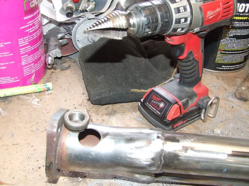

I finally finished welding the left hand extractor. There wasn't much left to do, I was able to get to most of it while it was bolted to the motor.
I then bored a hole in the collector for the oxygen sensor bung.
This is where stepped drills come in really handy.
A bit of hot glue -
Here's this side finished ready for HPC.
I figured I'd better weld the oxygen sensor bung into the other extractor too. Now they're both all done. I hope : )

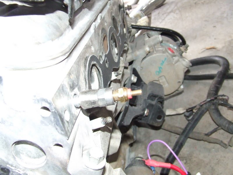

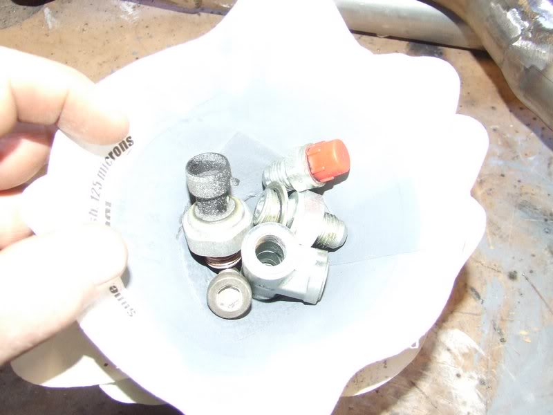

My next fun job is turning this collection of fittings into a T piece and an adaptor so I can use the LX senders for oil pressure and water temp as well as the standard LS1 senders.
Here's the T piece for the oil sender after I'd welded one of the fittings to it. There will be another fitting at the other end yet, as the LX sender is gas thread and the LS1 sender is M16x1.5mm.
Here's the T piece made and senders fitted.
I can't fit it with the holden sender fitted, but it's easy to fit that sender afterwards.

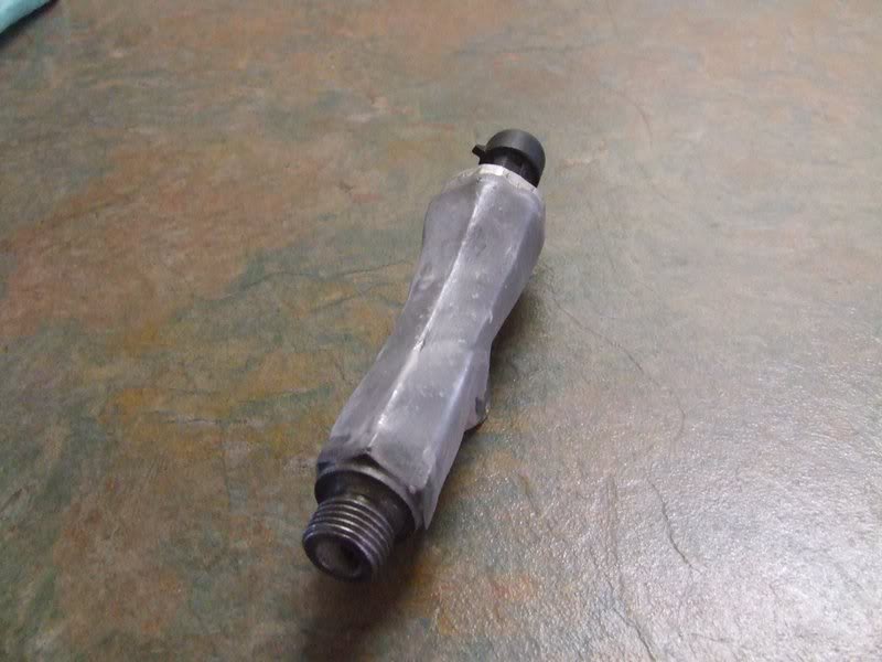

Once I was happy with it, I covered it in some Ferro pre plumbers 2 pac putty. It sets like concrete so means I'll be able to get a spanner on any part of it.
I had to drill the fitting out a little to allow the water temp sender to fit inside.
I then welded the other fitting on to give me the thread that I needed.
I know it's not screwed all the way in, but this is where the holden temp sender is going.

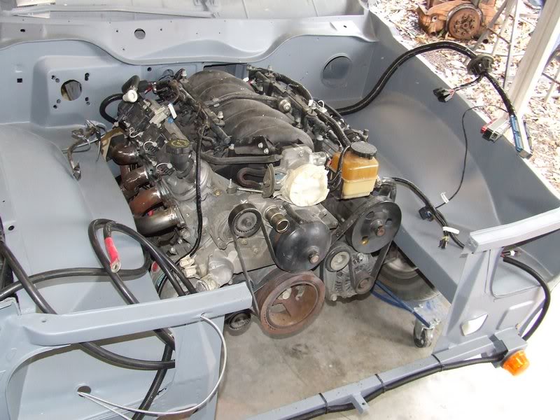

Well I got a bit more done.

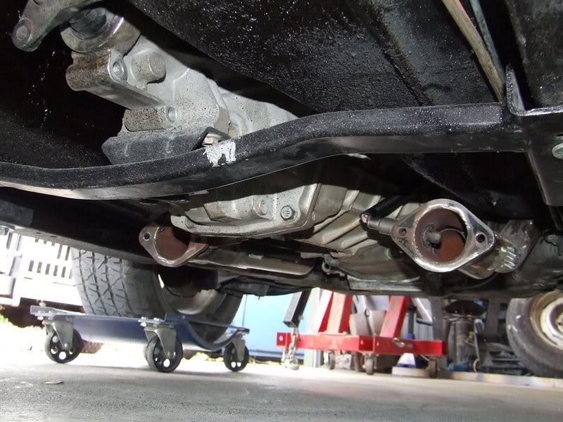

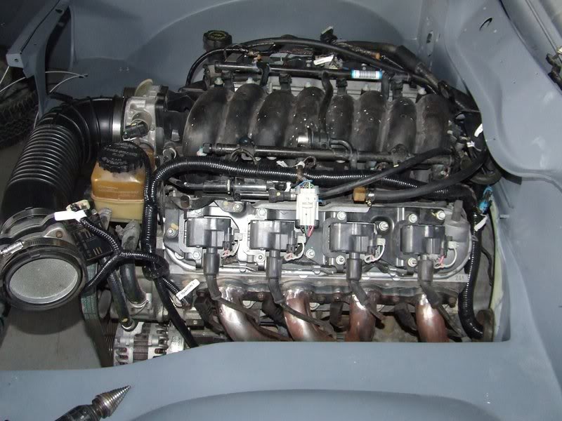

First thing was to bolt the gearbox and extractors back on so I could see how much I had to extend the wiring for the oxygen sensors. With that done it was time to load it all back into the car....again!!!!

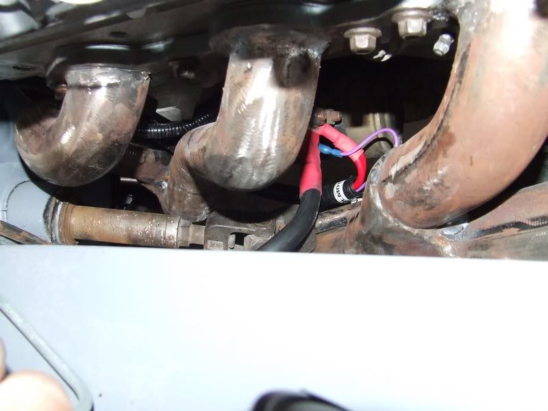

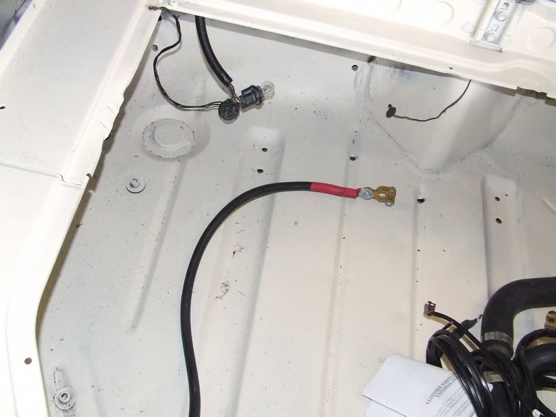

I bolted the main battery cable to the starter motor before fitting the motor, as it's a lot easier when it's not in the car.
Here's the oxygen sensors fitted and all plugged in.
I then ran the battery cable to the back of the car.
It had enough room to go straight through the extractors and into the inner guard area, so that's what I did.
If you look amongst the mess you can see the battery cable running along the inner sill, cable tied to the loom for the tail lights.

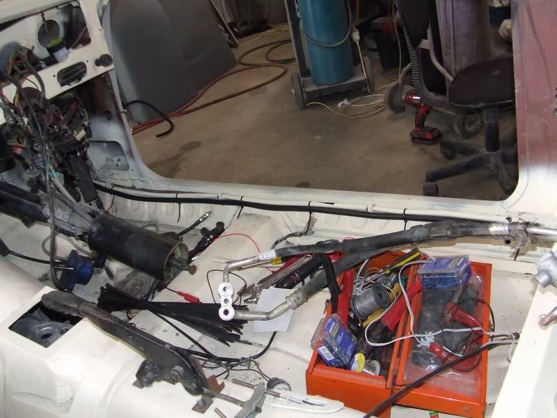

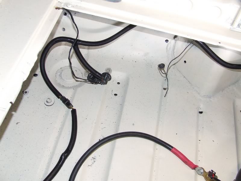

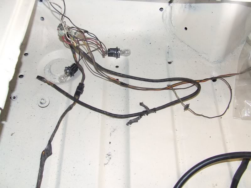

Once at the rear of the car I realised just how sad the tail light wiring looked, so I did a bit of work there.
I removed the horrid clamped on wiring for the old towbar too.
Covered it with some conduit.
Then tucked away.

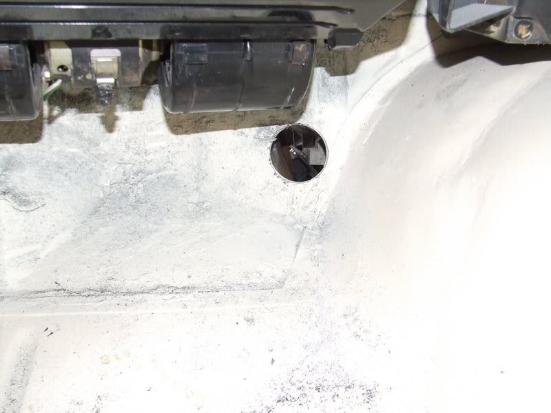

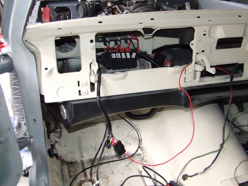

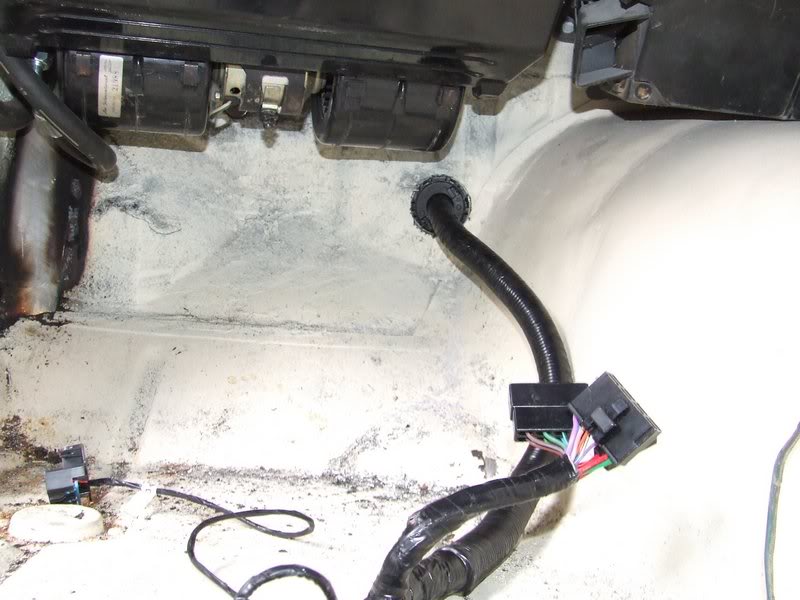

Now it was time for the big wiring. I was a bit stand offish about this part, as I'm certainly no auto sparky, but it had to be done.

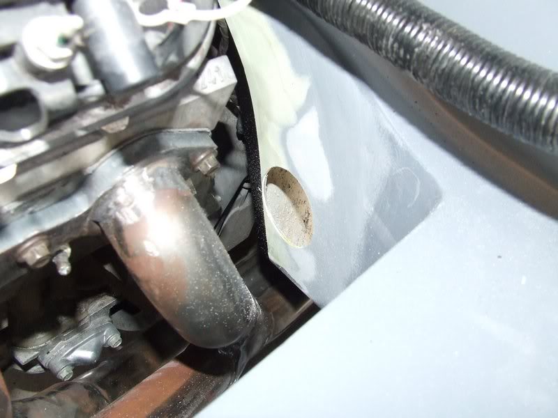

I looked about and figured the best place for the main engine loom to go inside the car was through the lower firewall.
There's plenty of room here, and it's fairly well hidden away really.
It was actually quite hard getting the huge computer plugs through the 60mm hole, as the exhaust doesn't allow a straight path through the hole. It's in there now though.
Doesn't look too bad to me.

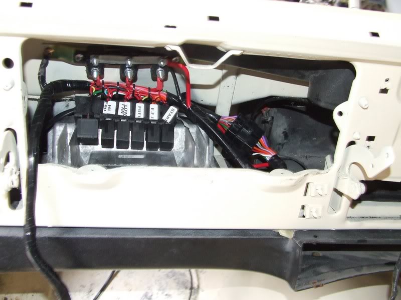

The computer and new wiring harness had nowhere else to go but in the glovebox opening. It'll still be able to have a glovebox, it might just be a tad smaller inside.
One thing I really wanted to do today was to be able to turn the motor over with the key. Before I finished I ran one wire, yes, the starter wire : )
And presto, it now turns over with the key. It's a small victory, but an important one none the less : )

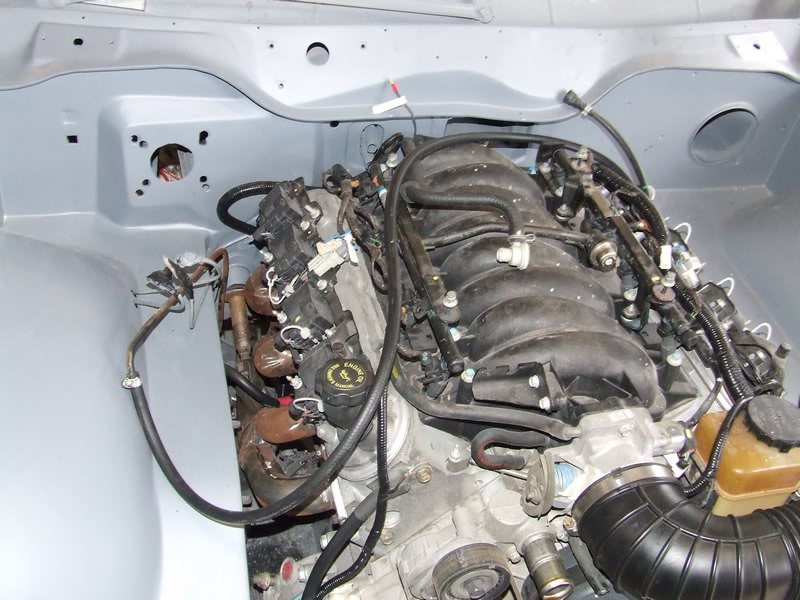

The only wiring left to go in the engine bay now is the heater motor, the wiper motor and the thermo fans. I don't think it'll look too overcrowded when it's all finished.
I wont be using that intake pipe either. I just stuck it on there so I could plug the sensors in. Because it's now tuned MAFless I'll be able to make something more symmetrical, as it wont need that big ugly alloy thing hanging off the end : )
Now I just need to figure out the rest of the wiring, put some fuel in it, cross my fingers and hope like hell it starts : )
Then I get to rip it all apart again : )
De ja vu anyone ????

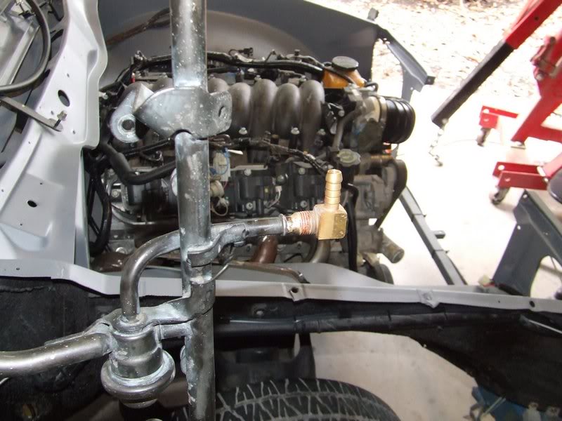

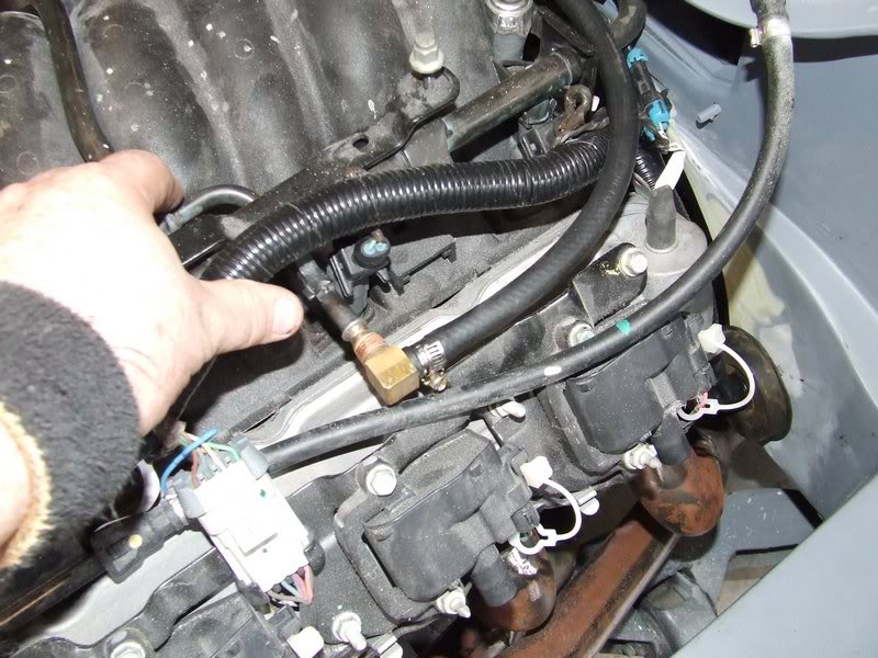

I took the fuel rails off and silver soldered a brass fitting on to replace the weird original fuel line fitting. Now it's just a basic barb set up.
I've still yet to properly run the fuel line, but I was eager to get it running, so I just ran it over the top instead. It will end up running up the trans tunnel and up the back of the motor. It should be fairly well out of sight that way.
Here's the new fitting. It's nothing amazing I know, but I didn't know of an easier way to attach a normal fitting. Plus, it will be hidden under a cover anyway.

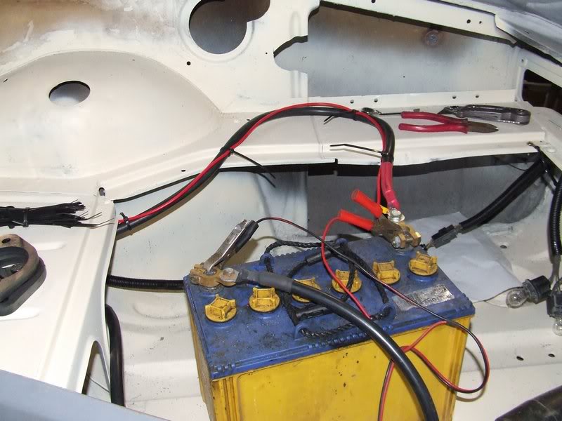

I only had a few more wires to connect before finally attempting to kick it in the guts, so to speak : )

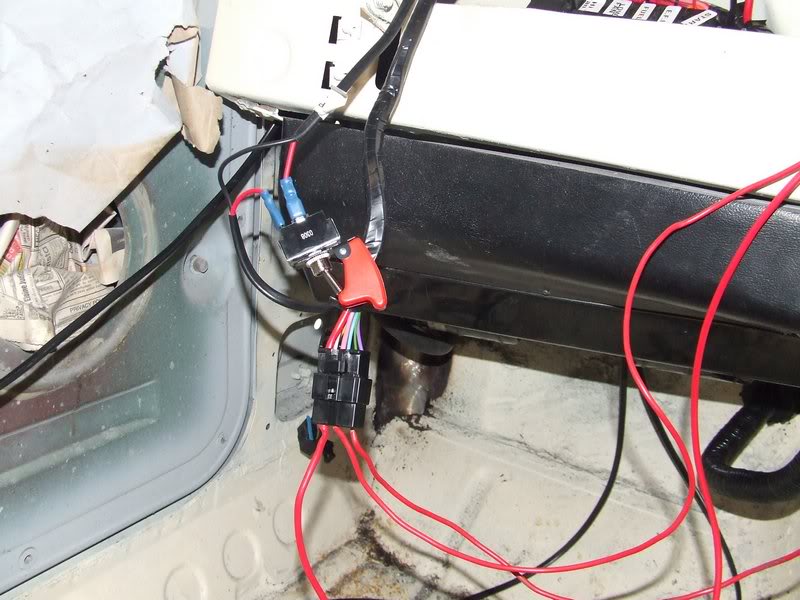

I could have spliced the main 6mm power wire for the computer into the battery cable, but I ran it all the way to the battery instead, so if need be it can be easily disconnected. I just tied it to the battery cable, to try and keep everything in some kind of order.
The battery I'm using isn't the one for this car. My brother already has a dry cell one for it, but I'm not going to canberra to get it : )
The next wires were for the fuel pump. I decided to put a 25 amp kill switch on the power wire for the pump, again, just in case. For giggles I stuck a missile switch cover on it. This switch will be hidden away, as the dash is to remain as standard looking as possible.

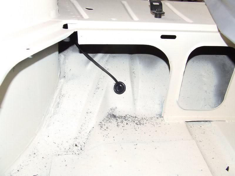

With all the wiring I've had to do on this car so far, I've gone through a few grommets. I was going to get all different sized ones for the different looms, but stuff that, everything gets a 1 inch grommet. Even the 2 wires for the fuel pump : )
How much of a tight a$$ company is Bosch for not even supplying nuts for the terminals on the 044 pump??? I dug some up and got the wiring finished. It's all systems go under here now.
Once this was done I turned the ignition to hear the lovely buzz of he fuel pump, only to see fuel leak from 2 of the injectors. My fault. I kind of thought I'd squished a couple of the O rings when putting the fuel rails back on. No biggy, I planned on replacing all the O rings anyway.

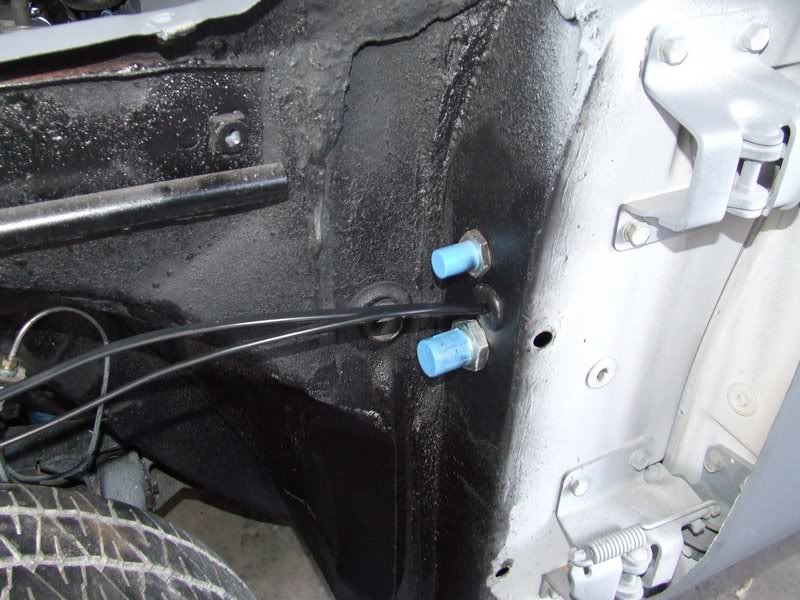

There was a perfect bit of space between the A/C lines in the A pillar to run the wiring for the thermo fans. Again, a 1 inch grommet saves the day : )
I'll refit the radiator tomorrow and finish running these wires. This is as far as I got today.
I had spark plug leads made up and they all seem to work well. There's not a lot of room around the pipes so the factory ones were way to chunky. I might have already mentioned these, but hey, it's 1.22am and I can't sleep, so shut up : )
If I can find out how to attach a short vid I'll stick a quick bit of the motor firing up here.
If it doesn't work, feel free to tell me how to do it, even though it's not a very exciting vid.
http://s567.photobucket.com/albums/ss112/pur308/?action=view&current=DSCF1319.flv
#423 _dirtbag_
_dirtbag_
Posted 24 March 2010 - 01:54 AM
OK, that didn't work. I'll try this.
I think this worked. It's got no exhaust other than the extractors but still sounds quiet on the vid. You can even see my dirty hand prints go up in smoke on the left extractor : )
[url="]
Edited by dirtbag, 24 March 2010 - 01:58 AM.

With your wiper motor wiring and the heater box I have an idea that you may like. I did it with mine.
Wiper motor wiring..
Cut out a notch in the opening for the wiper motor close as possible to where the plug goes on the wiper engine. Now extend the harness and run the harness inside the plenum chamber and through the fresh air duct near fuse box side. You'll have to make sure that the harness will not get caught in the movement of the wiper arms. I used some urethane for this.
You will have to take a small V from the fresh air duct for the harness to get passed it into the cab of the car.
Heater box fan wiring..
I just drill a hole very close to the heater fan motor plug and used a grommet to seal it in the firewall. It's easier to remove the terminals from the plug block so you don't need such a big hole in the firewall.
I don't have any pictures, but I can take some if you need.
#425 76lxhatch
Posted 24 March 2010 - 05:58 AM
^ I run the blower wiring inside the housing so you can't see anything from the outside.
