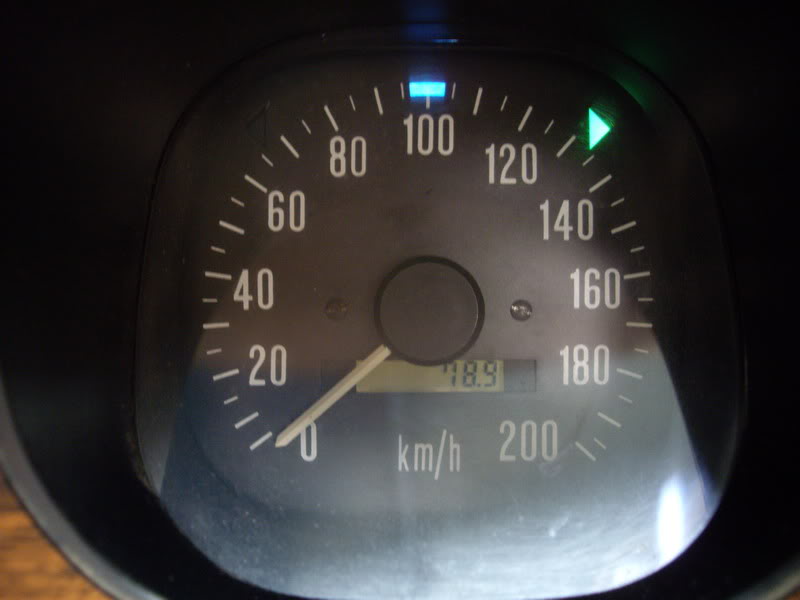

Sorry but that speedo just looks so wrong - how could you spoil the entire car with that horrid looking thing ??????
It only reads to 200kmh - nowhere near fast enough Posted Image

hahahahaha : ) Thanks Ken, that's a good one :spoton:
There are 300km/h ones available, but they don't look as good. Besides, this way you can hear the needle slap the stopper much harder : )

With the cluster mounted I finally got to see what the dash was going to look like. Not too bad in my opinion. You can also see the 3 LEDs in the front of the dash between the gauges and vent. The two between the gauges are for the indicators, and the one near the vent is high beam. They're not as obvious in real life as they are in this pic.
Drivers eye view : )
This is just showing some of the dash lights working. I'm pretty proud of these things actually working, as I'm really not very smart.

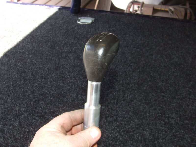

Instead, I thought I'd make a gearstick, as I didn't have one for the B&M shifter.

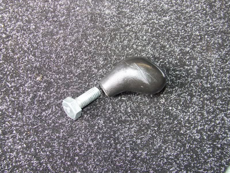

Mr brother liked the idea of using an old original 4 speed gearknob, to keep the original look. It just so happened that I still had the old 4 speed knob from my first ever torana. I like the idea of a piece of that car living on in this car : )
First job was to dig through my crap and find a bolt that had the same thread as the gear knob.

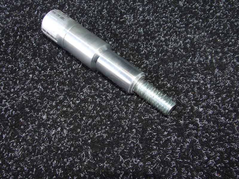

I have a piece of 25mm alloy rod to make the stick out of, but I don't want the thread at the top to be alloy. What I did was machine the head of the bolt down and tapped a thread on it slightly different to the one already on the bolt, and tapped a thread inside the gearstick the same as the new thread. I wanted a different thread so it would stop going into the gearstick when it reached the other thread. Does that make any sense????
The different thread stops at the right place to leave enough of the bolt sticking out to mount the knob onto.
Ta-da : )

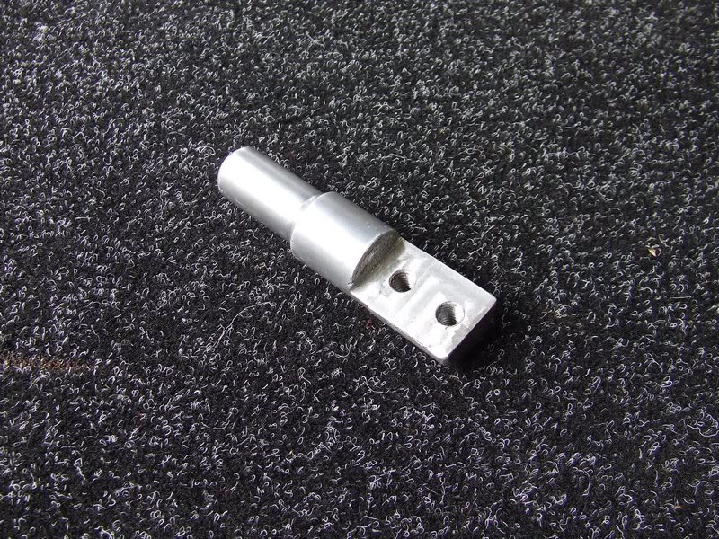

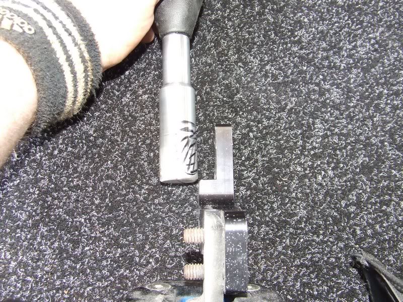

Now I need to machine out the bottom of the new stick to fit onto the existing part of the shifter.

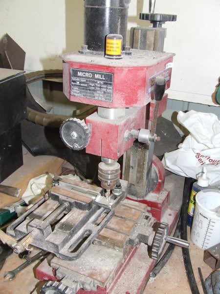

I cut most of it out with a cutting disc, but then levelled it all out on my mill. For those wondering, it's the biggest mill in the world. When I say biggest, I mean it's about 2 foot tall and I can carry it around : ) hahaha. It's very handy though.
It says "micro mill" on it, but they mean "HUGE MILL" : )
Once that was done I just had to drill and tap the two mounting holes and the job was done.

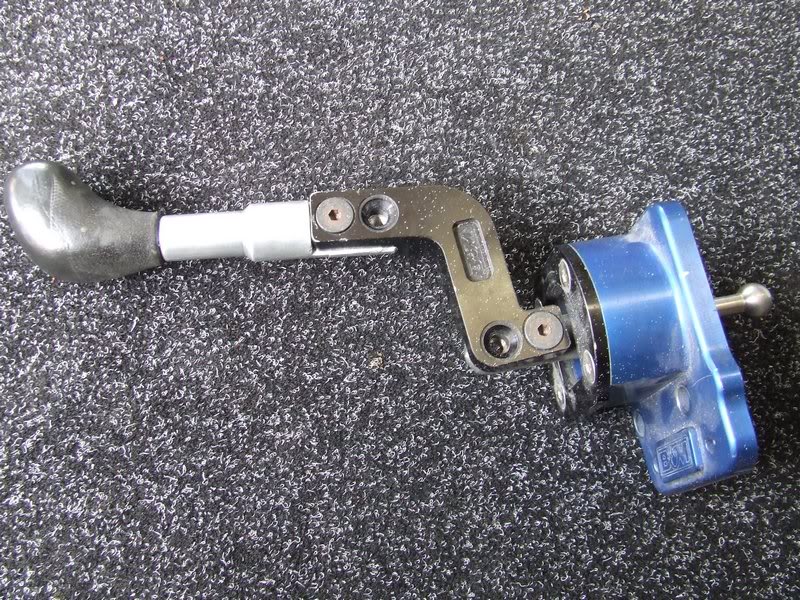

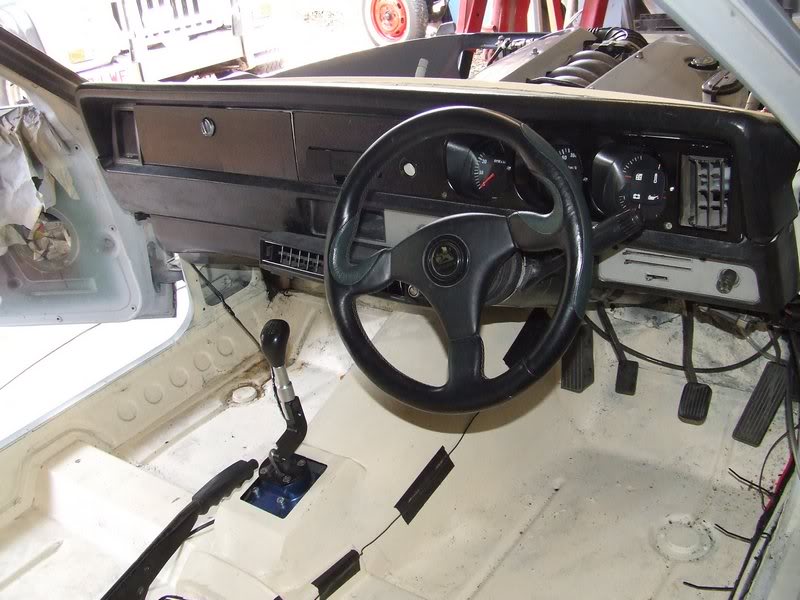

I only have the two bolts at the moment to mount the stick as that's all that was there, and being Good Friday nothing was open to get more, but you still get the idea.
Once it's got a gearstick boot around it I think it'll look great.
