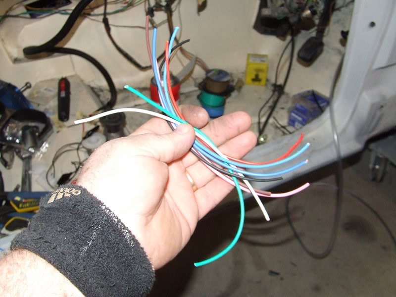

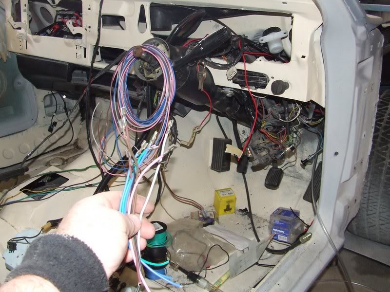

I did do some more wiring on the dash. I'm extending the dash wiring on each side of the new plugs so everything isn't so tight if and when you have to work on it later. I hate that.
The pieces of wire I'm holding with the plug clips attached are the extension for the gauge cluster. Maybe I'm just the worst sparky in the world, but all this soldering, crimping, wrapping looms and what not seems to take me forever. Having said that, at least things work now it the finished product looks better than it did at the start, so that's a plus.

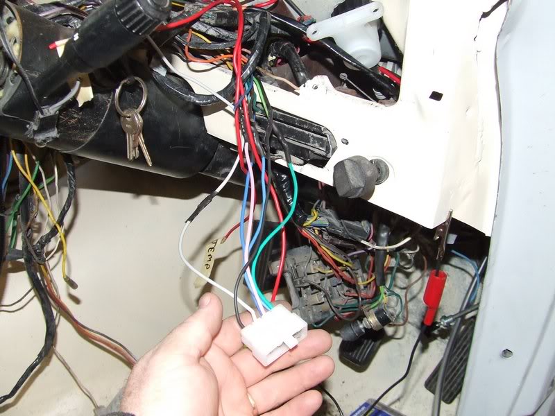

Here's the dash wiring extended and the new plugs fitted. I don't have the new speedo or tacho yet, so obviously they're not wired up, but everything else is.

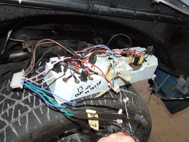

The 3 LEDs are for the indicator and high beam lights in the dash. The little lump inside the heat shrink is a resistor, to bring the volts down from 12 to about 2 or 3. Otherwise the LEDs would fry instantly.
I'm sure if someone who knew what they were doing did this it would look a lot neater, but I'm having fun so jam it : )
LEDs only work when wired one way, unlike normal bulbs, so make sure they're the right way around. I bought these yesterday, and today discovered the blue LED was a dud. Bugger. Back to town to get another. Over and hour round trip : (
And yes, I know the heat shrink is a bit too big for the LEDs, but too bad that's all I had.

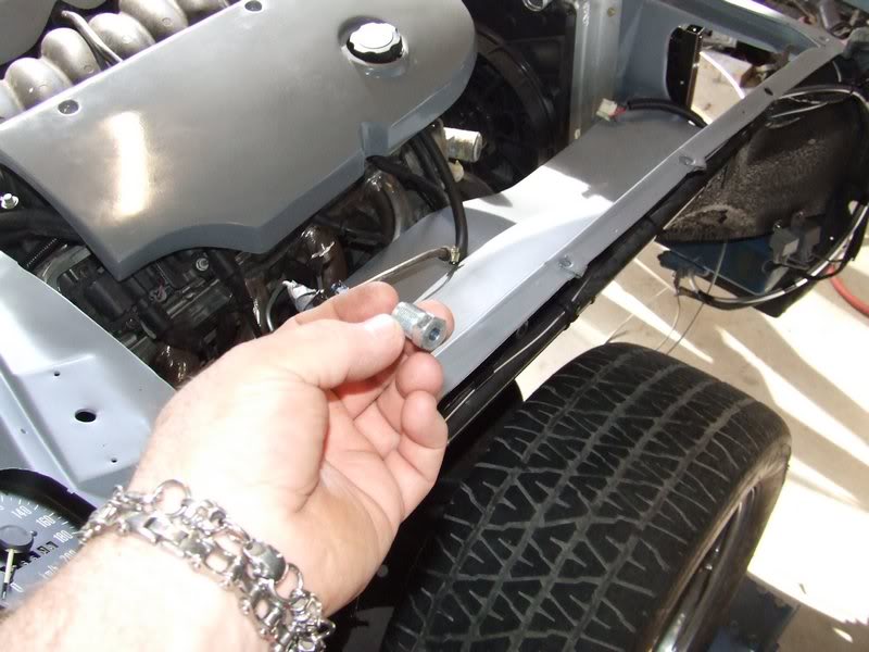

Remember the ugly fitting I had to make to fit the rear brake line into the master cylinder? Well I always hated it, as I couldn't find anyone around here with a 12x1mm flare nut to suit a 3/16 bundy tube. I couldn't even find a 12x1mm bolt to machine out into a flare nut, hence the ugly fitting. Well after another million or so phone calls I finally found a shop with the flare nut I needed, so while I was out getting the new LED, I picked the nut up too. Yay for small victories. : )

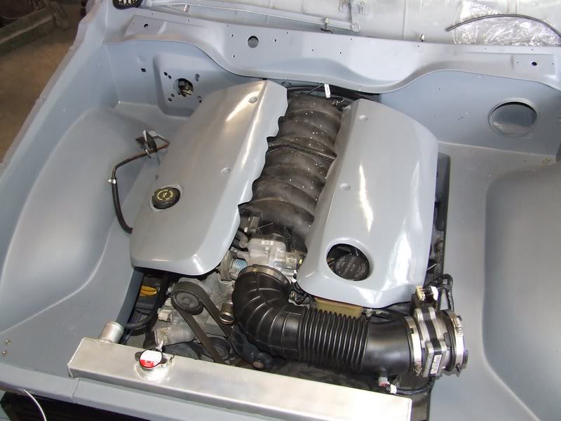

Oh, and the engine covers arrived today too. They look pretty good quality wise. I like them. They'll look good painted up, even though the gel coat matches the primer anyway : )
Tomorrow I'll bolt the cover mounts back on and bolt the covers on, so they're not all lopsided like in this pic.

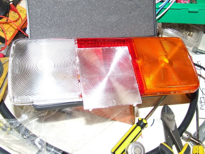

Well here's my simple fix for the indicators. I bought some truck light lenses. I cut the clear plastic piece out from behind the middle (red) area, so I now have 4 clear and 2 orange lenses big enough to cut to the size I need.
I will be mounting this piece of lense to the indicators that are here already, via the two bolts that hold the lense on. Obviously I'll need longer bolts. Once the existing lights are moved back a little bit more, the new lense will sit flush with the bodywork, hiding the trailer light completely.
Being a bolt on thing, my brother can change from clear to orange as he pleases. That's if they look OK. I'll try to get one fitted in the next few days. Too busy wiring at the moment : )
What do you think?

#449 _evil UC hatch_
_evil UC hatch_
Posted 25 March 2010 - 05:36 PM
that lens looks heaps better mate, I like it. How will you be able to attach it though?
#450 _dirtbag_
_dirtbag_
Posted 25 March 2010 - 05:41 PM
I'll just drill and countersink 2 holes and bolt them on with longer versions of the bolts that are holding the current lenses on. Does that make sense? I'm not too good at explaining things. The voices in my head make it hard to understand : )
