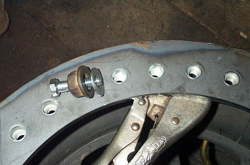

If you are worried about the size of then flange on the nutsert then there are small flange nutserts available. The small flange nutserts are less than half the thickness of the large flange nutserts. Once installed they are almost flat.
Large flange
Small flange
Installed photo from the web

Andy, I did look at the smaller lipped ones, but wasn't convinced they'd have enough bite for the flares. I know they're strong, but I'd hate for one to fail after it's finished and in canberra.

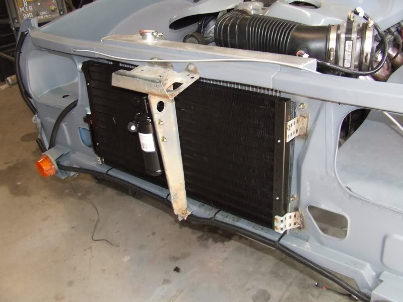

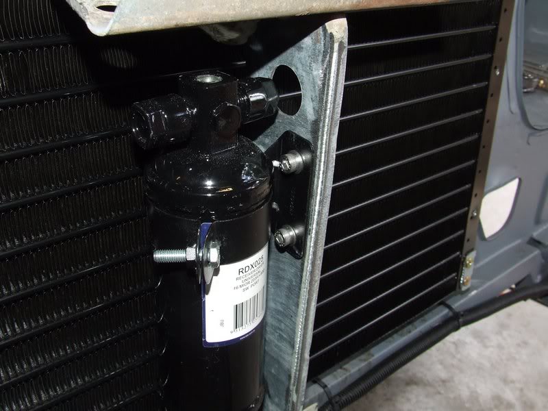

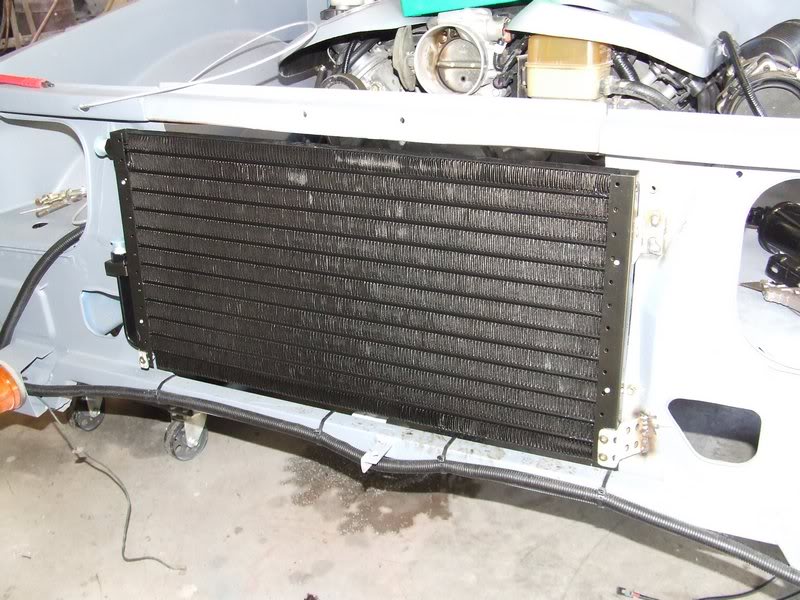

I mounted the air conditioning condenser and dryer in front of the radiator, so when the A/C guy comes back to make the hoses it's all ready to go.
I mounted the dryer on the bonnet latch stay. Of course being a kid with a new toy I mounted it with nutserts : ) The big hole is for the A/C line to pass through.
I also changed the radiator mounting. It now mounts with nutserts too. I can't stop : )
I'll have to open up the holes a bit in the radiator support panel where the bumper mounts go through to make room for the A/C lines.

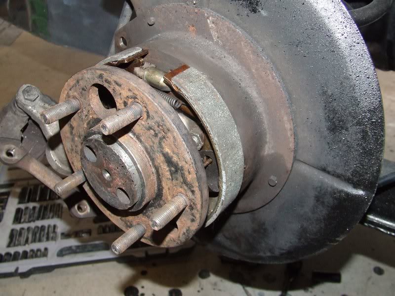

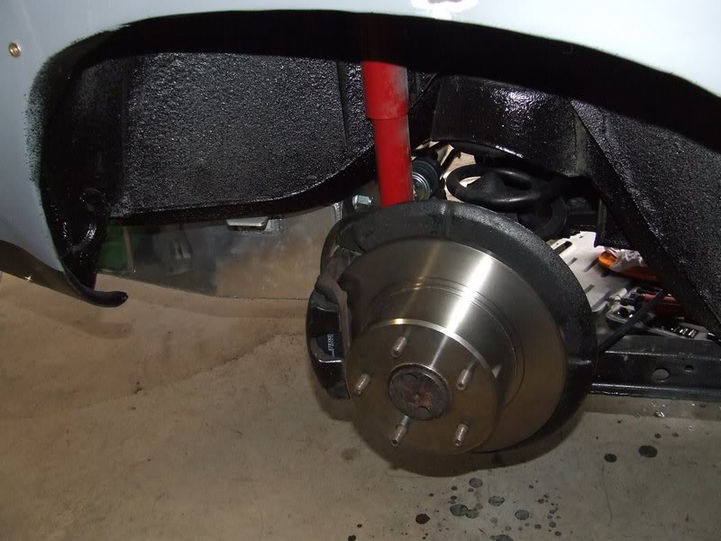

The next, very annoying, job was to fit new rear brake pads, rotors and handbrake shoes.
I used bendix handbrake shoes, as they're a pain in the a$$ to change compared to pads.
The only problem with swapping to commodore discs is the caliper and the axle hat are ever just slightly out of alignment, and the easiest fix is to shim the rotor off the axle hat a tad.
Sounds really easy, and I guess it is, but I went and bought a stack of shims and washers of all various widths to get this done. Anyone who's played with these brakes knows how much of a pain it is getting to the caliper bolts. Imagine then, fitting shims, fit rotor, do up 1 wheel nut to locate rotor, mount caliper and tighten both bolts. Rotor wont turn. Slowly undo rotor until you can tell which way it's adjusted wrong. Remove caliper, remove 1 tight wheel nut and remove rotor, change shims, then do it all again. Grrrrr. 5 times it took, but it's perfect now. Let's not talk about how annoying the springs are to refit in the handbrake shoes.
Well, it was worth the muck around I guess, as it's all good and proper now.

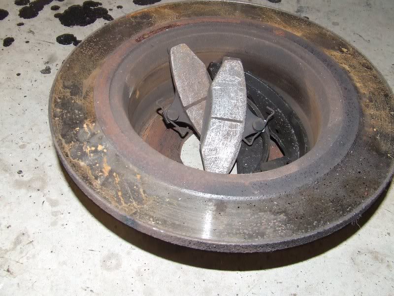

Here's the old pads, shoes and rotor from the right hand side. Note the approx 1.5mm lip on the inner and outer edge of the rotor. Nice : )
Interesting, I never would have thought of that. Most people just change to the disc brake axle seals.

Hiya 76lxhatch. I did swap the bearings and seals to disc brake ones, but when using non commodore axles the shims are still necessary, as far as I know anyway. My friends green hatch - I think there's a few pics of it in this thread - needed the same thing done when it got converted to commodore discs. It also runs a 9 inch with holden axle tubes.
Either way, it's done now so I'm happy : )

Yea the disc brake seals are to take the end play out... Ive been told to shim the caliper rather then the disc... havnt done it yet tho.

In my head I thought shim the caliper too, but unfortunately the caliper mounts on the disc rotor side of the mounting bracket, so I would have to actually machine metal off the caliper to fix the problem. It just seemed easier/quicker to use shims, even though it was a pain and took ages : )
Ah I see, I should have thought about it a bit longer, you'd have bearing problems without changing the seals regardless. Duh, carry on... :spoton:
