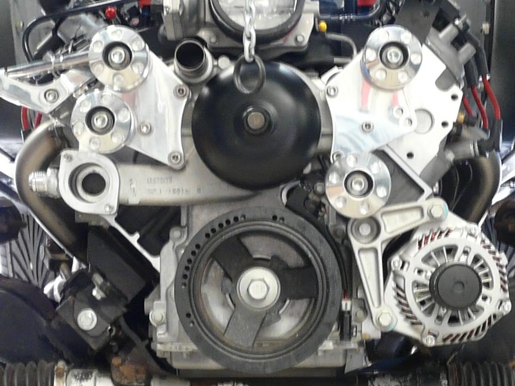

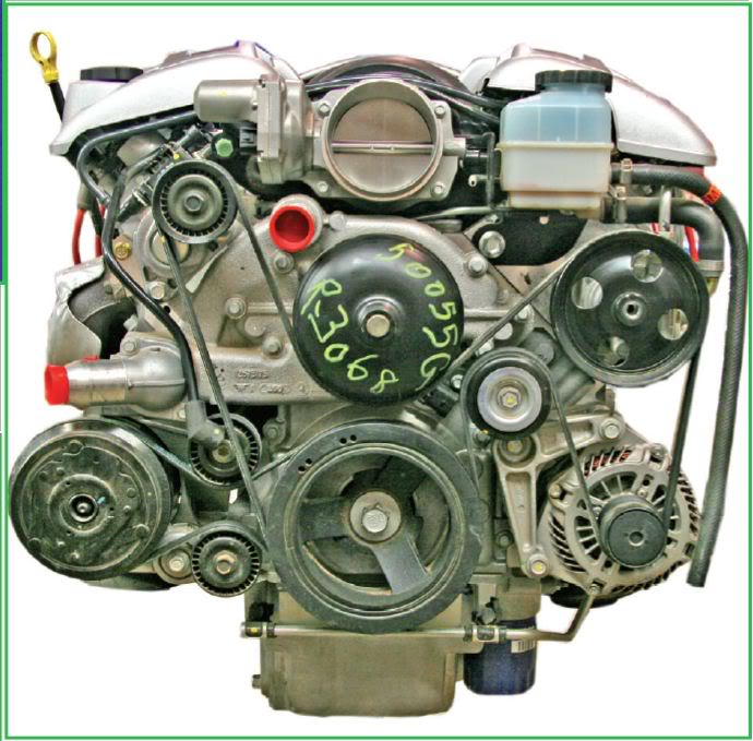

#592 TerrA LX
Posted 12 April 2010 - 10:28 PM
You can't plug the powersteering pump, the pump will over pressurise.
You can't run it dry either.
Looping it may overpressurise the low pressure return aswell.
either run a smaller belt or purchase a dummy idler pully.

I just got shorter belt and a pulley of a V6 supercharged engine and solved the problem.
#594 ls2lxhatch
Posted 13 April 2010 - 10:45 AM
The green LS2 hatch ran the power steering pump as an idler until the twin turbos were fitted and it was painted black.
The V6 pulley looks good but the amount of belt contact with the crank and alternator is significantly reduced compared to the factory setup. It will be interesting to see if belt slippage is a problem. I think LS1LX removed the alternator idler and went straight from the crank to alternator to water pump.
CAE make an idler for $210 that would look at home on a tractor.
I bought this idler with the A/C bracket I was going to use.
Fitting an electric water pump is another option.

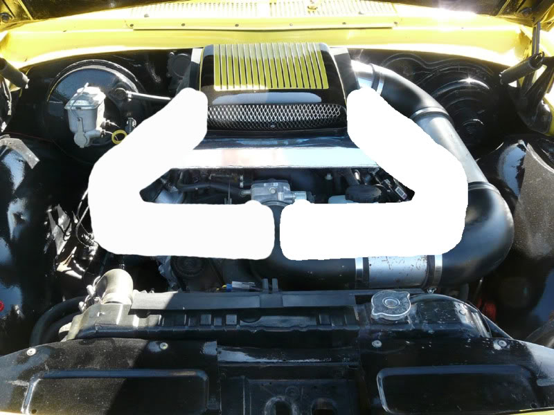

Posted 13 April 2010 - 11:23 AM
Intake Ideas time!
Whats to stop you running the left hand pipe (the one that is modified to miss the radiator hose) closer to the engine covers and the same on the other side, then flicking them up and into a scoop/filter?
something like this-
If you wanted to get tricky, you could make a two piece airbox setup so that the lid and filter would go up with the bonnet and youd be left with two big fat intake pipes and maybe a small alloy box?
And get them HPC coated :)
There doesn't appear to be room for that in the photos previously posted, the height of the throttle body places it in front of a pulley and any sharper bend would be detrimental...

Yeah, my brother and I discussed using the airbox set up with a pipe on each side, but the engine covers are actually quite tall, and a 3" pipe wont fit over them and not hit the bonnet. It's OK though, we have a new plan.
