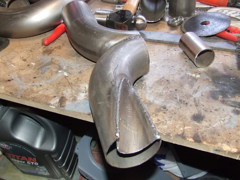

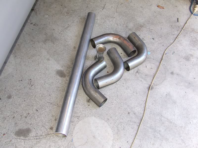

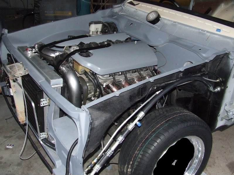

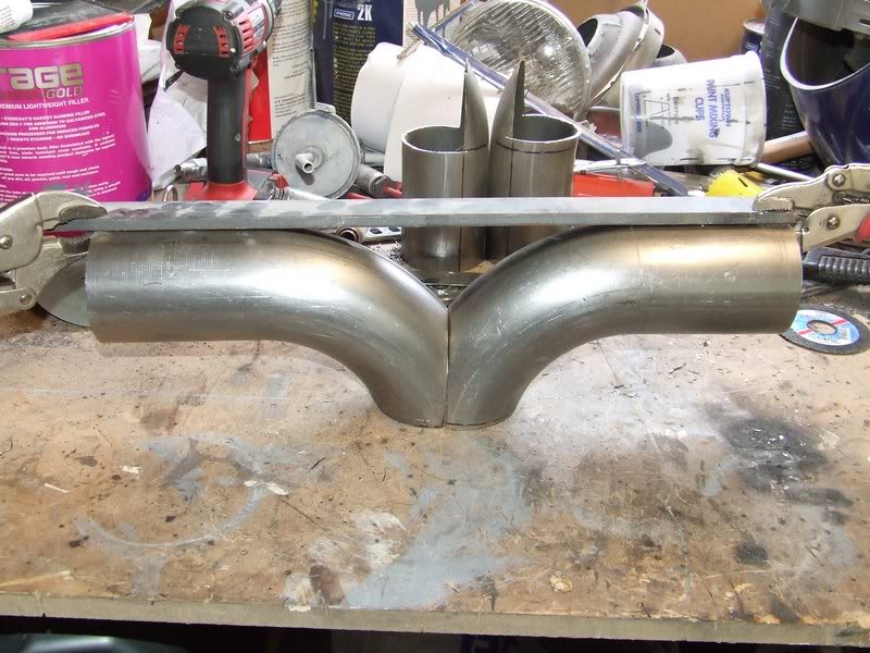

OK. This rotten air intake business. I tried the alloy aftermarket one and brother didn't like it. I guess I didn't either really. I still liked the idea of it being symetrical. So did brother. So I went out this morning and bought some 3" mandrel bends, some 3" pipe and a weird little double flared piece of 2" pipe. You'll see why.
The opening of this intake will be a small piece of 4" pipe, which I don't have yet, so the first thing I did was to cut two of the mandrel bends to the length I wanted out of the throttle body, then cut the side out of each where they join. I made sure where they join is just under 4 inches, so when I get the pipe it can go over the top.

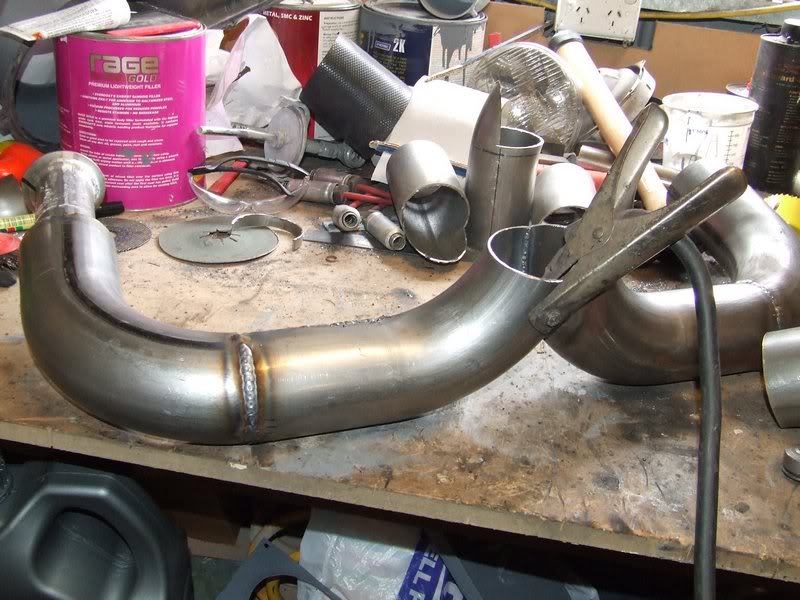

I clamped the two pieces to a piece of 10mm flat bar to make sure they stayed in line while I welded them.

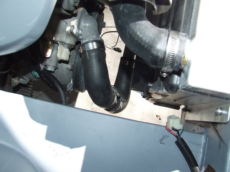

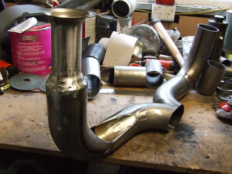

The passengers side will be fairly straight forward, as there isn't really anything in the way. The drivers side however has top and bottom radiator hoses in the way.

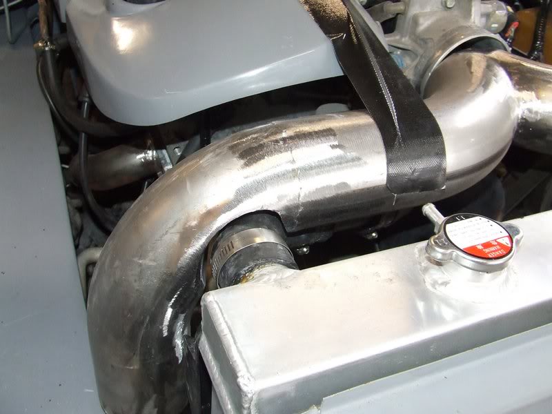

To have the two intakes and still be able to close the bonnet I had to allow the top radiator hose to fit inside the new intake. It was a pain in the bum to do but it looks much better, as not only is the intake symmetrical, but you can't really see the top radiator hose any more : )
Here's the first piece welded in for the recess for the top hose.
Sure it's going to be a restriction, but hey, it's got the other side too.

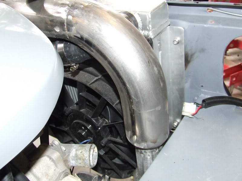

Because this piece will be getting chromed, I want to be able to sand it smooth where it's welded. I try to keep the welds as flat as I can, so it's easier to sand. Mainly because I'm lazy : ) And I'm too much of a cheapskate to buy a TIG.
This is the area that a 3" pipe is supposed to fit. I didn't like my chances, so this is where the flared 2" pipe comes into play.
I welded the flared 2" pipe in the area where it passes the chassis rail. This means it will actually fit, so any loss in flow can go jump : )

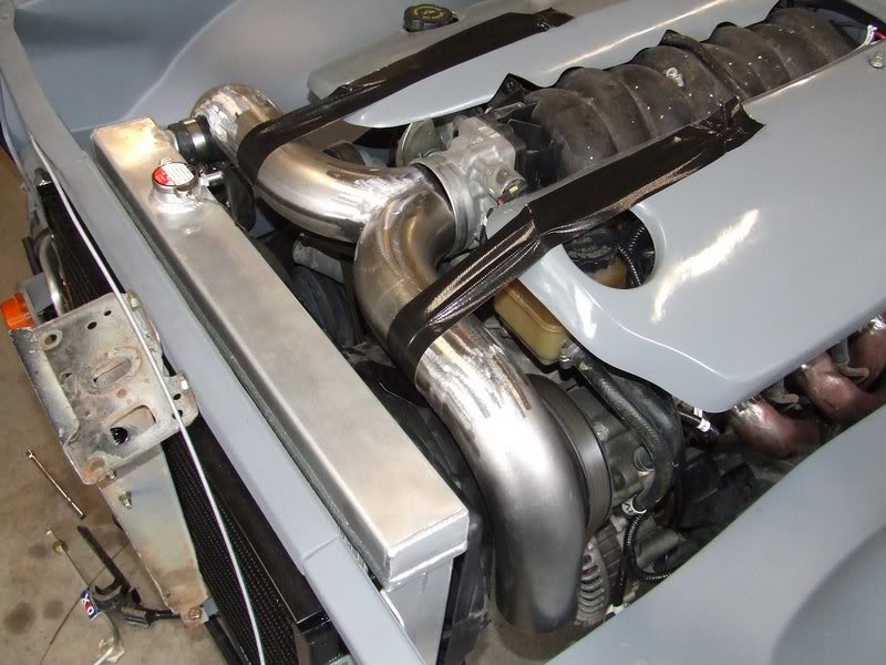

Here you can see how it works with the smaller pipe. It's still close, but it fits. Notice also the top radiator hose is inside the intake pipe.

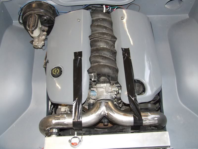

Here's just a few shots showing the overall look I'm going for. I still need to mount it and fit air cleaners, but you get the idea. Nice and symmetrical (not perfectly, but close enough) and no filters visible. Lovely : )

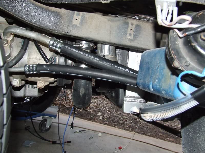

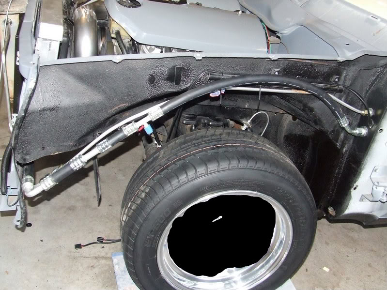

More good news, got the A/C lines made today. Starting at the compressor.
The front bits.
And the part that joins into the A/C unit itself. Don't worry about how saggy it looks. All of these hoses have to come out again when the car gets painted, so they can get mounted properly after that. In order to keep my brothers promise of hiding the wheels, I coloured the front wheel in. I did leave a bit in the middle not covered, so you can figure out what they are : )

Anyway, scrap that intake, scrap the inlet manifold. Fab up a tunnelram and put a nice big panel under the scoop mate. Otherwise it will just be a RICER

Heath, I think your idea of ricer and everyone elses are 2 different things. There is no way that a functional intake that improves the air flow is in any way Ricer. This is a brilliant intake that will look even better when finished (unless it is chromed - yuk) - I especially like the way it hides the radiator hoses. Even though it is losing a lot of potential flow down the drivers side I think the symmetry and the other unobstructed side more than makes up for it.

Do you think you will get heat soak into intake pipe over the radiator hose, or are you going to shield the radiator hose under the intake pipe?

My brother doesn't like how it compromises flow with the mods I had to make so it would actually fit, so I've binned it. Back to the drawing board.
As for the power steering, I think he's still waiting to hear back about one of those subaru power rack kits that someone in this forum makes, so the pump will stay, at least for now.

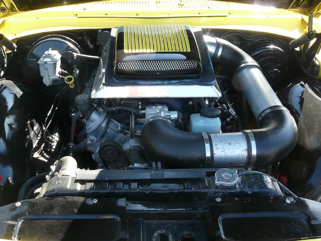

I do not think flow would be a problem as one of the pipes you used would flow more than the throttle body. I think heat would be a bit of a problem. I my opinion air quality below the bumper level is poor, particularly in Perth which is basically a sandpit.
Something like this would make the bonnet scoop operational, and provide clean, cold air.
Now that is cool! :spoton: And functional.

Well my brain hurts trying to figure out a way of making this thing symmetrical and not compromise flow, so for now he can have the standard black plastic pipe that came with the motor.
The airbox under the scoop idea is good, but then there's the symmetry problem again.
I still have other stuff to sort out so I'm going to concentrate on that and leave the intake for now. I feel enough time has been wasted on it. I liked it, and figured the flow loss was well catered for by the unobstructed other side, and the heat issue I can't see as being a huge problem, as the standard air intake runs along near the top tank anyway. The half a second it takes for the air to pass the "hot spot" where it goes over the top hose surely can't make too much difference to a dead stock engine.
Anyway, I'm sure something will come to me when I least expect it, and hey, we all make mistakes - to some people anyway.
So if anyone has any ideas that look good, are symmetrical, don't involve shaker scoops (Andy, how could you? hahha) or super expensive 8 throttle set ups please let me know. This car deserves something interesting, as all the other things my brother has wanted in my opinion will make this car very nice indeed.
Have I mentioned my brain hurts?????!!!!!!

Absolutely fantastic job on the car. Those pipes are looking really nice and I agree with you there would have been no real problem with air flow restriction because the other side would more than compensate. You could always send them my way ;-).
What if you made them in a slightly lower profile rectangular section that would take the same route but over the top of the radiator pipe and own as you planned? The bottom could round out to the flange you had on those ones.

Could you cut the radiator inlet off and get it welded on at a 45' angle downwards to give more clearance for the pipe?
