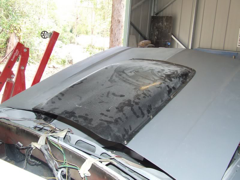

The top of the scoop is a bit ordinary, so it'll need a bit of attention to get it looking nice.
It's hard to see in the pic. but the top is sagged in the middle. The front needs a bit of work too.

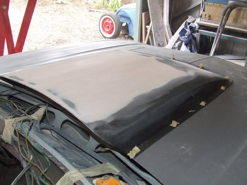

A few hours with some filler and sandpaper later.....
The scoop still needs more work, as it's still a little low in the middle, but that's what tomorrow is for : )

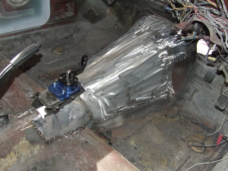

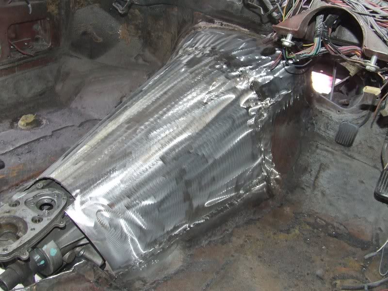

The tranny tunnel is pretty much done now. I've just got to make the bolt on top section that will cover the gearstick and have a rubber shield to stop gunk from coming inside the car from underneath.

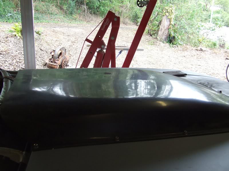

The scoop is still getting some work to fix the saggy look. I hate using filler, but in this case it's a necessary evil.
Plus, it makes the front of the scoop look like a butt print : )
