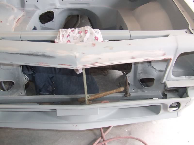

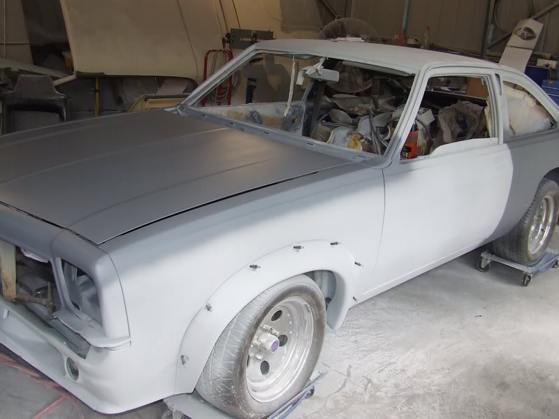

Well today was an exciting day filled with sanding, then a bit of sanding, followed by some sanding and then a bit of painting : )
It's all starting to look half decent now though.

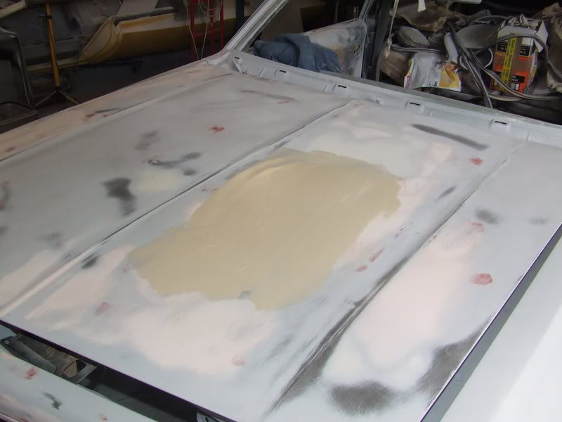

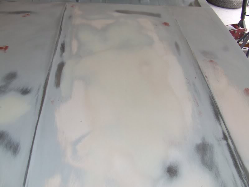

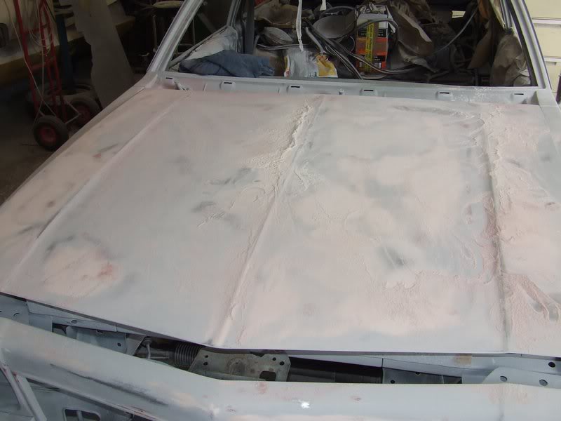

The bonnet was a bit of a shocker, but with the first 2 coats of primer I was finally able to figure out where it was wrong and got it sorted out after dry sanding it with a long board.
There was an annoying low spot that was near impossible to feel but showed itself once I blocked the bonnet down. I used a bit of Dolphin Glaze over a larger area and it smoothed out really nicely.
Looks like an awful lot of filler, but none of it is thick. I'd guess the thickest bit would be 2mm. It's just annoying being such a big flat area. Sikaflexing the bonnet skin back onto the framework underneath makes it a lot easier though, as the bonnet doesn't wobble up and down as you sand it.

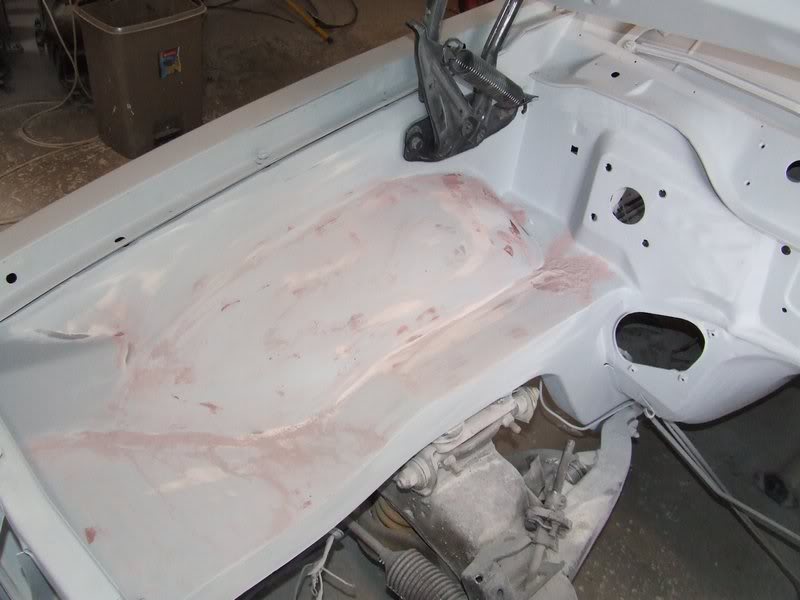

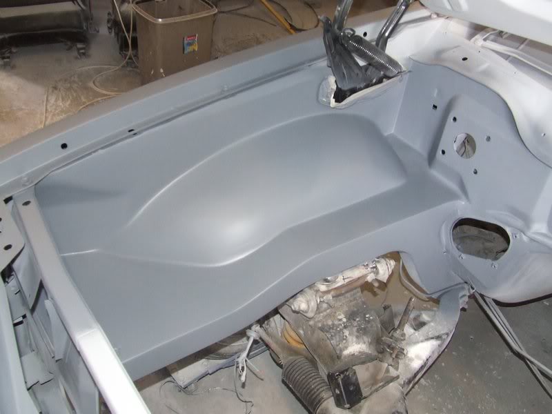

The right side of the engine bay also got a rub down and a few dabs with the stop putty.

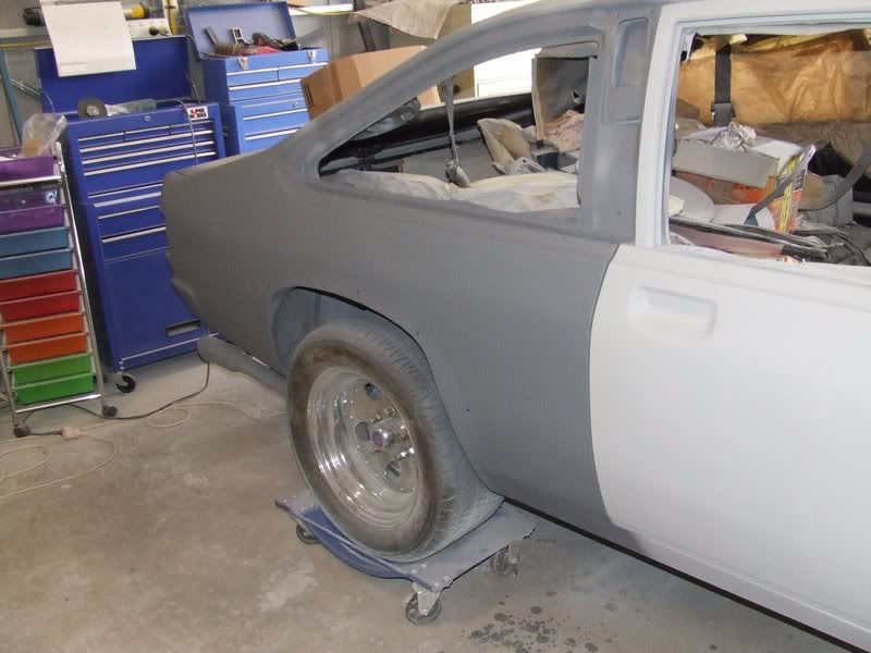

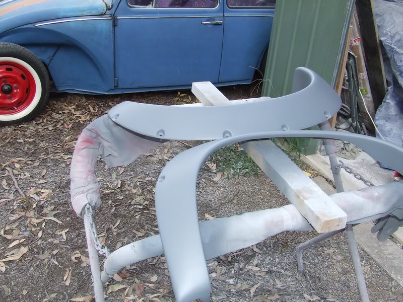

The nose cone, flares and rear wheel arches also got some fine tuning in readiness for their second lot of primer.

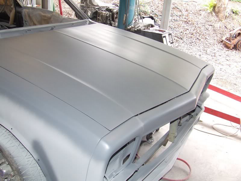

Once all the sanding and puttying was finished, it was time for some more primer.
This time I'm using a slightly different primer. It's still Protec 2k primer filler, but it's a darker grey. My poor old eyes have trouble seeing the imperfections in the light grey.
This is the part of the left rear flare that I added a fair bit of fibreglass to. I think it looks good. Can't really tell it's different.

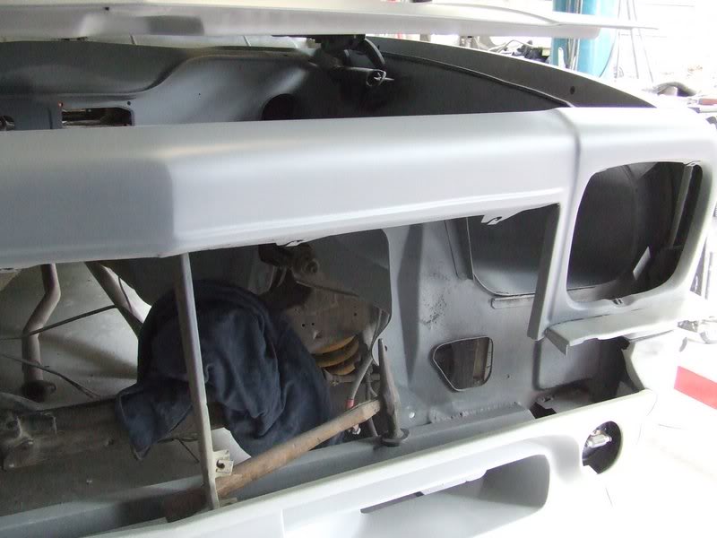

I'm happy with how the grill surround turned out, as it needed a fair bit of attention.
The side of the engine bay is a lot better now too. I really like smooth torana engine bays.

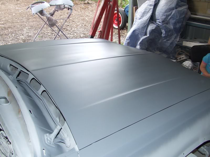

I'm stoked with how the bonnet looks this time around. I thought it was never going to be straight there for a while.

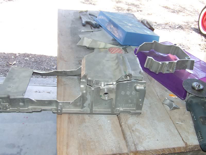

Speaking of 12 slotters, the wheels arrived today : )
Nice aren't they : )
You can see them when the car is finished. My brothers' orders.

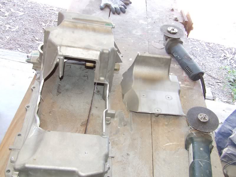

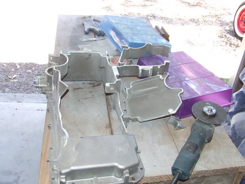

I also cut the sump to bits today and will hopefully get it welded soon as I don't have an AC/DC TIG.
The first bit to get cut out is to allow room for the crossmember and steering rack.
Then I took 50mm out of the depth of the pan.
Now I need to make a new middle section and get it welded together.
