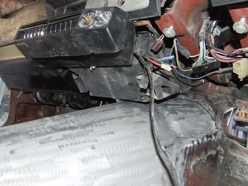

Well I finally made the new section for where I cut the crossmember out to fit the shifter. It's not pretty, but then again, neither am I, so there you go.
Getting the first side done was the hardest, as I made templates that I could use on the other side. I used 1.6mm steel to give it strength. The original was only 1mm. Once the gearbox comes back out I'll weld where the old crossmember was cut to the inside of the new bit I just added to tie it all together.
Here's the same side after some grinding and sanding. I always use 36 grit sanding discs on bare steel to clean the surface and smooth welds. I use 24 grit to remove paint. Just so you know : )
Here's the whole thing made and sanded.
A look from the other side, because it is so exciting to see : )
Once all that was done I gave the whole tunnel a good coat of rust converter.

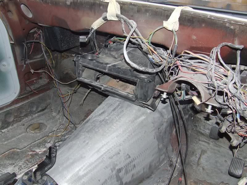

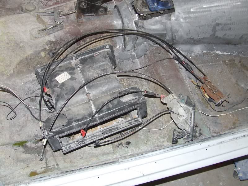

Well today was filled with hours of sanding and a bit of chasing parts. I needed to fit the heater, but only had the UC controls and cables. After some calls and going out and ripping them out of the same sedan I got the dash from, my brother tells me he;s sure he sent me them earlier on!!!! Whoops. I thought I had everything in the one pile. I might have to go looking.
Anyway, I managed to get the heater in place behind the A/C, after juggling a few bits and pieces out of the way.
The only other thing I had to change for the heater to fit properly against the firewall was cut this one lug off where it hits the new taller tunnel. You can just see it in this next pic.
Next job was to change the controls and cables over to the LX ones. You can see here the LX ones are fitted to the heater, and the much shorter UC ones are now unattached. The actual switch panel is different too, just in case you didn't know. I didn't, but I am pretty dumb : )
Finally it sits in place nice and neatly and has the right bits hanging off it. One more little job crossed off the imaginary list.

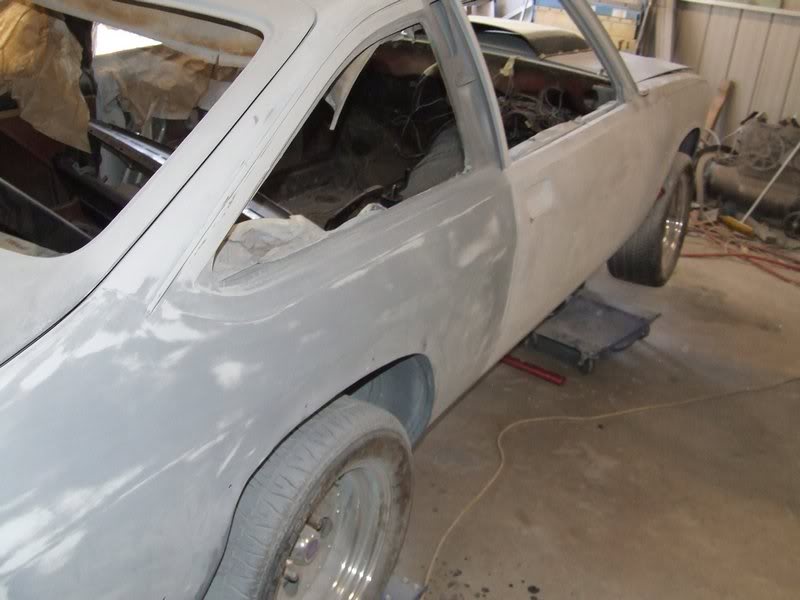

It was time to start dry sanding again. The little imperfections are getting really small now so I think the next batch of primer will be the last. Fingers crossed. I blocked it down this time with 120 grit dry. I could go smoother but the 120 still cuts a nice straight line, as opposed to following the shape, which is what smoother paper tends to do.
I really like the new darker grey protec primer I used last time. Much easier to see where I've sanded and low spots are really obvious with the long sanding block.
This next pic is funny as I've sanded the dark grey overspray off the lower part of the guard, and it looks like it has the blackouts painted on. I should just clear it : )

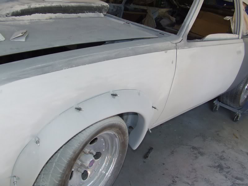

The whole right hand side except the roof got rubbed back today. It takes a little while, as I like to put as little pressure on the block as I can, so the lows don't get sanded. The whole point of this exercise is to find the lows/highs. There were a couple, but really really minor. As bad as it looks in the pics, it feels fantastic. I'm very happy with how it's coming up. The next coats of primer will get wet rubbed for topcoat. Yay!!!!!

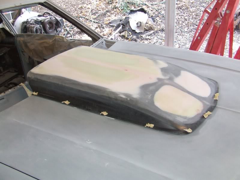

Some people ask why I don't use guide coat all the time. I like to use it at the start of the straightening stage. I'll then rough out the shape if filler is needed with 40 grit paper, then 80 grit then prime it. I don't use guide coat again, as it's just more stuff to sand off. I'm pretty anal about what sanding block I use on certain areas, as to which will give me the best result and show up any problems.
I normally use Upol Dolphin glaze on the tiny problems, as it's a finishing putty. It's really runny and easy to sand. The paint shop I went to didn't have any, but suggested I try this expensive bog. They're good guys there so I bit the $65 bullet (yikes) and went with it. It certainly is nice stuff yo use. Spreads on really smooth and had no air bubbles. Very nice.
There were a few minor bits here and there, plus I used it to finish off, hopefully, the bonnet scoop. I'd like to try and get most of the car reprimed tomorrow or friday.

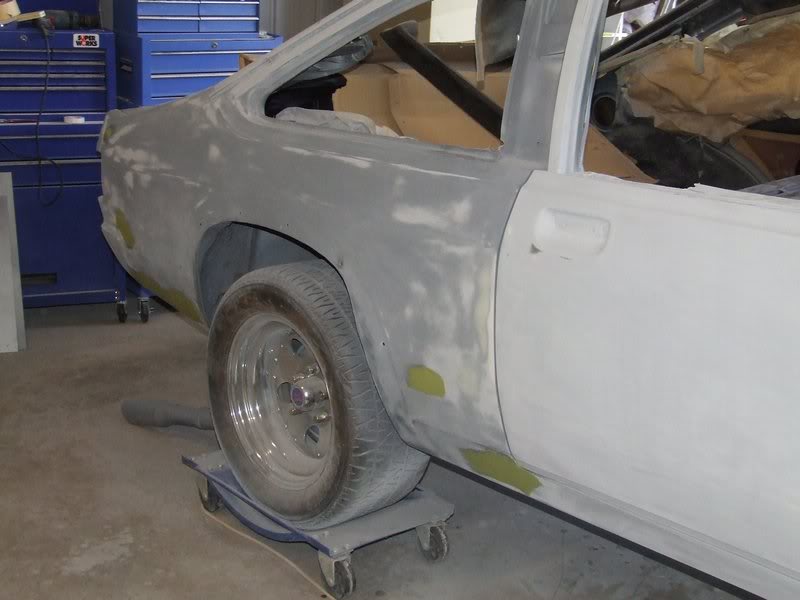

You can see in the next shot a few bits of filler on the rear guard. Once these bits are sanded they'll be see through. That's how minor the imperfections are, and how well this filler feathers out.
The front spoiler also got a touch up
And the saggy scoop : )

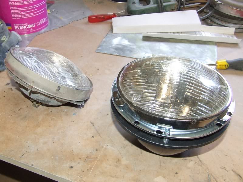

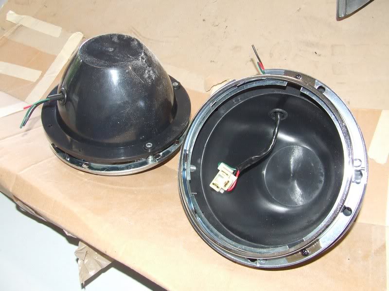

The new headlight buckets I ordered through carbitz showed up today. Those guys and gals there are really good in the nambour store.:spoton:
I figured seeing as they have to have custom mounts made they didn't need to be the original buckets. Plus I didn't have all the parts.
This is just a sealed beam light fitted as a trial. I assume it'll get halogen globes eventually.

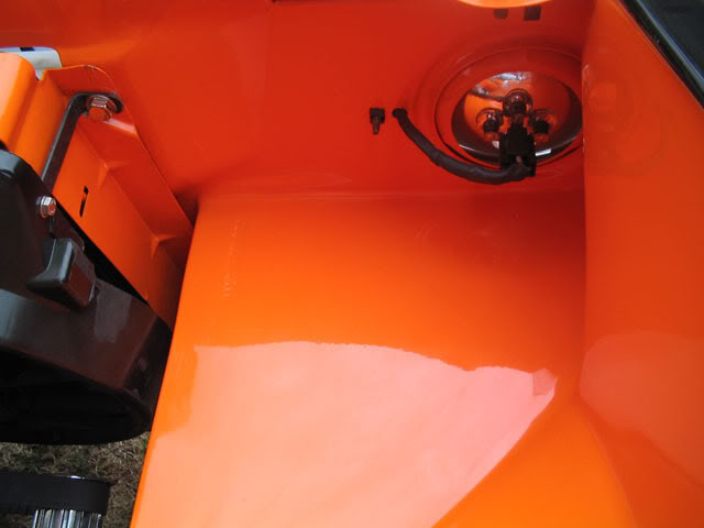

The NARVA headlight buckets should look better in the engine bay than the original LX setup. I considered using them on my LX to tidy up the back of the headlight but I think I have a simpler solution for the original setup.

I too think the narva buckets should look OK once painted. They were cheap too, so can't argue with that.
