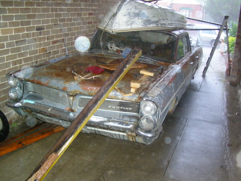

Hey Bart. I've spent a lot of hours in the last year on a friends 1963 pontiac bonneville 2 door hardtop. One of the rustiest cars I've ever worked on, and no replacement panels like the camaro : (
What are your plans for the old beastie?

Plans for the beasty, restore it I hope. Yes the Bonneville is the USA version I think, this is the Canadian version, 1963 Pontiac Laurentian, same panels but different floor/boot pan, Bonneville has the wide track chassis Laurentian has the narrow K frame. You can tell the difference as the Bonneville wheels are closer to the guard arch, fuller wheel arches.
The USA 1962 Chev Bel Air shares the same floor/boot pan and chassis as the 1963 Laurentian but the outer panels are different obviously.
