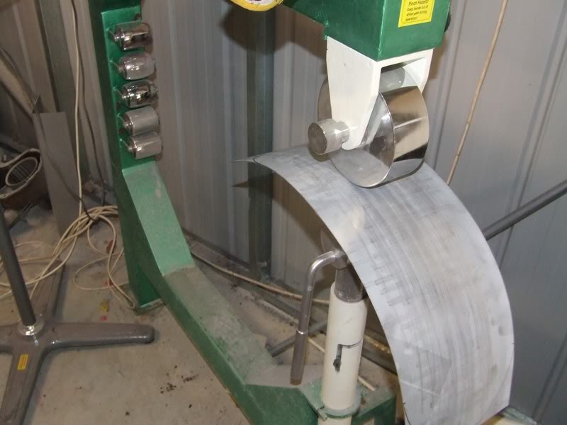

mmmm....english wheel. Mine's not a super dooper mega dollar one, but it does me fine.
Take a pic of it, show us your goods mate

It's not a great pic but you can still sort of see it.
This is the start of one of the cycle guards for my volksrod.
