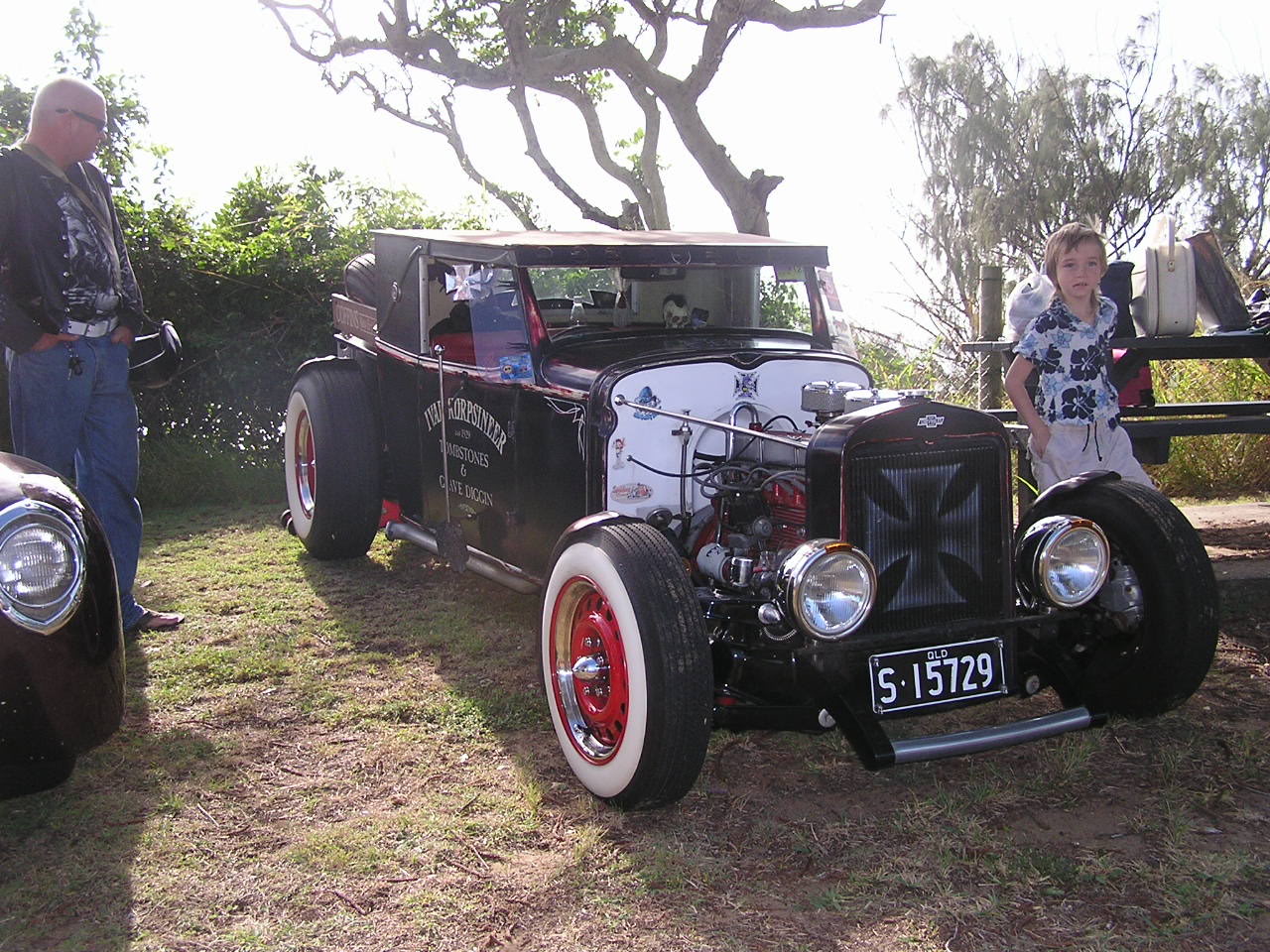

Posted 12 July 2010 - 10:17 PM
Owned by a local bloke, have been out to his place a few times. All built in his shed and cost him less than $10k. He drives it all around Australia.
Now has a Cummins supercharger on it
